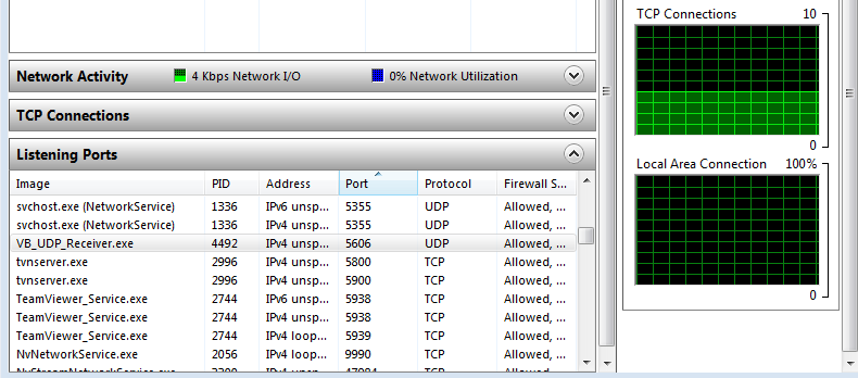

    I am going to attach each picture, so that you can see each aspect.
    My first picture is showing the port 5606.
    I am using the 5606 port for the VB UDP receiver.
    Regards Marcel

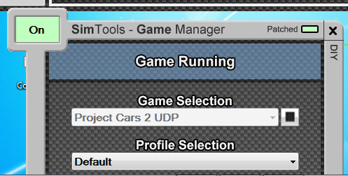

    The second Picture is of the Game manager,
    You can see that I have started the game and it is patched.
    As you can see, PC2 UDP is patched and the game says that it is running.
    MC

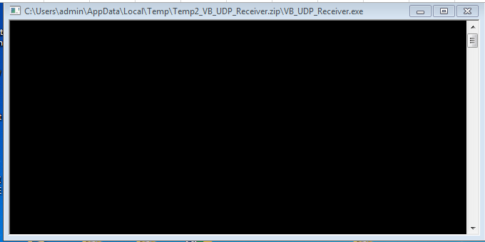

    2DOF, SCN5
    Please see UDP receiver show that no info is reaching the PC
    MC

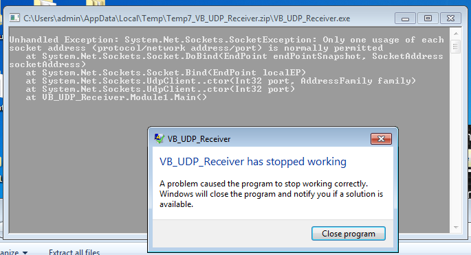

    Hi Noorbeast,
    I took a picture now of the error,
    Do you have any idea what this means?
    Regards Marcel
    21,580
    151,094Coins
    +11,028 / 56 / -2
    My guess you have multiple apps trying to use the same port, crashing the app.

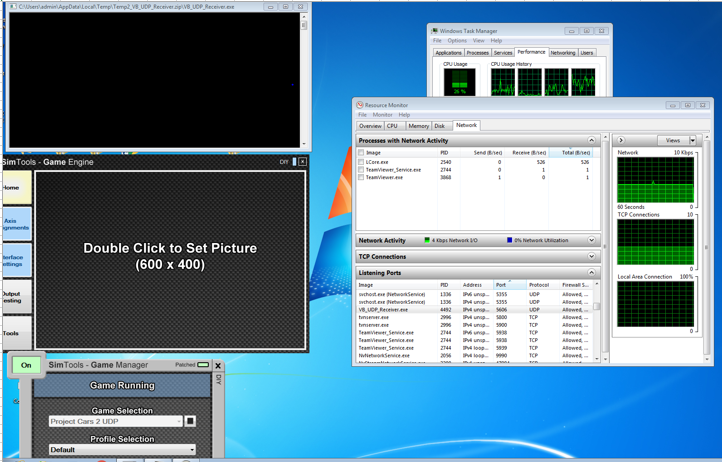

    2DOF, SCN5
    I will check using task manager if I can see any other application using port 5606.
    Thanks,
    Regards Marcel
