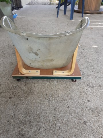

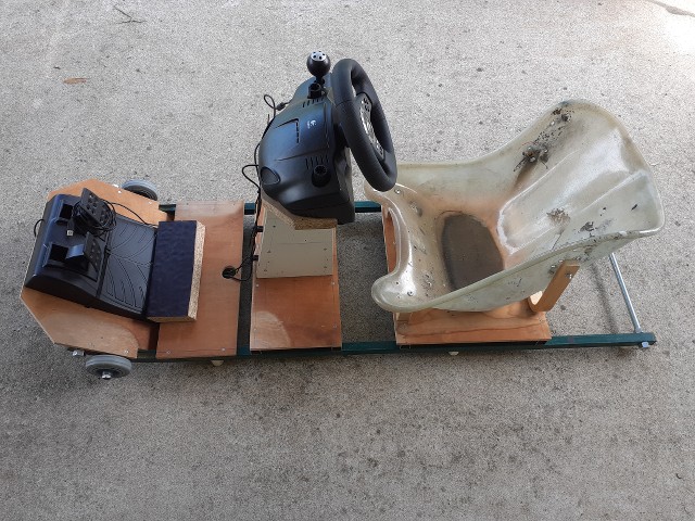

    The old swing has found a new life by turning into a chassis, an old kart tub repaired with fiber, Ikea chair legs
    , a few pieces of wood and screws.[​IMG]

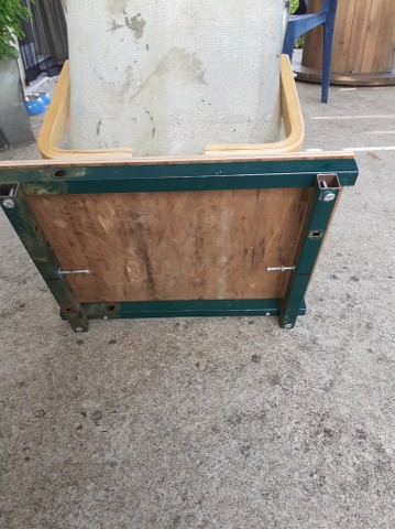

    Attaching the seat with Ikea children's chair legs[​IMG]

    The distance from the steering wheel and the seat are adjustable with screws so that my children can also play.

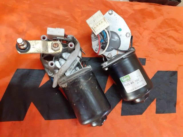

    Some little news:
    Today I got 2 valéo wipers (12v).[​IMG]
    To carry out my first tests, I ordered inexpensive Moto monsters. If it is successful, I will buy a sabertooth card.

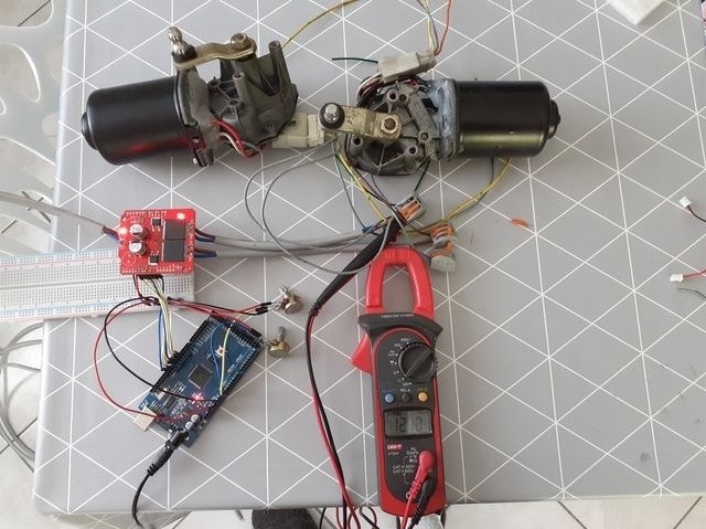

    Today I received the Chinese monster motorcycle cards.
    I tested the 2 cards with my multimeter then with the motors.
    Only one card works properly.[​IMG]

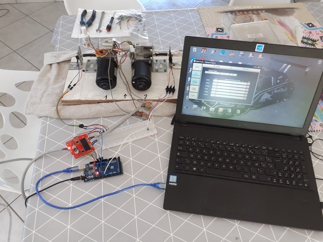

    today I carried out my first functional test with the Arduino software then with Simtools demo.
    I followed the forum tutorial and everything went well, well almost ...
    The engine n ° 1 works correctly and reacts well, the engine 2 tends to move back and to seek a little its final position after each command.
    In addition motor 2 has less movement than motor 1. I measured the voltage in A0 and A1 of my arduino
    when I put the motors in the middle position (command R7FL7F).
    I find 2.1volt on A0 and 2.9volt on A1. Is it normal not to have the same values on the outputs of my potentiometers?
    21,592
    151,215Coins
    I have mentioned these before -
    Are the motors ground isolated: https://www.xsimulator.net/community/faq/wiper-motor-mandatory-ground-isolation.25/
    Has the clone MM been tested: https://www.xsimulator.net/community/faq/reputable-monster-moto-suppliers-testing-before-use.158/
    As an aside MMs need active cooling.

    Thanks for the reply, I think I found the source of the problem. I reduced the speed of the motors and now the 2 motors work well and take the same positions.

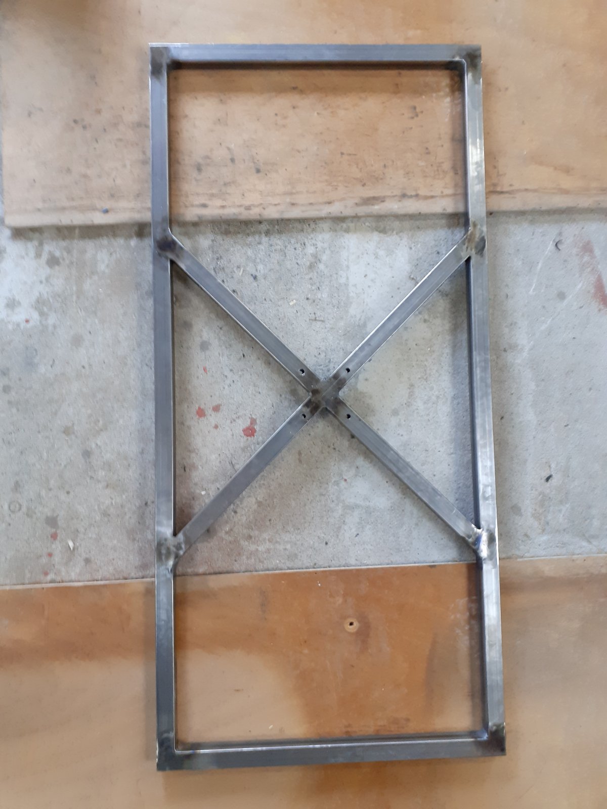

    Last week I made the base of the simulator.
    I used used 30 x 30 mm square tube (3€ for 5 tubes of 1150 mm).
    The frame is 1150 x 550 mm.

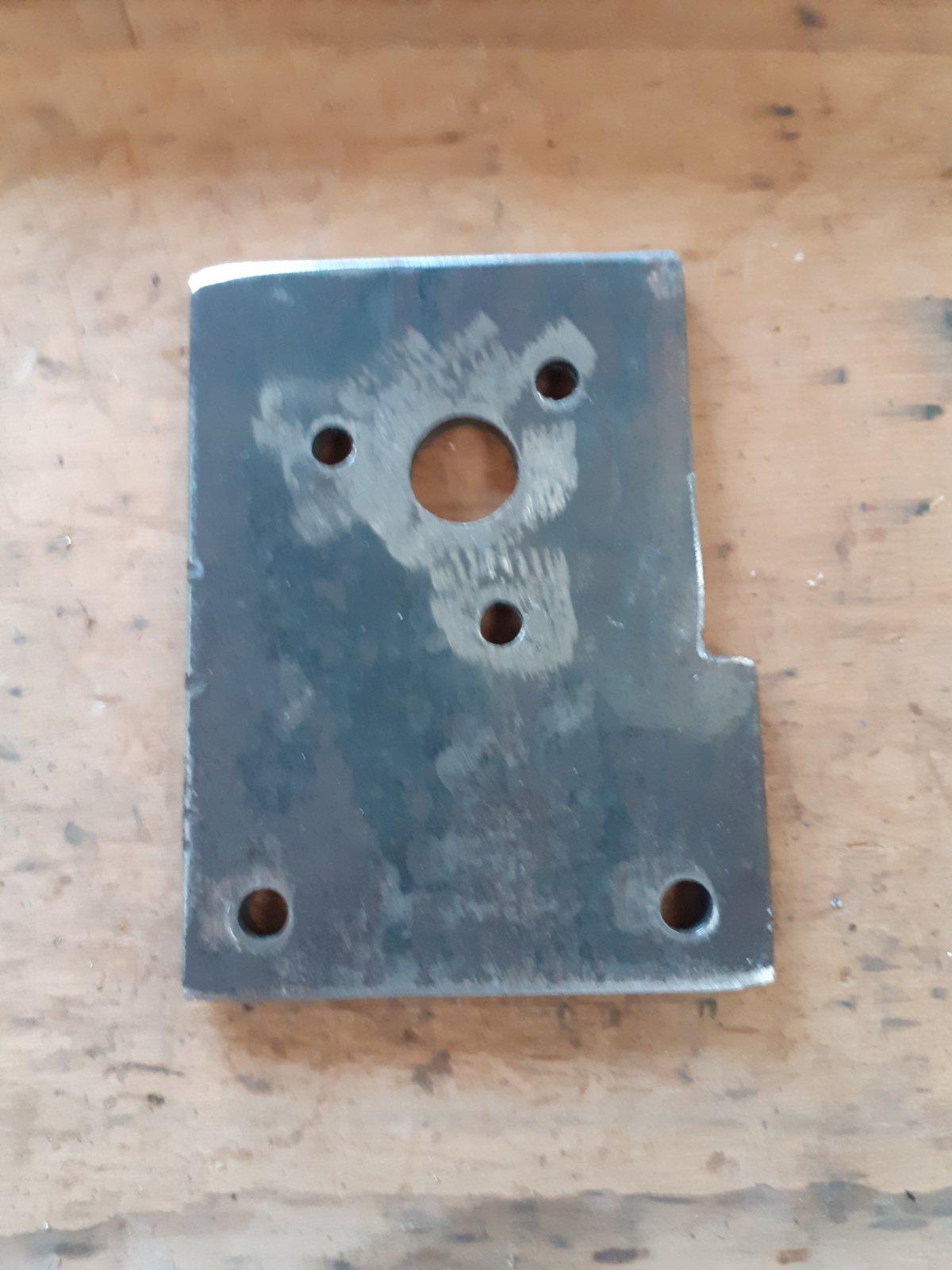

    While I was in the workshop I also prepared the motor plates with 7.5 mm thick flat iron.

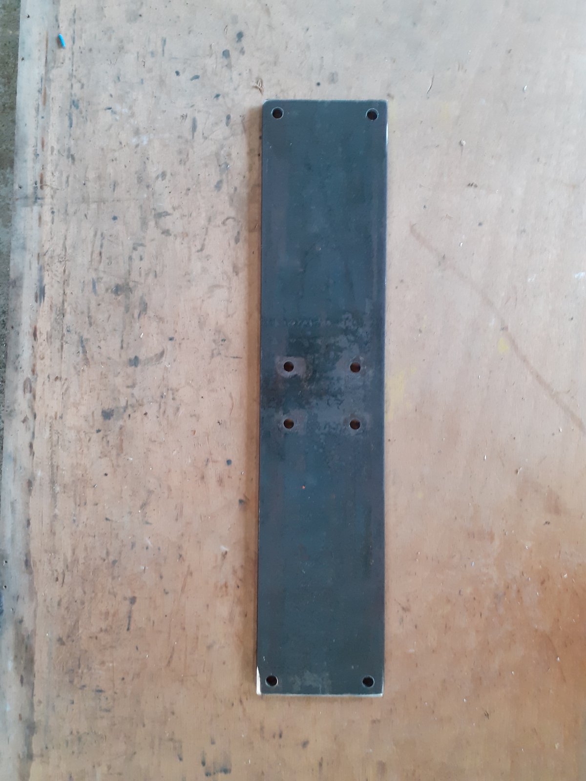

    I cut a 470 x 100 mm flat iron that will serve as a connection between the gimbal and my seat.

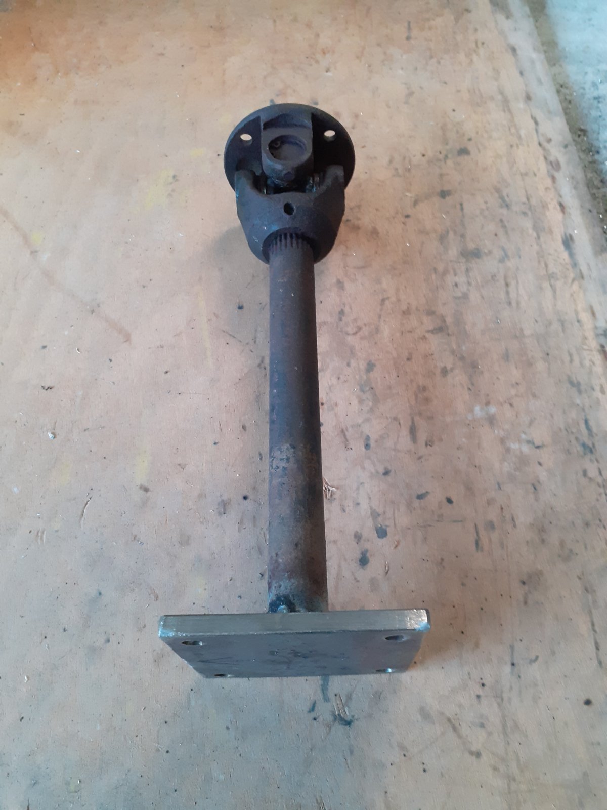

    I got a cardan from triumph spitfire.
    After cutting it, I welded it on a 100 x 100 mm plate.
    I will add reinforcements when the tests are finished.
