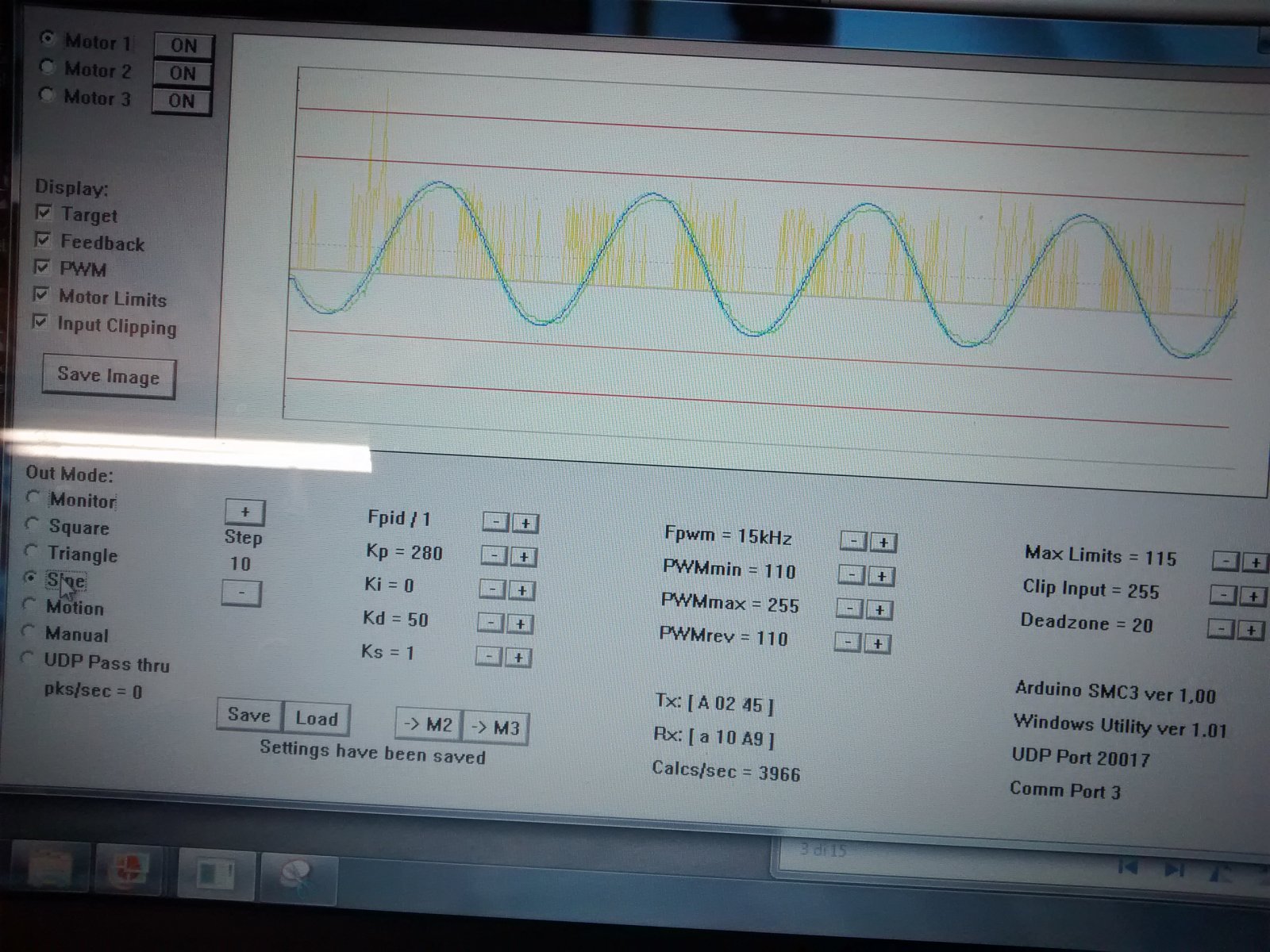

    My playseat is going by two wiper motors with PS4 Project cars 2 and now I'm starting to install the third worm gear motor, traction loss.
    Now I don't understand if the plugin UDP for PS4 have the traction loss effect. I think I need set up the traction loss motor on EXTRA 1 with 100%.

    Hopefully @vthinsel can add the supported axis to the description on the plugin download page, but from the video on the download page Extra1 is supported and yes you can use up to 100% on any dedicated axis, such as traction loss.

    I've a problem with the wiper motor, I think the feedback curve (green Line) isn't good. So I'd like to have some suggestions to improve the wiper motor operation. See the files about my two motors.
