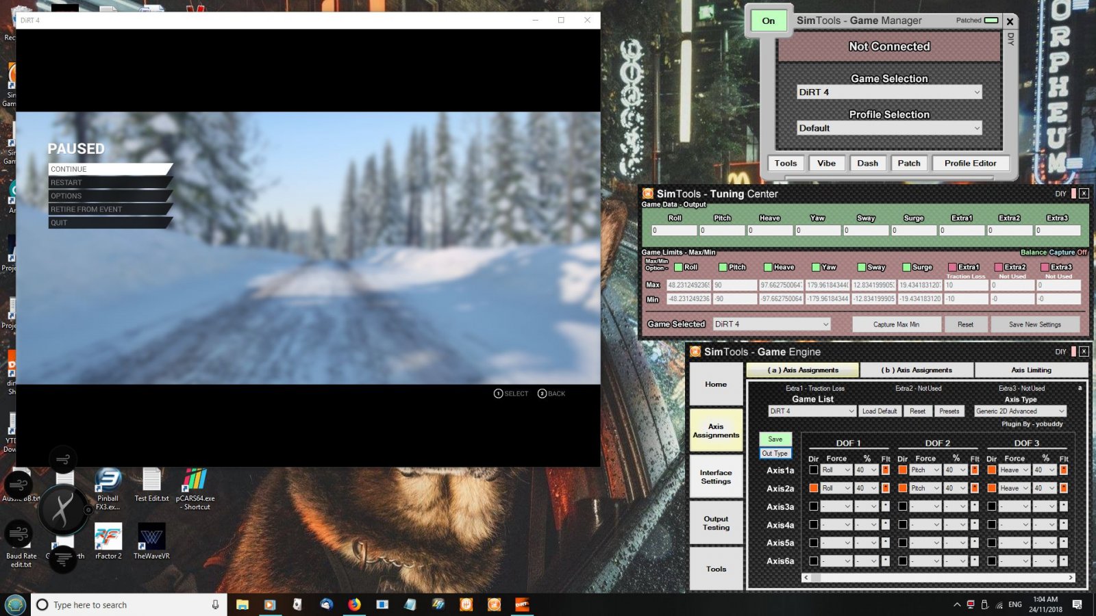

    I have only recently got my 2Dof rig working and I am still new to creating game profiles etc. but I have already downloaded all the plugins for PC1 & 2 for motion and the other driving games that I prefer, and I have successfully got motion working in L.F.S, and Dirt4 with no real problem.
    Project Cars 1 & 2 are a different story though and I have basically followed the same steps as I did in Dirt 4 for PC's with the exception of allowing Share Memory and UDP in the settings menu but when i run the game Game Manager is not connecting which is why I am getting no motion.
    I have the same IP address on Game Manager and Game Engine selected so I think that is all I need to do or is it ?
    If it matters I am using a Sabertooth 2X25 with Arduino in Packet Serial mode.
    The game also launches through Steam because I have VR . Would that affect what's not happening.

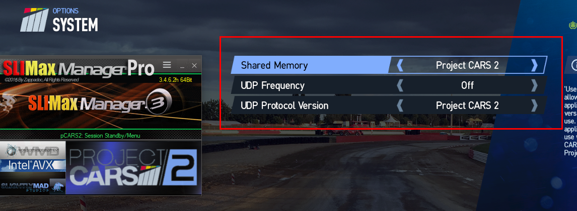

    not sure why you want to use UDP when you can use shared memory. From my understand UDP and shared memory are two different ways for SimTools to read motion information from the game.
    I have it running fine with shared memory, like in the screenshot above. I think if SimTools and the game run on the same machine, you can save yourself some Firewall and network hassle by using shared memory instead of UDP.
    Also make sure you use the Projects Cars2 Plugin WITHOUT UDP !! (there are two different ones, one with UDP and one without).

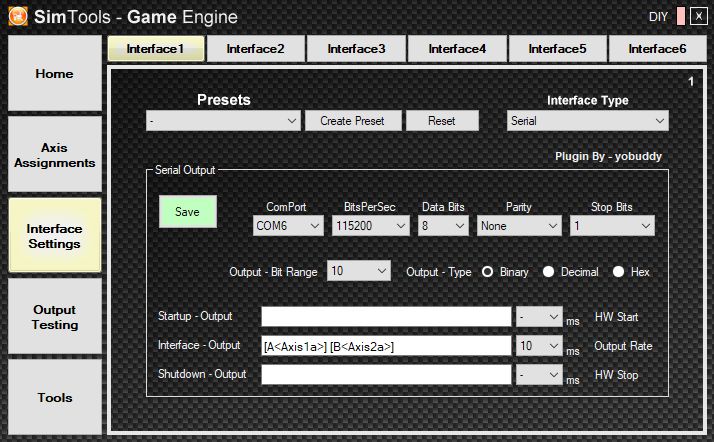

    I am starting to think is there a problem with the Arduino sketch as I have to manually edit and re-do some baud rate settings if I want to use SMC utility because of my Sabertooth .
    I have done it 20 or more times and all is good and I can test each axis and play with settings if needed so there is no mystery there as it's only two lines that get edited.
    So I am at a loss now and looking for suggestions and no I don't want to do a clean install of my system if it is just a registry problem.

    I don't think it's Arduino problem if you can normally test each Axis in Simtools Output testing. In your screenshots everything seems OK. Just some of these Tuning Center values seems a bit off, Sway and Surge for example. But that also shouldn't be the problem for the game connection with Simtools.
    What is your game patching procedure?
    Can you check for Dirt4 if it was patched succesfully - go to My Documents\My Games\DiRT 4\hardwaresettings\ and open file hardware_settings_config.xml with Notepad
    At the bottom of the file there should be some lines like this, bold one is important for Simtools:
    <motion_platform>
    <dbox enabled="true" />
    <udp enabled="true" extradata="3" ip="127.0.0.1" port="4123" delay="1" />
    <custom_udp enabled="false" filename="packet_data.xml" ip="127.0.0.1" port="20777" delay="1" />
    <fanatec enabled="true" pedalVibrationScale="1.0" wheelVibrationScale="1.0" ledTrueForGearsFalseForSpeed="true" />
    </motion_platform>

    G'day,
    I use Game Manager to patch games and unpatch when needed.
    I have these lines in my Dirt4 hardware config.xml
    <motion_platform>
    <udp enabled="true" extradata="3" ip="192.168.0.103" port="4123" delay="1" />
    </motion_platform>
    Just did a few stages and still no connection ??
  19. prodigy
    prodigy Burning revs
    Oct 27, 2013
    459
    Croatia
    6,698Coins
    +399 / 4 / -0
    How come you have this IP address: 192.168.0.103 instead of 127.0.0.1
    Have you entered this IP address yourself in the Simtools Game Manager?
  20. Deane
    Deane Old Fart Gold Contributor
    Aug 25, 2018
    215
    Wirrina Cove, South Australia
    681Coins
    +91 / 3 / -0
    The IP address is what comes up when I press the tools IP Address box and that is what comes up in both I just clicked save.
    I did try to change it but it never worked it just stayed as is before, so I tried doing it again and bingo it connected.
    So I assume that was the answer to the problem, but I waas also getting a .Net Framework error when I ran the games and I also just ran .Net Framework Repair Tool
    and rebooted the computer and voila .
    Regardless of which was wrong it is OK now and that is what I was after.
    So thanks all for your help :):)
