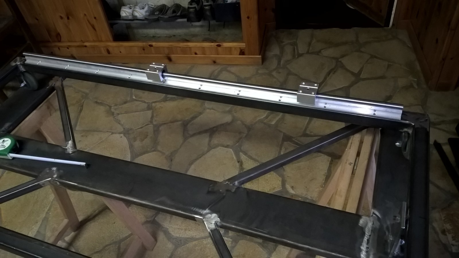

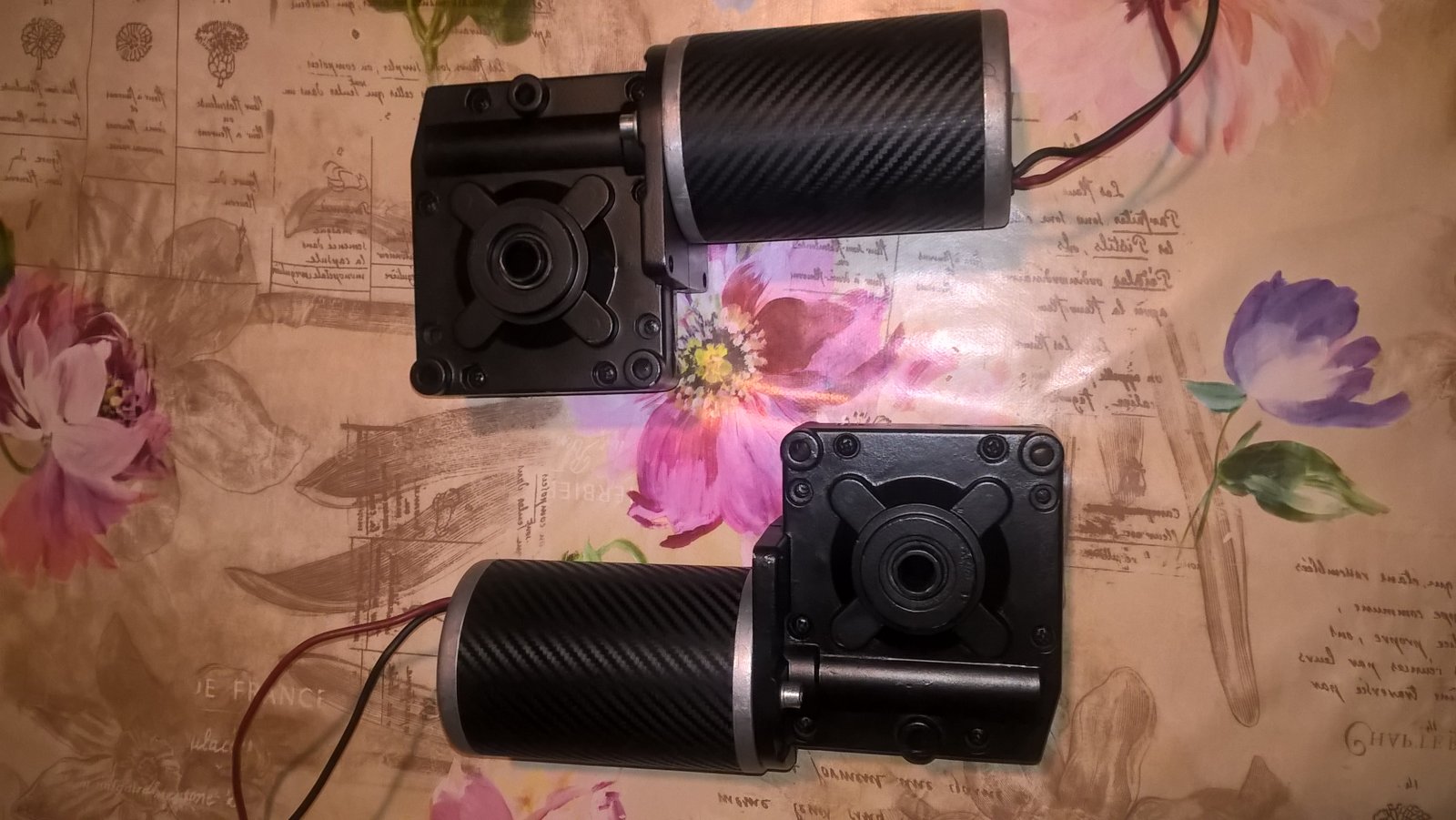

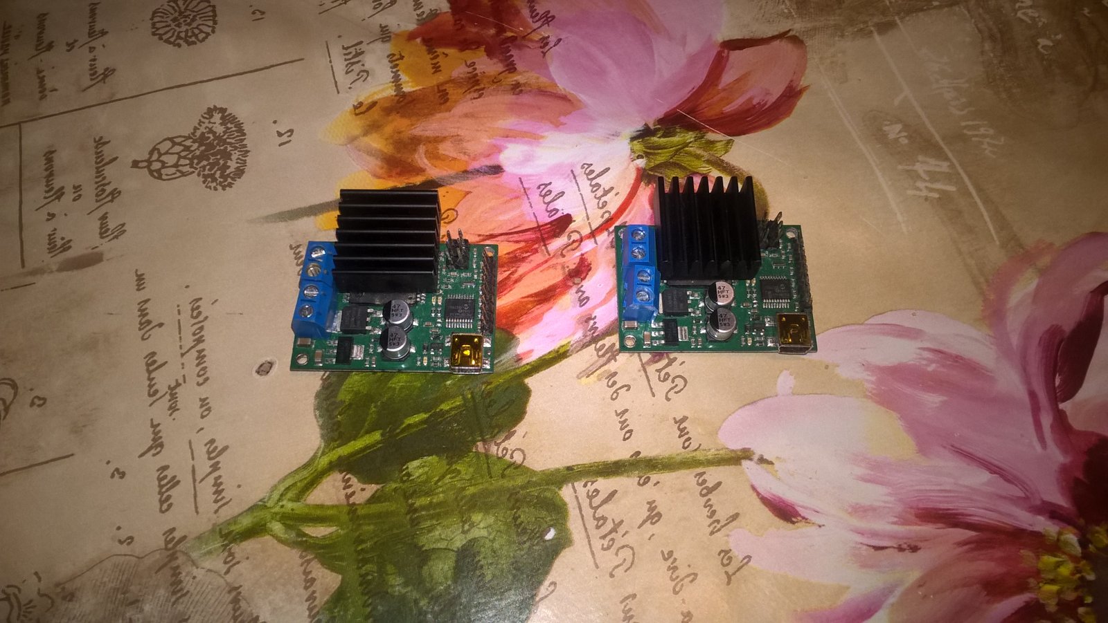

    Hi everybody,
    I looked for informations on web and finnally I decided about my sim.
    The rig is in progress (I will post some pictures). Will be ready for 4 dof but at the moment yaw and surge movements will be mechanically locked and without motors
    I will start with pitch and roll only.Then after some experiences will go ahed with other movments.
    The motors I have choosed are 2 zyt80 driven with 2 jrk 12 and 2 PSU 12V 50 A (still waiting for delivery)
    I'm still searching for a good sliding system for surge (smooth and silence) I would like to use 2 linear guide with 4 sliders.
    I want to install them now, in this way the rig will be ready in the future to add surge.
    I will let you know about the progres :thumbs
    ...enjoy you race

    Hi to everybody , I need an helpThe frame is a work in progress, I'm starting with softwareHere the motors and the jrk
    Now I have a questions or better
    For Windows 10 Home 32 bit wich Pololu driver I need?
    Thanks a lot for an answer

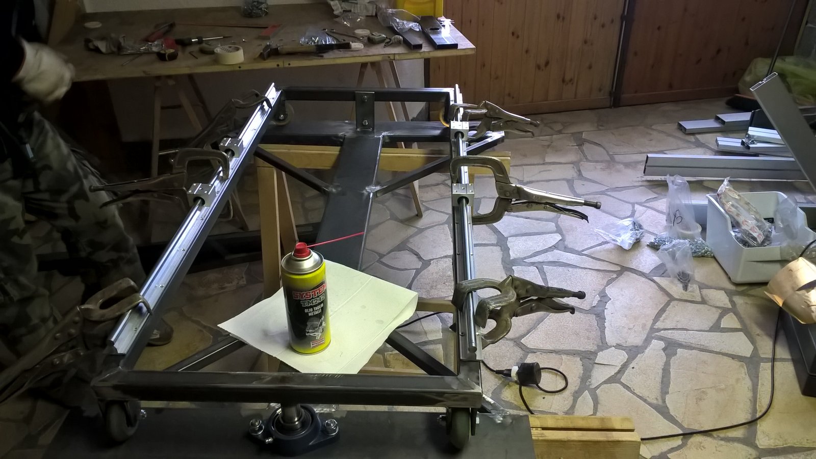

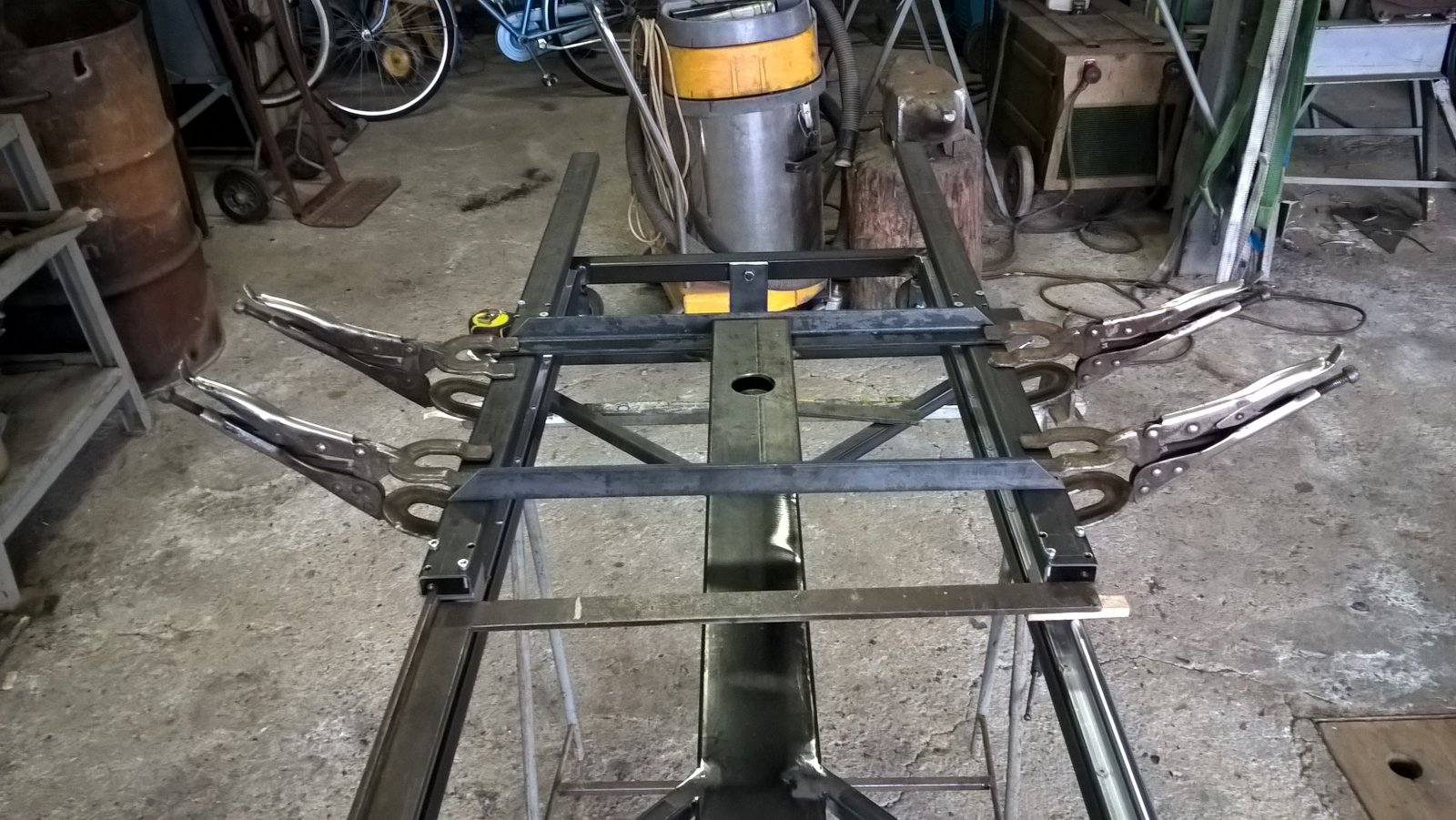

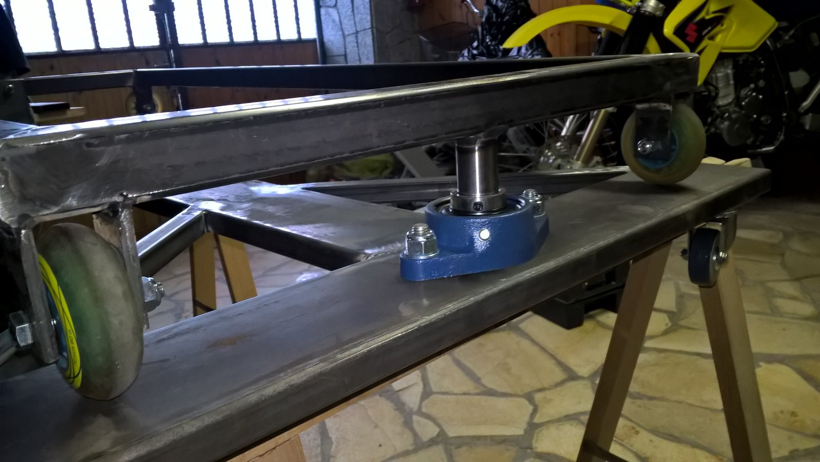

    Hi everybody, I want to show my work in progress, maybe can help some one about rig construction .....
  20. Enrico
    Enrico Member
    Feb 5, 2018
    123
    417Coins
    +28 / 0 / -0
    4DOF
    ...and some more ..
