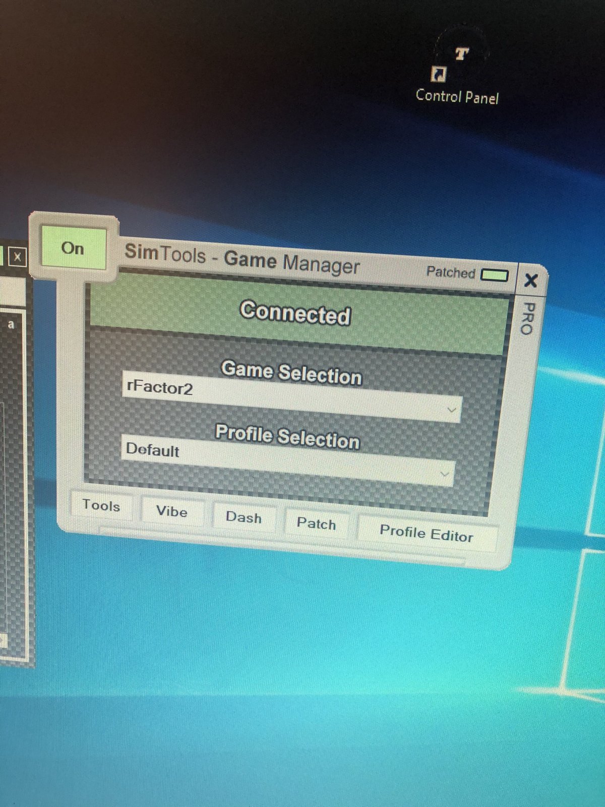

    EAC0EFA5-E0DD-4C3D-8124-EC4B655502BA.jpeg Hi
    In game manager there’s only the default profile. How can I load others profile?
    I have some preset in game engine and I load them, but in game manager I found only the default one

    click on profile editor and then click on editor and you can create and save profiles for the game you have selected

    Sorry I’m missing something.
    So they aren’t the same profile I have created in GameEngine?
    When I load a profile or a preset in game engine then they don’t load in game manager? What’s the point to create a new profile in game manager when I have already profiles or preset in game engine?

    in game engine you define the dofs(roll pitch heave yaw sway surge etc) , the directions for them so you would have correct movements for each dof and how much (%) each dof will use on each axis (motor)
    in game engine we have the tuning center . we create a general profile for each game there and then in game engine - profile editor we fine tune the particular game for different cars and tracks
    take a look here it explains it better than me https://www.xsimulator.net/community/faq/steps-to-create-a-motion-profile.228/
    https://www.xsimulator.net/community/faq/tuning-centre-and-axis-settings.240/

    GameManger has live 'Profiles' that alter you Min / Max settings on the fly for the game.
    (This allows you to tune in other vehicles.)
    Game Engine only has 'Presets' that help you with setup.
    For instance a friend uses the same interface as i do, so i make a preset and send it to him to load.
    This Preset only helps him get setup, and is not used live like a GameManger profile is.
    Hope this helps,
