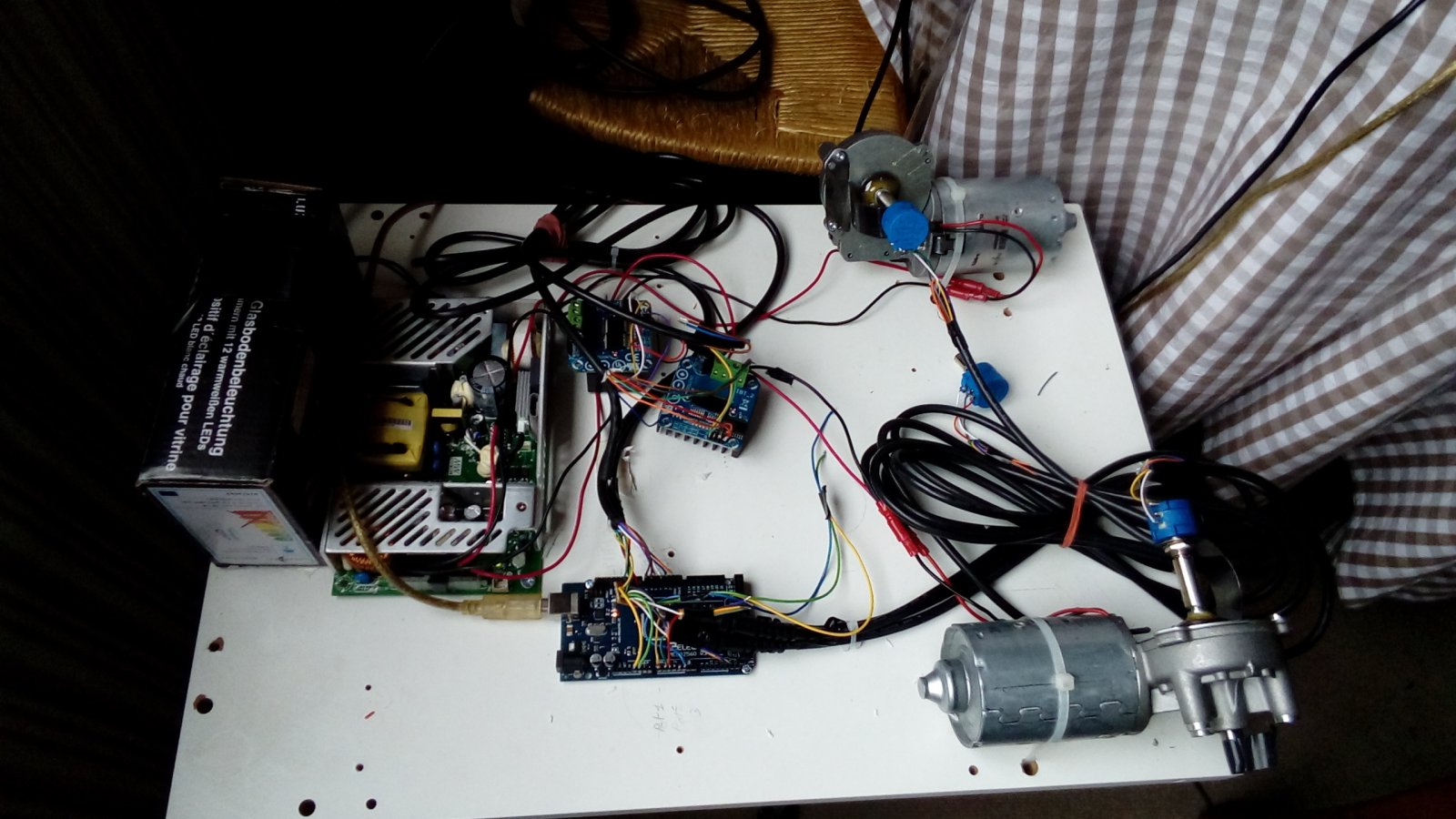

    Hello friends,
    I realized a test plate to test different piloting technology:
    -Arduino mega
    -Motomonster
    -Ibt_2
    -Potentiometer 10 turns 10k cermet
    -SMC3
    But I have problems otherwise it would not be funny. With basic programs no worries, I manage to control the differences cards as well as the engines. But I can not start the engines with SMC3 on my Arduino mega, nor even SMC3 utils.
    And I do not know how to modify all that.

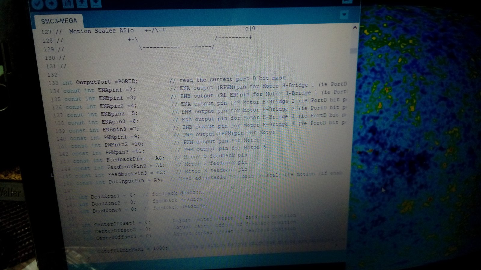

    I use pins 2,3 and 9 with the IBT_2 card
    mode2
    pin2 for RPWN that allows the reversal of meaning
    pin3 for R & L_EN which is connected to the 2 pads ENABLE of the card IBT_2
    pin9 for LPWN which gives the PWM signal.
    Engine 1 on ON
    I see the signal of the potentiometer on SMC3 utils which induces a pulse PWM on the graph
    But pin3 for R & L_EN is still at 0

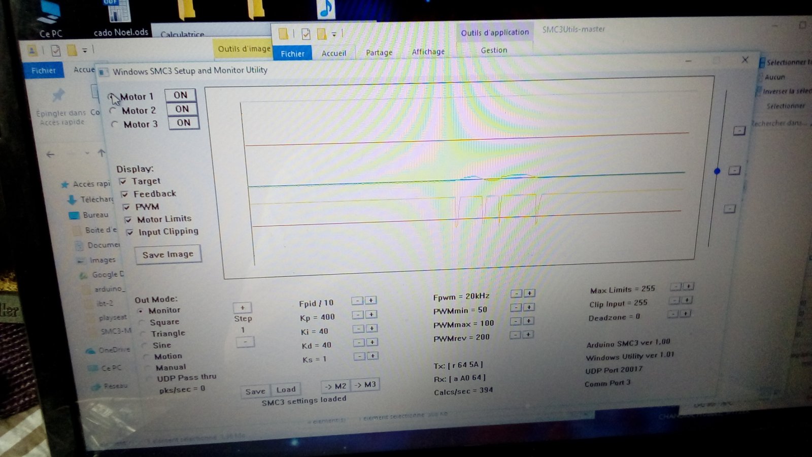

    Je vois le signal du potentiometre sur SMC3 utils qui induit une impulsion PWM sur le graphe
    Mais pin3 pour R&L_EN est toujours à 0

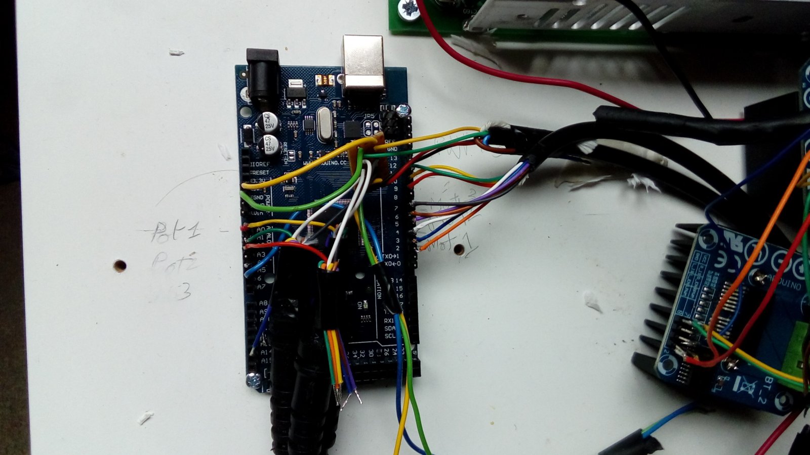

    My proto-plate !!!:thumbs

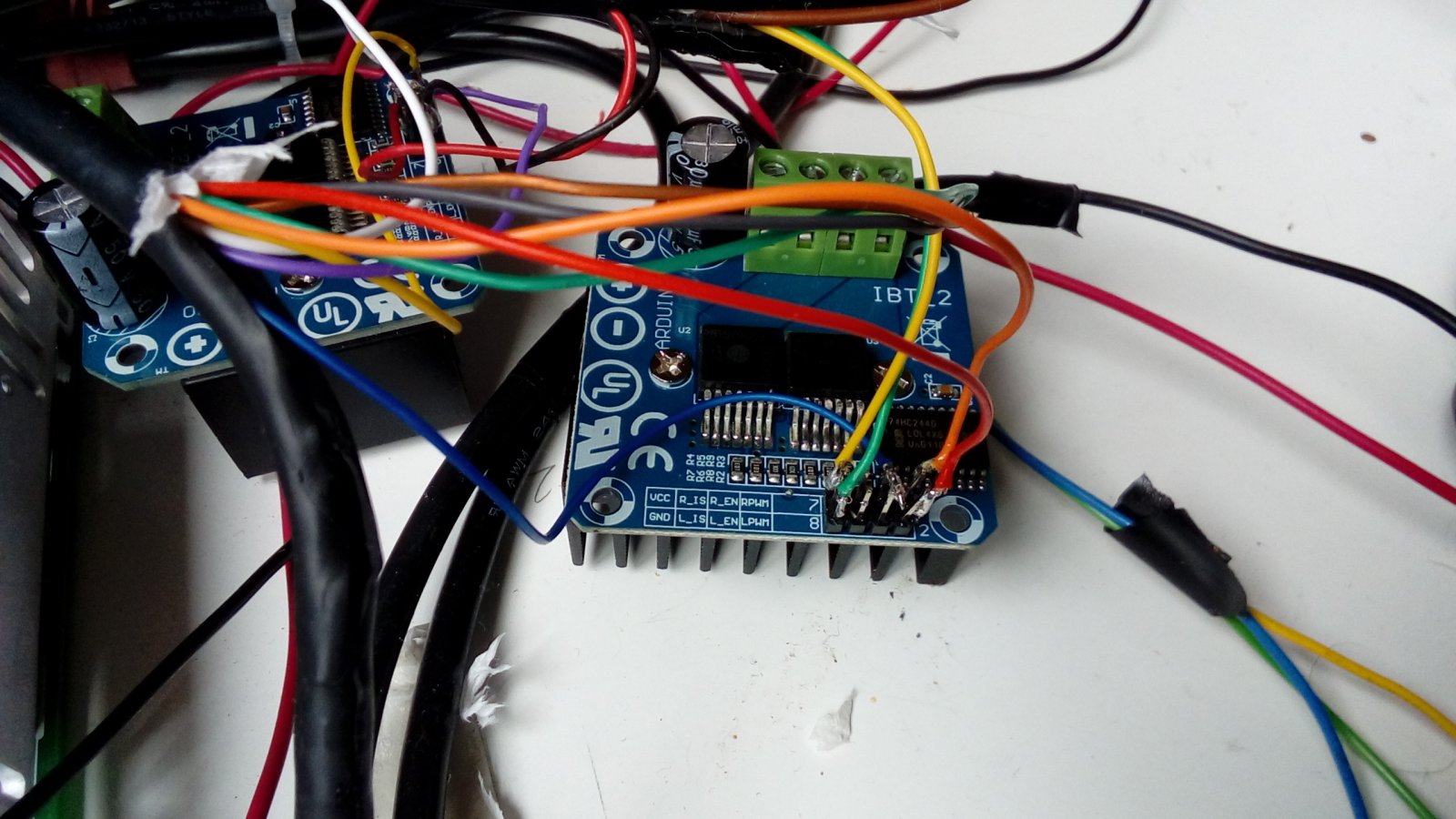

    my wiring between Arduino and IBT_2

    my Arduino assignation pin with mode 2 define
    my SMC3 utils view… This is cardiac arrest :grin

    RufusDufus has stated that the EN pins are always high during operation so you should be able to tie them directly to +5v instead of pin 3 (at least for testing your ibt-2).

    you're right I'll try to connect them to the 5v and I will give you my feedback.
    Edit: I tested the mount with a basic program, actually pin 3 on 5v still work well.
    But not on smc3 utils.
