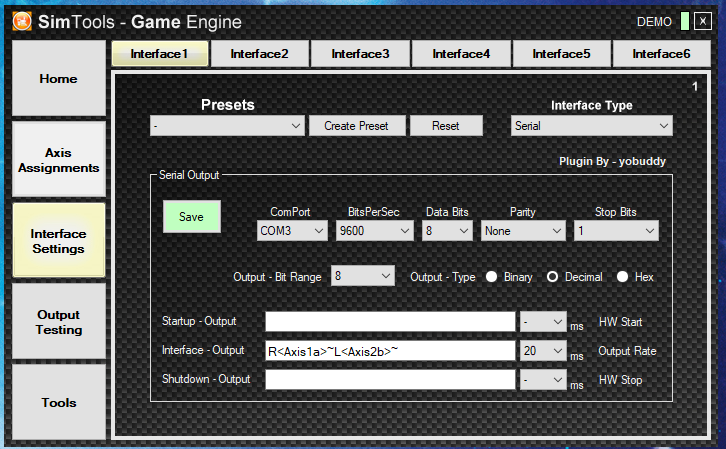

  9. xiatian
    xiatian Member
    Sep 5, 2017
    78
    Xi'an, China
    262Coins
    +28 / 0 / -0

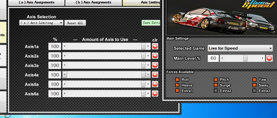

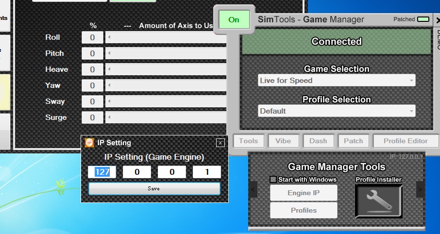

    This is my setting
    IP address should be set too

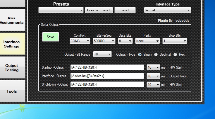

    Try switching to Decimal vs Binary

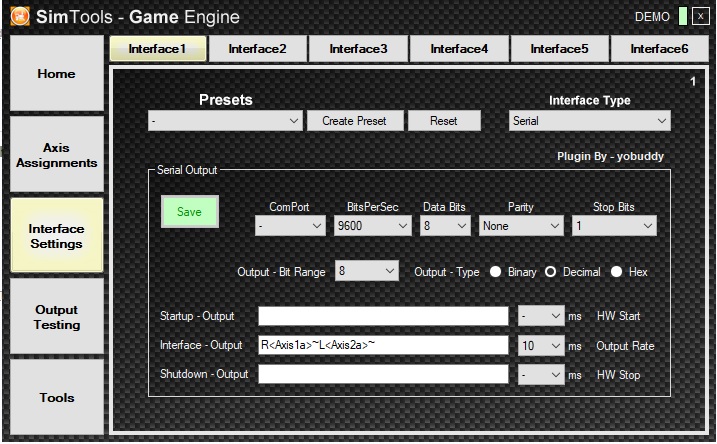

  14. phreezee
    phreezee Member
    Jan 25, 2018
    61
    IT Guy
    Canada
    425Coins
    +24 / 0 / -0
    @Marc R these were the settings I used. Interface - output R<Axis1a>~L<Axis2a>~B<Axis3a>~
