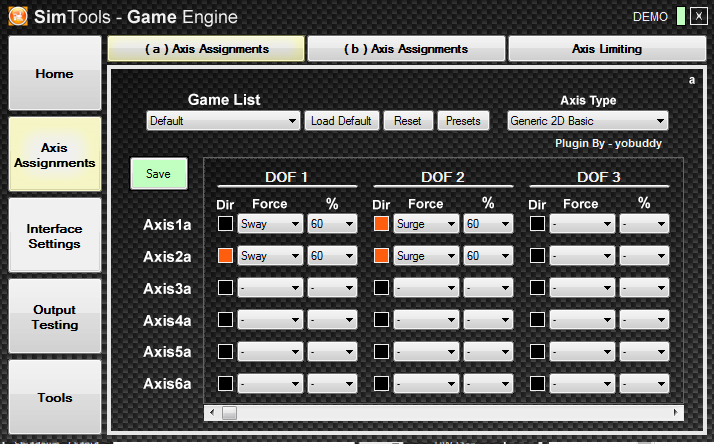

    ok, im planing to use sim tools 2 for my actual project and let see how it will work.
    i will post my project and if i need any help please help me, really appreciate your support always .....
    also thank you for regarding licence information as well..
    Cheers.....

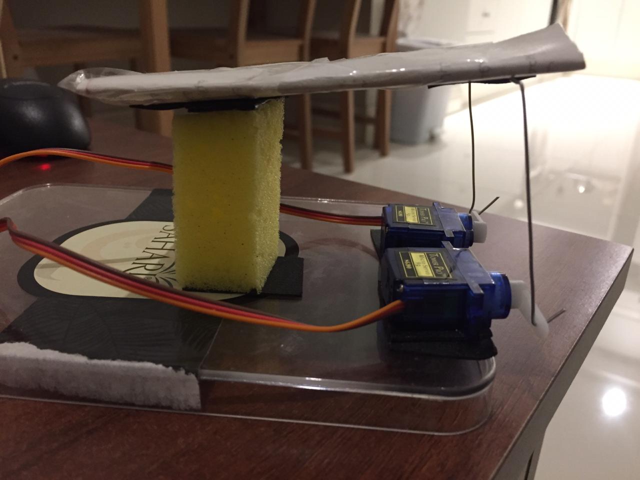

    hi
    i already test my motors and sim tools setting with RC motors and it work perfectly..
    this is really good and i can play around settings of sim tools.
    this is really good chance learn about sim tools before actual build.
    thanks ....

    this is the my test with RC motors, It is working well.
    any suggestion most welcome..
    thanks ...

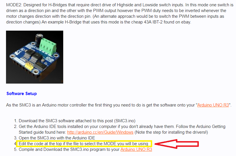

  6. Pramuuditha Kumara
    Pramuuditha Kumara Member
    Jan 6, 2019
    51
    61Coins
    +4 / 1 / -0

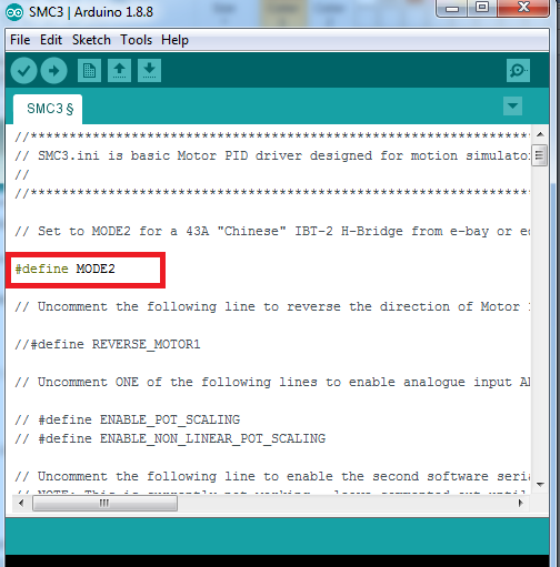

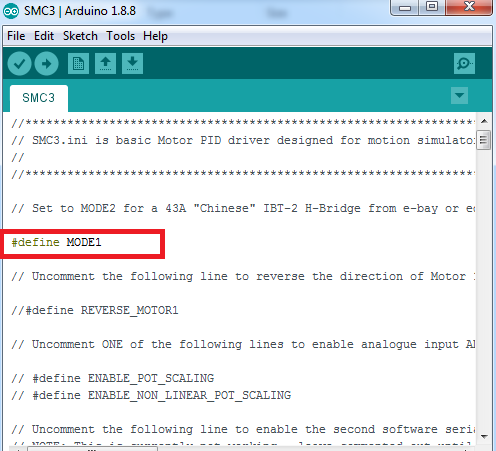

    but i have doubt about changing the code for selected mode, how can i do this according to my hardware.
    if any one can explain this, really thankful...
    also is there any suggestion about my hardware and plan most welcome...

  7. BlazinH
    BlazinH Well-Known Member
    Oct 19, 2013
    2,145
    Oklahoma City, USA
    16,691Coins
    +1,839 / 32 / -1
    A few lines down from the top of the sketch look for #define MODE1 and change 1 to 2.
  8. Pramuuditha Kumara
    Jan 6, 2019
    51
    61Coins
    +4 / 1 / -0
    Thank you for your reply.
    to
    is it correct what i have done..?
  9. Pramuuditha Kumara
    Jan 6, 2019
    51
    61Coins
    +4 / 1 / -0
    i have followed and i connected SMC with Arduino
    if someone can conform this is correct or no ...
    thanks ..

  10. BlazinH
    Oct 19, 2013
    2,145
    Oklahoma City, USA
    16,691Coins
    +1,839 / 32 / -1
    Yes that's correct.

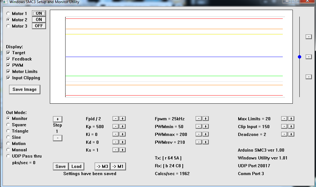

  12. Pramuuditha Kumara
    Jan 6, 2019
    51
    61Coins
    +4 / 1 / -0

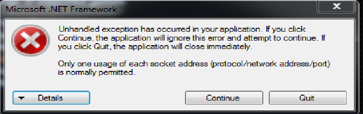

    hi
    i already tested my motors with SMC and sittings changes like this.

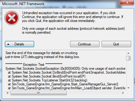

    then i was trying to setup sim tools, but im not able open sim tool and when i open there is error
    can someone help me with this, how can i fix this issue...

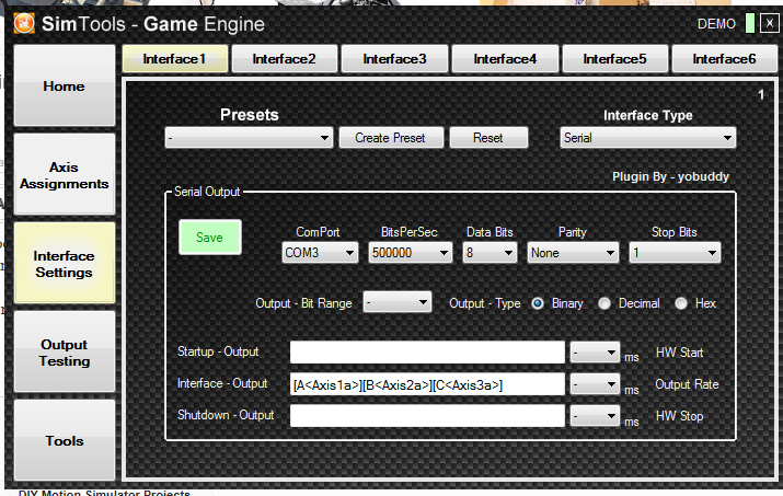

  13. Pramuuditha Kumara
    Jan 6, 2019
    51
    61Coins
    +4 / 1 / -0

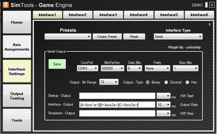

    even sim tools open, im not able to open interface settings, when i hit interface settings same error will pop up.
    this is the error
    Please help.....

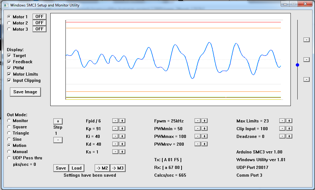

  14. Pramuuditha Kumara
    Jan 6, 2019
    51
    61Coins
    +4 / 1 / -0
    i uninstalled sim tools 1 and installed sim tools 2. then there was no any error and i can edit interface settings.
    but there was no any changes for out put settings and there no any RX TX feedback on my arduino board.
    here is the my settings.
    Please help me with, when i was testing with RC motors it work fine for me with sim tools 1, but it did not work with sim tools 2.
    but now i cant use sim tool 1 due to error and sim tools 2 is not connecting
    please help, how can i get this fix..
    many thanks..
  15. BlazinH
    Oct 19, 2013
    2,145
    Oklahoma City, USA
    16,691Coins
    +1,839 / 32 / -1
    Interface settings are incomplete. Use 10 for output bit range and 10ms for output rate.

    You can't run smc utilities and Simtools at the same time.
  17. Pramuuditha Kumara
    Jan 6, 2019
    51
    61Coins
    +4 / 1 / -0
    Th
    Thank you very much for your reply,
    yes i was missed output bit and out put rate,
    i changed it and start working now.
    thank you very much....

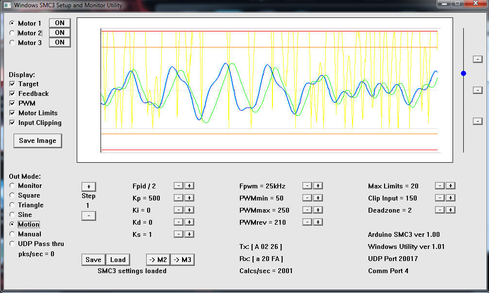

  18. Pramuuditha Kumara
    Jan 6, 2019
    51
    61Coins
    +4 / 1 / -0
    this is the my current settings

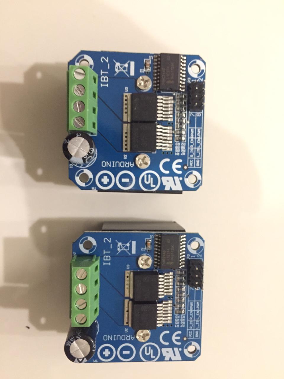

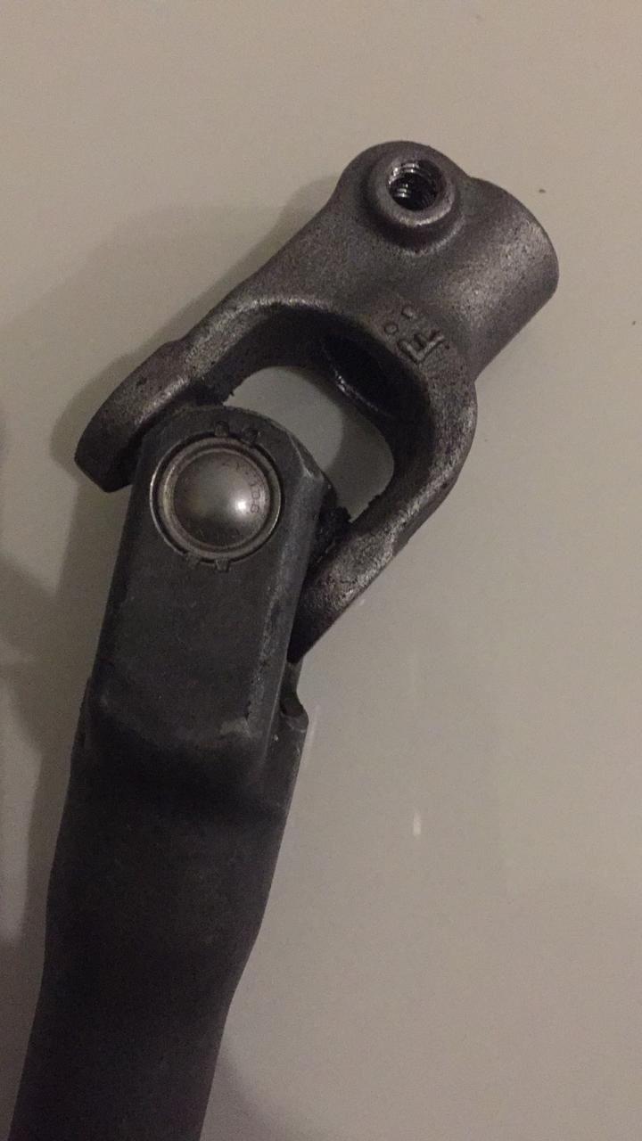

  19. Pramuuditha Kumara
    Jan 6, 2019
    51
    61Coins
    +4 / 1 / -0

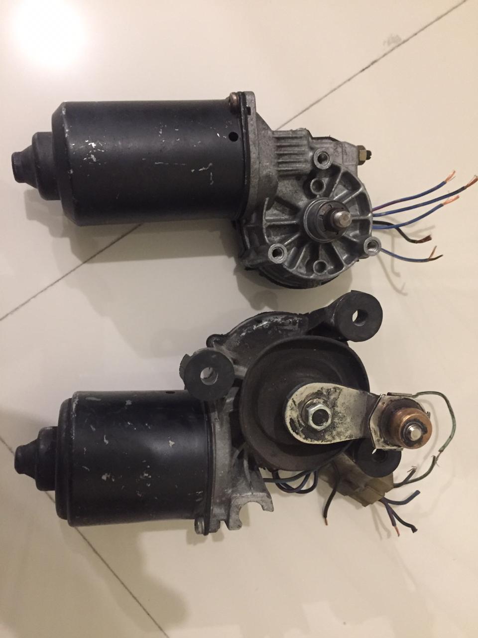

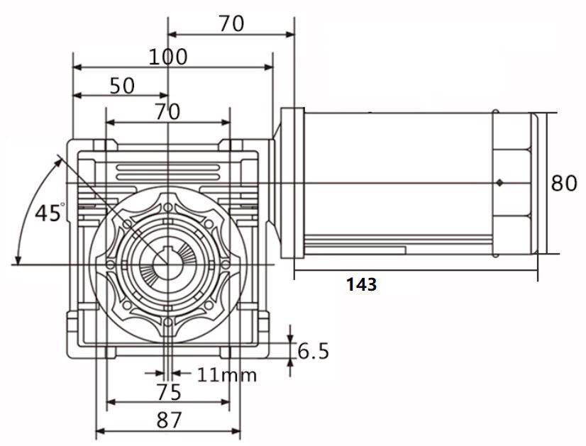

    hi
    im planing to buy
    22. 5 RMP
    Speed ratio 80
    torque 19.1 NM
    i attached the photos for reference
    is this motor work for my simulator ??
  20. Pramuuditha Kumara
    Jan 6, 2019
    51
    61Coins
    +4 / 1 / -0
    updated image of SMC
