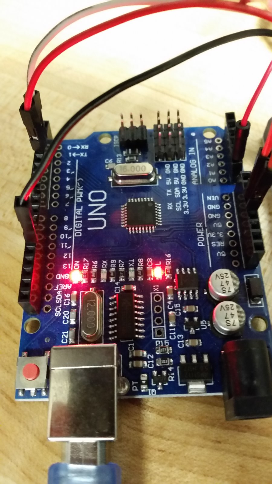

    STEPS THAT WE HAVE DONE SO FAR (What did we miss)

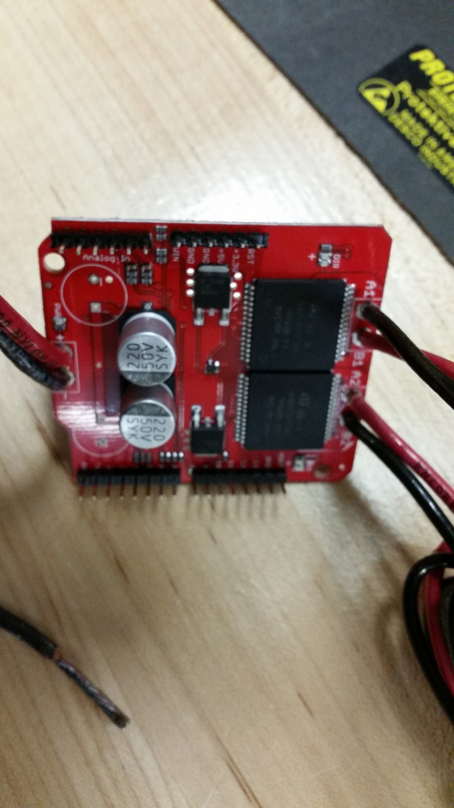

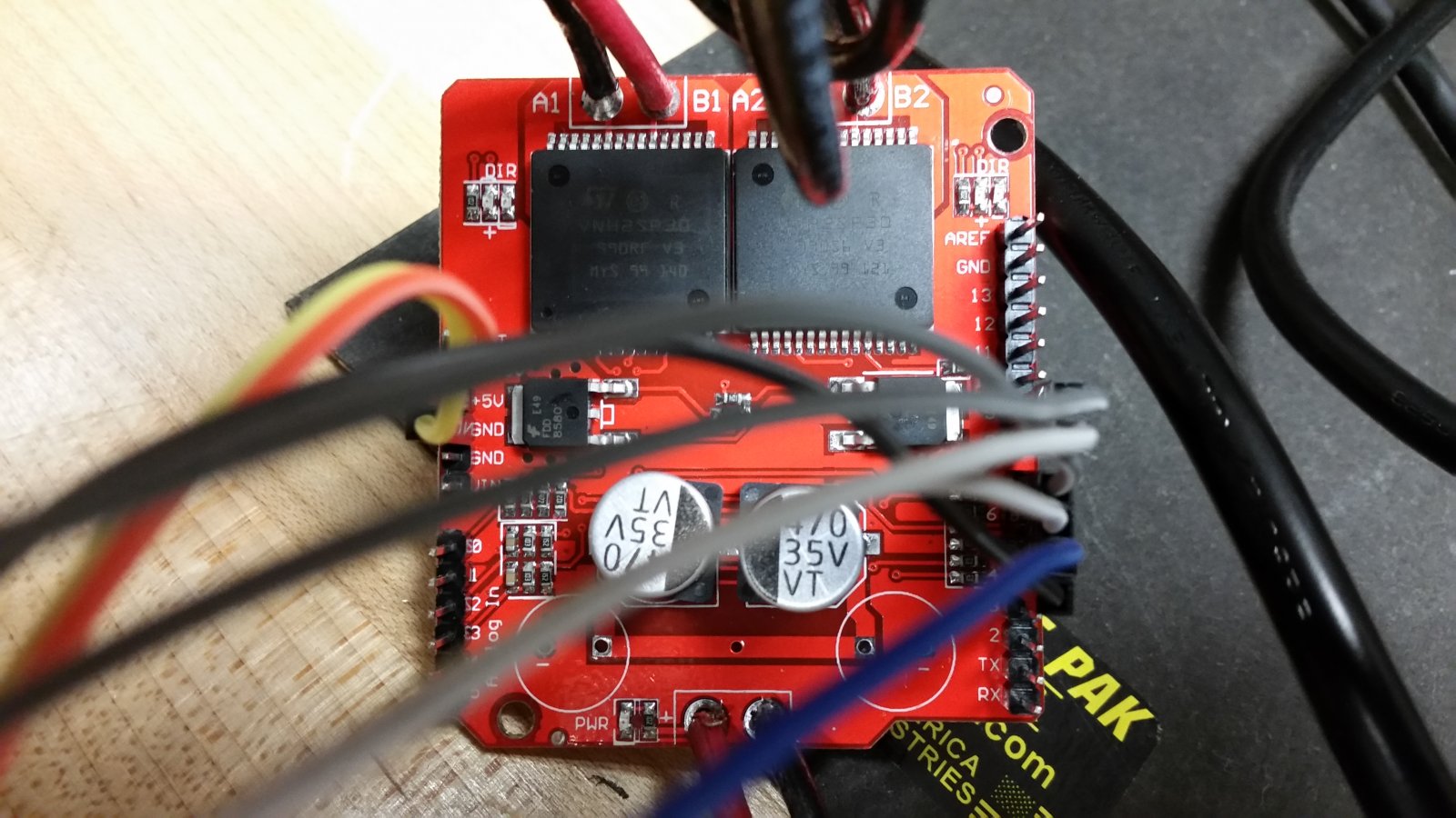

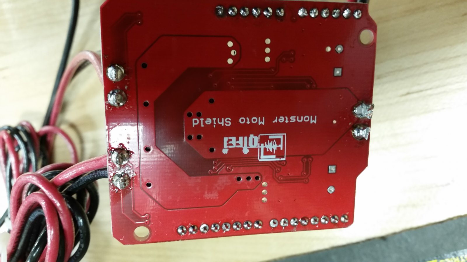

    Here is the setup of the Moto and the Arduino. I will post the wire diagram another day.
    20161101_111006.jpg 20161101_111014.jpg 20161101_111039.jpg 20161101_111104.jpg
    Here is our wiring setup. Some of the connections are split 1 to 2 connectors. Do you see anything wrong with this part?

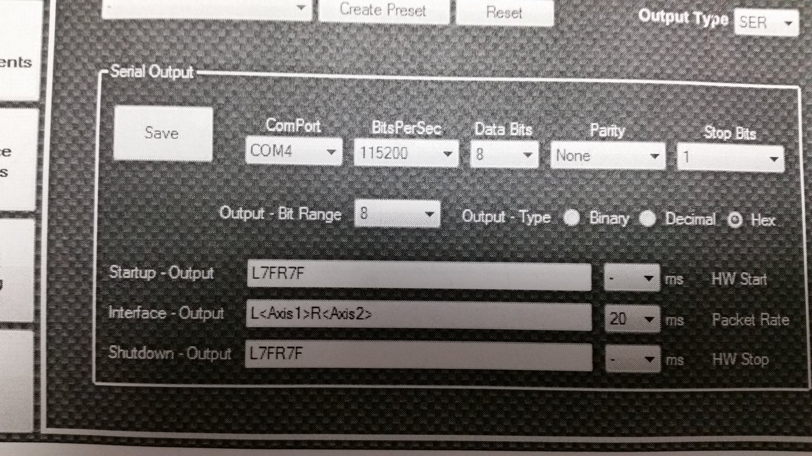

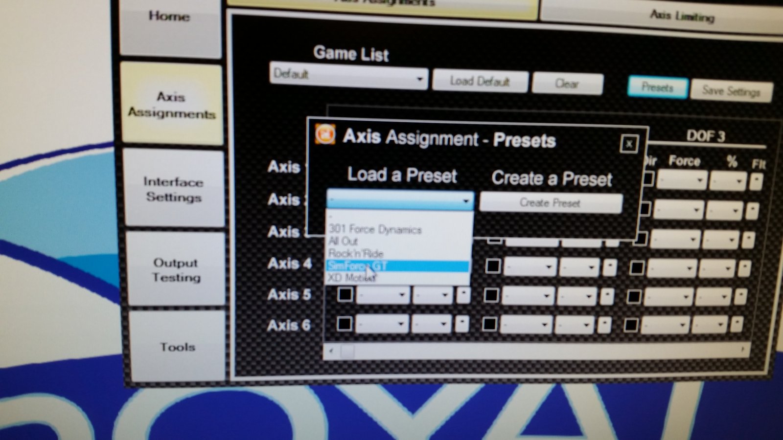

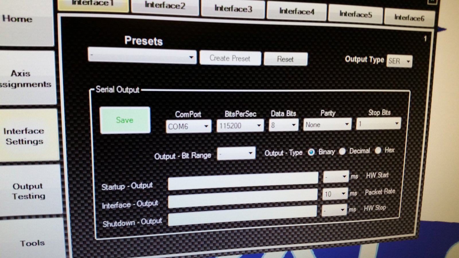

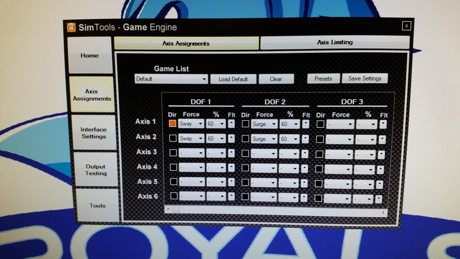

    THE SOFTWARE SETTING
    Please let me know if you see something wrong or missing 20161101_105754.jpg 20161101_105621.jpg This is our screen from page 5 (we selected Default) 20161101_105754.jpg Here we selected SimForce Gt
    20161101_110214.jpg Here we selected com 6 (where the arduino is and setup the rest of settings)
    20161101_105858.jpg Here is where we ran into our first question.Where do we get the output settings (Setup, interface and shutdown)?
    I had problems following the guide from the "under packet rate"section.
    Where are these settings?
    Which value is the 10ms?
    Is it all of them?
    Where is the "speed bar"?
    What preset do I use for the interface?
    What do I use for the preset?
    I appriciate all the help in getting this thing going. Our Motomonster controls 2 motors. Please help me get an understanding on what I missed. The "moving your simulator with mouse" made the sliders move without issues. Help help!

    ok i need clear shots of your pinout on both the arduino and monster moto, side shot maybe its difficult at this angle to see.
    also a screen shot of this showing your settings. these are examples do not copy these settings start as explained in the setup.

    this should be your wiring

    Ok, I will get a picture of the SMC and write out the pinouts. Is there a better picture of this anywhere? I followed the steps but, a picture is worth a thousand words. I just can't zoom in enough to see where the stuff goes to validate my work.

    your wiring should match the diagram exactly.

    @bruce stephen, now that is a beautiful picture, I can see all of the connections clearly! You are my hero. Ok I am going to rewire that whole thing again to match the drawing. Then, do we want to work with my settings in Simtools or SMC? I didn't do much in smc but, I followed the whole thing in Simtools.

    re wire, then smc3. it has to move in smc3 before simtools

    @bruce stephen @noorbeast and the rest of the forum.....We HAVE Motion!!!
    Thanks for the drawing, with an up close picture I was able to identify two mistakes in my wiring. We took the SMC3 to the recommended levels an were able to read Voltage. I then took a set of windshield wiper motors and wired them in place of the volt meters. They work!

    Now that we know that the wiring and the hardware work, can someone please assist me on what I am missing from the SIM TOOLS setup? At the top of this post is some pictures of the setup.
    Are we setup good so far?
    Can someone please clarify on what to do on the last picture (where I have hand written makings) I am not sure what to do with that section. It is the area where I posted these questions:

  17. noorbeast
    21,643
    151,516Coins
    +11,041 / 56 / -2
    The written section you posted actually relates to SCN actuators, so is totally irrelevant to what you are doing, as what it describes is only visible if you have SCN selected as the Output Type.

    Ok, super I ran the simtools. The only question is in the guide where it says to untick and input the values. Are those values supposed to be at the top or do they replace the values on the bottom that where put in there with the "Capture Max Min"?
