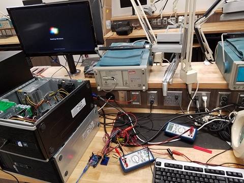

    Help Help Help
    I have the moto monster wired according to SMC3 Ardiono 3DOF Motor Driver Utilities. I ran the setup in Axis assignments. I can do the slider test using the mouse.
    I am lost on what is next and how to get the setup to actually work. The Arduino and the Moto monster are wired. I have a 12volt Power supply connected as well as two volt meters for the motor outputs...nothing happens.
    What did I miss? What's next?

    post pics of your settings. have you patched the game you are using? So it moves with default profile in output testing?
    Edit: have you gone into SMC3 utils config and entered the proper com port?
    Have you gotten movement in the SMC3 application?

    I configured the application from the simtools quick start as follows:
    Select a preset: SIMFORCE GT
    Arduino game engine interface has Com6, 115200 data bits 8 stp 1
    output 8
    I was able to "Moving your simulator with mouse" the sliders moved but the voltmeters showed no differences.
    Is there some screens or wire setup that you want to see to assist in the troubleshooting? @bruce stephen
    The wiring was done to match Tutorial SMC 3 Arduino 3DOF Motor DRiver and Windows Utilites guide page 3.

    Today I downloaded the Arduaino IDE tools
    I reconfigured the SMC tools config file to show com port 5
    I downloaded the arduiono files and ran them in the Arduino IDE tools(uploaded them)
    Now the SMC when set to motion makes sine waves
    I think I have all the parts but, I am obviously missing something. Please help. I will be posting some screen shots today to show you guys where we are on this project.

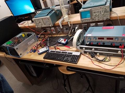

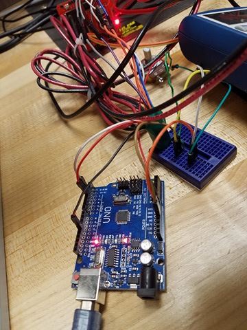

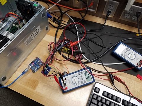

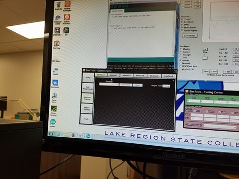

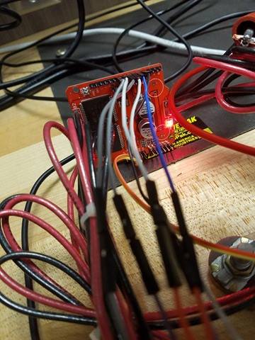

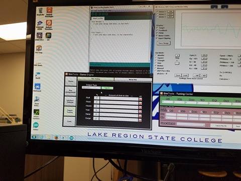

  20. Rudolf Jan Horak
    Rudolf Jan Horak Member
    Jan 26, 2016
    52
    Simulator Maintenance Student
    Devils Lake, ND
    274Coins
    +9 / 1 / -0
    Motion platform
    Here are some pictures that should help guys. Let me know what else you want to see,to help 14875408_10153762555086580_460511204_n.jpg On the upper right you can see the sine wave that started forming.
    14875411_10153762559306580_1555837970_n.jpg This is the setup. Here 14877182_10153762555271580_1250596911_n.jpg The Moto Monster 14877899_10153762554986580_724531104_n.jpg software 14885879_10153762557486580_2123003444_n.jpg 14885946_10153762558866580_1705110268_n.jpg 14914950_10153762555401580_457002412_n.jpg 14936979_10153762558436580_859712129_n.jpg
