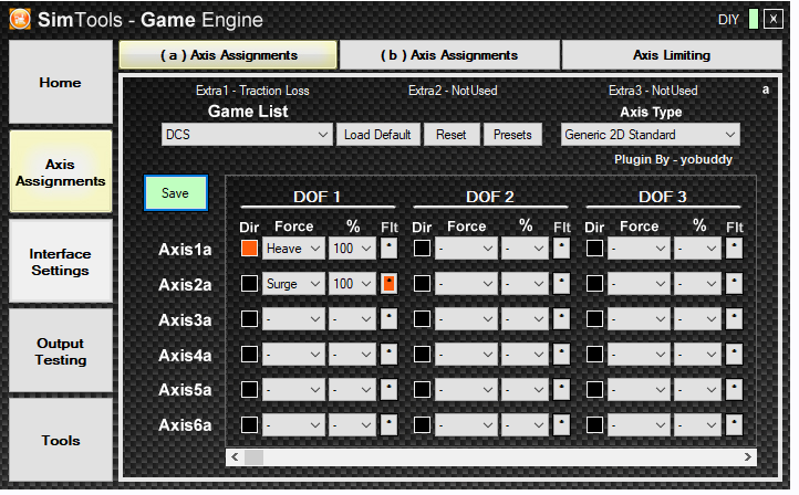

    Hi guys. Progress, bought a simtool and plugin licence. Happy to support you guys and the great work you do. I am running dcs flight sim and have settings for heave and surge. Because I am using servos to compress a bladder I want the servos normal or start position to be fully deflected one way. I altered the arduino code to have there start position at 180 degrees which worked, however as soon as i launched simtools and dcs the servos went back to there mid position. I have searched the forum and cannot find or dont understand a solution. Any ideas. On the plus side I only have one bladder working as I am waiting for more servos to arrive. However even with one working the added sensation of climbing i.e. positive g is impressive. Thanks
    21,725
    152,063Coins
    +11,065 / 56 / -2
    A couple of things you can try in the FAQs, to prevent negative values and movement take @yobuddy's advice and allocate a '0' for the min value for the likes of Sway and Roll.
    And there is @Jumping Coin's modified code.

    Thanks for the replys guys. Used jumping coins code to get full travel from 0 to 180. Got surge pretty well dialled in using the gain adjustment in simtools. Struggling a bit to get heave working to simulate g in a banked turn (pulling back on the stick). I am getting full deflection on the servo at about 2g was trying to adjust this to get full deflection at about 7g. Am i correct in trying to adjust this with the gain adjustment in sim tools? Anyway making progress and learning as I go. Couldnt do this without you. Thanks again for all the support.
  12. noorbeast
    21,725
    152,063Coins
    +11,065 / 56 / -2
    It would likely help if you post pictures of your settings and outline what you are trying to do.
    Generally Gain is how much the rig will react to changes in the input from the game. But when you say 'full deflection' it sounds more like an issue with axis range, is that what you mean? If so that is likely a combination of Axis Allocation and Tuning Center settings, not Gain.

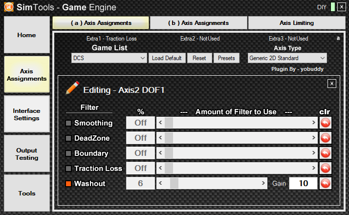

    So reference previous post. I am starting off very simply. Trying to Replicate positive g and acceleration in DCS flight sim. Axis assignments are as shown below.
    Am i correct in using heave to replicate positive g force i.e. pulling hard into a turn or loop and surge for acceleration?
    Changed the filter settings for axis 2a surge as below, this got me from hardly any movement in the servo to
    something that is ok for now.
    My problem is in axis 1a Heave, as soon as i pull back on the stick at all, the servo deflects to its full range of motion 180 degrees of travel. Tried changing the gain for this axis to .5 this however just made the servo deflect to half its range under the same g condition in the game.
    So my question is how do I make the heave servo respond more proportionally to g load i.e full deflection of the servo at about 7g not 2g.
    Hope this make sense. Let me know if I need to clarify anything.
    Thanks Guys

    Disregard when I said "Changed the filter settings for axis 2a surge as below, this got me from hardly any movement in the servo to something that is ok for now." Its not correct either. I am getting this servo operating when I am pulling G and not accelerating.
  17. noorbeast
    21,725
    152,063Coins
    +11,065 / 56 / -2
    That is what I thought, what you describe as full deflection is the physical axis range from 0 to 180 degrees.
    Grab a copy of the SmTools manual and keep it handy for reference: https://www.xsimulator.net/community/faq/rtfm-start-with-the-official-simtools-documentation.117/
    Then see the motion profile tuning tips in the FAQs: https://www.xsimulator.net/community/faq/steps-to-create-a-motion-profile.228/
    Keep in mind that the purpose of a motion rig is not really to try and recreate all real world forces, but rather to exploit physiological and psychological processing weaknesses by supplying enough believable cues to have the brain accept something as real, even though you know it is not, with the brain itself filling in gaps that a rig actually can't provide.
    Perceptual context matters. For example IRL if an aircraft is in long sustained dive any unconstrained passengers will experience that as weightlessness, while the strapped in pilot will have the tactile sensation of aircraft movement relative to the seat and harness.
    I say that because your rig can't actually produce 2Gs, let alone sustain 7Gs. But what you can do is trigger cues relating to a gentle turn Vs a sharp turn. Those cues can include mixing roll, pitch, sway, surge and heave within a single axis range (0 to 180 degrees). Fortunately SimTools can mix those on the fly, what matters is refining the motion profile for your rig and you do that by tuning each individually, then turning them all on and tweaking from there. Keep in mind the limits of a single axis range (0 to 180 degrees) may actually be shared between roll, pitch, sway, surge and heave
    You can cheat a bit, even more so for a flight game, by allocating a % total for the axis range that is more than 100% of the actual physical range (0 to 180 degrees), that is because, say for general aviation, it is very unlikely all the mixed axis forces would be at their full % allocated of the actual range at the same time. If you do over allocate an axis range too far SimTools will clip motion, much like a FFB steering wheel will clip feedback if over saturated.
    In some ways building a rig is the easy part, as refining a good motion profile is part science and part art, the latter often influenced by personal preferences, given a motion rig can't actually recreate all real world forces, particularly those that are sustained, and instead must trick the user's brain to fill in the gaps with cleverly crafted cues.

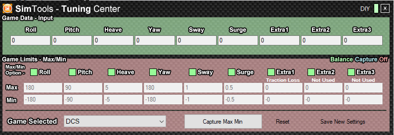

    Thanks for your response noorbeast. I was in the middle of rereading the user manual as you posted. Had a look at the virtual axis screen was getting max deflection in the heave axis with very little stick movement which backed up what i am seeing. Very little movement in the surge axis which also is what i am seeing, so that was good learning. Ran the tuning center and took off with full burner then pulled max g etc. This improved things however I have now gone the other way in heave and cant get full deflection under max g. So making some progress. I take it you cannot manually tweek settings in the tuning center?
    Thanks again for your help. Makes all the difference.

  19. noorbeast
    21,725
    152,063Coins
    +11,065 / 56 / -2
    You can and where necessary should manually tweak TC values, in some case you may want a different Max than Min value for particular types of effects.
    See p.79 of the manual, with the TC check box selecting “green” (Balance also default) makes your max value equal to the opposite min value, selecting “blue” (Capture) captures the max/min values coming from the game, select “red” (Off) if you do not want to change the DOF while capturing live data, or manually set values.
    The higher a TC value the gentler the response, over a greater range, the smaller the value the more aggressive the response, but over less of a movement range.

    That worked a treat noorbeast. After much reading up on the tuning center from your links I ended up with the settings as shown below. Might be a good starting point for the next person trying this type of g seat set up.
    Thanks again guys for all your help. Will hopefully finish up the build over the next few days and will post some pics. Even in this lashed together state of build it is impressive the amount of immersion this adds.
    Obviously am only using and have tested the Heave and Surge settings
