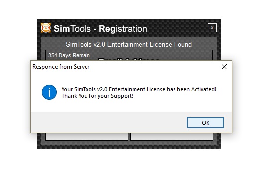

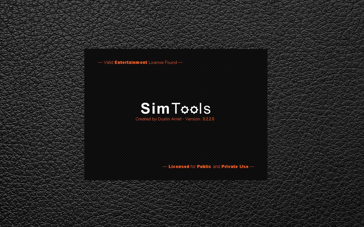

    Simtools well licensed:
    It looks good, but not:
    :sos

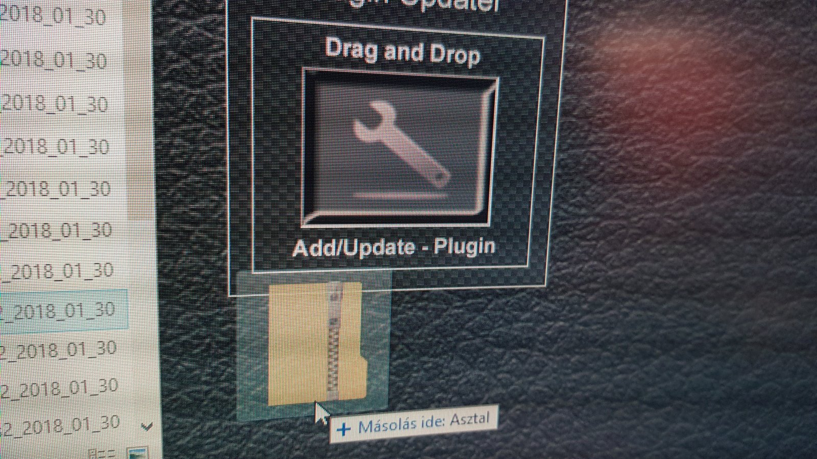

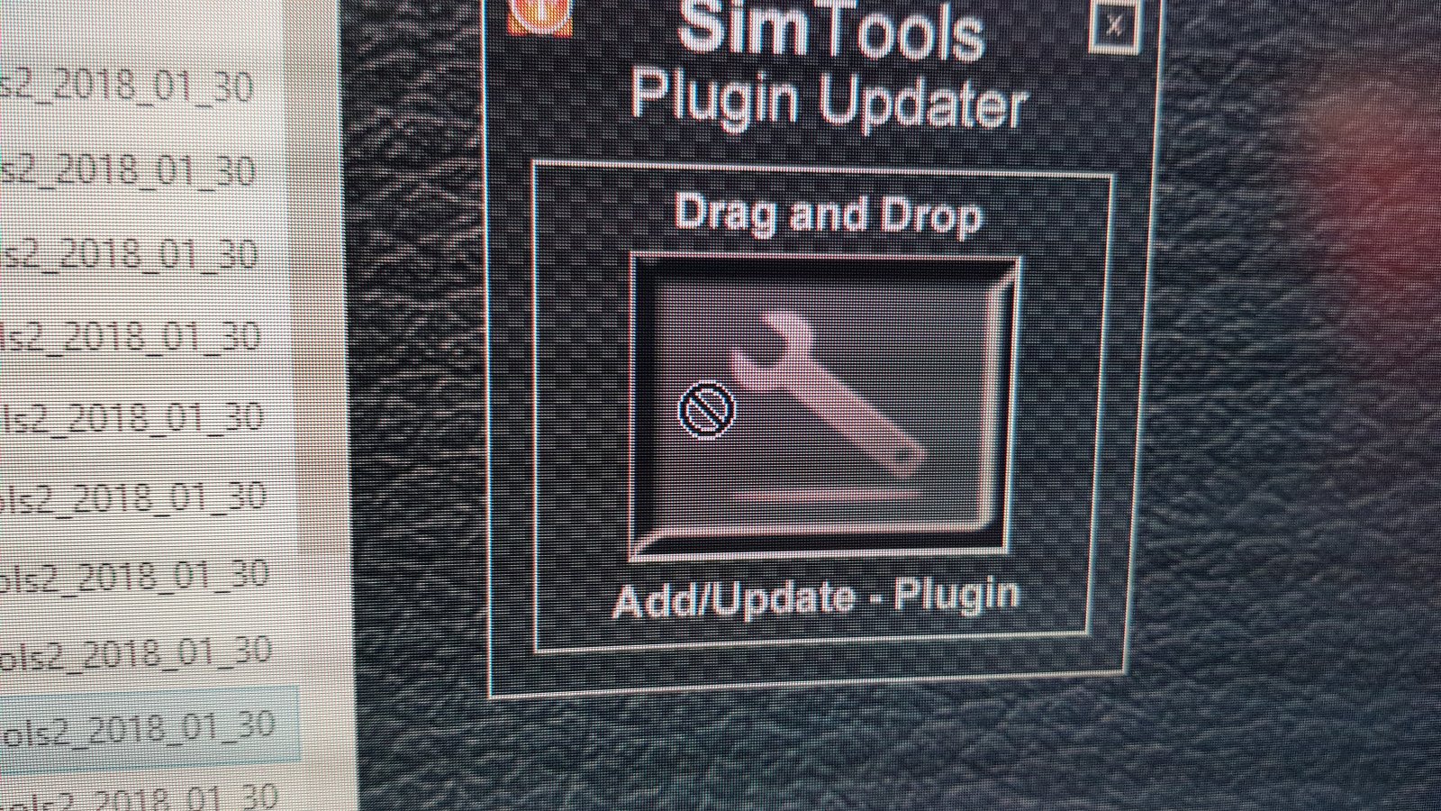

    When I drag zip file and I wanna drop into updater than nothing happens. I got a tipical windows sing (a circle crossed) when I pull over it.
    I have a simtools software as well, but I've never had problem to add any new plugin.... have no idea.

    ok, I cleaned up his pc, removed Simtools and all components of it.
    Just finished with reinstall as administrator. Activation done. It looks everythin ok.
    Closed Simtools software and opened updater.
    tried to drag n drop all of downloaded plugins with same result.
    Same issue.

    You will have this problem If you run the SimTools Plugin Updater as administrator.
    Launch it normally and it will work buddy.

    The 'Drag 'n' 'Drop' not working makes sense when you think about it.
    If the plugin updater is running as admin, it is running above the privilege of the account your using.
    So it blocks the 'Drag 'n' 'Drop' because the current user does not have the same elevated privileges as the plugin updater.
