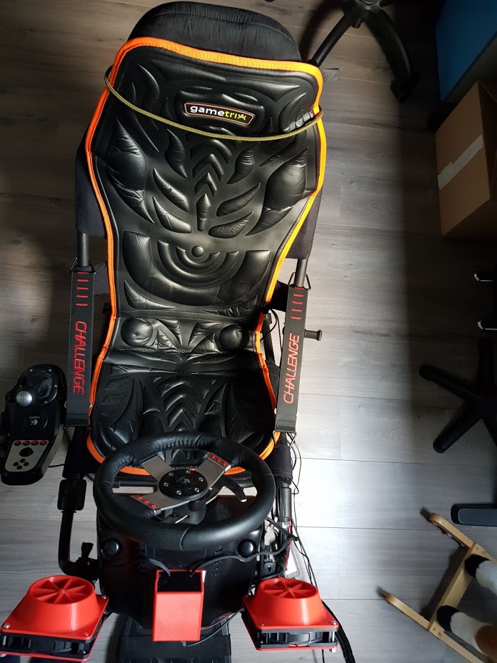

    Hi there,
    I'm a longtime reader of this forum and used this forum for lot of reasearch and ideas.
    Over the past year or so I had to make a choice on a racing rig. Nr 1 on the list was portability and ease of setup.
    Therefore I finaly settled for a ready made chair but to add all my required addons in stages while maintaining portability. For this I chose the Playseat Challange: relatively cheap, good build quality, lots of room to add stuff to it and fully collapsible with everything attached in under a minute.
    Now besides the bare chair I wanted to add the following besides my Logitech G27 with shifter set:
    For the feedback in the chair itself I opted for the Gametrix jetseat
    Everything except G-seat is now in place. The G-seat portion is in the works and all parts are ordered and slowly getting in.. so thought would be time to write up on the how to's..

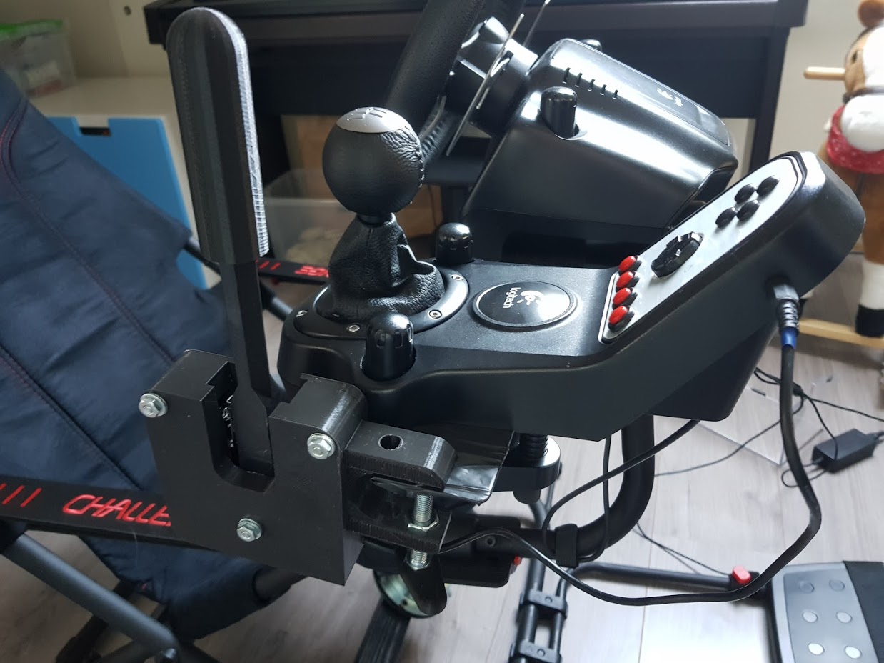

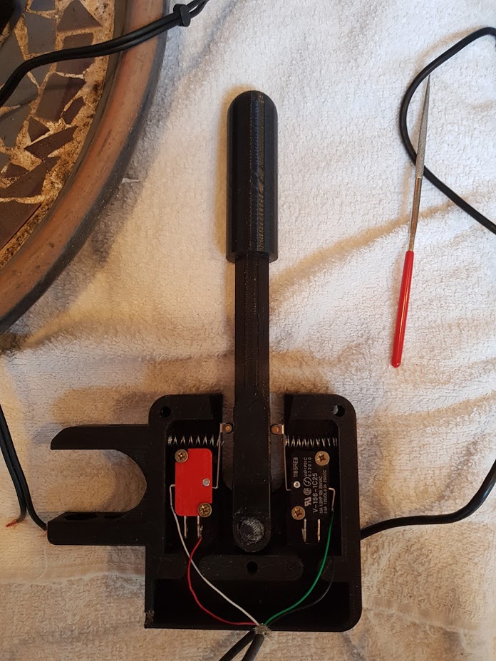

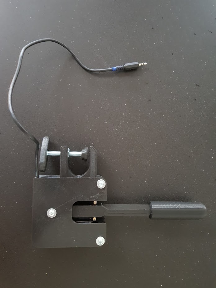

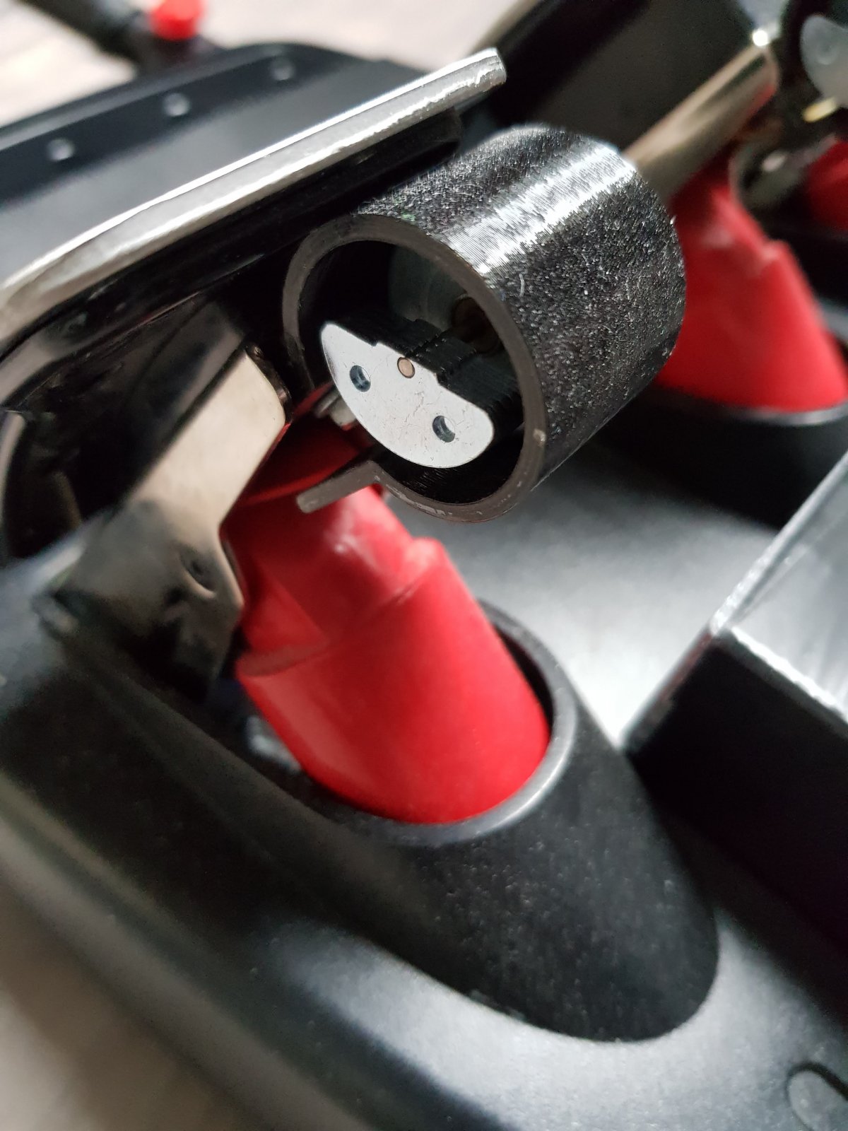

    Part 1: Handbrake for G27
    20171029_151654 - kopie.jpg 20171029_115017 - kopie.jpg 20171029_122538 - kopie.jpg
    3D printer files:
    Electronic/components:
    Instructions
    • Print the 3D files (used PLA, 0.3mm layer height, heigh infill)
    • Add the roller switches and connect them to the 3.5mm male jack connector (see pic for wirediagram)
    • Use the following manual:
      for soldering the connections to the G27 shifter module and instead of a fixed output lead I used the 3.5mm female connector on the side (see first pic on location)

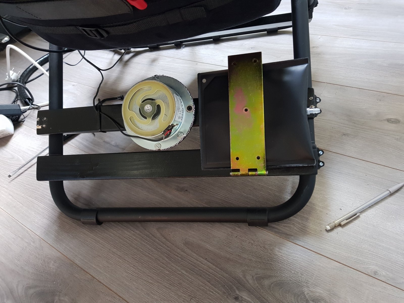

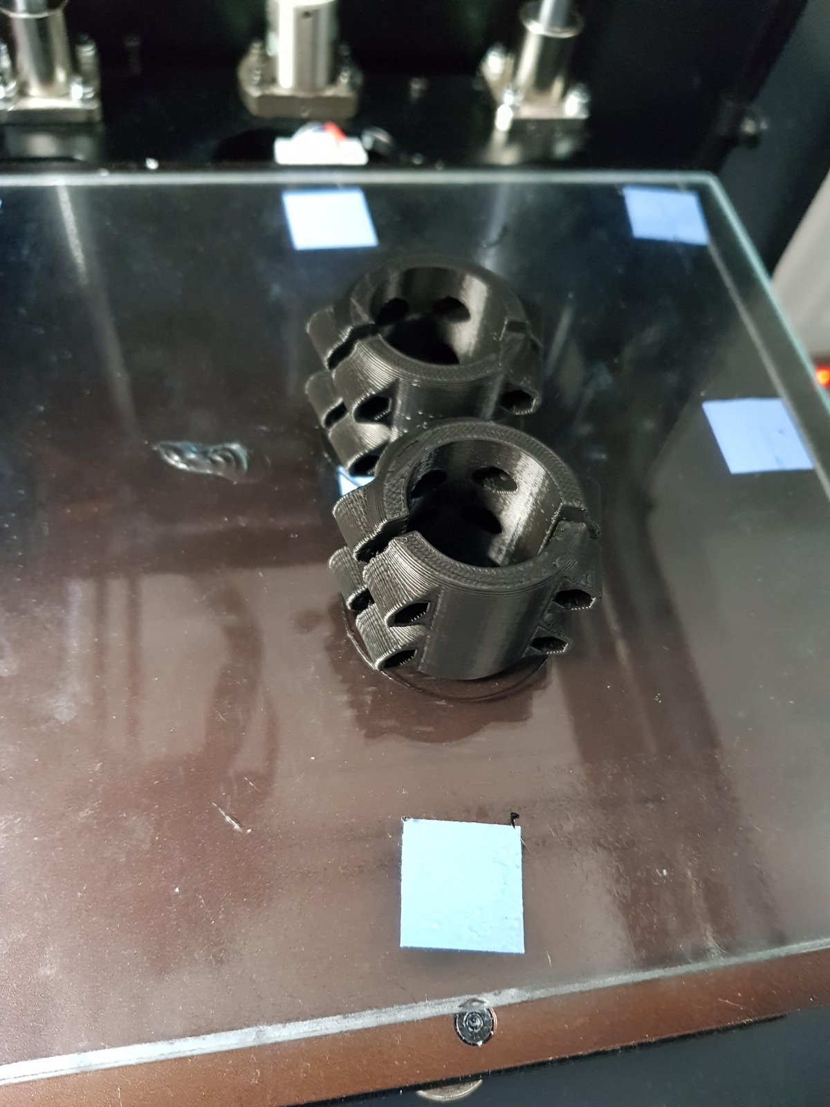

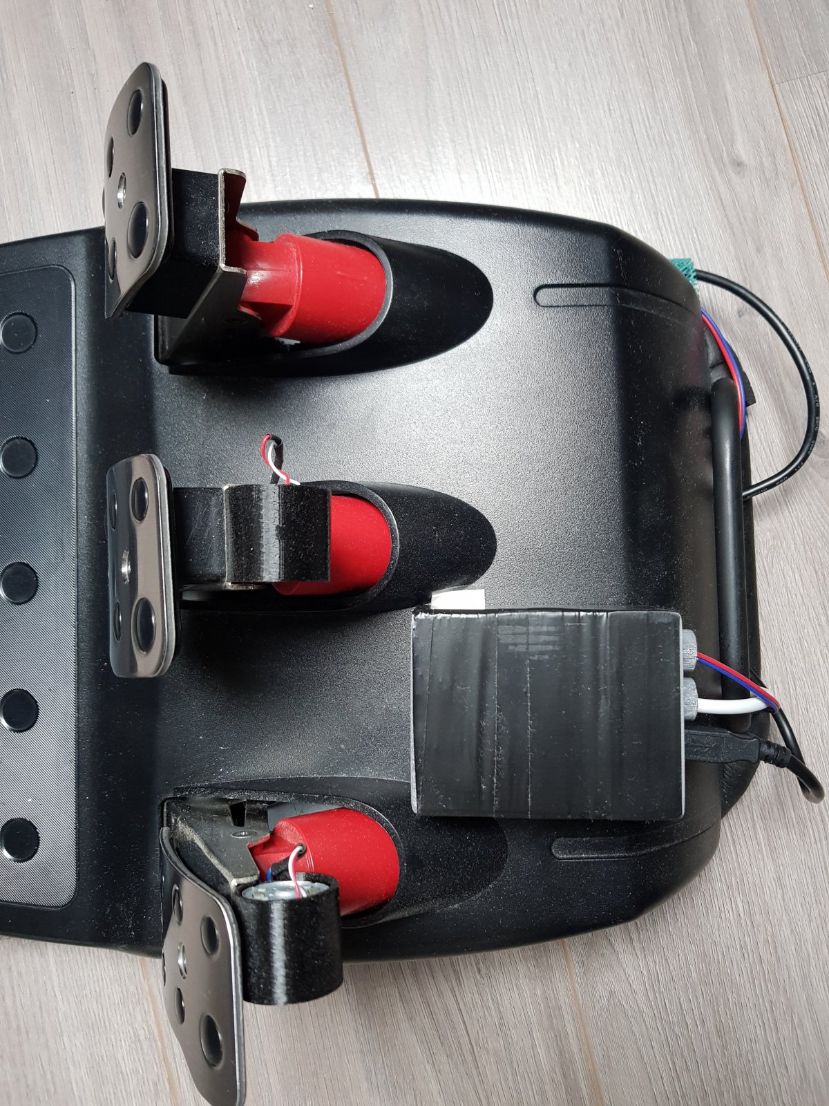

    Part 2: Suspension feedback (buttkickers)
    3D printer files:
    • 2x Transducer
    • 1x amp
    • 2x RCA female connector
    • Speaker cable
    Software/code
    Instructions:

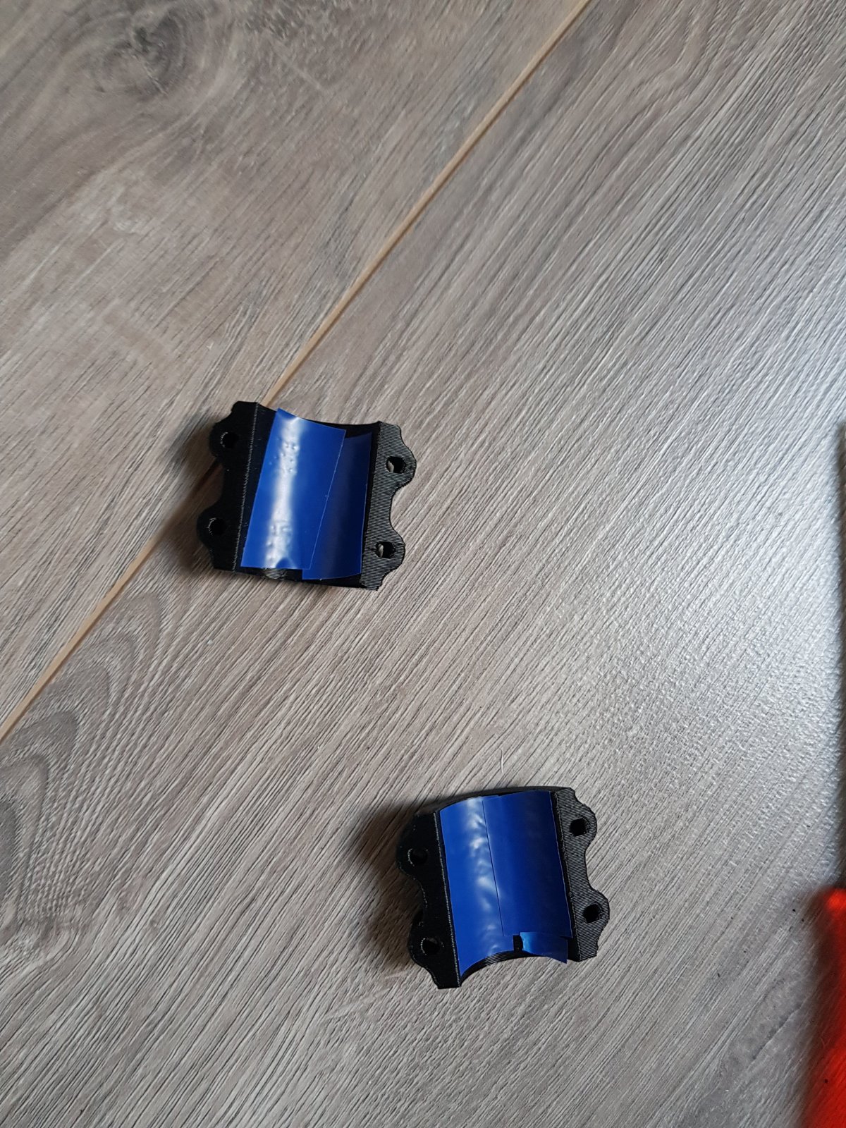

    • Connect a piece of wood to the front and back using the 3D printed connectors as shown in pictures
    • Add the mounting plate to the wood using wood screws
    • Add the transducer as shown to the mounting plate.
    • Solder the speaker cable to the transducer and RCA connectors
    • !! Make sure to watch out for the impedence of the transducters.. Mine got really hot on load and had to run them in parallel instead each channel seperate to reduce heat.

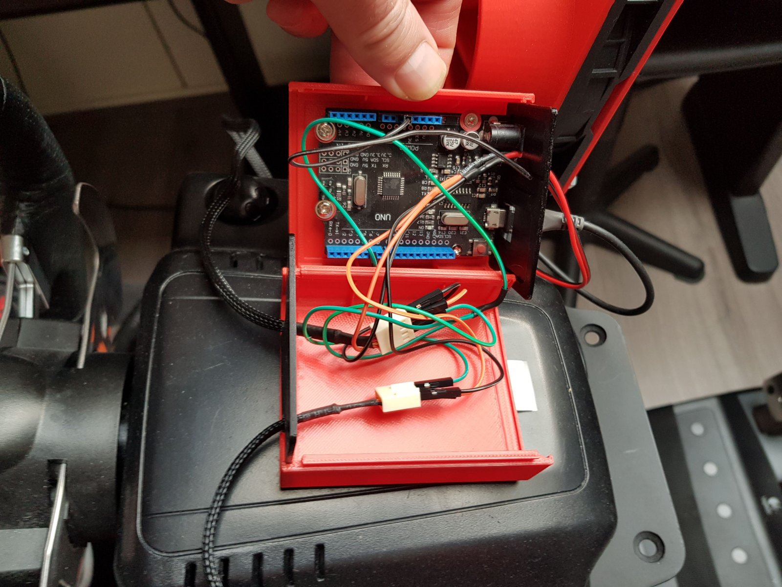

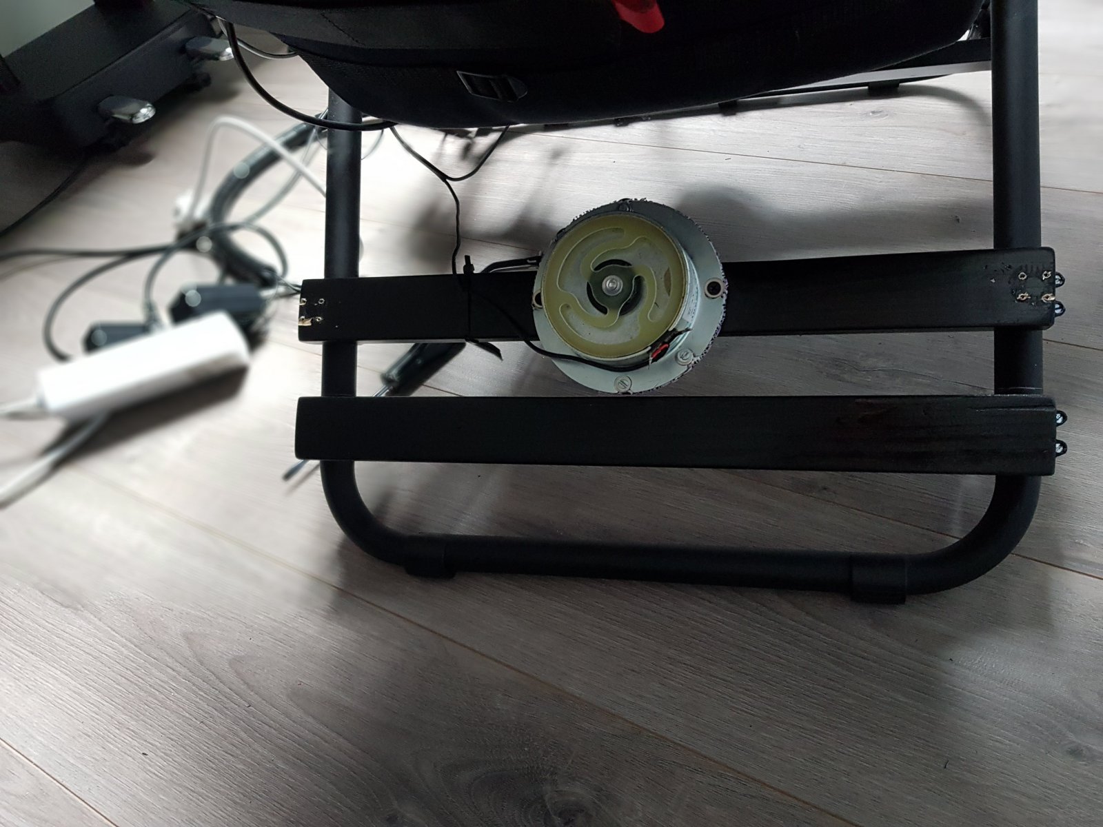

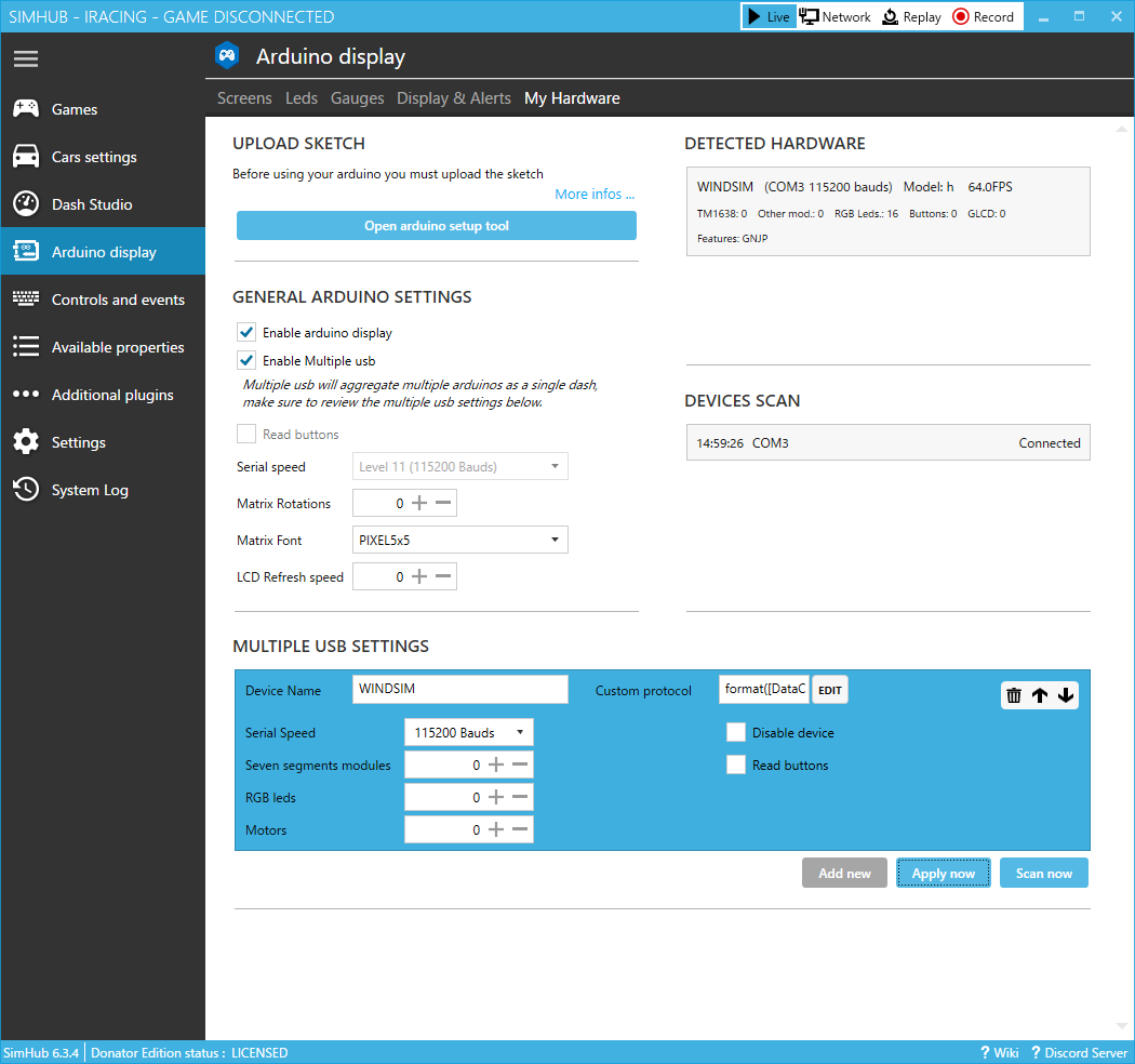

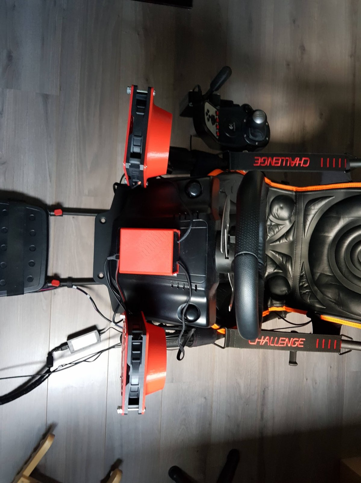

    Part 3: Wind Sim
    20181210_111117.jpg 20181210_111122.jpg 20181210_111127.jpg 20190324_113013 - kopie.jpg
    3D printer files:
    Alternative GoPro mount (not tested myself)
    Software/code:
    Instructions:
    • Print the 3D files (PLA, 0.2mm, 20% infill)
    • For the code and wiring, follow these (https://github.com/kshiba/SimHUB-WindSim-Scketch) instructions
    • The control box where the arduino houses is fixed using double sided tape
    • All USB wiring go to one central USB hub at the bottom front of the chair
    • In SimHub simply add the arduino, call it 'WINDSIM' and set the message binding according to the instructions here

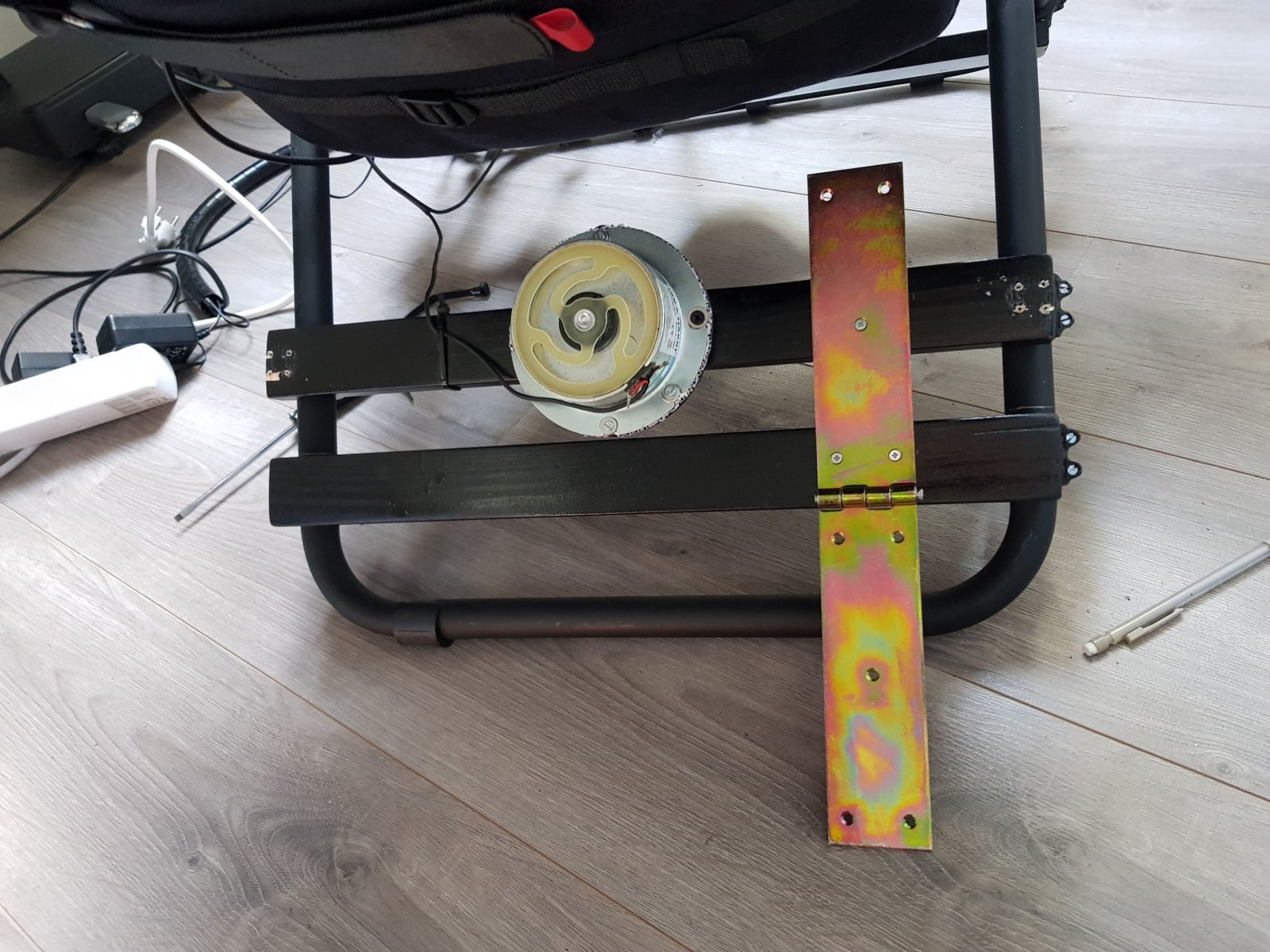

    Part 5: Pneumatic G-seat
    3D printer files:
    Software/code:
    Instructions:
    So this took a bit longer then expected due to getting all the parts in (especially the Chinese ones).
    In the mean time I started designing and printing the electronics housing part and thinking about the placement of all the components on the Playseat Challange.
    For the placement of the servo's and bladders I got to think to place them on the back side of the chair where I have currently one basshaker. To get some more room I will move the crossbar on top instead now below the leggs and add another crossbar to mount the hinges tight. I already printed the connectors and got the crossbar on length and painted.

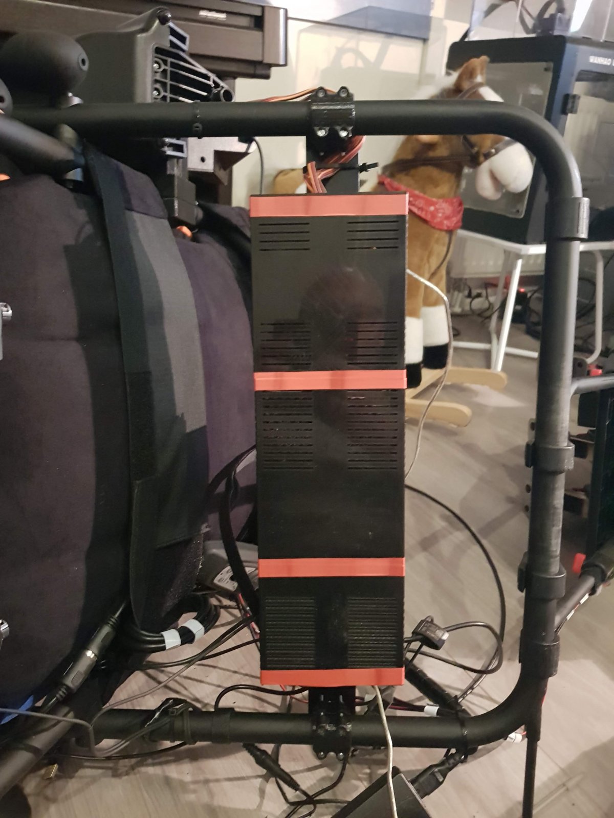

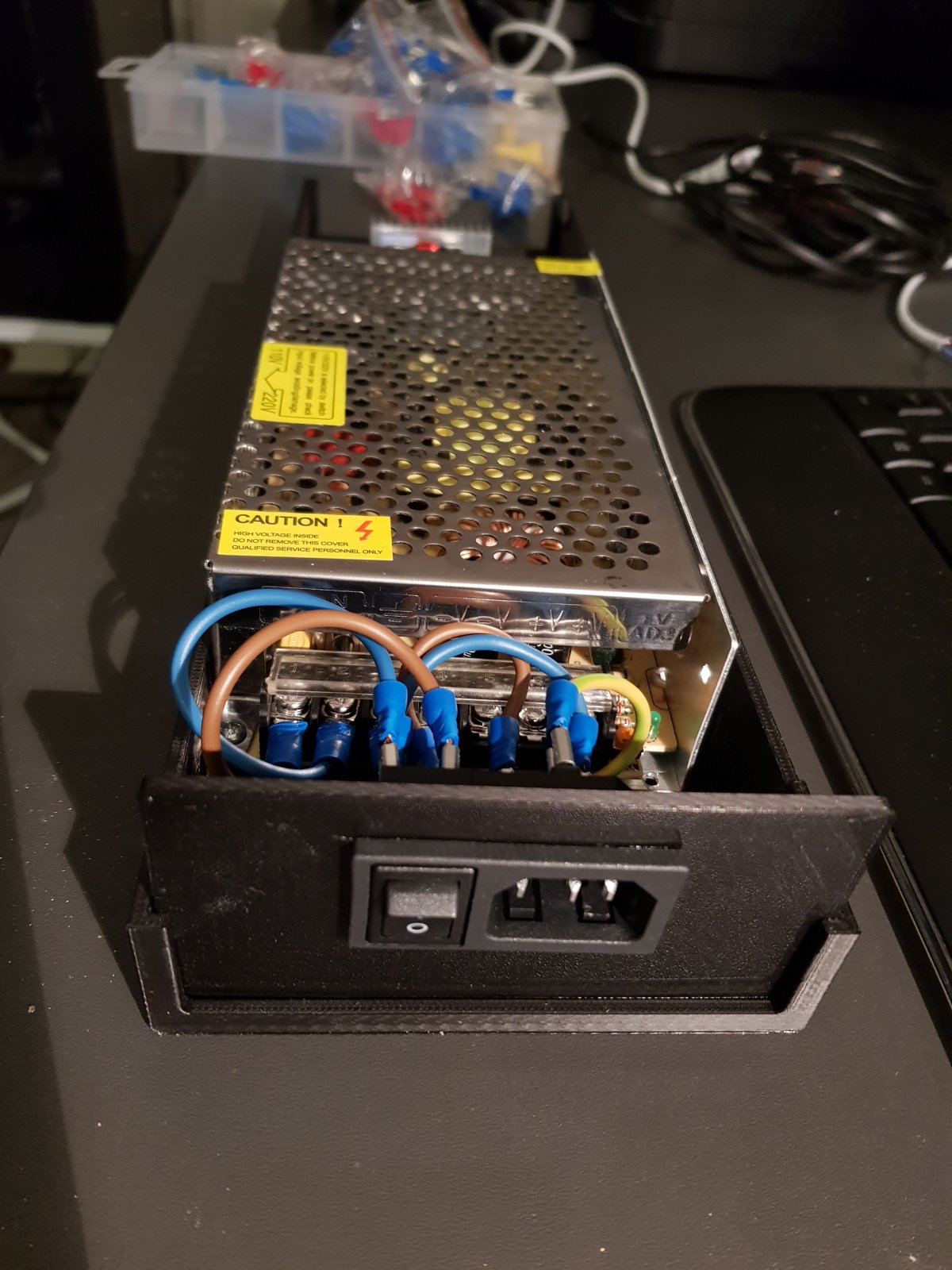

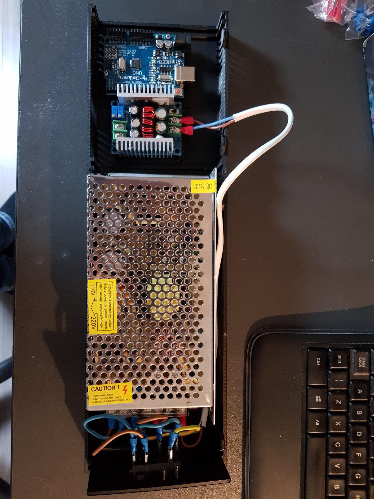

    For the electronics housing I opted for one case with the PSU, DC converter and Arduino integrated. I came up with this:
    Basicly its 3 cases created with The Unlimited Box Maker glued together ;)

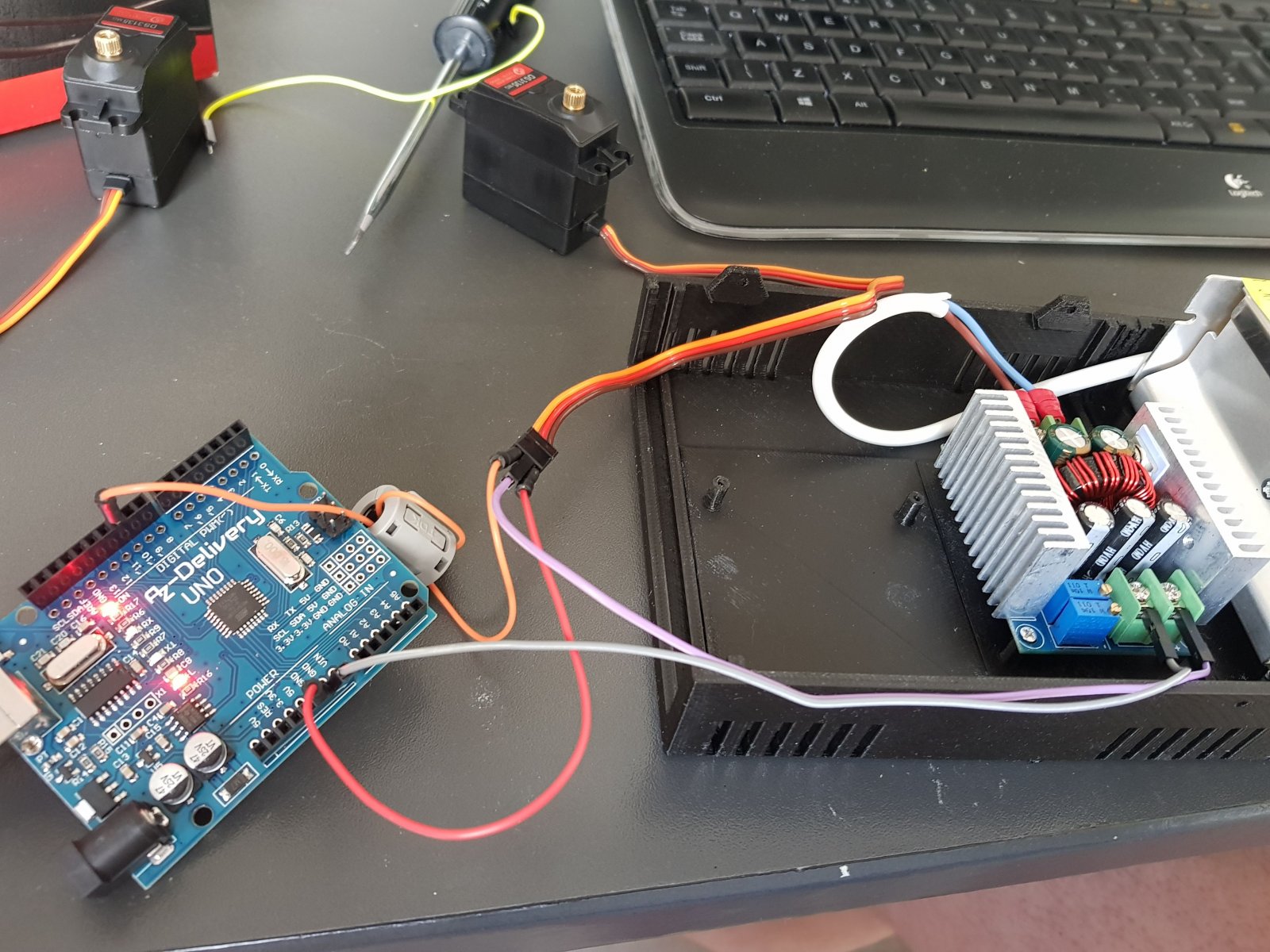

    Now I'm fairly new to all the arduino electronics stuff and just uploaded some code, hooked the servo and... got some weird effects on the servo like jitter.. Now I found a lot of posts on Arduino and servo jitter but no solution initially. Example of my servo jitter
    Till I just found the solution: common ground.. as the servo is powered by my PSU and the Arduino gets the power by the USB port the ground level differs from the pin it gets driven by. Making a common ground between the PSU, Arduino and Servo fixed the annoying jitter issue.
    Now that sorted I just have to get the simtools software to start testing the connections and arduino code.

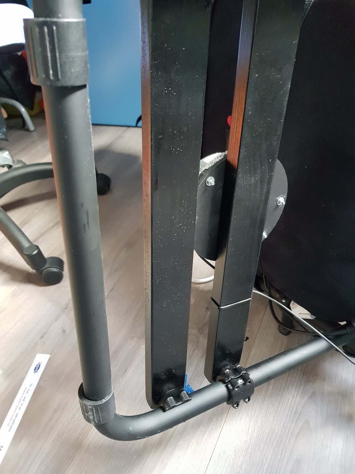

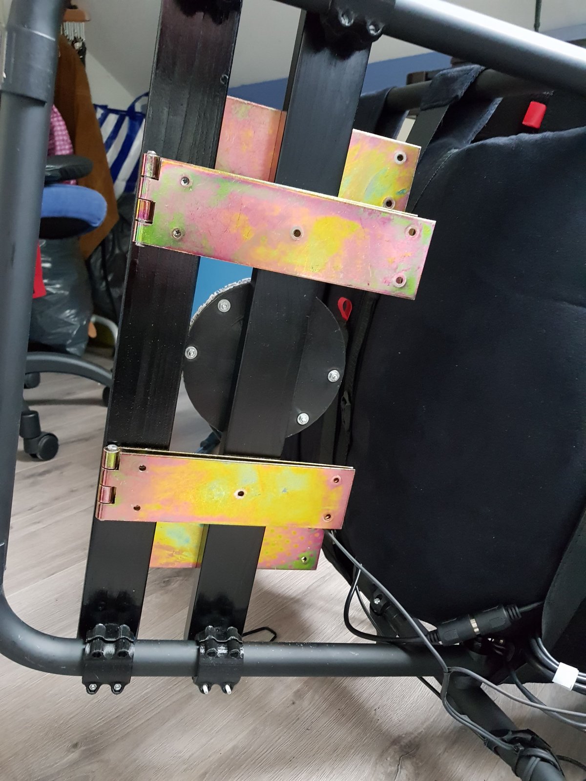

    While waiting for the license I started adding the mounting support on the seat to accomodate the bladder bags. Make sure to use some isolation tape to the mounting parts to avoid scratches and to improve friction
    Mounting the extra cross bar:
    Support bar installed:
    Now ready to add the hinges and bladder bags.

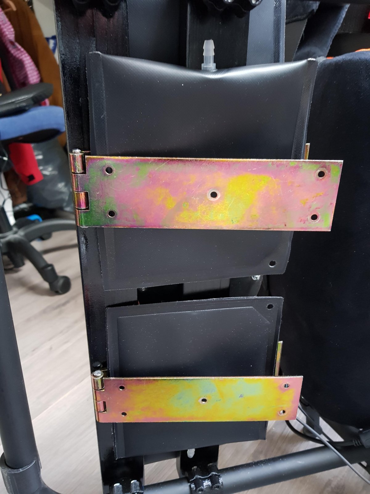

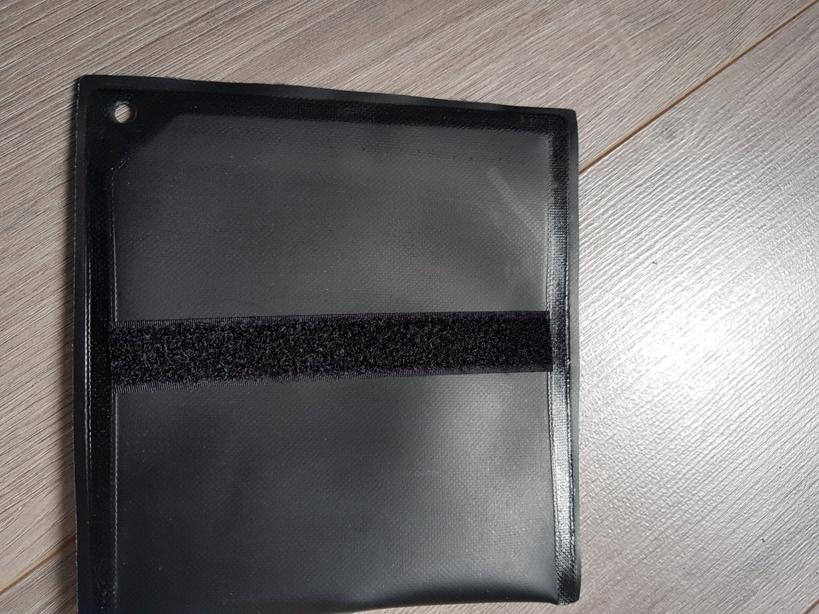

    All 4 bags installed. 2 on each side!

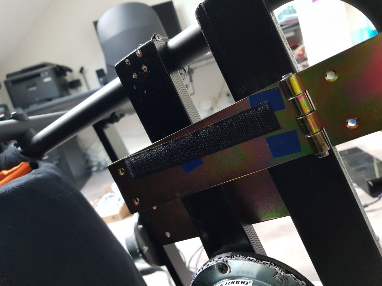

    I used some velcro to mount the bags to the hinges
    20190325_142024 - kopie.jpg 20190325_142201 - kopie.jpg 20190325_142928 - kopie.jpg

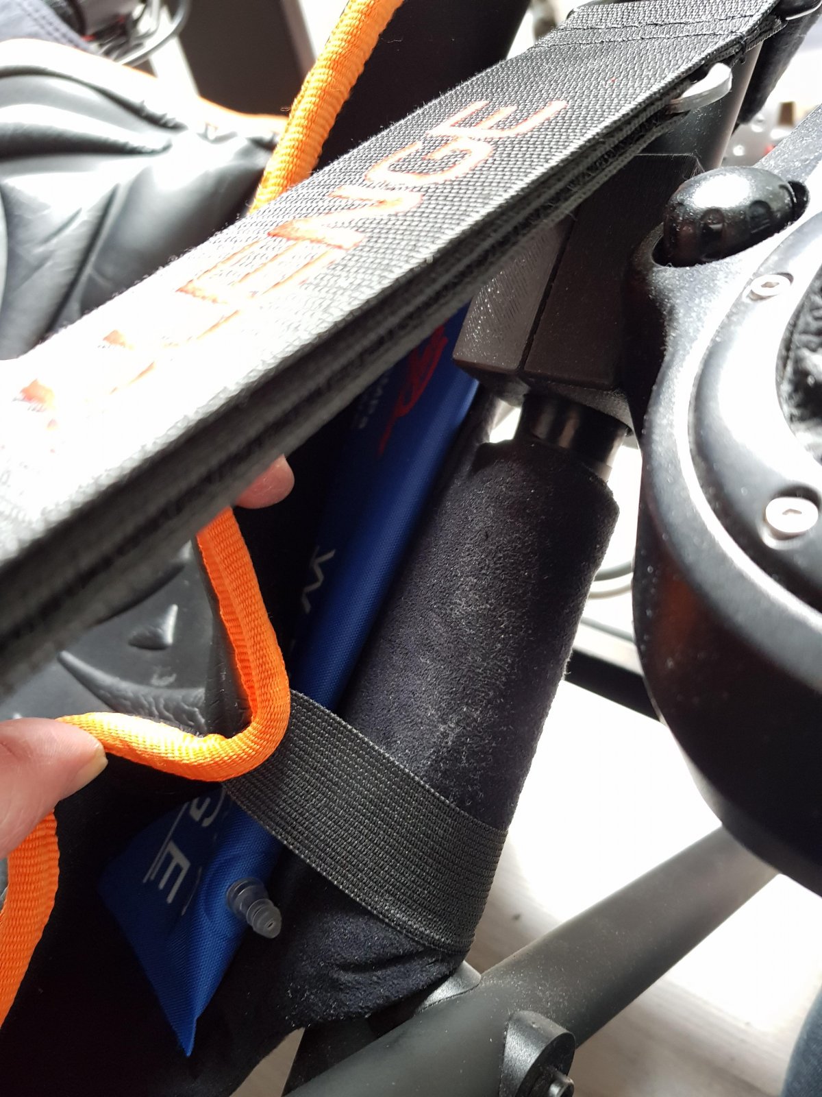

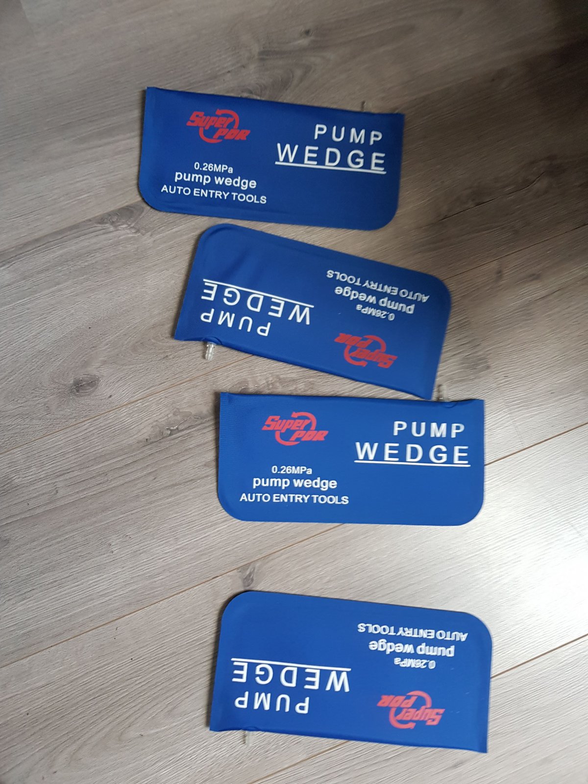

    Now its time to add the 4 bladders that will provide the lifting

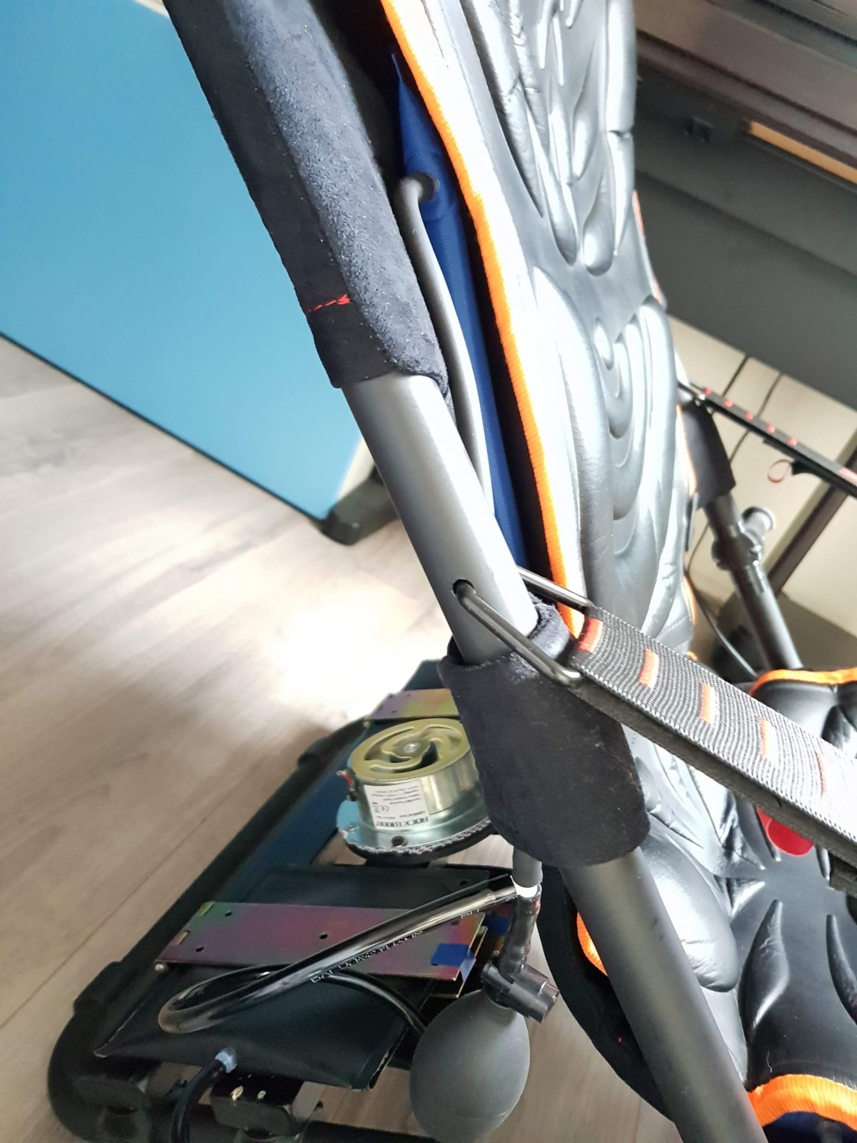

    I installed 2 at the back side and 2 at the seat. For now I placed them loose to test the placement but in the end I will secure them with some velcro

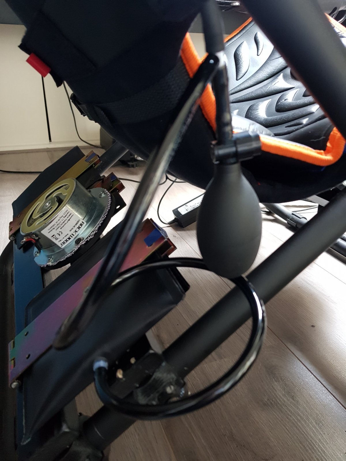

    Now it is time for some plumbing ;) Each lifting bag is coupled to a T connector which goes to both the bladder at the servo side and to the pump/valve used to control the initial air pressure
    20190325_144549 - kopie.jpg 20190325_144556 - kopie.jpg 20190325_145542 - kopie.jpg 20190325_150846 - kopie.jpg

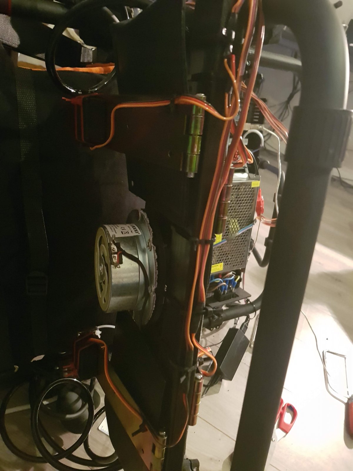

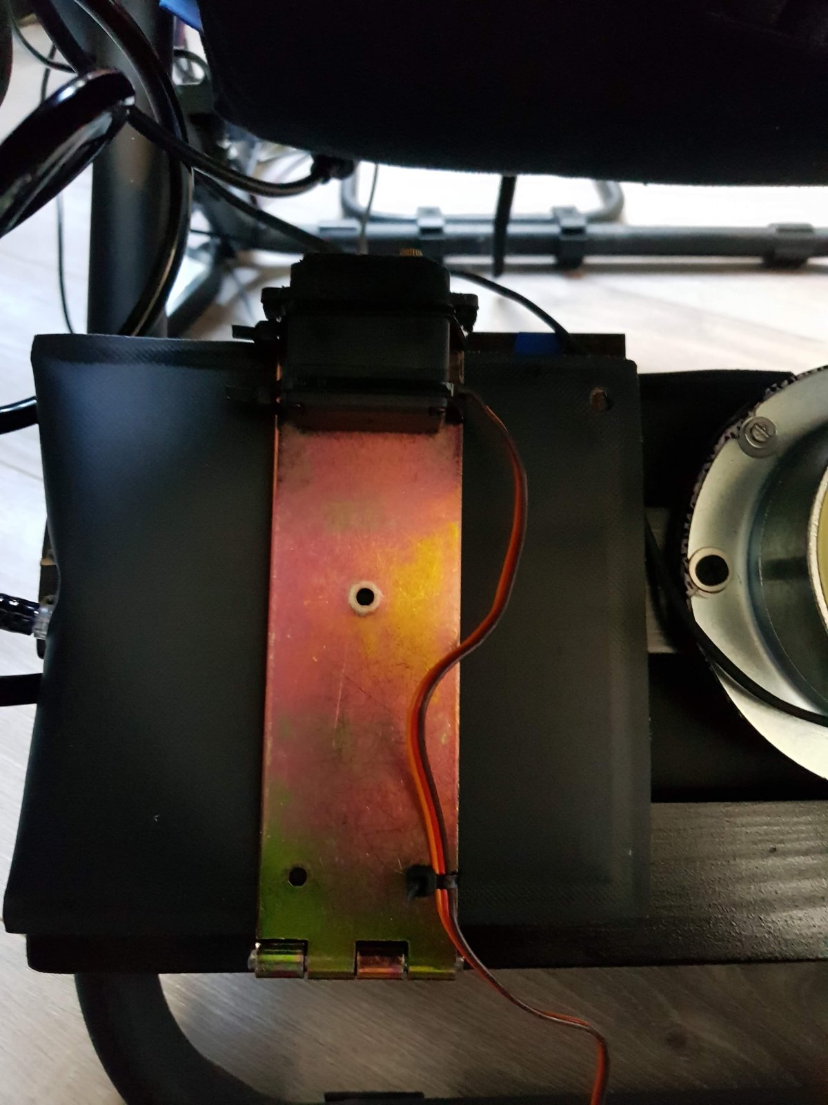

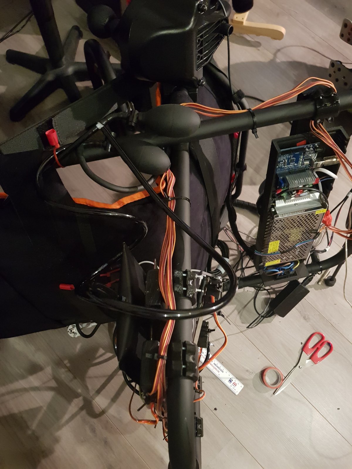

    With all the plumbing in place, the next step is the electronics. I start with the Servo's.
    Note that I found that you have to pay close attention to the turn orientation of the Servo in regards to the axis of the Servo. The axis placement is not in the center so when you place it the wrong way around the arm can get stuck to the hinge!
    NB. As you can see, I mounted the servo's with common tie wraps. To secure them more firmly and restrict vertical movement I taped them as well in the end.
    With all the servo's in place, it's time for the elecrical wiring. First I wanted to use all the connectors for ease of maintenance. I soon found it would be too fragile so I soldered everything together. Tie wrapped everything to the cross bars and guided the wiring to the front at the x-joint of the chair itself.

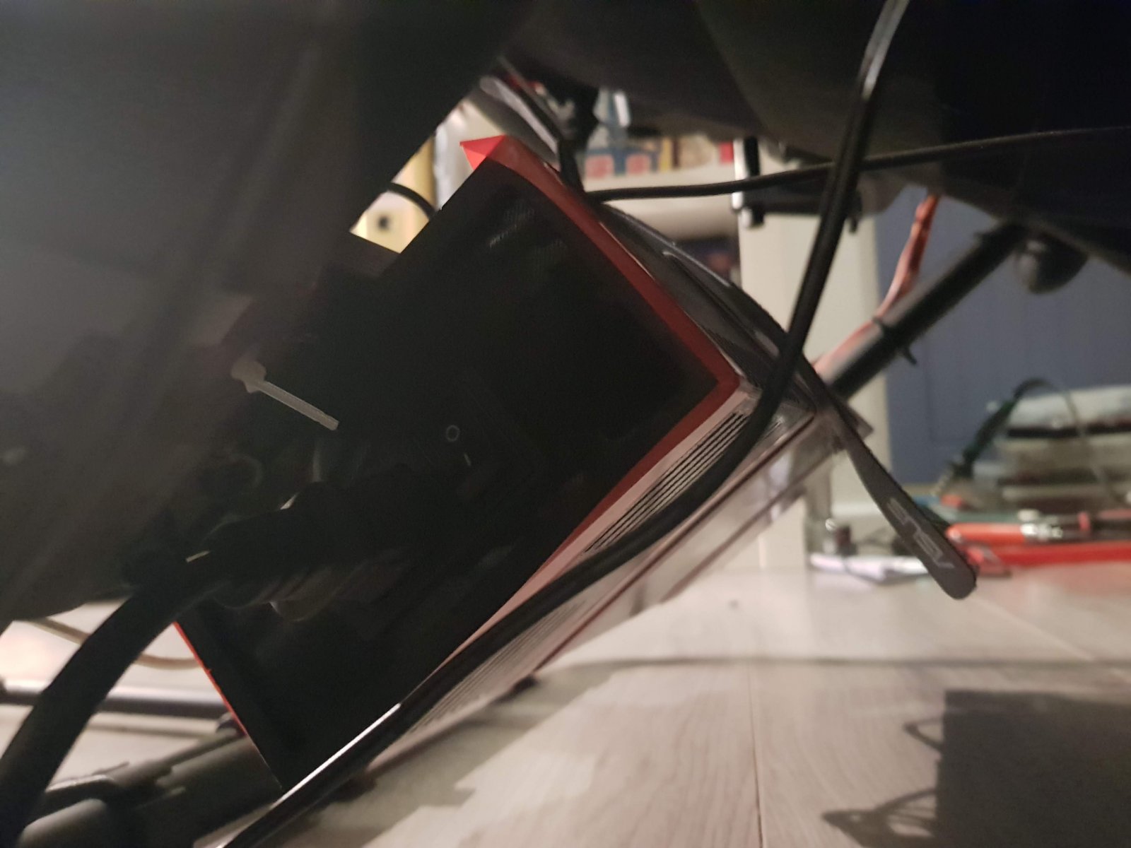

    Well, spoiler. As you could tell from the last fotograph to illustrate the wiring it was now time to place the electronics box.
    I mounted the electronicsbox simply by using screws and screwing it through the bottom of the box to the crossbar at the front. Now, I got a bit of a challenge with my box design with the arduino connection I didn't account for. The USB connector is way too long, so I cut a hole to the side so the USB connector would fit.
    Hook up all the connectors as by my initial test using the common ground and close the case. I secured it with tape the hinges proved to fragile with PLA.
