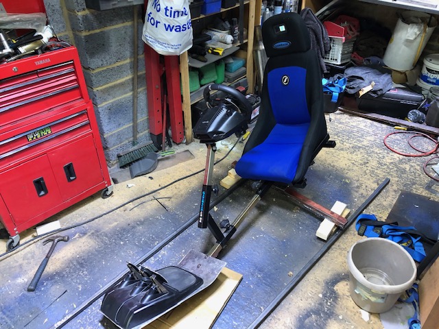

    I was originally planning a 2DOF DIY sim with traction loss loosely based on the DoF Reality H3 system, but going to get it up and running as 2DOF only to begin with and then maybe add the traction loss afterwards.
    Have got a load of metal and starting converting a normal gaming seat rig using a Mercedes 190E propshaft UJ and a little bit of steel box section:
    Other than that I have 3 wiper motors ready, an Arduino Uno, and as I had a Monster Moto already lying around i'll use that for testing, although it's just a mini so will either buy a full fat Moto or just more mini's for the other motors.
    Planning to have this running with my Xbox for now (I know it's quite limited on games), maybe in the future may add a decent PC and VR to take it to the next level, but budget is key to begin with!!

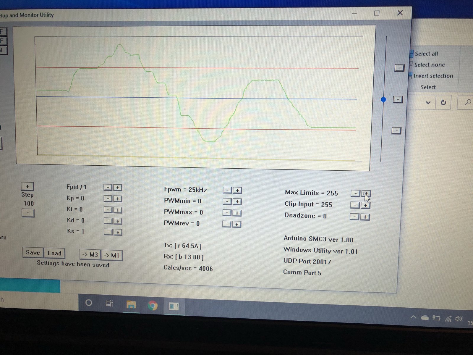

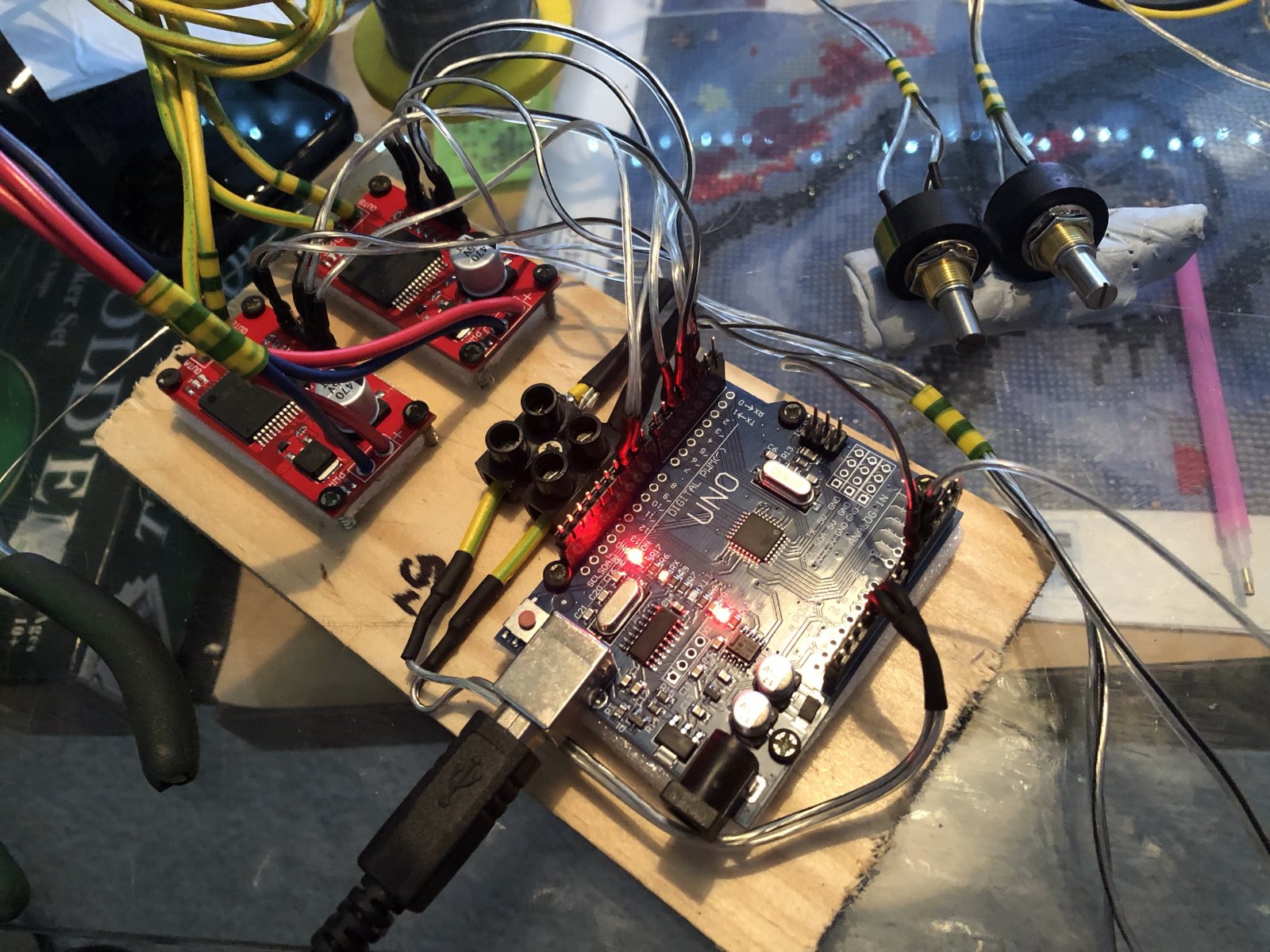

    First bit of electrics testing tonight as the pots have arrived, I’m using:
    TT Electronics 6127V1A360L.5
    I’ve just locked up a basic layout using a piece of wood, I’ll knock up a proper box and add fans for the rig:
    don’t have any motors at the moment so just tested using SMC3 util and pleased to say getting good feedback on both sensors:
    next is to get some motors, attach the sensors and fabricate some brackets on the rig.
    then mount the electrics and power supply.
    then make the linkages from the motors to the seat.
    then.... work out how to get simtools set up and get some plugins to work with the Xbox!

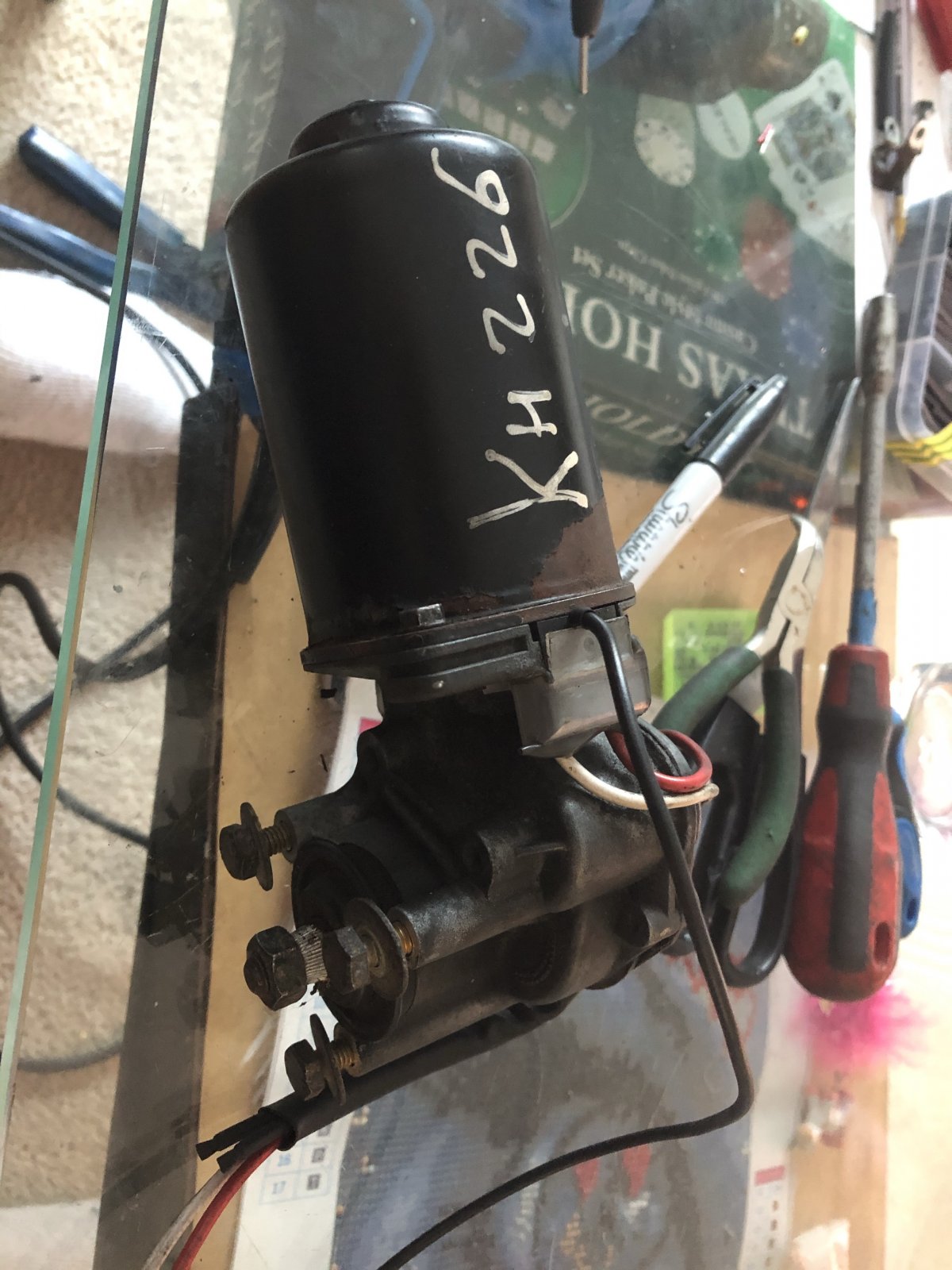

    Another productive evening, my motors arrived today so have been isolating the earth, it wasn’t possible to tell visibly which one was connected to the body so had to put bits of paper between the brushes and motor and then use the multimeter to trace the wires and identify the earth but all done!
    Also found out that one of my monstermoto units was not working, just putting out a consistent 2.16v all the time, replacement is already on its way!

    Thanks,
    that’s exactly what I was doing, one of them is spot on constant 12v, no idea what happened to the other one as barely giving any voltage at all....
    supplier already has a new one on the way to me anyway so hopefully will have it here soon.

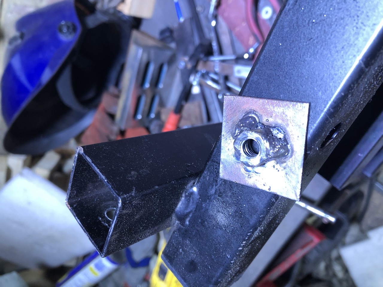

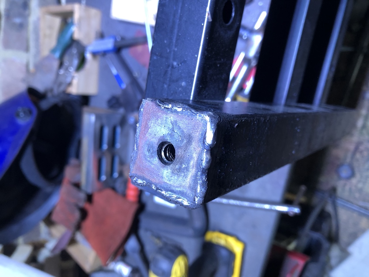

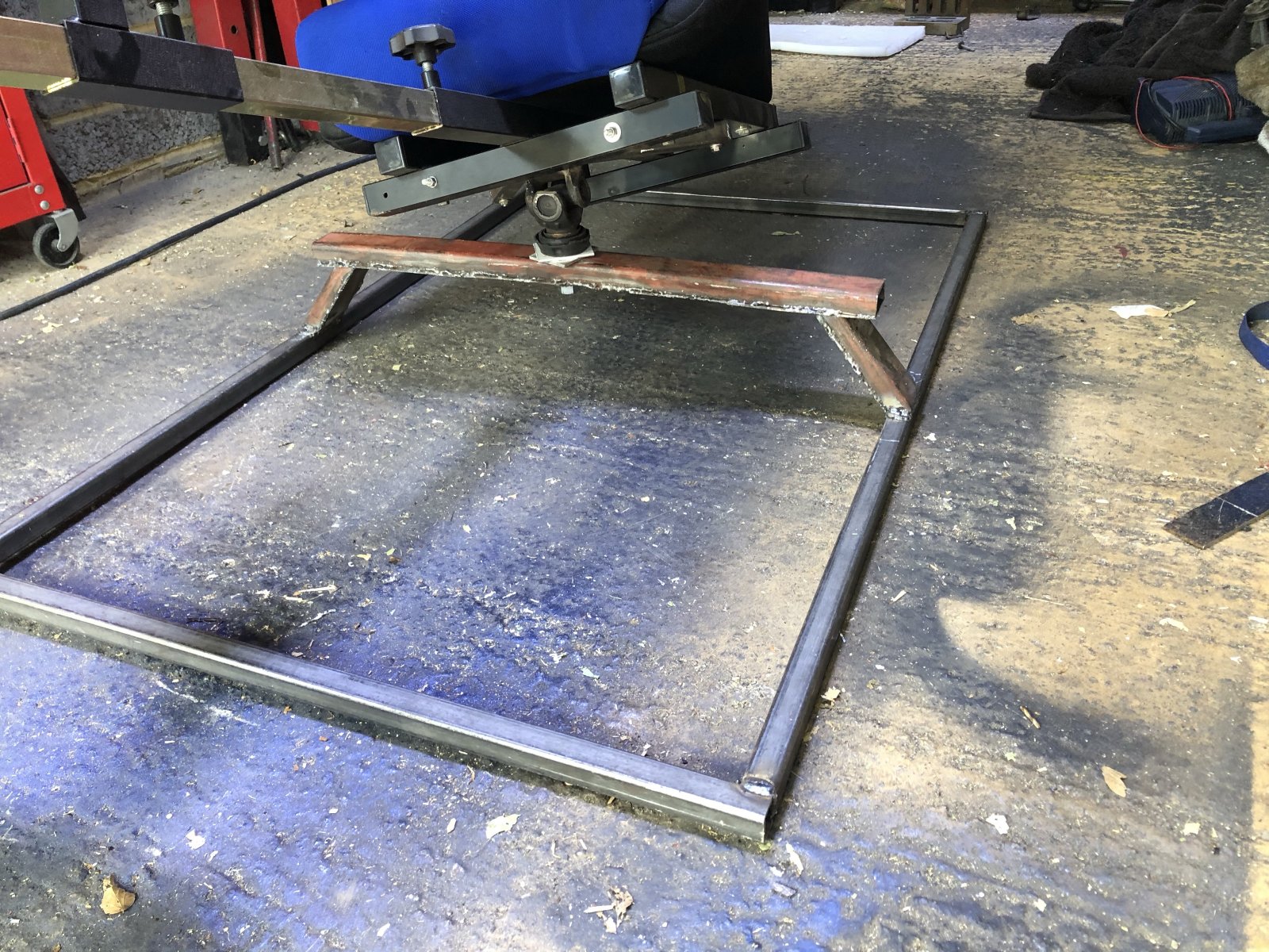

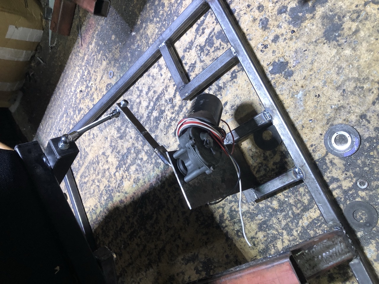

    Had a play tonight with where to mount the motors, I know a lot of people go with a bar at the top back of the seat but I’m going to try underneath the back of the seat frame, just working out the length of the cams I need...
    also realised my seat was way too low, so chopped and welded some higher sections:

    +20 / 0 / -0
    Some more progress tonight, realised my seat was freely rotating around the UJ so welded on some ‘wings’ to the main thread and cut slots in the bar to stop it rotating, all now stable!
    also welded up the first motor mount and then realised that the positioning is not good so cut it all back off again and then got annoyed so came back inside.
    did work out where it needs to go though, so that will be tomorrow’s job!

    Nice progress :thumbs
    Keep in mind wiper motors are not very powerful and a compact design for a full frame rig need a fair bit of torque compared to other designs with more inherent design leverage, SimCalc can help give you and idea of design Vs physics trade offs: https://www.xsimulator.net/communit...e-linear-speed-and-forces-of-your-design.270/
    Just checking you have some cooling in mind for the MMs, as they will overheat without it.

    Thanks, yes have already ordered heat sinks and paste for the MMs, understand about the motor positioning and design, to be honest I quite like fabricating so if it doesn’t work too well on the first go then I’m quite happy to chop it up and try something else!

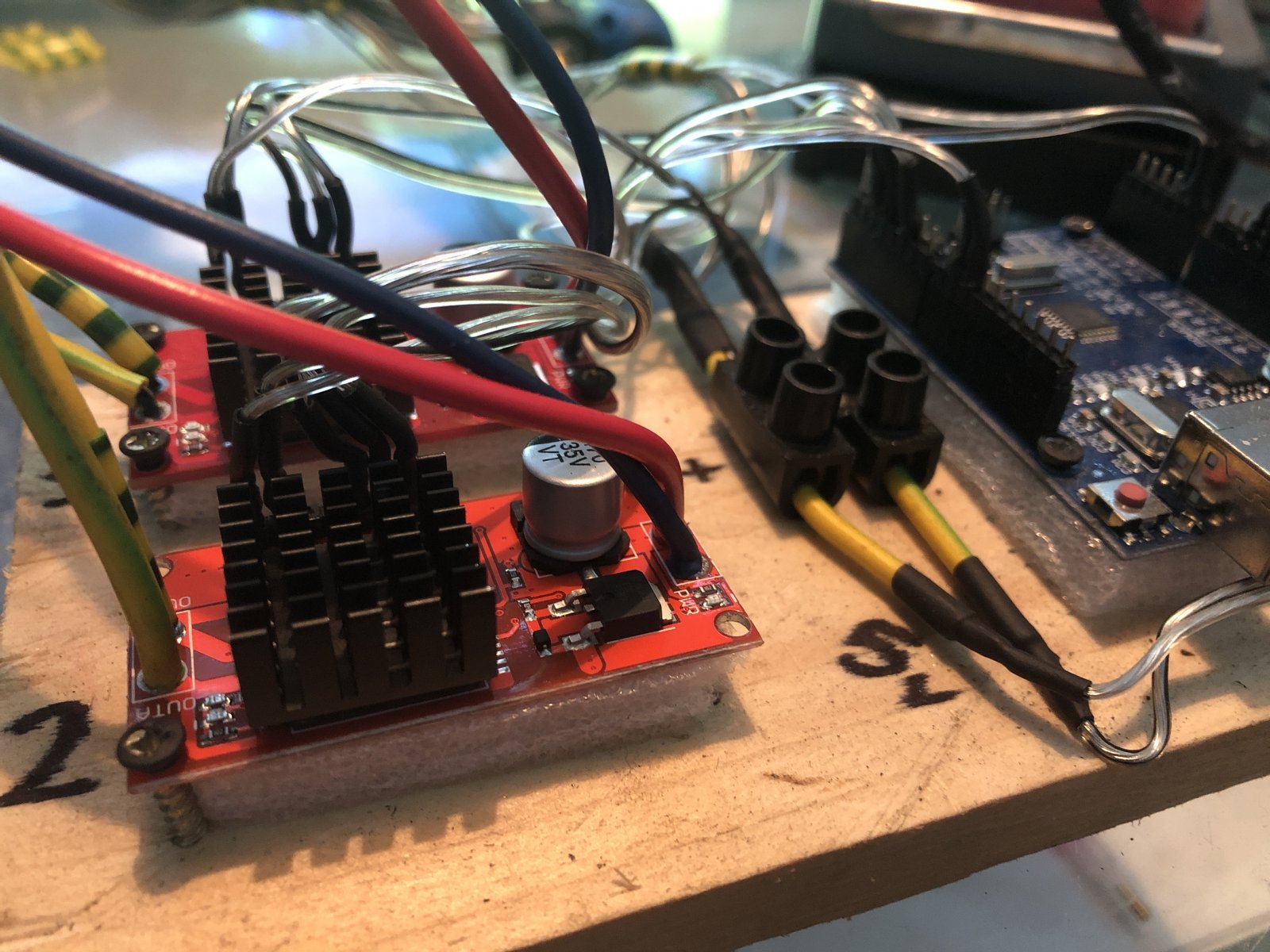

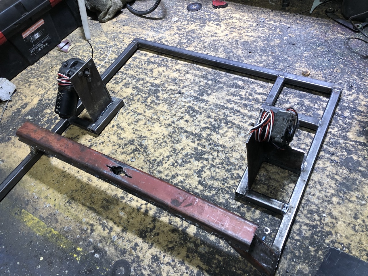

    A bit more done tonight....
    The new MM arrived so replaced this and giving good voltage now, also added heatsinks and have a cooling fan ready to mount.
    Also welded up my first motor mount, seems to move pretty well, didn’t have the energy to do the other side tonight so that’s tomorrow’s job!
    Have ordered couplers to attach the hall sensors, so once these arrive can make the brackets to hold them still.
    pretty close to testing now, applied for the diy simtools licence - does anyone know if the reply comes via xsimulator or direct from the simtools guys?

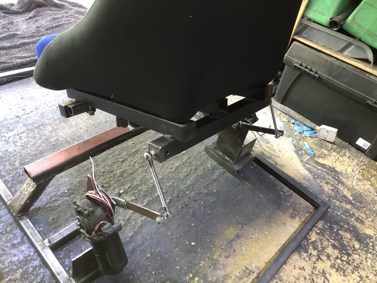

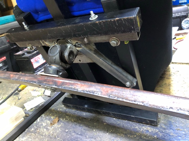

    Some more progress, both motor mounts now fabricated and welded up!
    going to move the linkage point under the seat so need to knock up some small brackets for this.
    just waiting for the motor couplers to arrive so I can mount and attach the potentiometers and then I think it’s about done!!!

    I noticed one thing: please don't use the green/yellow wire for anything else than grounding! I suggest you to buy something like red and black H05V-K 2.5mm² or 4mm² to wire up your DC stuff! As this is the main type of wiring in the industry, the wire is relatively cheap.

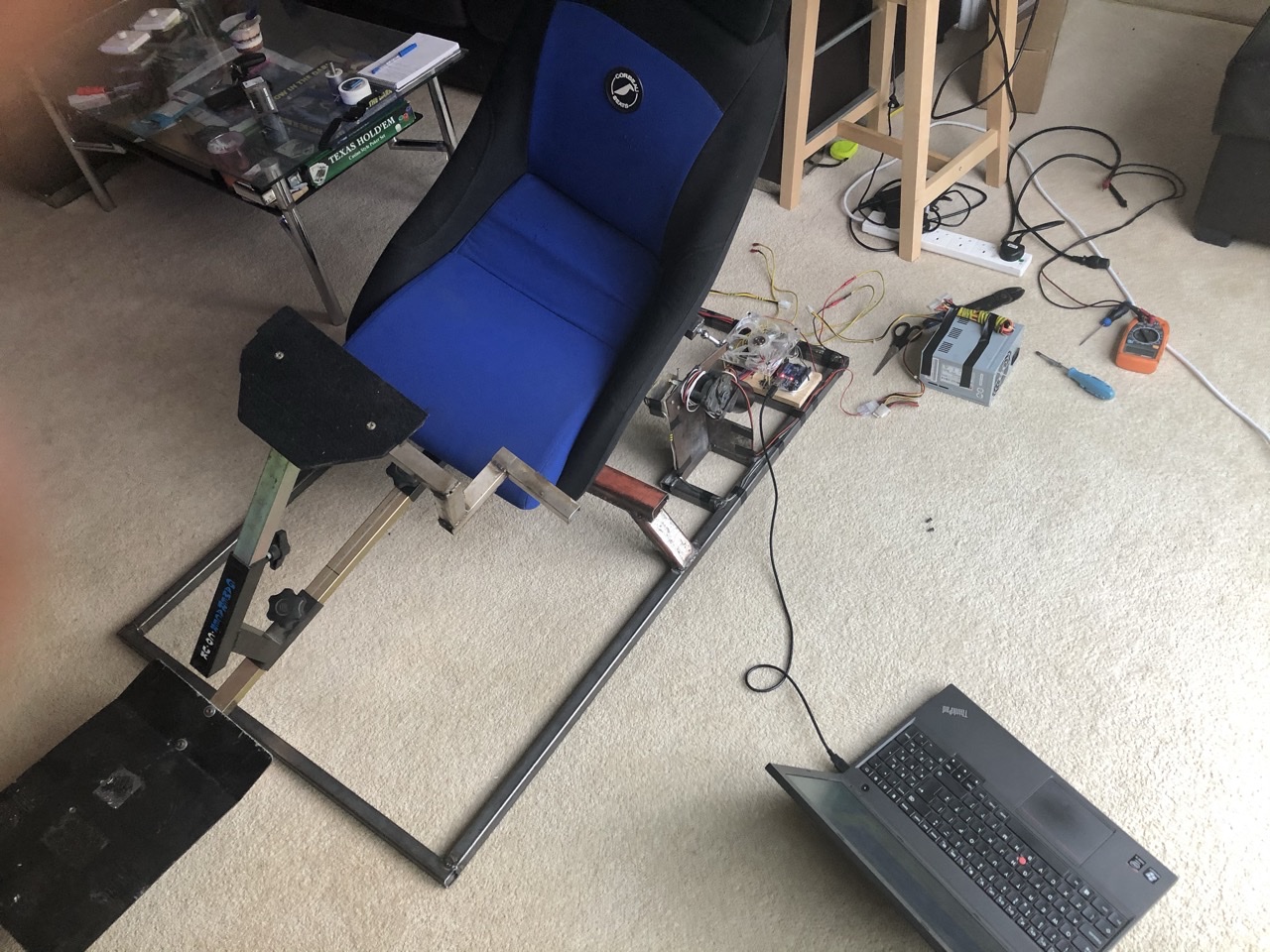

    The earth wire was just because I had it lying around and using to test. Out of interest what would be the problem using this as it’s pretty thick core wire?
    anyway, loads more progress over the last couple of days and I think it’s basically finished!!!
    It’s the small things sometimes that take the time:
    motor couplers arrived but were too long so ended up making my own.
    brought it inside for some quick testing with SMC3 and it’s alive!!!!!!
    One thing I can’t work out is how to upload a video??

    Ok there a few things i would change and ill explain why.
    Firstly in one of your pictures i could see a modified pc power supply. I would change this to a 480w 12v led power supply as pc power supplies have loads of built in protection against voltage spikes which motors produce huge amounts of. Might help to avoid future problems.
    Secondly your lever arms are way to long. The way you have it set up the motor drivers are going to have to work extremely hard to give you the amount of movement you will get. Most likely is after a few minutes they get so hot that they go into protect mode and keep shutting down. Now a diy licence doesnt specify how much movement you need to have so a 50mm lever arm will get you to a diy licence far quicker and you can change it to whatever you like once you have it.
    Thirdly the wire you have connected the pots with is not going to be good enough. You need to use shielded cable to get smooth motor motion. The wire you are using will cause motor jitter that can only be delt with by using a huge deadzone in the smc3 which is bad unless you use shielded cable. Get an unused usb cable and cut the ends off and use that cable. The outer shield needs to connect to ground at the arduino end only.
    Fourthly cooling. You are going to need to put fans directly above the drivers as they really do get hot. I have 2 pwm pc high flow fans on my motormonsters and still i get constant temps of about 60C with good coolers.

    agree about the arms, one of the things I was thinking of revising as it only uses about 45 degrees of movement from the motor and doesn’t give the best leverage, although with my basic testing has done the job.
    thanks for the tip with the pots, I’ll change this along with the earth wire - all was just wiring I had lying around for testing....!
