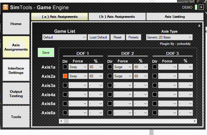

    In axis assignment, I use the SimForce GT preset:

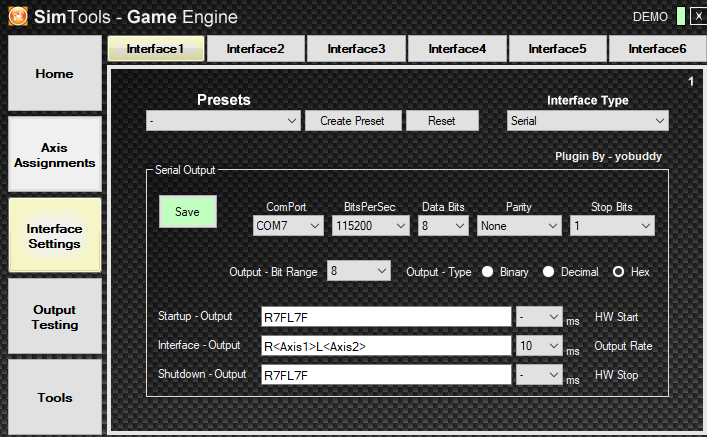

    For the interface setting: [​IMG]
    When I enable output testing, both motors go forward wich is weird considering the startup output should put them in the default starting position. When turned off, both motors go in the default position as expected. Also, any sliders won't do anything to the wiper motors, no actuation at all.
    I've tried many different things with the axis assignments wich I believe is where I get stuck. If anyone have some pointers on what to try next it would be greatly appreciated.

    In your Interface Output use this for SimTools 2: R<Axis1a>L<Axis2a>

    Wow that was it! Many hours have been wasted because I'm too stubborn to post ha!

    At least you made the effort to look for yourself, though it takes a bit of digging. The need to update the Axis Input for SimTools 2 is covered in the SimTools manual p. 46, and it is worth downloading the manual to keep it handy: https://www.xsimulator.net/community/threads/official-simtools-user-manual.12424/
    For the benefit of others using the code the need to update the Axis Input for SimTools 2 is at the very end of @RacingMat's guide, so if you are too eager it is very easy to miss: https://www.xsimulator.net/communit...-and-2-pins-direction-hbridge-motomonster.67/
    SimTools Setup
    - In SimTools : set the same ComPort and same Speed
    - my Arduino code needs 8bits Hex data : just setup like this for 1 bridge and 2 motors
    the only change needed for SimTools2.0 is the a designation: Axis1 -> Axis1a
    Ignore the axis b tab, you are not using it.
