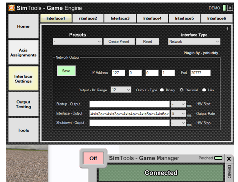

    I want to send data packet with 24 bytes from simtool to my application by ethernet as below:

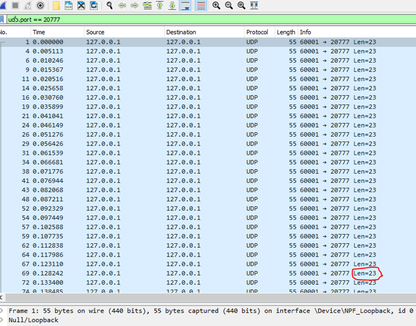

    When I use wireshark for capturation data length from simtool, it is wrong data length as below image.
    It is 23 bytes, sometime is 24 bytes. I don't know the reason why lost output data from simtool.
    Could someone help me for making configuration right? From that, output data from simtool is 24 bytes right ?

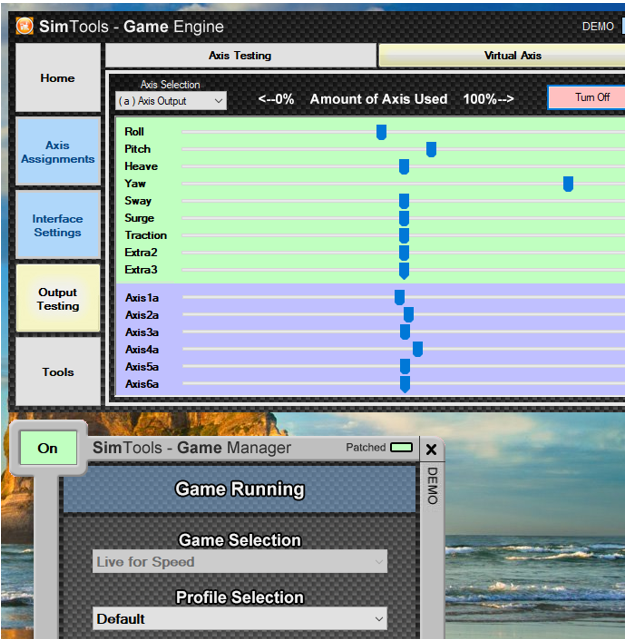

    I already maked connection between Simtool and LiveForSpeed game successfully. Game's motion data already had in Virtual Axis of Simtool's output Testing.
    However, I received motion data wrong ,when I capture data packet from Simtool. I gest that I make configure wrong. I mean, data length is right of 24 bytes, but I only received 23 bytes when I capture data in wireshark.

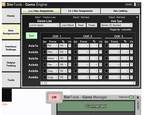

    step 1: Setup 6 Asix (Asix1a. .. Axis6a) as below

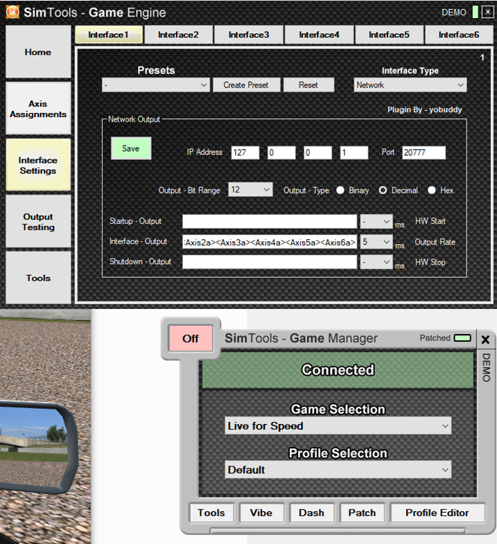

    step2: setup configuration ethernet for receiving 6 Axises (example: Axis1a is float 4 byte) as below
    step 3: Run Game and capture data packet by wireshark tool.

    Send the data as 'binary' to have a stable output for length.
    When sending as decimal, The length can change quite a lot.
    If one of the values of an axis is "1" the length is one, where if its a "239" its a 3.
    But if you send the data as binary, you will get 2 chars for each axis or 12 chars for output.
    Give it a try buddy.
