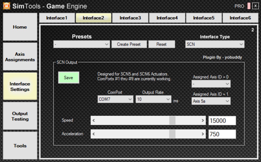

    I use simtools with the SimuKit SK1 and until now, everything worked fine :)

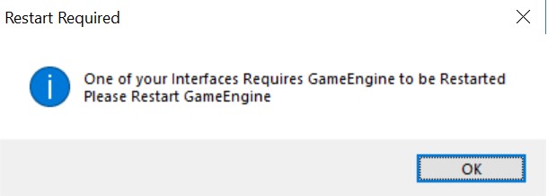

    But now, I try to add a new DOF with an extra SCN6 but when I try to set the Interface 2 on SCN, Simtools tells me it needs to be restarted. I restarted it many time but I get all the time the same message : "One of your interfaces requires GameEngine to be restarted". If I delete the Interface 2, simtools reworks...
    If someone has any idea why I'm not able to enable simtools with my SCN6, I would be glad to get some help.

    Here are the pictures of my simtools and the message

    Do you have 2 SCN's attached to a single com port adapter?
    fyi, you will get this message if one of the SCN's can't startup.
    (or has not initialized)

    Good point, Actually, I don't know the axis ID of my SCN6 then I've set booth axis but that's right I have only one.
    Then, If I understand, I just remove the second one and I try again...
    let see and thank you in advance :)

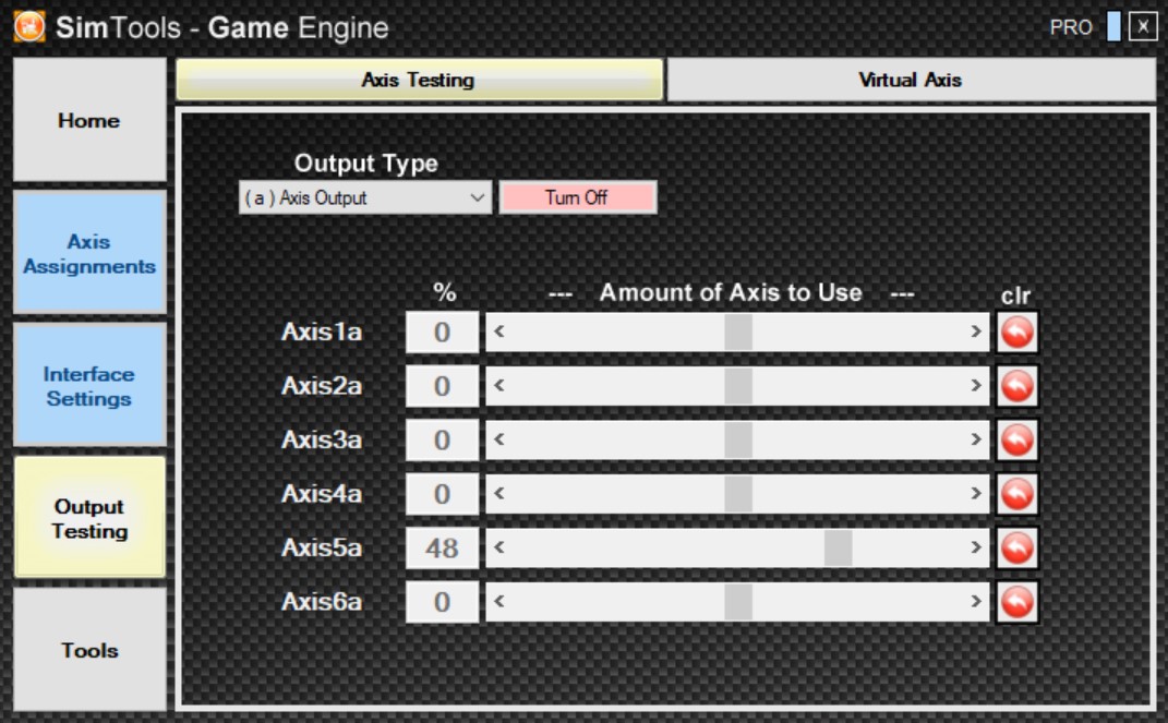

    Into the GameEngine. I set the scn6 as the Axis5b and I tried to change its position thru the output testing part.
    I also tried to run LFS but nothing moves when my SimuKit SK1 moves properly.

    No, sorry, it is a mistake, I've set the SCN6 on the Axis5a... not the Axis5b
    When I launch GameEngine, the SCN6 moves once up and down but when I go in the Output testing tab, when I move the dimmer of the axis5a, the actuator don't want to move...

    No, it is not centered. It is completely down.
    But there is something I didn't say, it is a SCN6-050-050. Perhaps it is important since I believe the normal actuator is a SCN6-050-100...

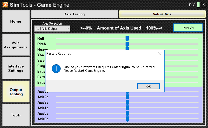

    in a fresh installation of SimTools2.2.5 (and SCN Protector). i am able to start the "VirtualAxis Output Test" to see if the game talks to SimTools2.2.5.
    But after setting up the Interfaces as shown below i´ve got the "restart-gameengine" message if i try to TurnOn the "VirtualAxis Output Test" .
    Needles to say that i tried to restart the engine over and over ;)

    the scn-rig isn´t connected yet.. it is placed at an other location. thats why i´ll try to use the virtual demo to see the function.
    (i know that the demo works just fine without the actuators to my usb-2-serial adapters)

    Its because the SCN's are not able to center on SimTools startup.
    (because they are not connected)
