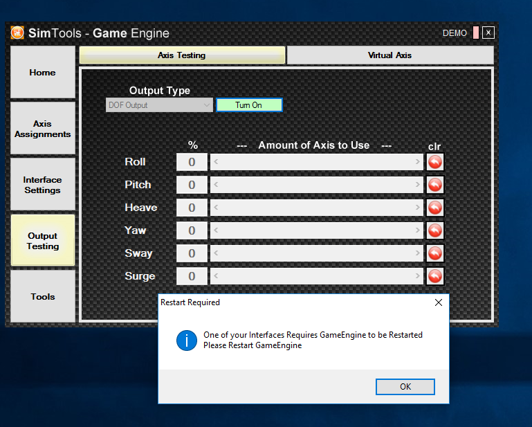

Question One of your Interfaces Requires GameEngine to be Restarted

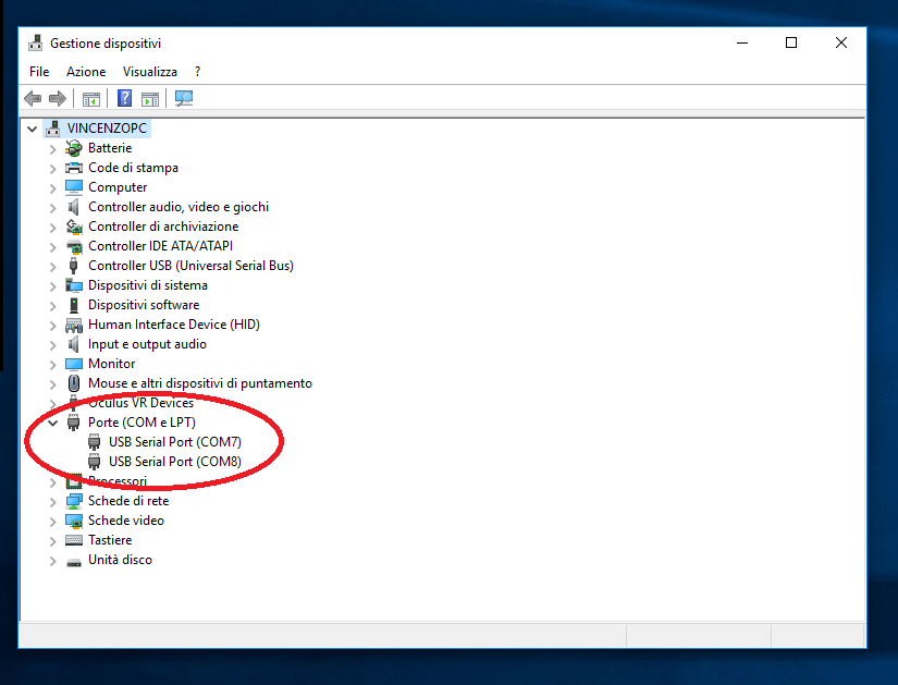

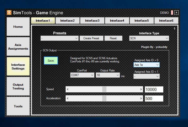

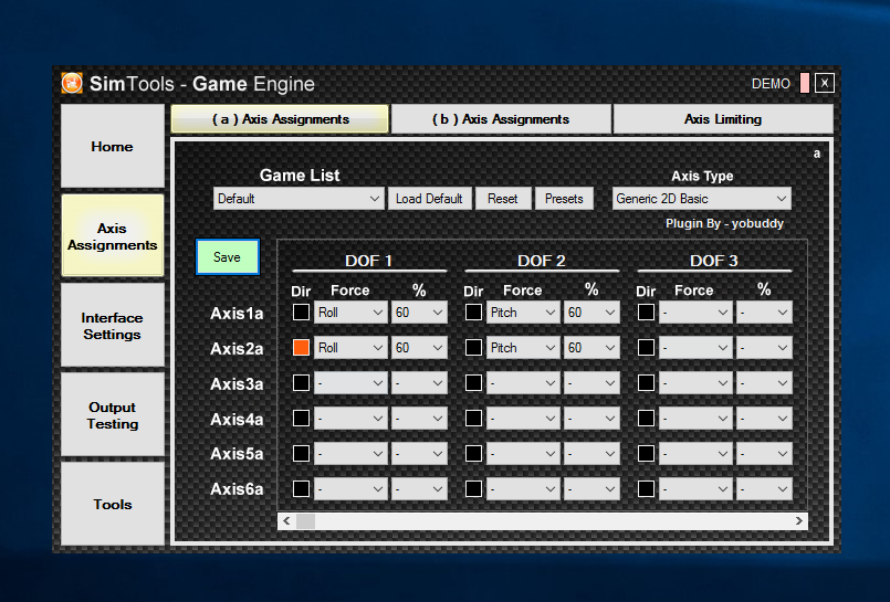

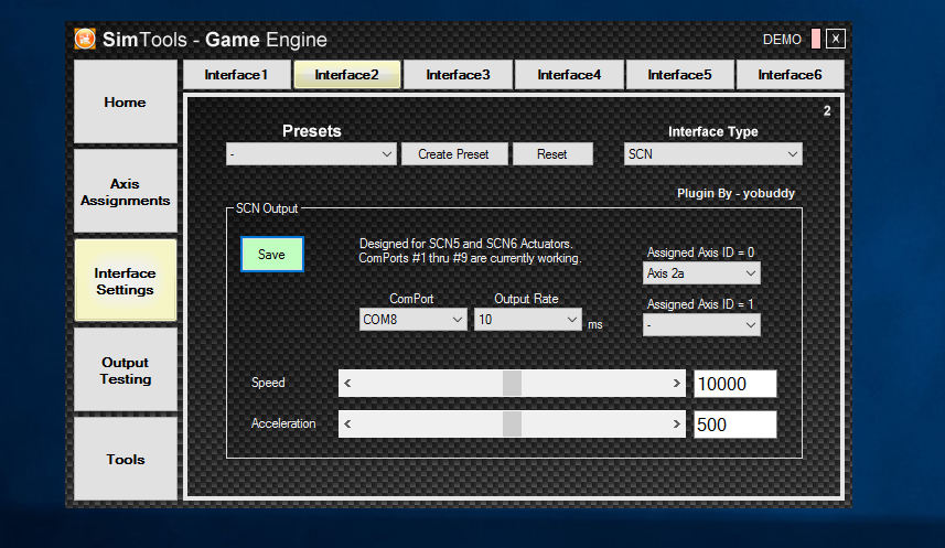

    Hello everyone, I spent all day trying to understand the problem, I also searched the forum, there is no apparent solution. I turn the screenshots around so you can see the procedure that leads to the error. I have two SCN5 actuators which work perfectly with another program. I tried to run simtools with the Virtual Sim App, the software works. The actuators work with another software and are centered and powered. Help Me

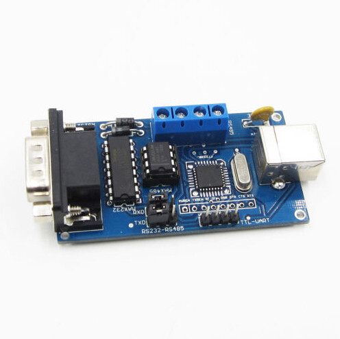

    Hello, both actuators are connected to cards like this one
    the two usb cables are connected to a USB hub ,. The hub connected to the PC has been deprived of the power supply wires, red and black, as it created me a power return that damaged my motherboard.

    Hi, I read the FAQs but I don't know how to change an actuator's ID.

    I always have the same problem. Now with the previous experience I have put ID = 0 to both actuators but it doesn't work the same. I am going crazy

    I use the version 2.5.3, which gives me this error.
    I used version 3, but i am not getting any signs of life from my actuators.
    With the actuator software I set both ID = 0, but the error always comes out.
    I also tried with only one actuator, same thing.

    Check the other interfaces (3 thru 6) and make sure you don't have any settings for them.

    I try to change ID and change COM, i try every possibility but the error message return.
    I try again with Sim Tools 3 - But there is not errore message, the actuator don't move.
    With the SNC5 software the actuator is perfect.
