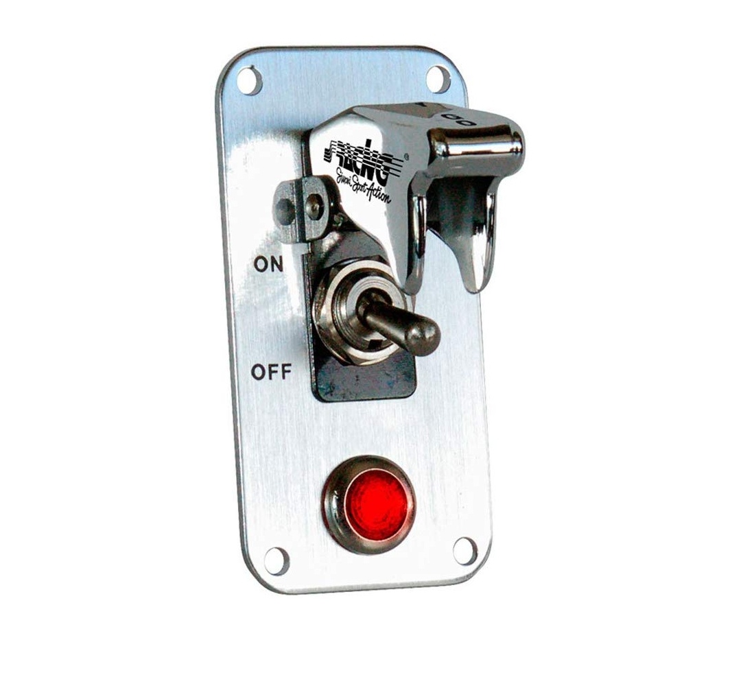

    Hi guys,
    I want to add a power switch near my steering wheel that acts as an emergency switch if necessary as well as an convinient way to power on or off the motion rig.
    I run a 24v system so I struggle to find "correct" switches for 24v.
    I thought about something like this :
    I figured I put it between the psu and the sabertooth which should work as desired.
    My question is what I might missing and what do I need to take into account?

    Oh it looks like the link was broken for the reference.
    I was looking for more of a racing look:
    But all I found were for 12v only.
    I can't use a 12v one for my 24v system, can I?

    Also if it is going to be used to shut down your drive motors in a emergency, then I would recommend a standard emergency switch so that it is easy to hit if you are maybe being thrown around by a runaway system.
  7. FoxHound.92
    FoxHound.92 2DOF seat mover Gold Contributor
    Jan 11, 2018
    69
    38Coins
    +30 / 0 / -0
    Thank you for pointing that out.
    That's the reason I was confused I couldn't find any switches that are rated for more than 2A.
    I should have listened more carefully back in physics class... :nerd
    Thank you all for your answers, my question is hereby solved. hug:
    I thought about the last point as well and might be better of with a common emergency switch.

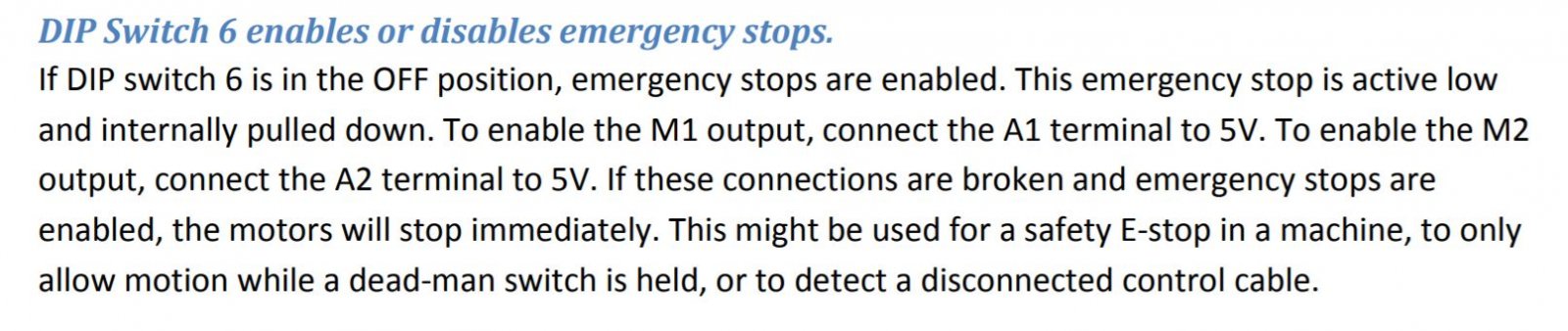

    Also if you are using a Sabertooth 2x32 you can use the built in emergency stop by enabling dip switch 6. More info here and in the manual.

    I've read the sabertooth's manual like a hundred times by now and I dare to assure you this paragraph did not existed before you pointed it out to me! :eek:
    Thank you, anyway! :roll
