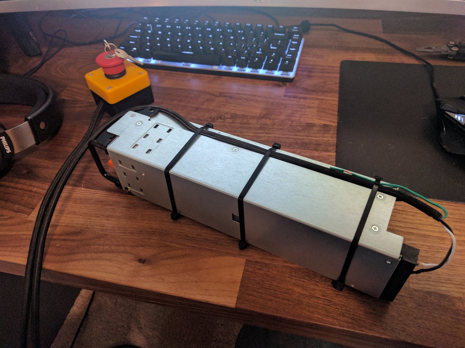

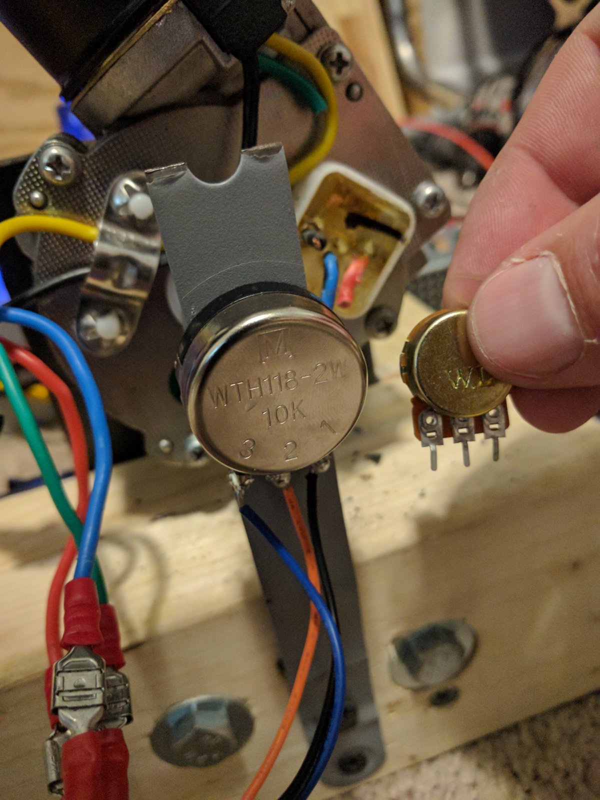

    So it's been a bit since I've had an update; where we left off was me realizing 400w isn't enough power for my needs and a broken potentiometer after testing. Part of it was due to waiting 14 days on a power supply to be delivered, then as soon as it showed up I had some family health issues that took priority of my time. I'm hoping to make a good bit of progress over the next week, I'm feeling like I'm in the final stretch now! I also think that with THIS post I will earn enough points to grab the simtools plugins I need :)

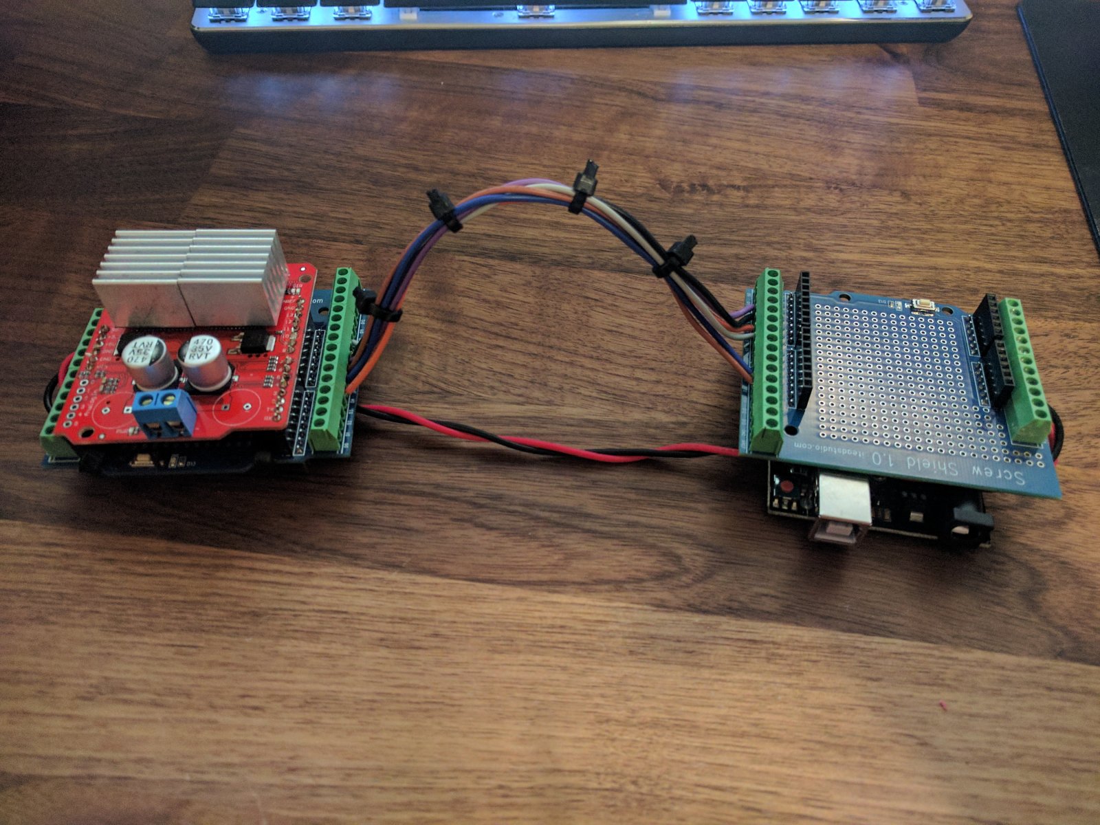

    I mentioned earlier that the pinout that the SMC3 software requires prevented me from using the monster moto as a shield, so I ended up getting a second protoshield board and made a little wiring harness up so that the pinout matches and I can still have everything quick-separable in shield form if I decide to change any parts out down the road.
    As for the power supply, I purchased a Dell 2950 750w (actually, two of them but will only be using one) as recommended elsewhere on this forum. I did the fan mod (since the fan at full speed sounds like a jet taking off in my room) and connected it up to my kill switch using some braided lamp cord I had laying around, makes the kill switch look like it does more than just act as a jumper across pins on the supply....
    I will also have it plugged into a powerstrip that I will turn off when not in use, since it seems to still draw enough current to stay mildly warm to the touch without being turned on.
    Total $ at this stage: I don't want to remind myself! Somewhere around $500.

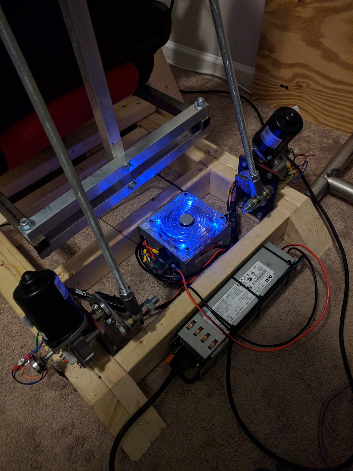

    Motor controller and arduino componets all placed inside an old power supply box. New Dell 2950 server power supply for providing 750w of power, I have a second I might run in parallel.
    I gave up on the cheap potentiometers I was using before, they kept flaking out in the middle of test runs. New ones are MUCH higher quality!
    There's always something with this build to put me behind.... somehow one of the motors suffered from an internal short and overheats after just a minute of motion, new motor on order. This is the primary suspect for an issue I posted about in the Q&A section where my power supply to keep shutting off intermittently

    It often feels like 2 steps forward and 1 step back during a build, but hang in there, it will come together in the end.
    Just a suggestion, you will likely find the threaded rod by itself could bent when used as rods.
    You can grab some 25mm steel box or tube and weld a beefy washer and nut either end to make a really strong rod.

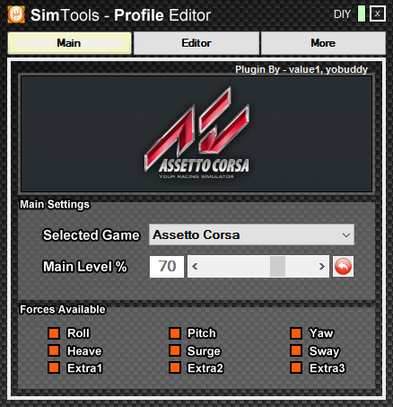

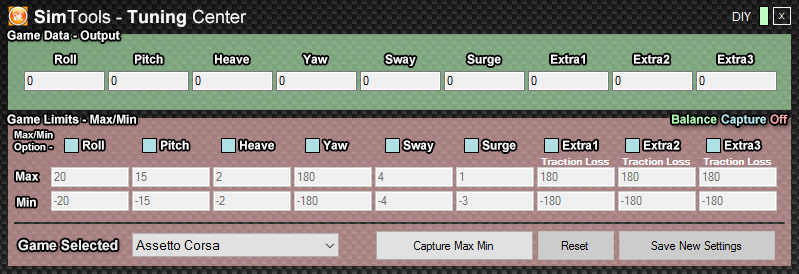

    The new motor came in and I got it all wired up and installed, fixed the overheating and motor fade issues right up!
    I spent some time last night trying to get a decent tune set up.
    These screenshots are more for my reference so I can use them as values to roll back to for a base-line tune.
    For the tuning center for Assetto Corsa, I settled on these values

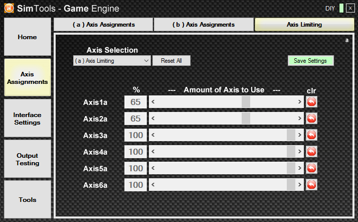

    For the axis assignments I'm testing out these values
    With axis limiting set to 65%
    And game main level 70%
    It's recommended to keep the overall tune at 100% per axis max, so I will be revisiting that to balance everything out so that the main level can go up to 100%
    I took these settings out for a test ride on the ring, here's a video of my first lap with motion where I wasn't focused on trying to tune settings:
    The amount of motion FEELS like so much more inside of VR, I may end up dialing some settings back. Advice is welcome!

  13. Nick Moxley
    17,057Coins
    +2,506 / 30 / -2
    Pitch and Roll are Way too high in the Tuning center, Pitch roll and Sway are 3 you really want nice and linear. No herky jerky movements.
    Also Nords is Not a Recommended Base line for setup, It has multiple quirks about it that renders it not usable. Tho there are many tracks that will offer you places to test Said pitch and roll, Spa for example where you can park sideways @ Eau Rouge, that will show you a Max example of what roll could be. Stop On eau rouge, That will show you a Max Pitch situation. IMO 8 is the ideal number for AC for pitch and roll. Yes you might have a situation where an 8 will clip some data, but lets be honest here, were circuit racing, if you got THAT much angle and lean on the car, your doing it all wrong, lol
    Imo you need to get rid of the Axis limiting and run that profile @ 100% ANYthing under 100% is SEVERELY limiting the data coming in and i HIGHLY suggest you go back to 100 and re tune. use the Profile editor to tune cars/tracks, Not the Main slider.
    PS time for some seat belts. :p
  14. armpit
    armpit Active Member
    Jan 7, 2016
    128
    Software Engineer
    SC, USA
    - 8Coins
    +132 / 0 / -0
    I don't think I will be adding VR motion cancelation, it all seemed pretty natural feeling with head jerking around in real life causing the same movement in the car. I'm wondering if the motion cancelation is mostly for 3dov where there is up/down movement?
    I did my tuning on other tracks, mostly Mugello, then after it felt dialed in moved to Nords. I'll adjust my pitch and roll, they are only taking up a small percentage of the axis, most of the movement I seem to like feeling so far is from surge/sway/heave and I kind of stopped messing with pitch/roll and focused on the others. I trust your advice and I'll drop them down and see how that feels this evening, thanks!
    As far as the axis limiting inside the game engine, if I set it to 100, my motors will rotate past the 'max-up' and 'max-down' rotations in extreme cases, it's a 270deg pot and I only want max 90deg rotation off of center in either direction, so ~15% soft-limit on each end. That's what I was using the axis limiter for, is there somewhere else the soft-limits on the motors should be set? Just lower percentages in the axis settings or something else?
    I agree about a seatbelt, just threw a basic 4 point in my amazon cart :)
  15. armpit
    Jan 7, 2016
    128
    Software Engineer
    SC, USA
    - 8Coins
    +132 / 0 / -0
    So I set the main output to 100%, left the axis limits at 65%, and WOW the amount of detail in the motion is incredible! I thought it would just be more aggressive but it does actually seem to add a good bit of detail. I also changed the pitch and roll values as @Nick Moxley recommended and that also made a great improvement to the immersion. Thanks again for the tips!
