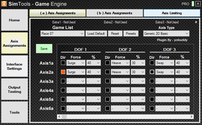

    I'm totally in a circle. I set up Simtools two days ago. Game Manager on the Game PC. For testing I installed the game Race07 and added the plugins.
    On the second PC I installed the Game Engine and set everything. I use an Arduino with XPID and Moto H-Bridge with 12V wiper motors.
    I tried to add the axis settings of Racinmad. But the error appears that this is not a valid Simtolls file. I created the axes myself.
    As soon as I start the game, my engines are moving because they want to get into the starting position and as soon as I finish the game, they will go back to the middle position.
    The engines do not move at all during the game. The GameEngine shows that this data is received because in the Output Test the controls are moving.
    Can someone help me. It must be an axis problem what I have or an error with the game plugin.

    It works. Whyever.
    I turned up the percentages of the individual powers. Then I have the engines on the Output menu first manuel and then drive over the game. I'll test it right away and report if everything went well.
    Thanks for the link noorbeast. I'll check everything first.
