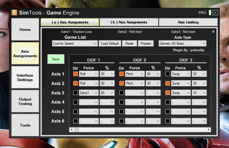

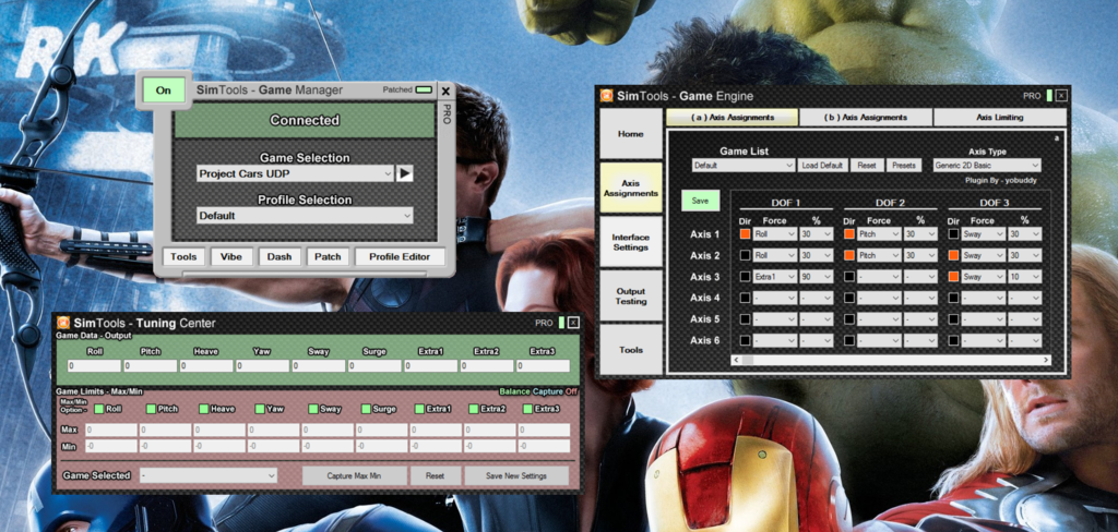

    Here are the screen shots, showing my settings.
    Can anyone tell me what I am doing wrong? BTW - I have the locale set to United States as per the instructions.

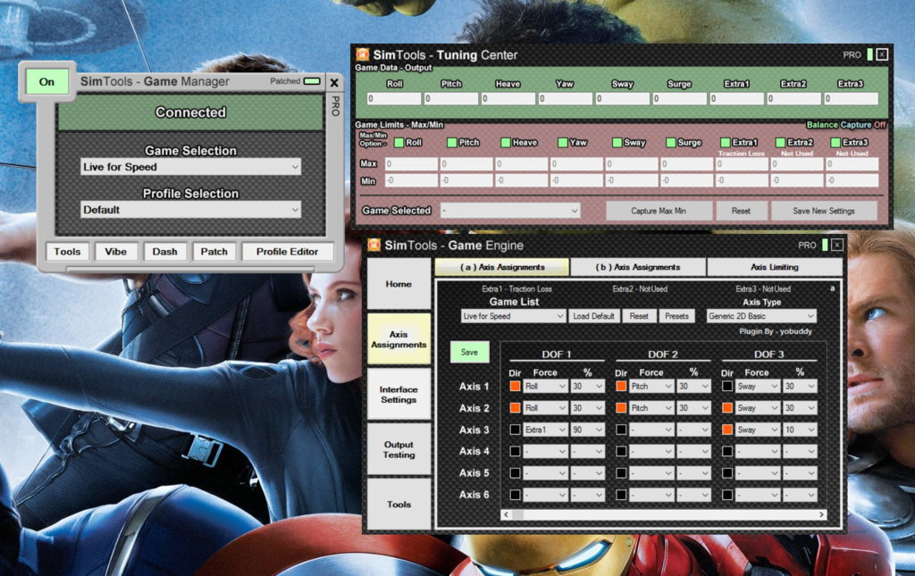

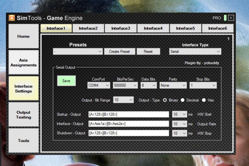

    Please post pictures for all of your settings, including the Axis Allocations for LFS.

    Is this what you wanted to see?

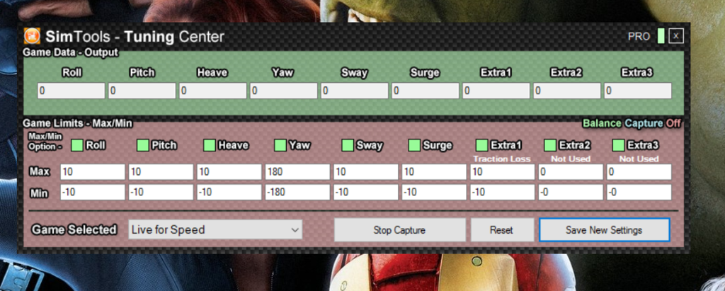

    You have to adjust your min max settings in Tuning Centre. They're all '0'.
    Use "capture max min" for that.

    I have tried capturing max/min settings and I dont get any data. The game plugin already has data if I select the game title.

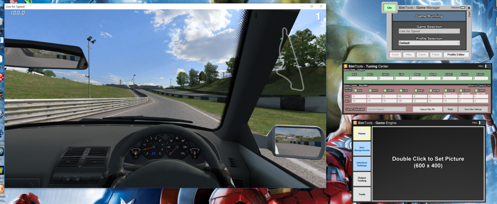

    You won't have Game Output data unless LFS is running and you are on a track, can you please post pictures that include LFS running so we know it works.
    Please confirm that Game Manager turns blue when LFS is running.
    Is Avast disabled?
    As an aside in your earlier post the Dir settings for Roll are wrong, it should be one checked and the other unchecked, and be the opposite of sway. Sway movement should lean away from a corner.

    Avast is disabled and Game manager turns blue.
