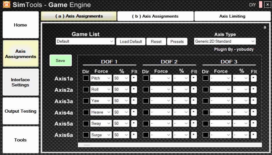

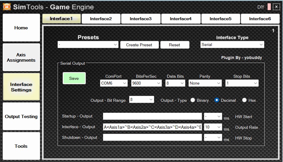

    2 Things to try;
    I think you need to have this for the Interface-Output field:
    A<Axis1a>B<Axis2a>C<Axis3a>D<Axis4a>E<Axis5a>F<Axis6a>X
    Also, unless you have changed the arduino sketch, you need to set your 'BitsPerSec' setting to match the Serial.begin value of the sketch i.e. 57600.
    Give that a go and see if some servos start moving. Good luck!

    Thank you GWiz. I looked at the code and it ends with X so it makes sense. I copied pasted the line you send me but no luck. 57600 has been not stable for me. Since I dropped at 9600 more stable. So I change the interface and the script. Still no movements. ok now the big one " Axis Allocation is done horizontally, with each axis being vertical." I see this on many threads. Sorry guys I just can't get my head around that :( is it like in this pic?

    Yes, I think that is correct in that for each DOF1 to 3 you now have an individual servo (axis) moving, i.e. for Pitch movements, only Axis1a moves, Roll only moves Axis2a. Ordinarily you would have multiple servos attached for different movements of a platform. For example Roll might need 2 servos to move in different ways to achieve the roll movement so you may need different directions of movement or different percentages depending on the shape of your simulator setup.
    Your software settings look correct to me, so I think the most likely fault will be your arduino not being able to supply enough current for so many servos. You can quickly check this by disconnecting the power line in all but one servo and see if it allows the remaining one to work. If so, then connect a separate power supply of the correct voltage for your servos to the power line and connect the Gnd of the power supply to the Gnd of the servos as well as connecting this Gnd to the arduino Gnd. Don't forget to disconnect the power from the arduino to the servos so you don't fry the arduino by accident with the added power supply.

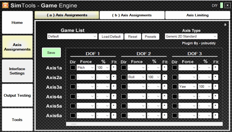

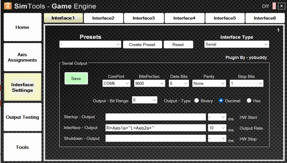

    Great diagram thank you. Oh man! I need tylenol again. Well I decided to go back to 2 servos with the eaorobbie script that I sucessfullly made working with LFS and MSFS2020. Not working. Sorry but here are my settings again and a short video showing what happens when i turn on output testing. I hope my board is ok. Please le me know what you think is the problem Thanks guys.
  12. noorbeast
    21,677
    151,706Coins
    +11,045 / 56 / -2
    For @eaorobbie's RC code the format is as you had it, as long as you modified the code to reflect these:
    A<Axis1a>~B<Axis2a>~C<Axis3a>~D<Axis4a>~E<Axis5a>~F<Axis6a>~
    I say that because that means changing the dealt R<Axis1a>~L<Axis2a>~, which presume you used for 2DOF, to A<Axis1a>~B<Axis2a>~......
    Did you reflash the code to the Arduino for the 2DOF?
  13. James Deriter
    James Deriter Learning slowly but committed! Gold Contributor
    Apr 27, 2023
    27
    Aruba
    170Coins
    +7 / 0 / -0
    Hello noorbeast. Thank you for your message. Yes I flashed it (pressed the red button than download the code. Ok, Thanks to you guys I understand much more. I unplugged everything, went back to 2 servos BUT with external power for the servos.
    I now understand the letter thing. If in the output sequence of Simtools I have A B C D...... then the constant KActuatorName must match. Also now I understand axis versus DOF 1, 2 so I put Axis 1a on DOF 1 Pitch 30% and Axis 2a on DOF2 Roll 30 %. Confirmed that I have 9600 baud rate in Simtools and the code and tried: Worked perfectly! I am happy I did not fry anything yesterday. So. Now I am going to add 4 servos with external power, use the MM_Stewart_test4.ino, update the interface settings with 57600 baud rate and put output to A<Axis1a>B<Axis2a>C<Axis3a>D<Axis4a>E<Axis5a>F<Axis6a>X
    then configure Axis assignments as on one servo (axis) per DOF and that should work right? Thank you!
