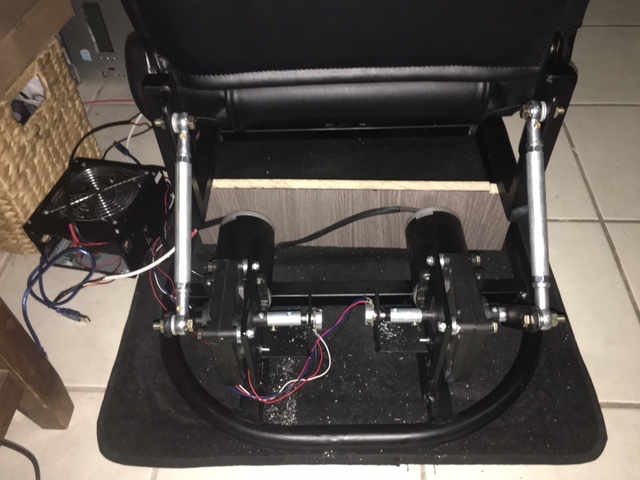

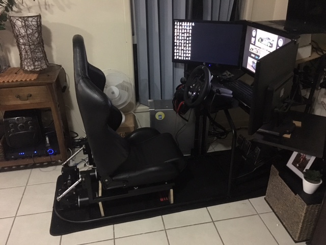

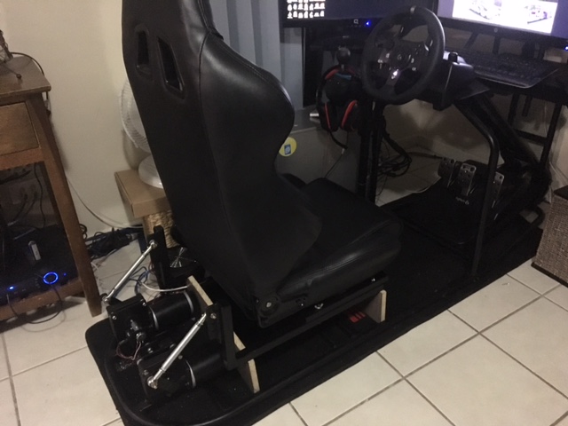

    718Coins
    +9 / 0 / -0
    Finally got a chance to build my proper motion seat. I have built it so its bolts straight onto my GTXtreme frame. I am having problem setting up the pots and working them in the software the right motor seems ok but the left just keeps turning even when i have positioned the pot to neutral, as soon as i send a command in test it just spins one direction. Is it better to have a continous pot??
    Also there is chatter from the motors when the sim is just sitting there, Also does anyone have some settings for Iracing???

    Yes everything is configured the same pin wise, i am thinking maybe i damaged the pot when i first fired it up?? Seems to be only the left motor having control issues. Might get another 10K pot and try it again.
    I have not changed any of the code, maybe need to set broader middle tolerances??

    718Coins
    +9 / 0 / -0
    OK Motor speed was way too high at 255 it was moving too fast for the Pots, i changed it to 100 any ideas what is needed for these motors to operate?

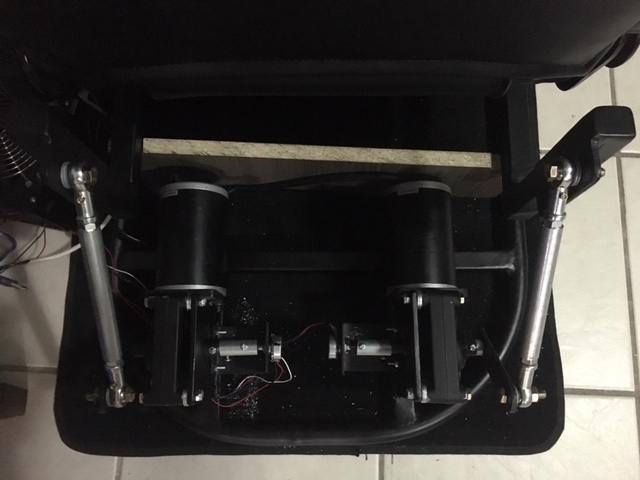

    718Coins
    +9 / 0 / -0
    Finally got some time t do some more work to my sim, But i have a problem that i hope someone can help me with. Just using the commands through the Arduino the motors tend to shake alot near the center position. I will post a video of what it is doing. Because of this continous movement in the Iracing game the chair is just constantly moving.
    It must have to do with the code or settings in the Arduino as it will happen without sim tools running. Any ideas??

    718Coins
    +9 / 0 / -0
    OK guys really struggling to get this thing to work, it has a massive amount of movement before the motors take up but there is no play in the connection with the poteniometers. i can sit on the seat and tilt it nearly 30 degrees before the motor kick in and push it back the other direction. The weird thing is i am using the standard race matt code??

    718Coins
    +9 / 0 / -0

    9,115Coins
    +1,243 / 9 / -0
    it appears to be oscillation, it may be related to your pot setup or the pots themselves. I am not familiar with @RacingMat arduino code but if there s a way to set a deadzone that would be where to start. also try to tighten everything up at your pots. I would suggest position sensors over pots as they last longer.
    http://www.mouser.com/Search/Produc...rtualkey57700000virtualkey858-6127V1A180L.5FS
    or this if you need 360 degrees

    718Coins
    +9 / 0 / -0
