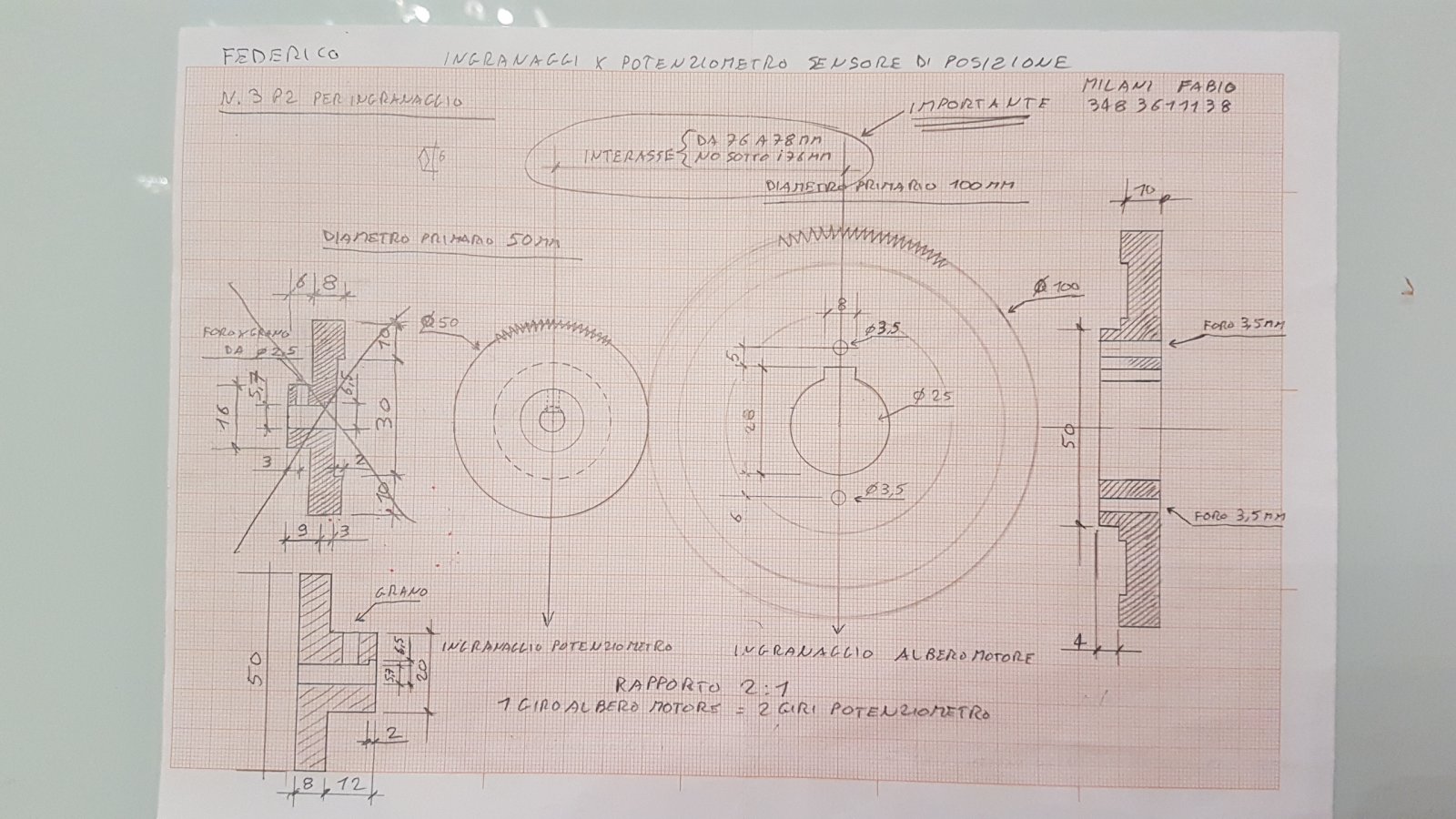

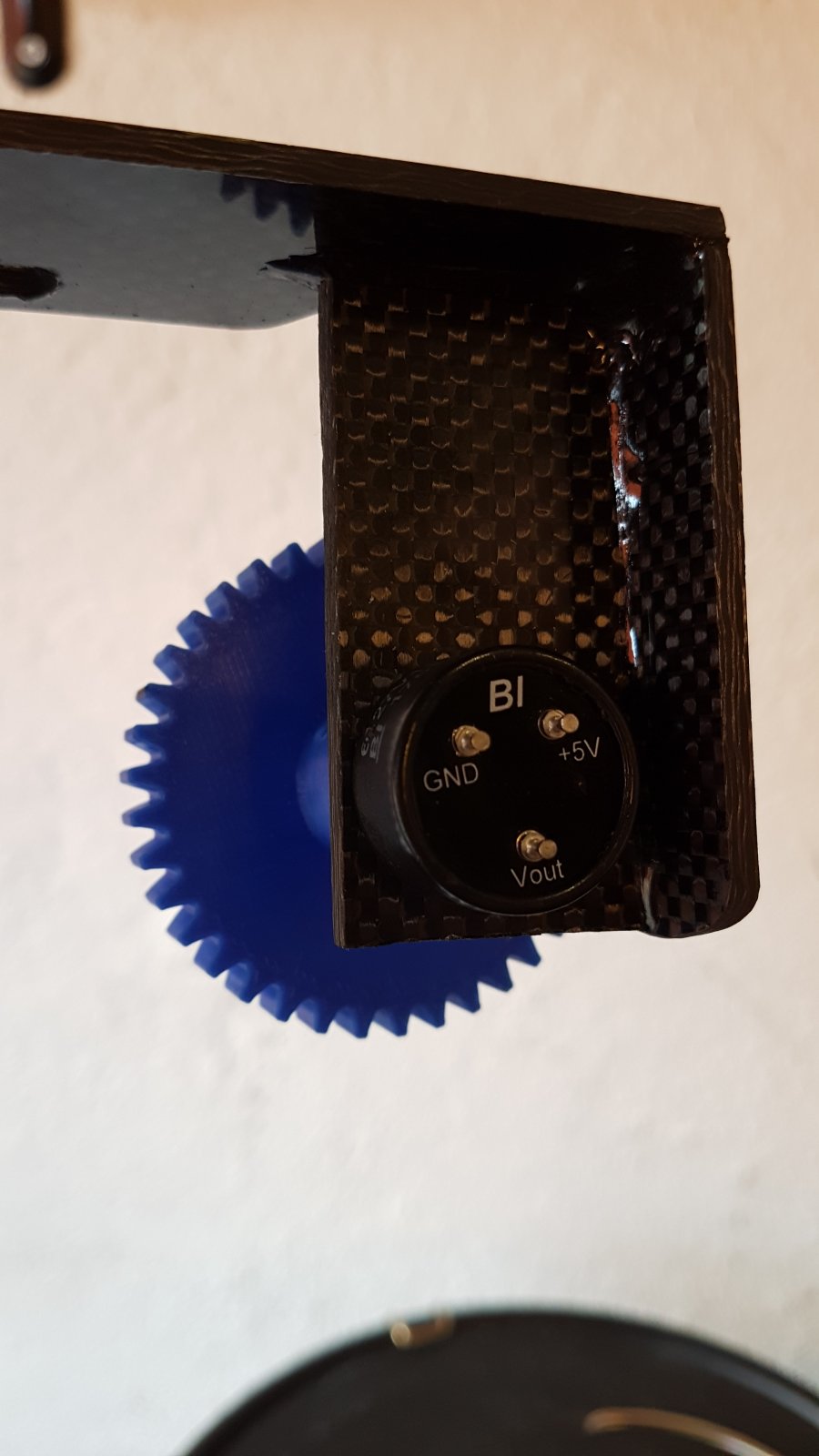

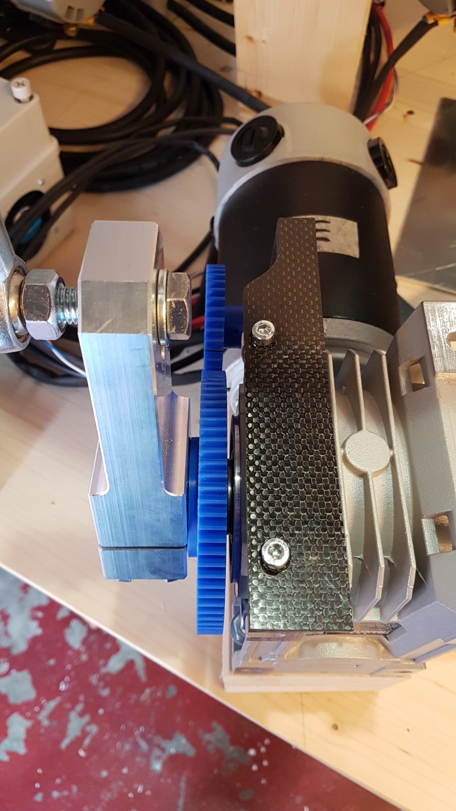

    Hi Fabio, where did you get the 3D gears for potentioner?

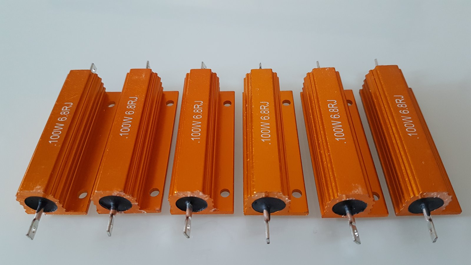

    Hi Favio, is it ok if i use more than 6.8 ohm? Like 8 ohm?

    Hi Fabio, do you have actual size measurements of your gears nor drawing details with the size?

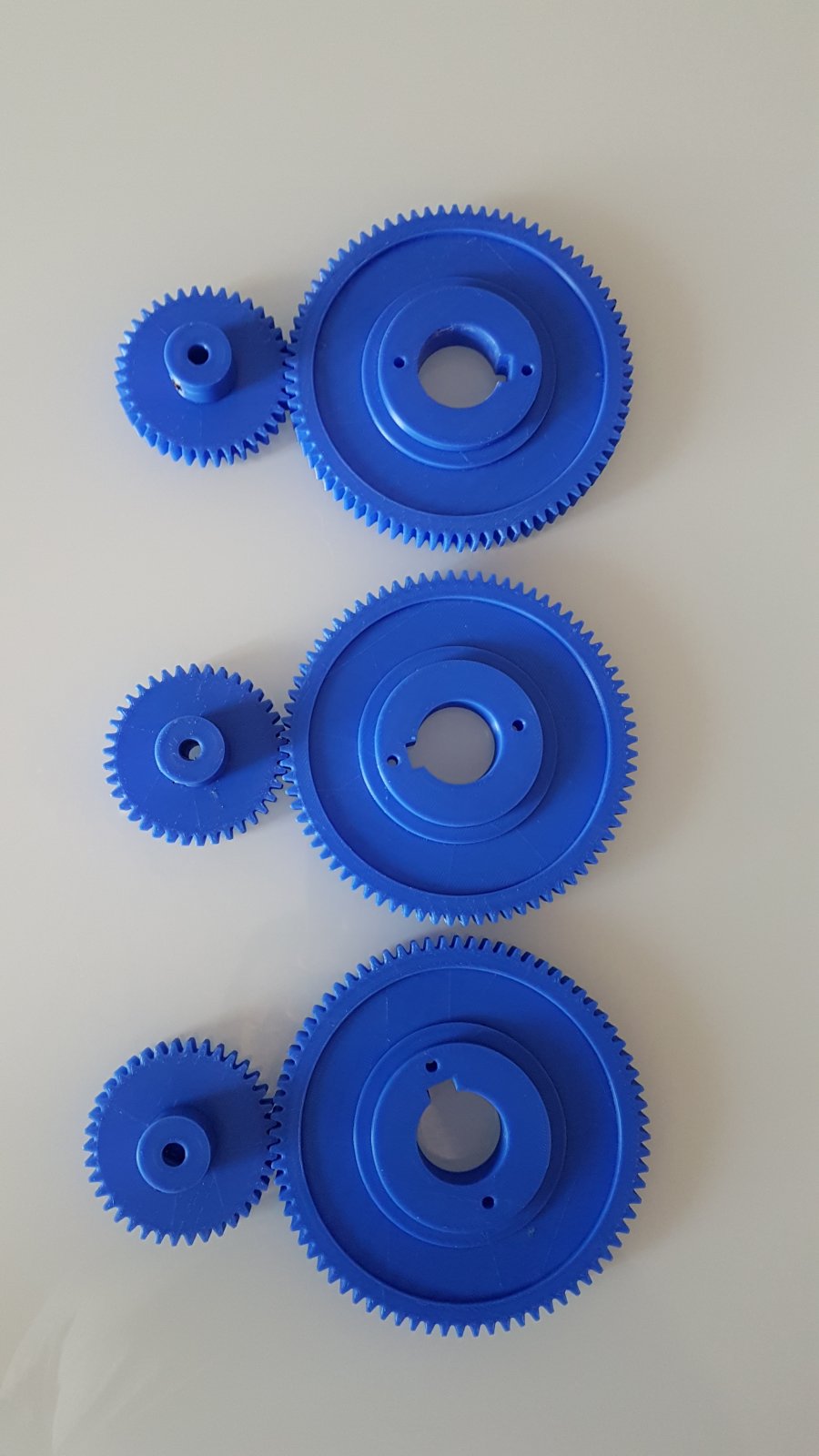

    hello sir you can give me drawing dimension gear to gear for hall effect sencer for me printer 3d
  17. Milani Fabio
    Milani Fabio Active Member
    Feb 21, 2019
    105
    Italia
    718Coins
    +74 / 2 / -0
    Hi Anatachaikiet,
    I didn't make the gears out of them, they designed them a 3D print shop, I gave them all the specifications and they designed it.
    I only have the files in stl format, but I can't load it in the post because it tells me that the stl format is not an allowed extension.
    I'm sorry.

    This is the project I gave to the 3D printing shop.

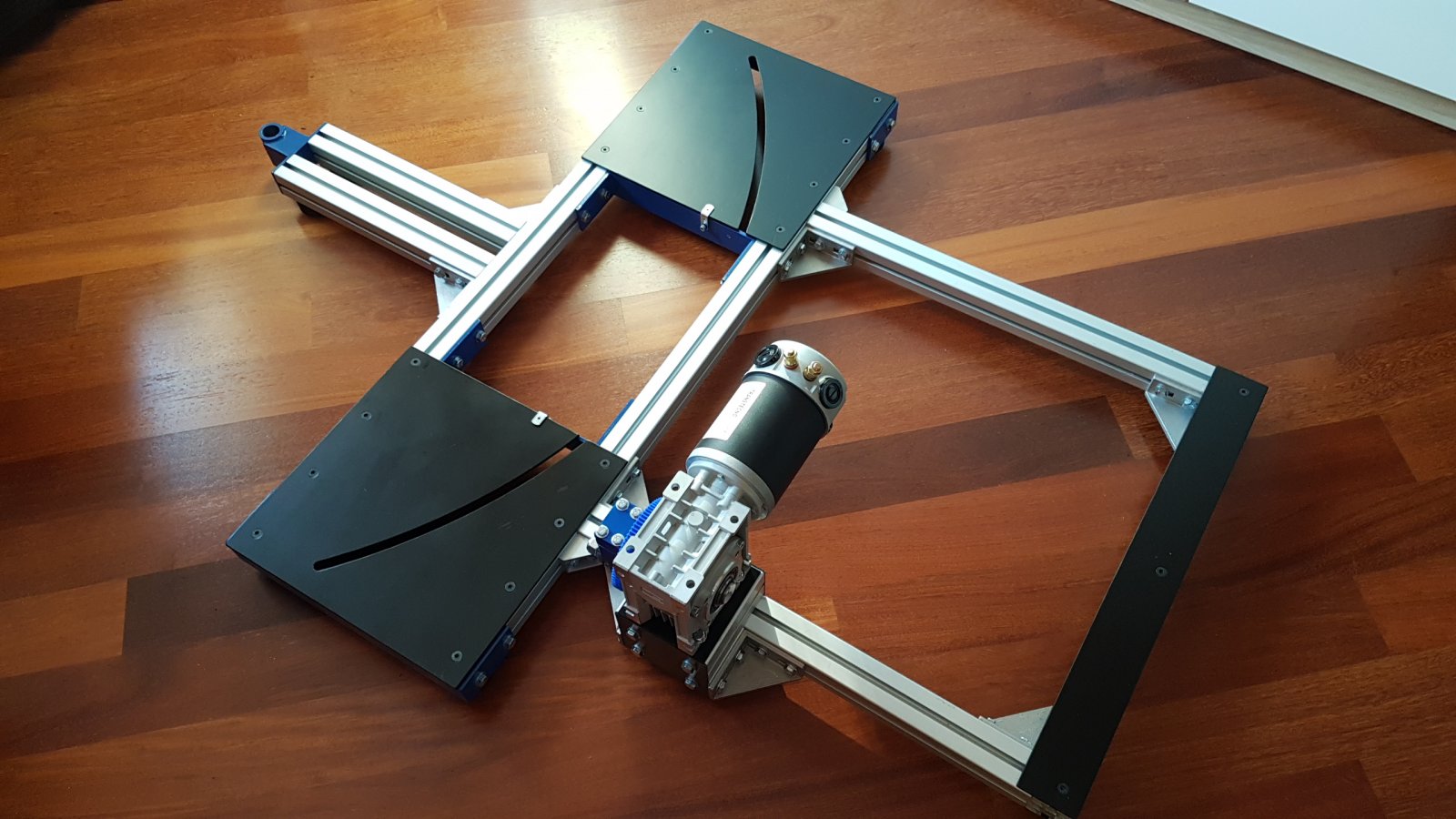

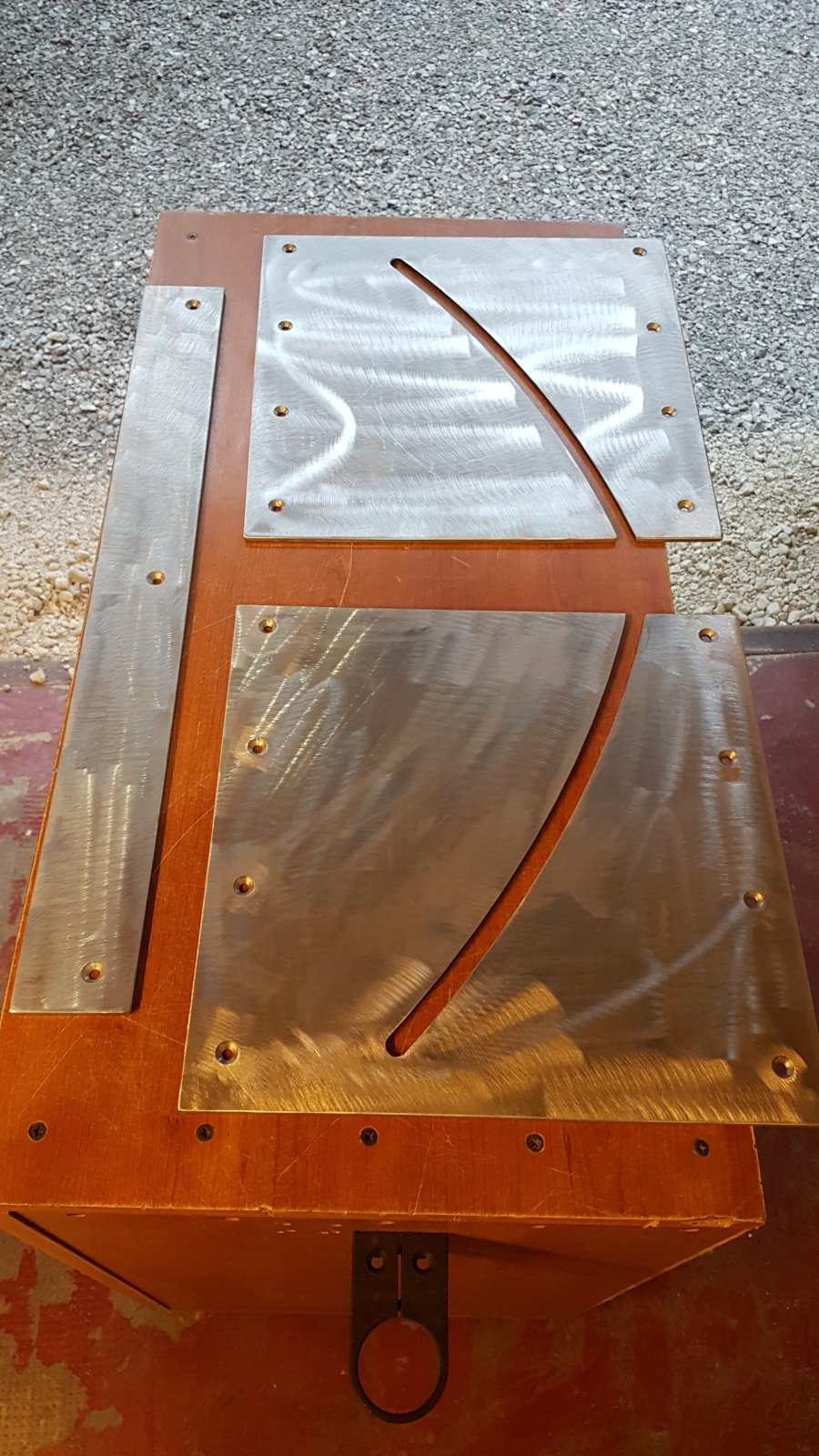

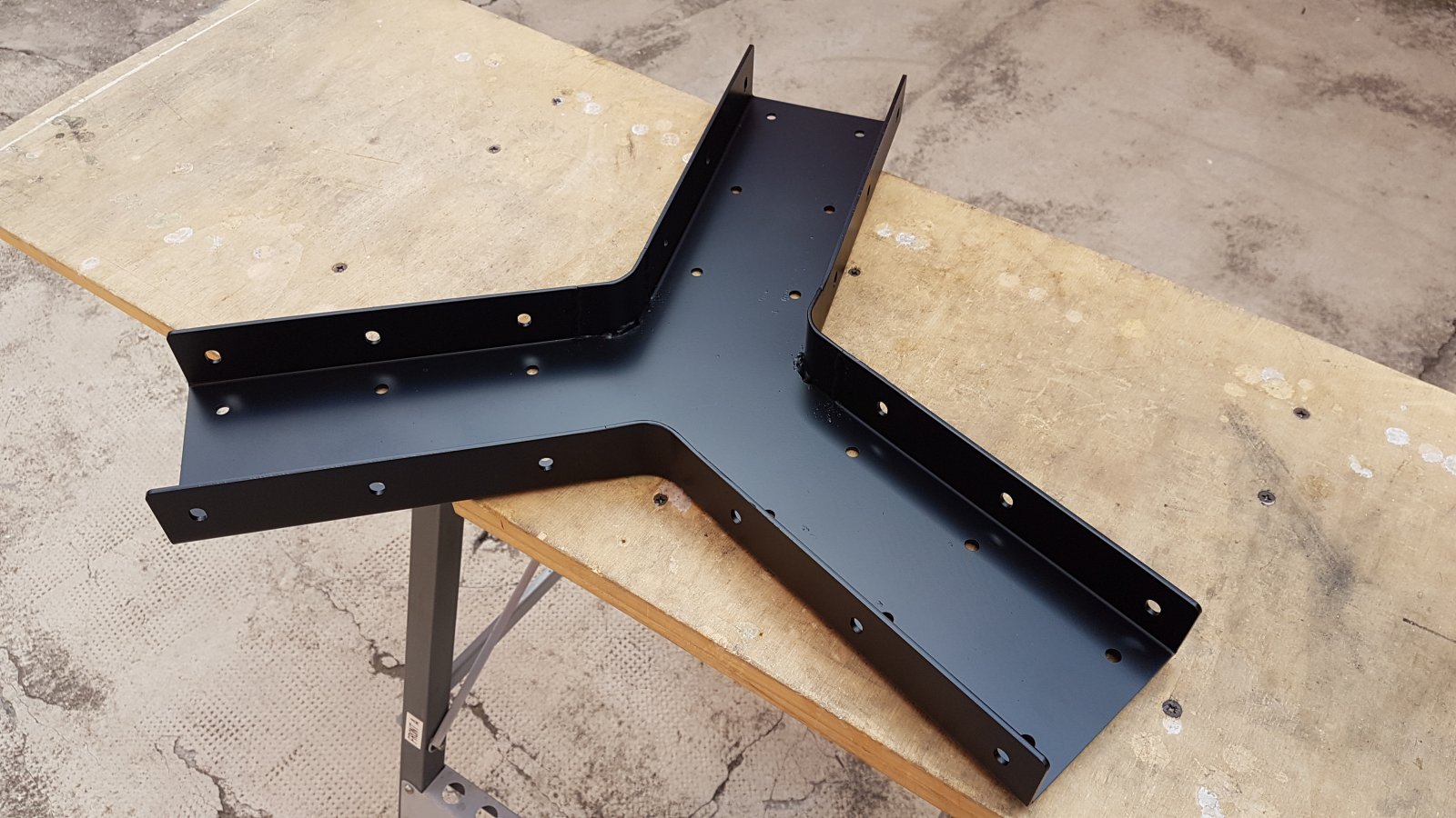

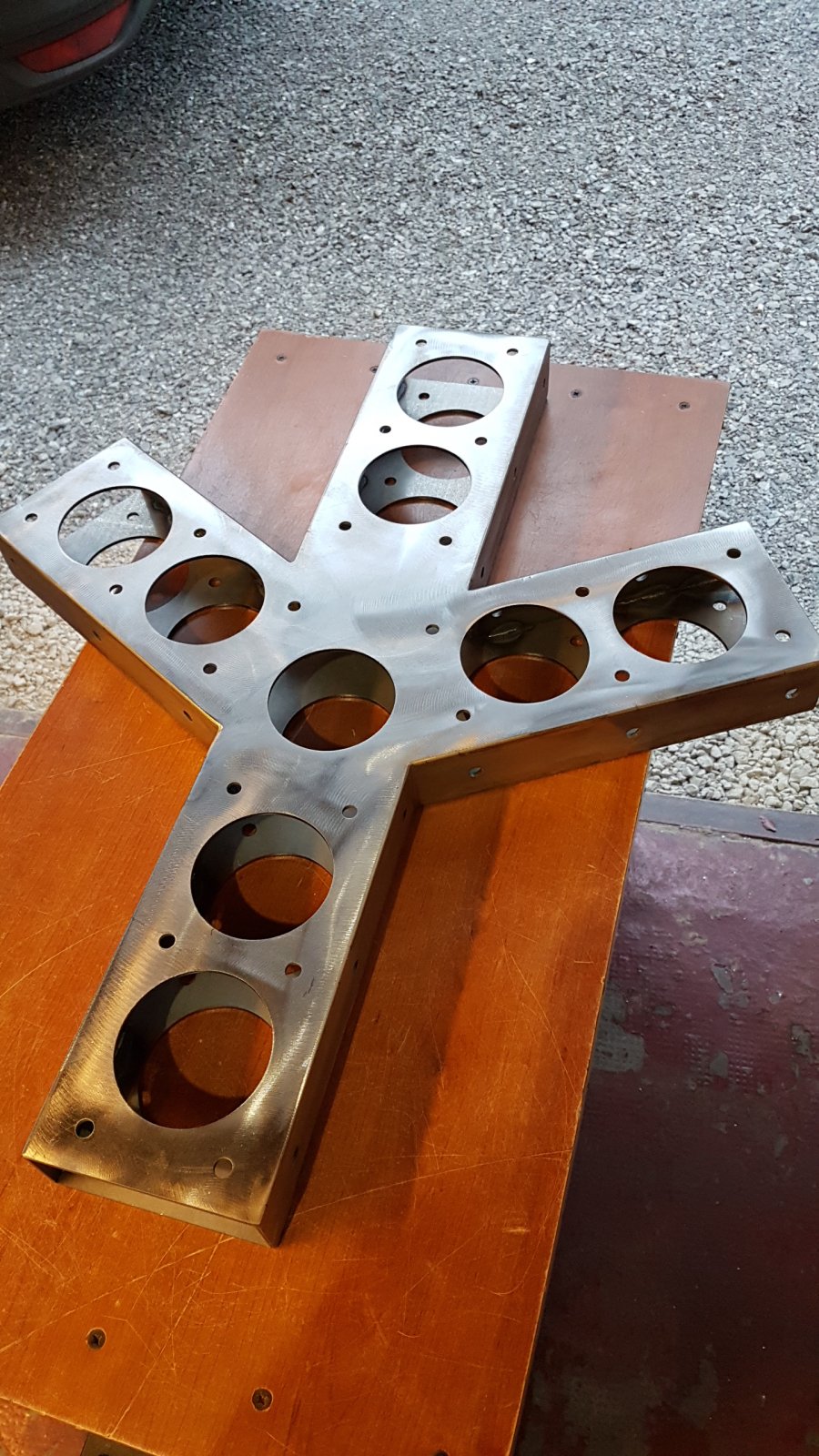

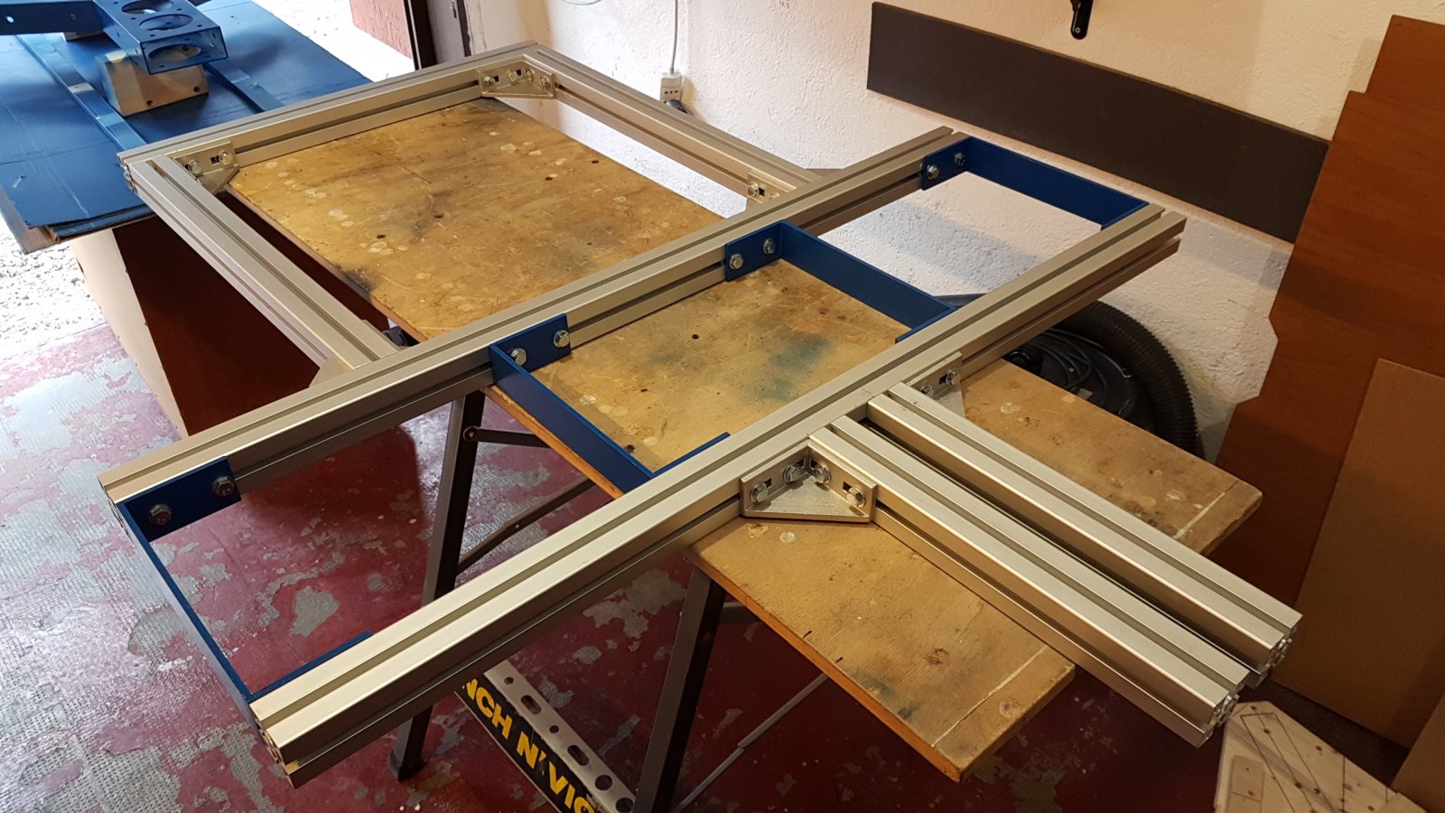

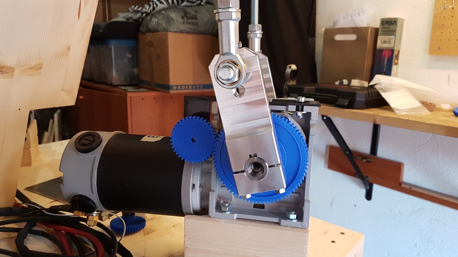

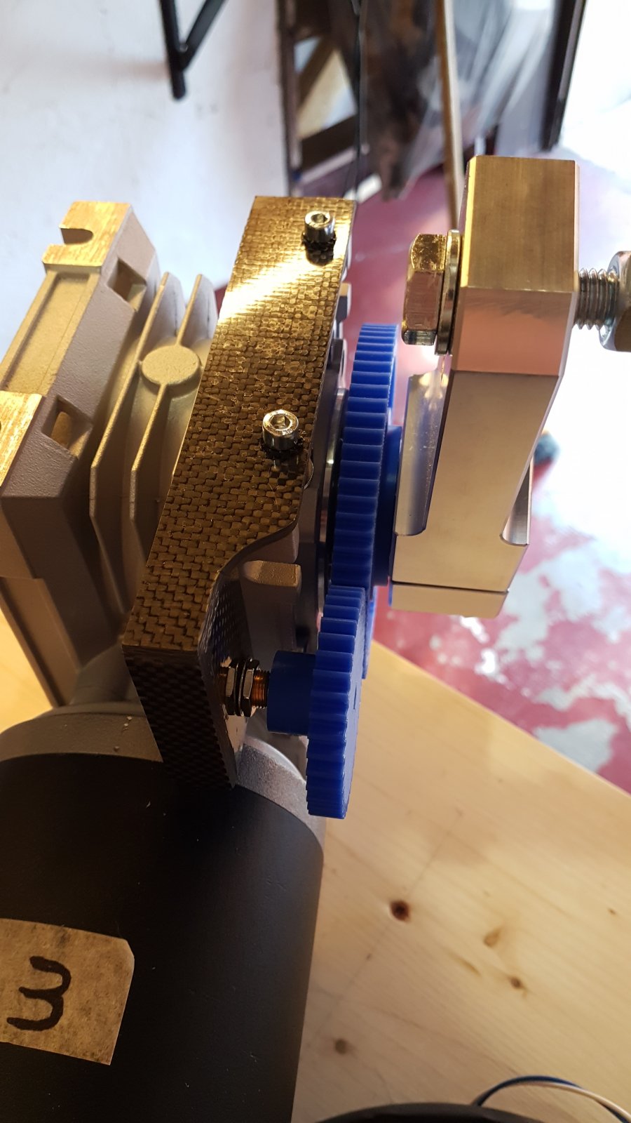

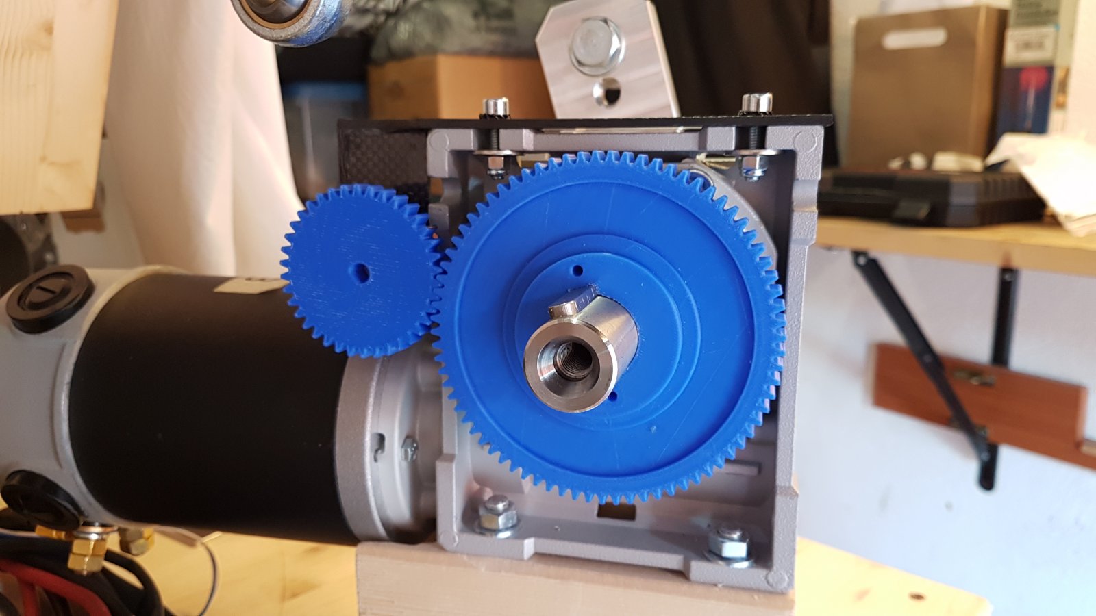

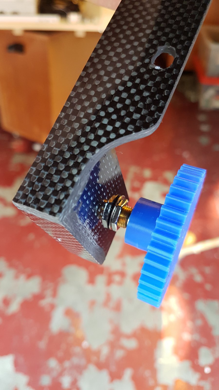

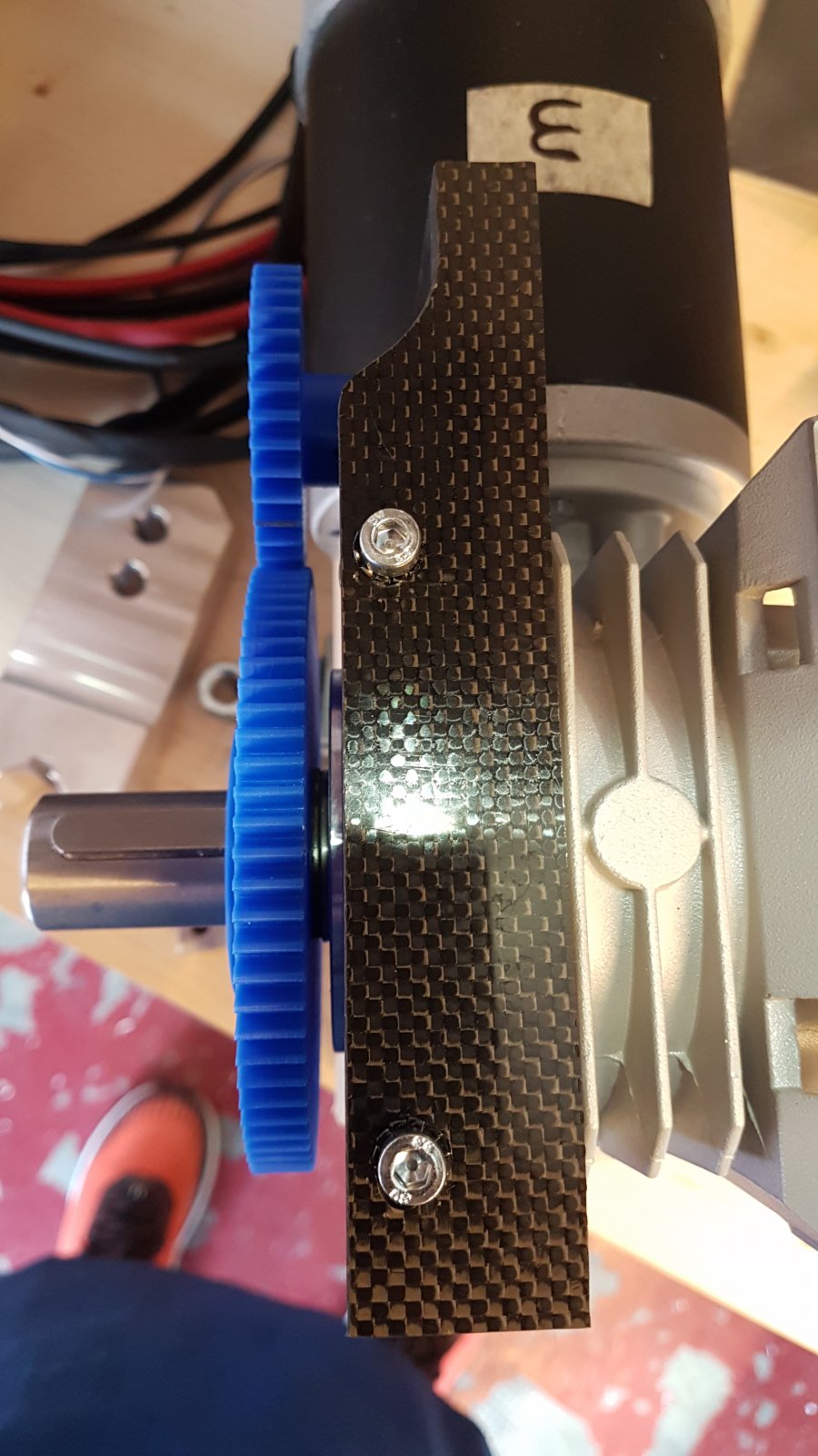

    Hello guys,
    after a short pause I resumed the project of the previous post for the upgrade from 3DOF to 4DOF.
    I made some small changes, the most important was to move the engine to the opposite side.
    Here is the project from pc to reality.
    Central star 3DOF
    Upgrade Central star 4 DOF
    Fixed base
