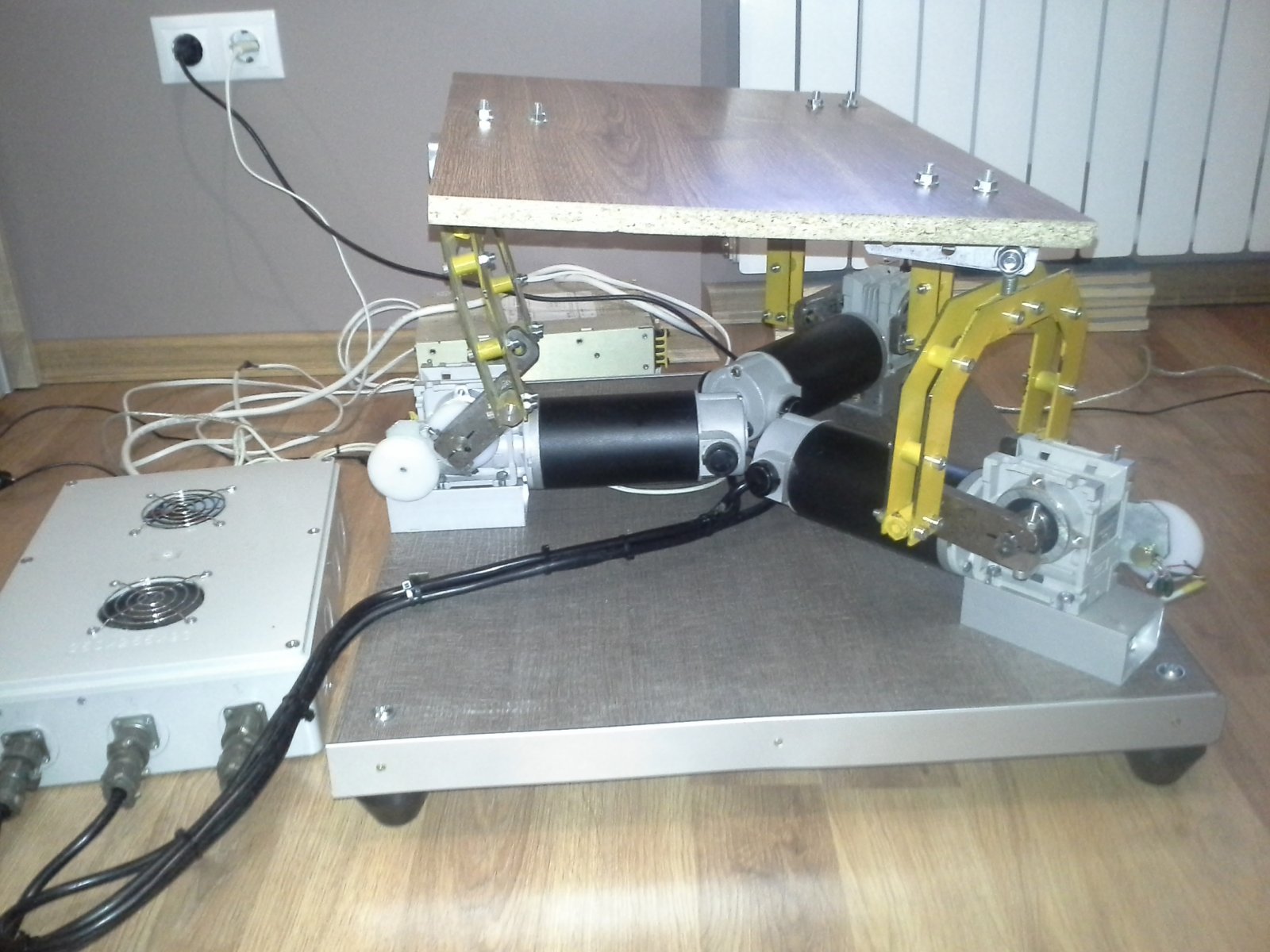

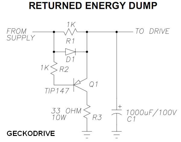

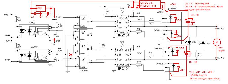

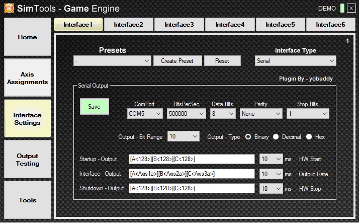

    Hello, just finished first version of my 3 dof platform.
    1) General view
    2) DIY drivers
    3) Dumper
    4) SMC3 and SimTools setup

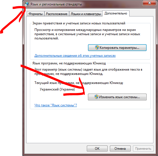

    I have troubles with SimTools. In SMC3 all motors moving smoothly, but in SimTools its randomly shaking when moving from one setpoint to other. Please help to solve problem.

  2. Vadim3333
    Vadim3333 New Member
    Apr 17, 2016
    Nikolaev, Ukraine
    192Coins
    3DOF, Arduino

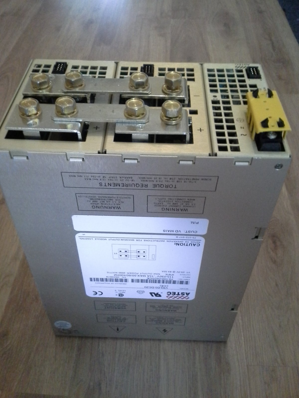

    Motors 24V 250W
    Power supply 24V 83A 2000W
  3. Radioproffi
    May 15, 2014
    135
    Lviv
    1,623Coins
    +88 / 1 / -0
    Change region settings in Windows.
  4. Vadim3333
    Apr 17, 2016
    Nikolaev, Ukraine
    192Coins
    3DOF, Arduino
    Thank you! No problem any more.

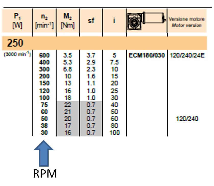

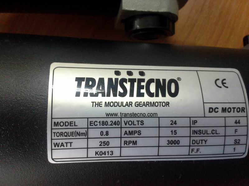

  6. Fábio Oliveira
    Fábio Oliveira New Member
    Mar 8, 2019
    96Coins
    Hi Vadim, I'm thinking in apply the same motors!!! Please, let me know about gearmotors are in your project! Follow attached the options to the motor EC180.240. Thanks in advanced!

  8. MENANDRO DALIDA JR
    MENANDRO DALIDA JR Member
    Apr 19, 2019
    53
    51Coins
    +17 / 0 / -0
    Hello Vadim, what is the ratio of your gearbox?
