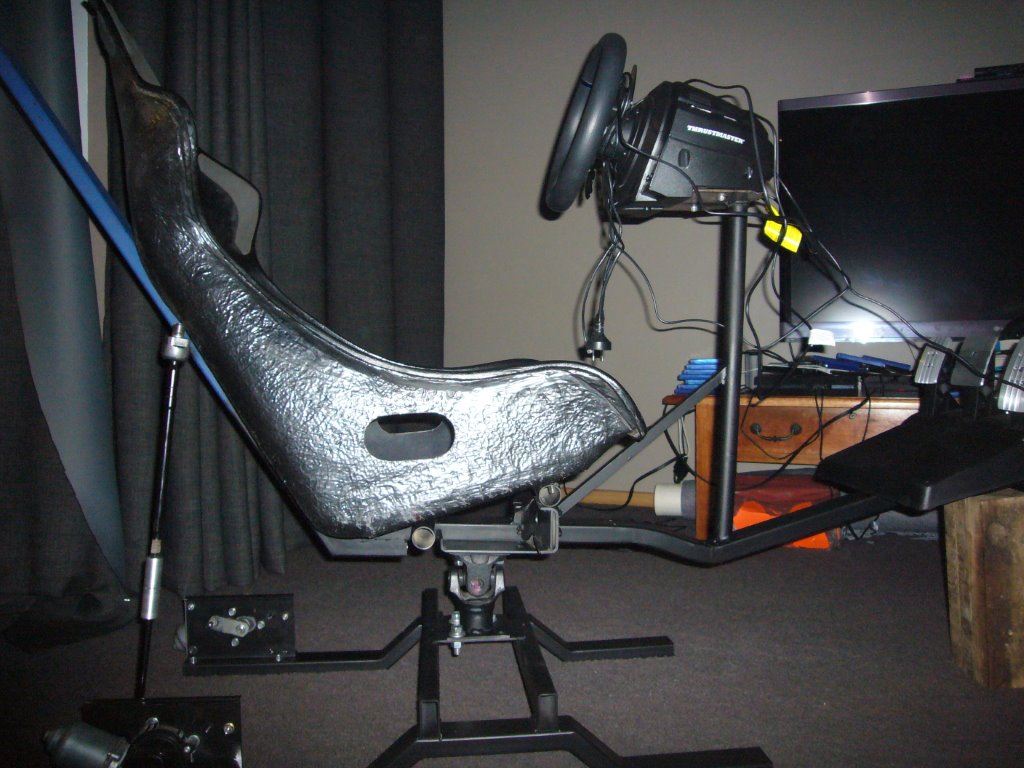

    Hello This is my 2dof build, not as good as I have seen on this site but will do to learn how to do. Next is the electronics not looking forward to that part, but will manage somehow. Hopefully I can ask some of you experts if needed.

    Hi, this weekend I am going to finish the frame and get the motors hooked up to the driver and Uno I will try some sort of testing with full weight see how my wiper motors perform, I am not sure how to go about purchasing the sim tools as I have read the are versions of it and my only option that I can see is to buy version 2 as I read it. And not sure if this is just a download or have to wait for it to arrive via postage snail mail system, any advice would be appreciated regards Ned

    Well as promised I rough finished the sim frame and connected the 2 motors, this test was just to see if all pivot joints and connecting rods would run without hitting or extend past there limits, I hooked up a car battery and ran both motors together without arduino input and of course the motors were doing full 360 turns one direction, I tell you, you would not of wanted to be in the seat for this test at very least you would have walk away with some sort of whiplash it was like a mechanical bucking bull (lmgo) now to learn how to hook up the arduino and mm motor shield and see if I can control this beast. Also purchased a new gaming computer which is now playing VR in steam with ps4 equipment it is awesome.
