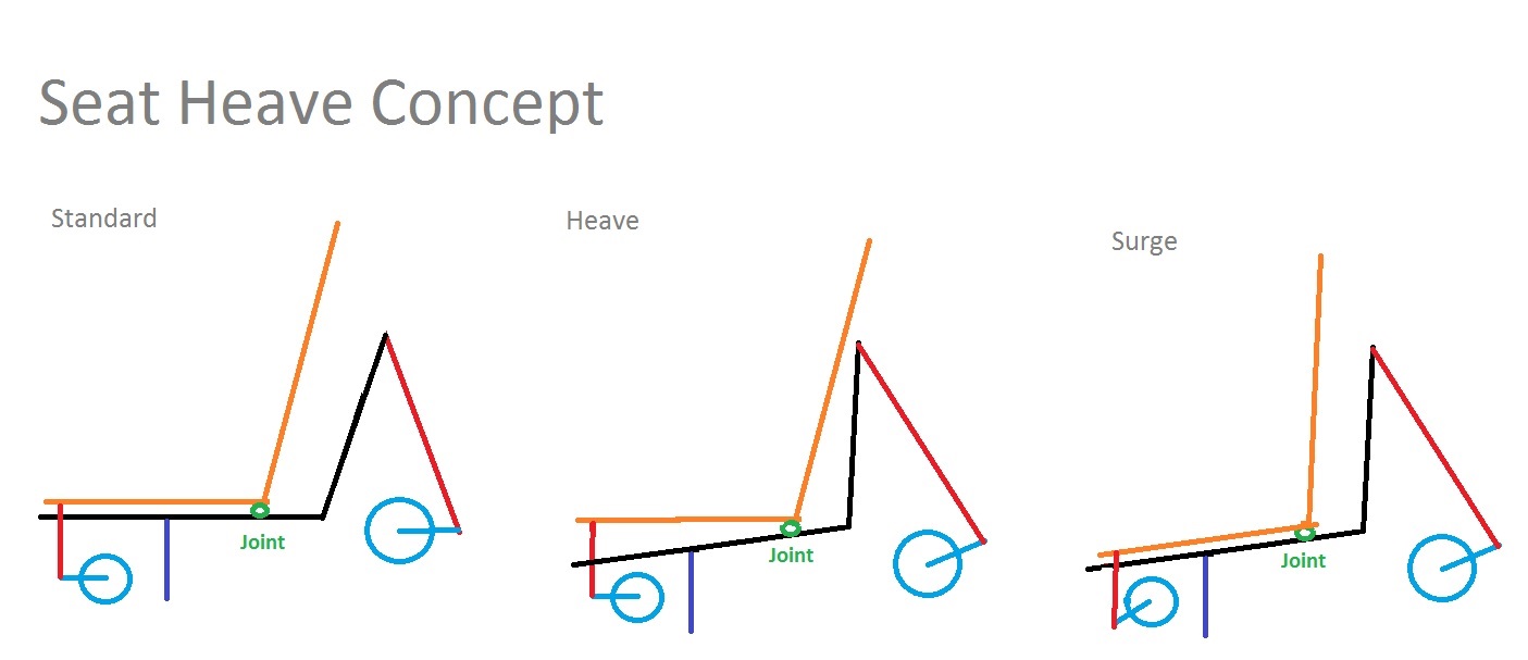

    Here an example of what you can imagine it could work (or not) :p
    The background: surge and heave of a 2DOF can - under certain circumstances - block each other. The heave concept transforms a 2DOF seat mover into a 3DOF Platform. Anyway the picture is a concept only ands show you an example how your ideas could be shared to the community.
    Any comments are welcome!
    2DOF Seat Mover Heave Concept:

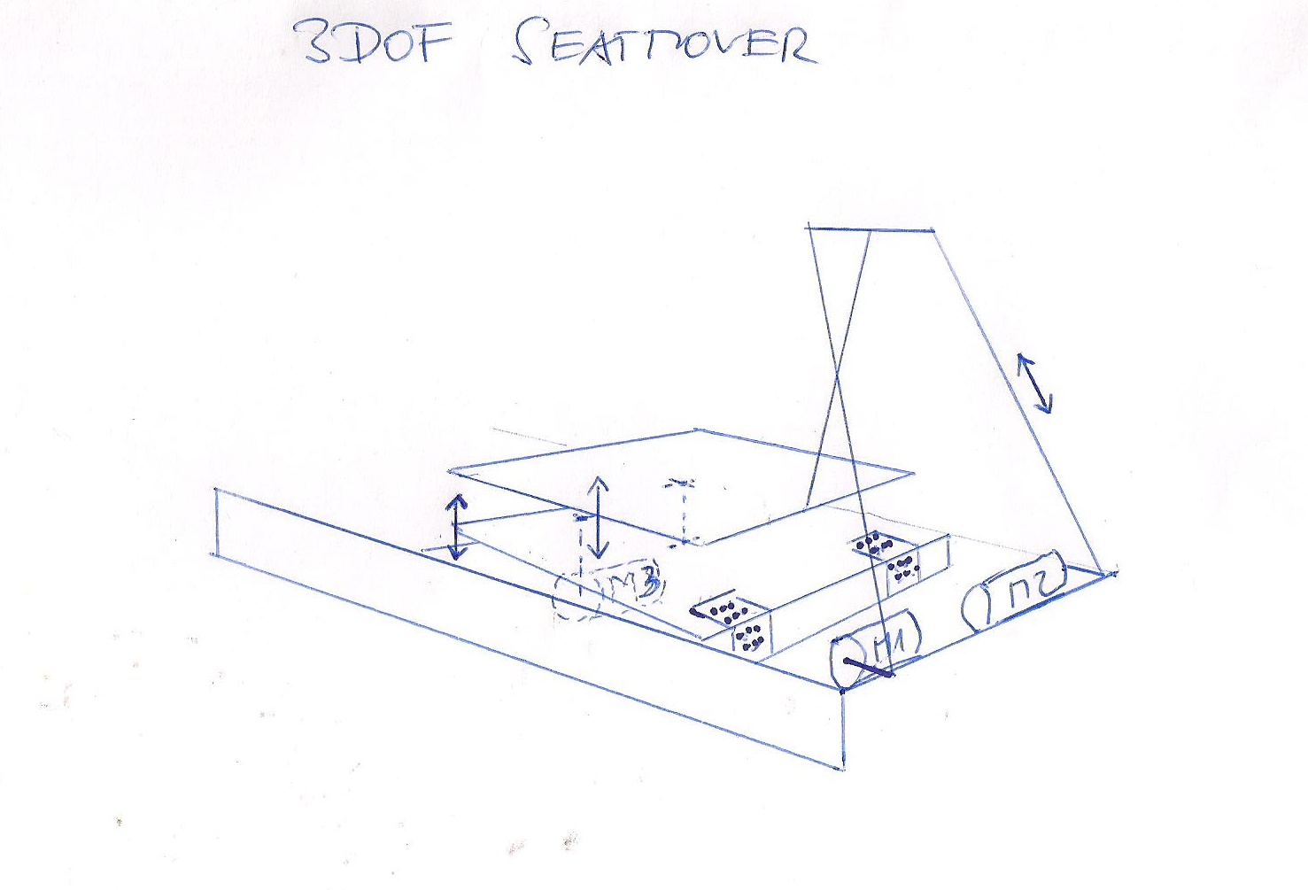

    I do not like pushing own threads anyway I would like to share my upcoming project - a 3DOF seat mover. You know usually a 3DOF is not a seat mover but a motion platform. Anyway I was thinking how to fiddle out a better heave instead of the "moving heave" of a 2DOF seat mover. Already I got a "better" heave due to the position of the joint, which is more in the front of the seat mounted than in the center of the weight (I hope my explanation makes sense to everybody ...)
    At least the third axle should to be implemented into my 2DOF without tinkering too much.
    IMO i got the solution:
    The third motor needs to be very strong. IMO my 750W winches (+ two MMs as a dual half bridge) should do the job. Nevertheless the third motor is only to lift the seat if the car is lifting, the fine vibrations coming from the surface of the track will be reproduced by the motors 1 and 2.
    PS: heave will be realized by all three motors. Only I am adding this information to avoid any confusion with.

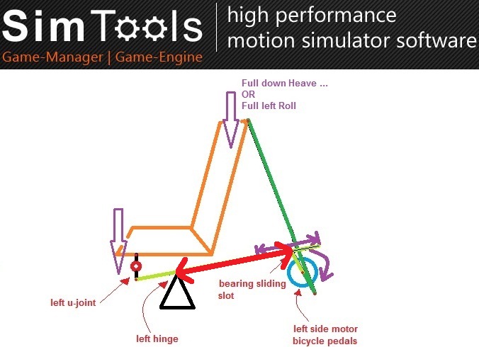

    Hi @Pit ... I wanted to see your bouncing chair video first just to make sure we don't have a conflict of interest :grin ...
    Maybe we can use just 2 motors with a double crank pedals for each motor like this ...
    So as below figure for left side motor :
    - FIRST we will have a good balance on bothe motors ...
    - SECOND we will have overall 4 controlling point to the seat that can separately simulate a 3 master forces [Heave -Roll - small Pitch angle ] ...

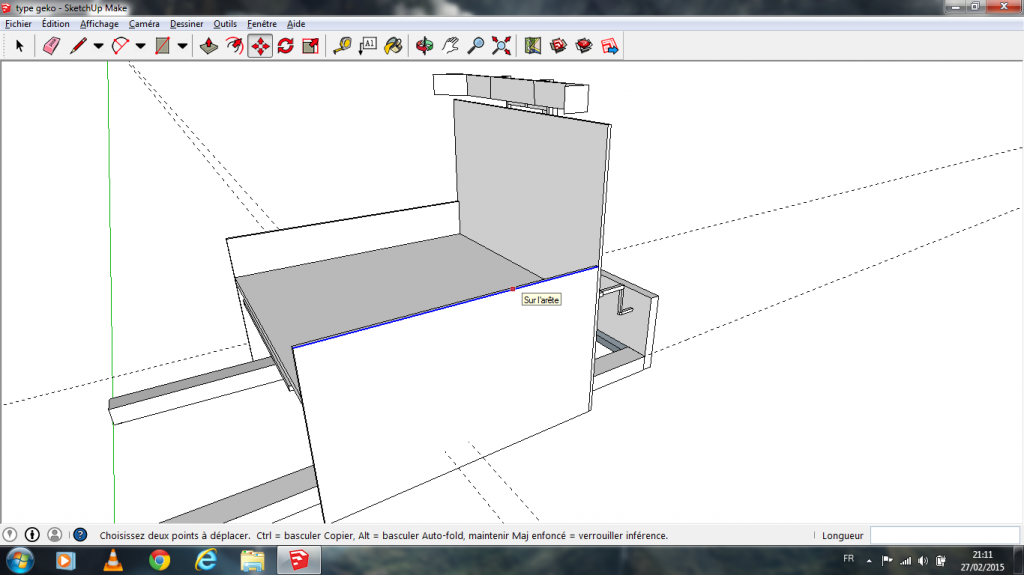

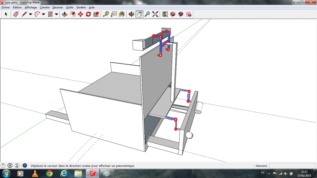

    my new project
    recovery of 2DOF base to created a geko 105 type
    the project is well advanced I give you news in few times :)
    the H translates the movements to shoulders

    Indeed I am a crank builder, you will find three cranks and two bottom brackets in my rig, but this is no reason not to support new crank concepts by other members ;)
    Second IMHO there is a fallacy with your concept - the red marked line varies in size, isn't it?

    Yeb :thumbs it varies in length as the light green crank has a circular rotation path ... and that end side has an open sliding slot for a bearing to move along it [ there is a tiny black line indicating that ].

    +3,097 / 31 / -0
