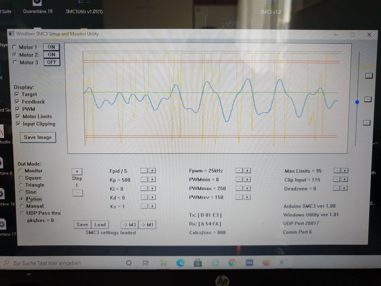

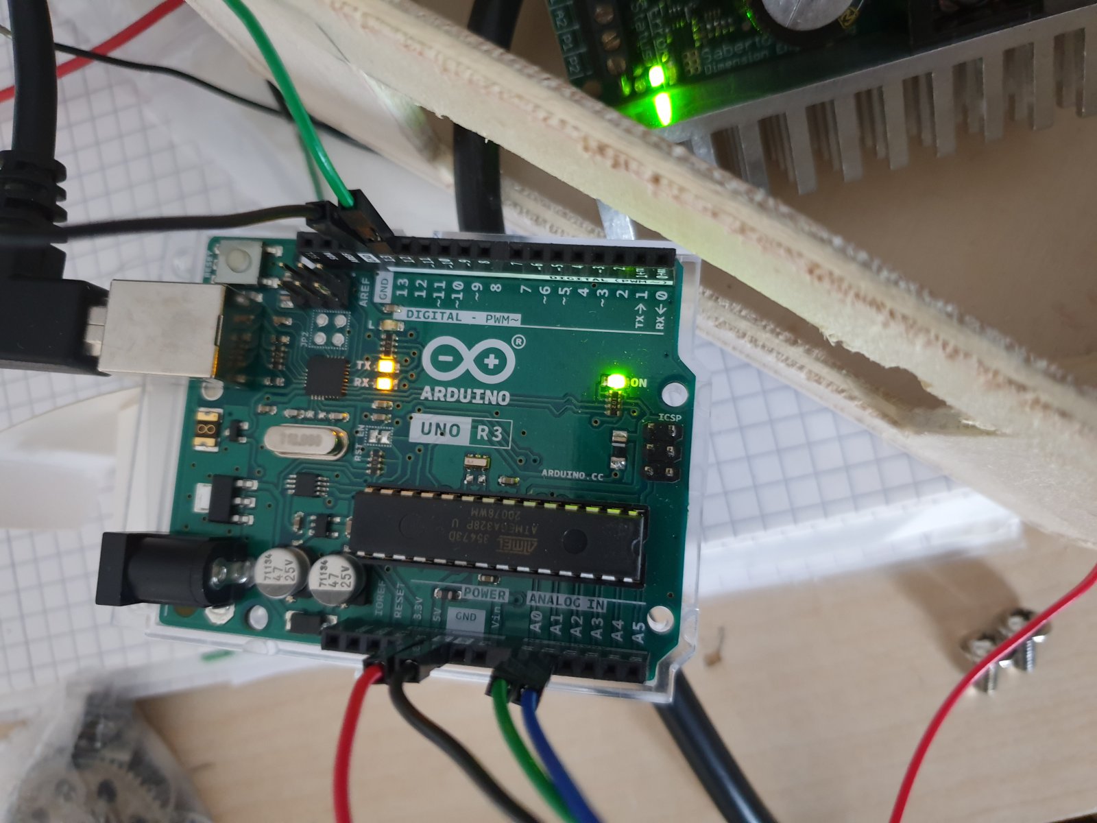

    I have the same problem. Green line is moving, motors are quiet :-(
    Meanwhile i am not sure if i have the correct potentiometer. But i think the motors should move manually somehow.
    Nothing happens

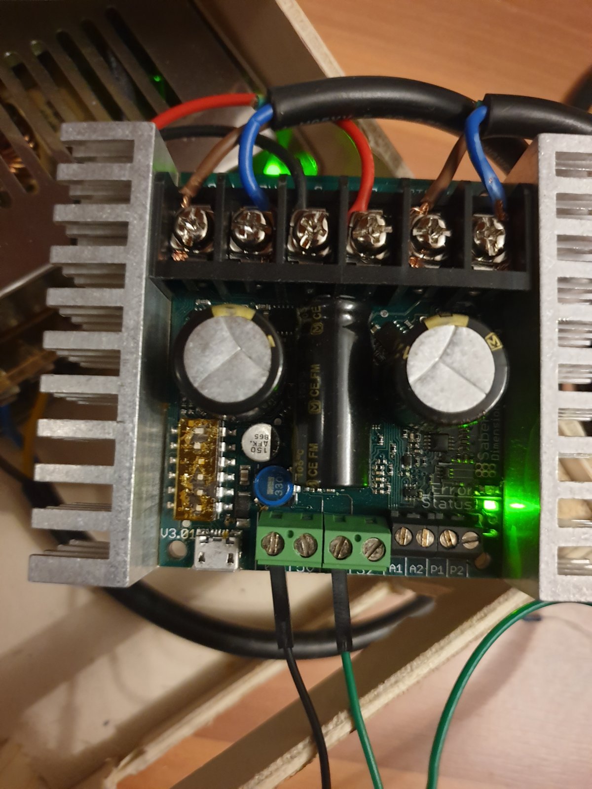

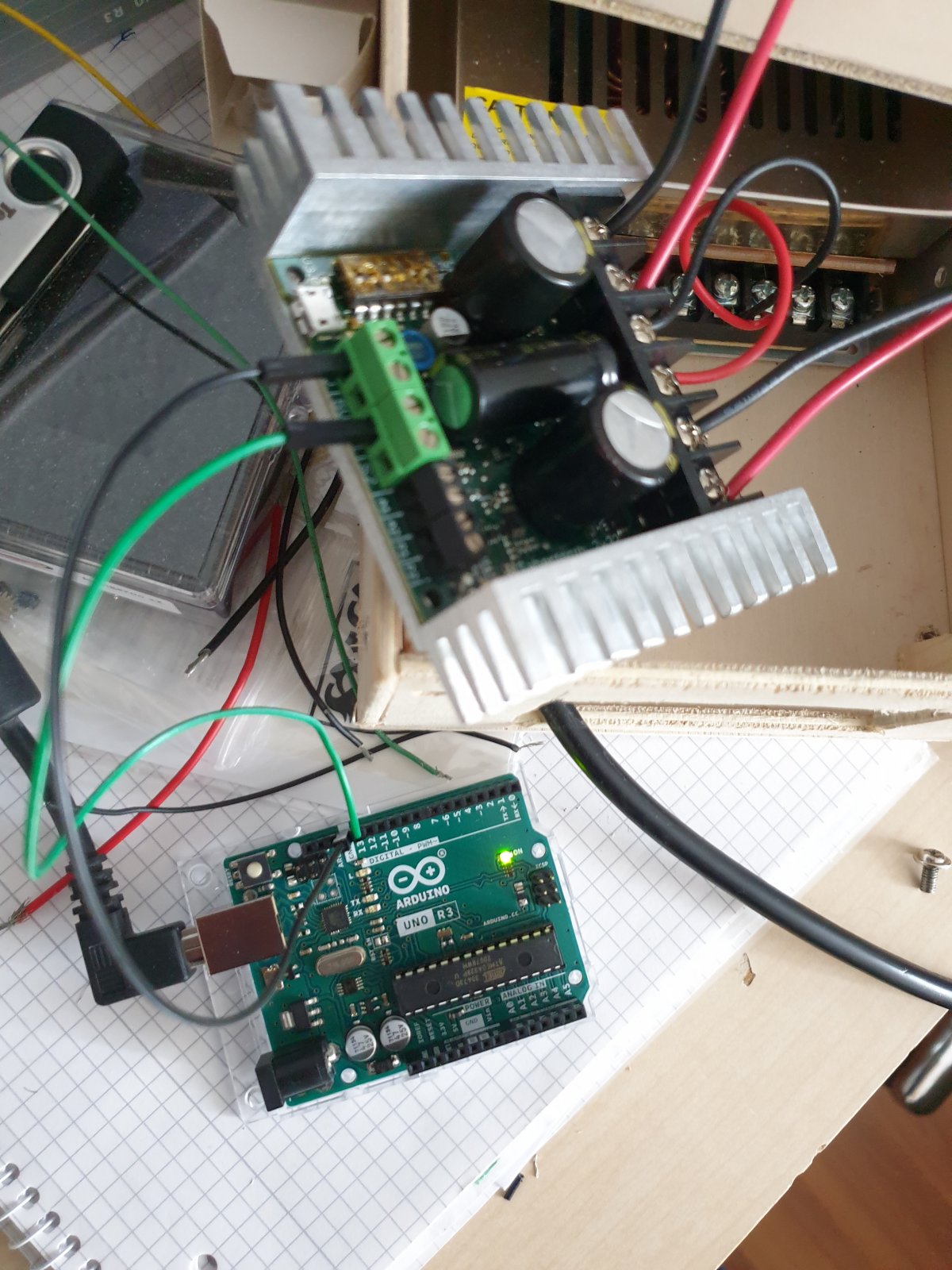

    When i switch the jumpers from the sabertooth i can see that the motors are able to move. But not controlled only permanent. It is not the serial mode then.
    But the motors are not damaged. Thats good. Only few steps ahead from the goal i hope

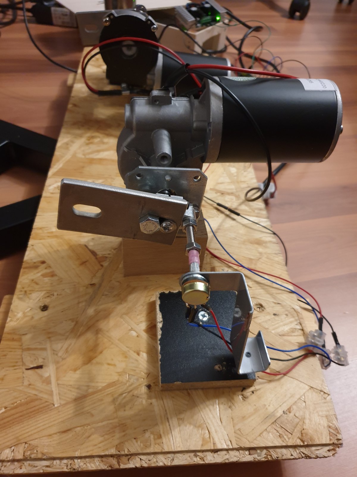

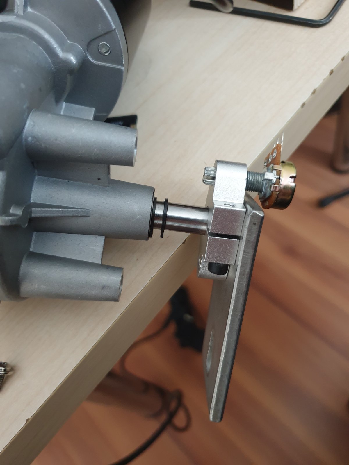

    Right now I am putting the potentiometer to the motor. Then the wiring.
    After this i will try to open util 1.01 with the sps sketch on another computer.
    Thanks for your help.

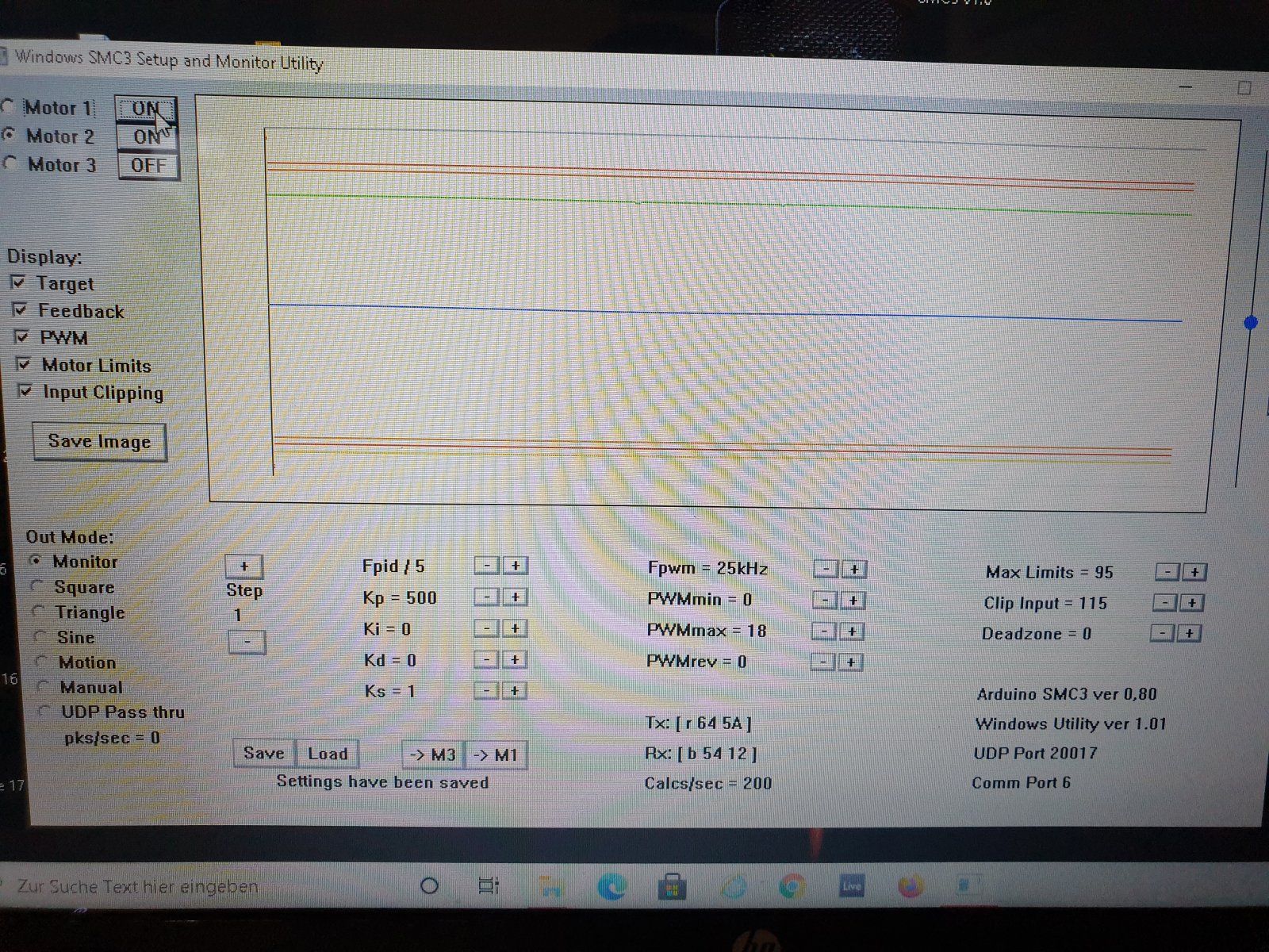

    Now I connected the pots to the motor and wired like in the diagram.
    Still using SMC sketch v 1.0
    Util v 1.01
    I will check on another computer
    Here it is the same. I have motion signal in the util smc3 setup but the motors are quiet.
    Dip settings of the sabertooth 1+2 off 3,4,5,6 on

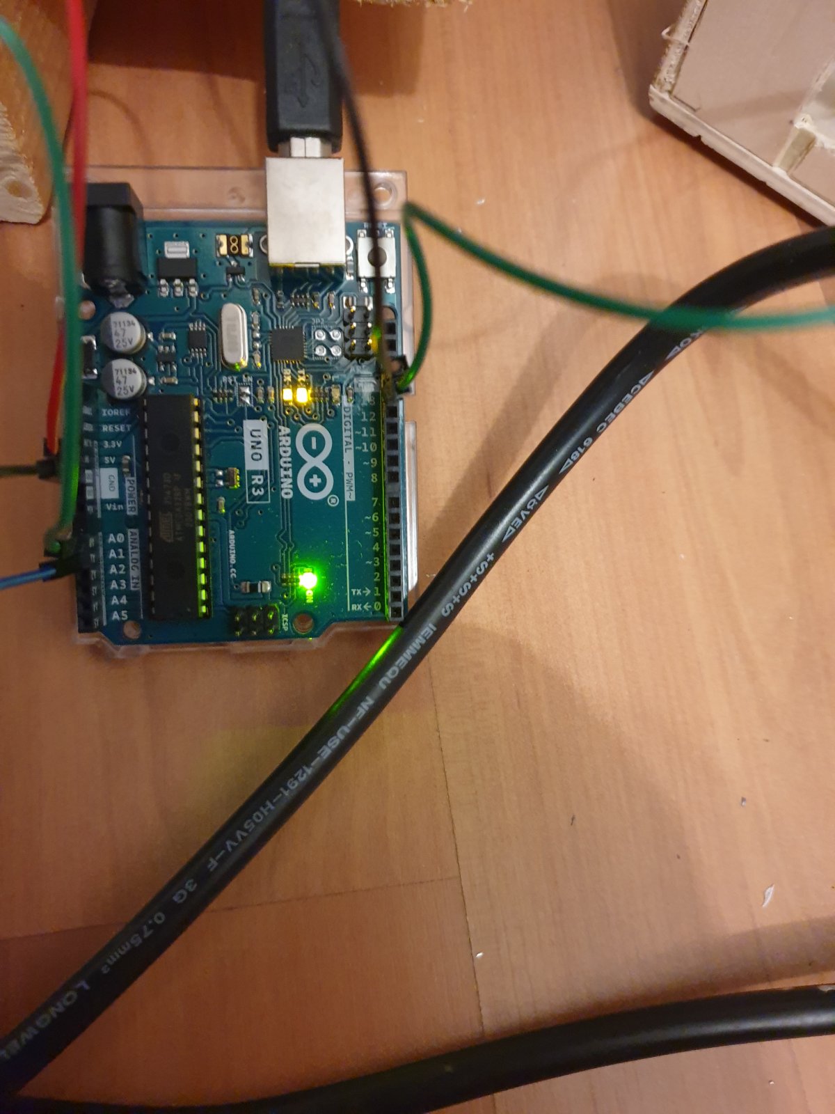

    I installed the beta sketch
    I prepared my motors for testing
    I started util v1.01 successfully
    I set the jumpers from the sabertooth 2x32 to only serial mode.
    No effect to the motors.
    Quiet
    Hmm ??

    To put a sabertooth in simple serial mode at 38400 baud set it's dip switches as follows: 1-on, 2-off, 3-on, 4-off, 5-off, 6-on.
  14. BlazinH
    BlazinH Well-Known Member
    Oct 19, 2013
    2,145
    Oklahoma City, USA
    16,659Coins
    +1,839 / 32 / -1
    Scratch those settings in previous post. That's the dip settings for V1 Sabertooth's and the 2x32 is a V2. Set switches for V2 as follows: off,off,on,off,on, off. Then you have to use DEscribe software to set the user defined simple serial baud to 38400 (default is 2400). https://www.dimensionengineering.com/products/sabertooth2x32

    I think i tried it. On the photo maybe i changed the pins to look what would happen.
    I will try later. After work.
    I hope this week the motors will move

    Hello, now i am back from work and already testing. I wanted to report.
    I tested few sketches now after nothing was really working.
    After reading in this top forum, i found the smc3 packet serial beta 8.1 softstart.
    With this sketch i could open the util v1.01 and the sabertooth (jumper off off on on on on / packet serial mode like the sketch said ) and....tatttaaaa the motors got connection. The first time. What a great moment.
    Now I will fix my potentiometer in a different way and will go on.
    This was a good day :-D
    Thank you all. Great

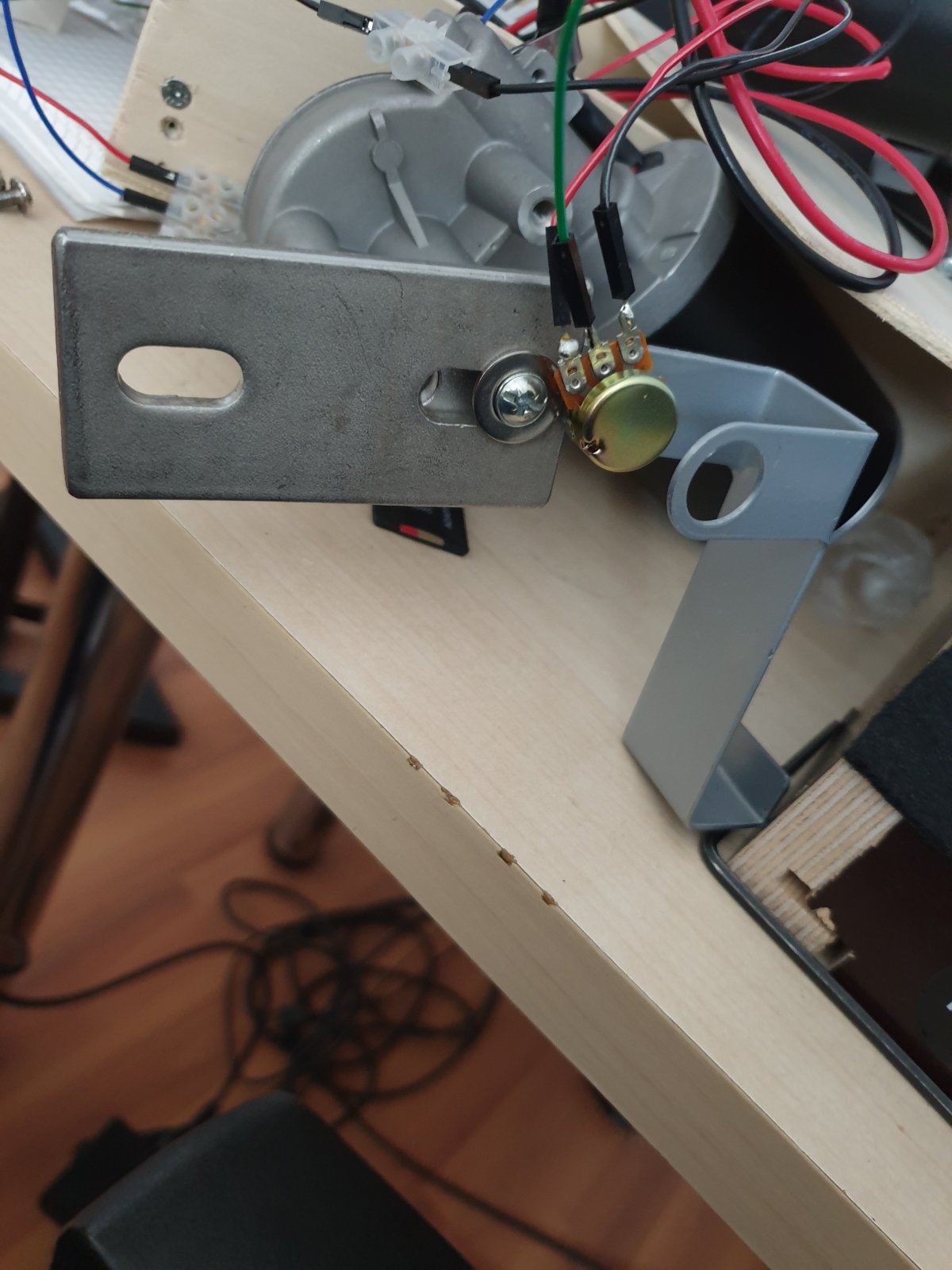

    Now I mounted the potentiometer to the motors and it seems to work good with SMC 3 setup.

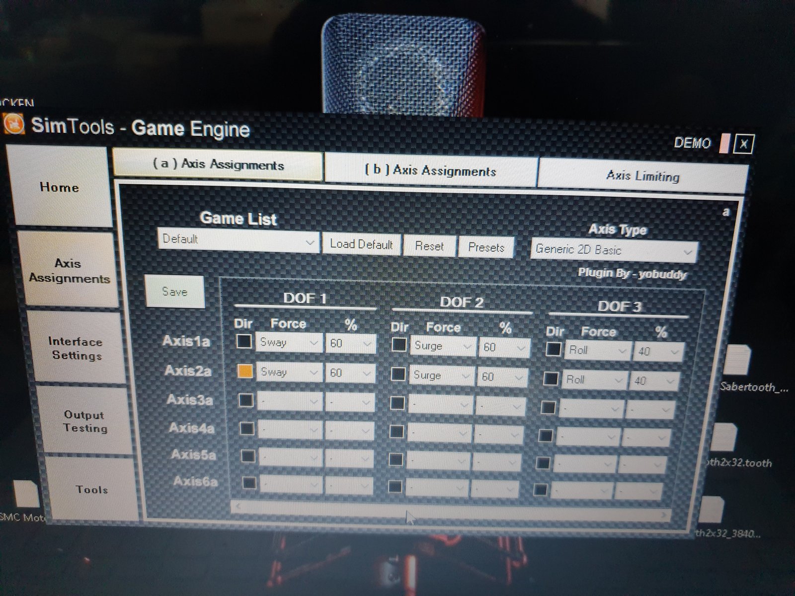

    But in simtools i am not able to move the motors. I think i have the wrong interface settings. Maybe someone has an idea for me :)
  18. noorbeast
    21,597
    151,245Coins
    Please post pictures of all of your SimTools settings.
    For SimTools 2 the Interface Settings should be like this, but make sure you use the correct ComPort for your hardware:

    I followed yiur advice and it seems that i have a connection now.
    I recognized, that everytime when i open SMC3 Setup, my settings are not the same.
    My question is, do i have to open SMC Studio everytime before playing to check ?
    And now i will go on struggeling with sim tools. When i open it the motors are moving immediately. I was thinking they will stay in their starting position till i control them or start to play a game.
    My final goal is to use UDP and play with xbox. I know that only few games are supported with UDP but it would be enough to have fun.
