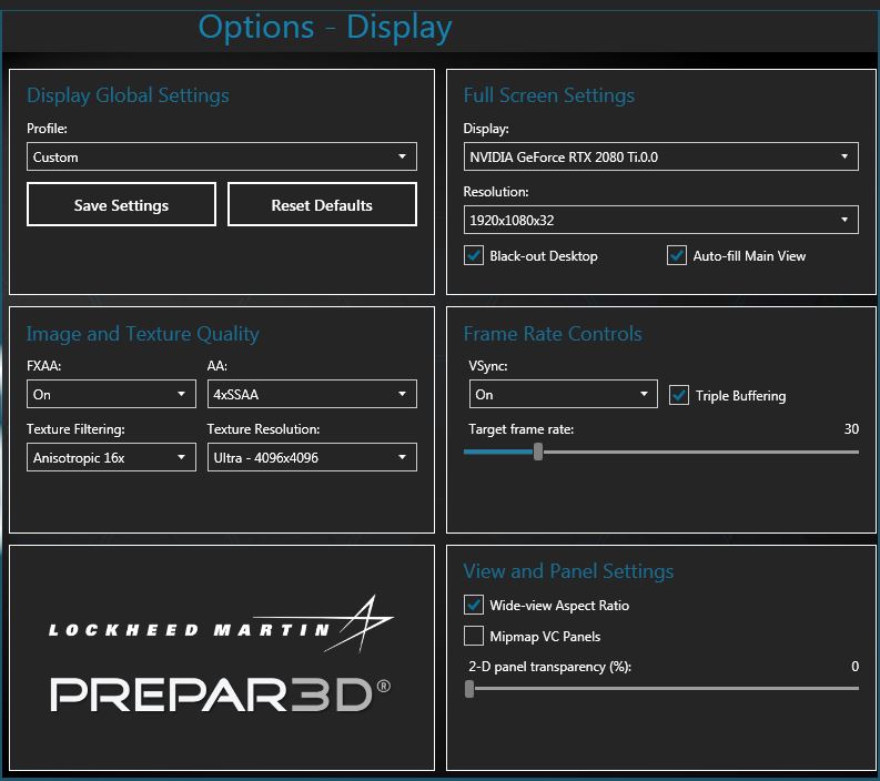

    gentlemen, ladies,
    I have enjoyed using P3D V.4 on Windows 7 software for years.
    I fly in my self-built Flight Simulator. See my website www.ph-nic.eu
    I recently made a DIY Motion floor with 2 servo motors.
    These are controlled with Arduino-Uno, Simtools and Patch for connection to P3D. There is contact with the program but the movements are very minimal! I have enabled the "Allow Turbulence" option. I think I'm doing something wrong but can't figure out what. Not much to be found on the web.
    Can you help me.

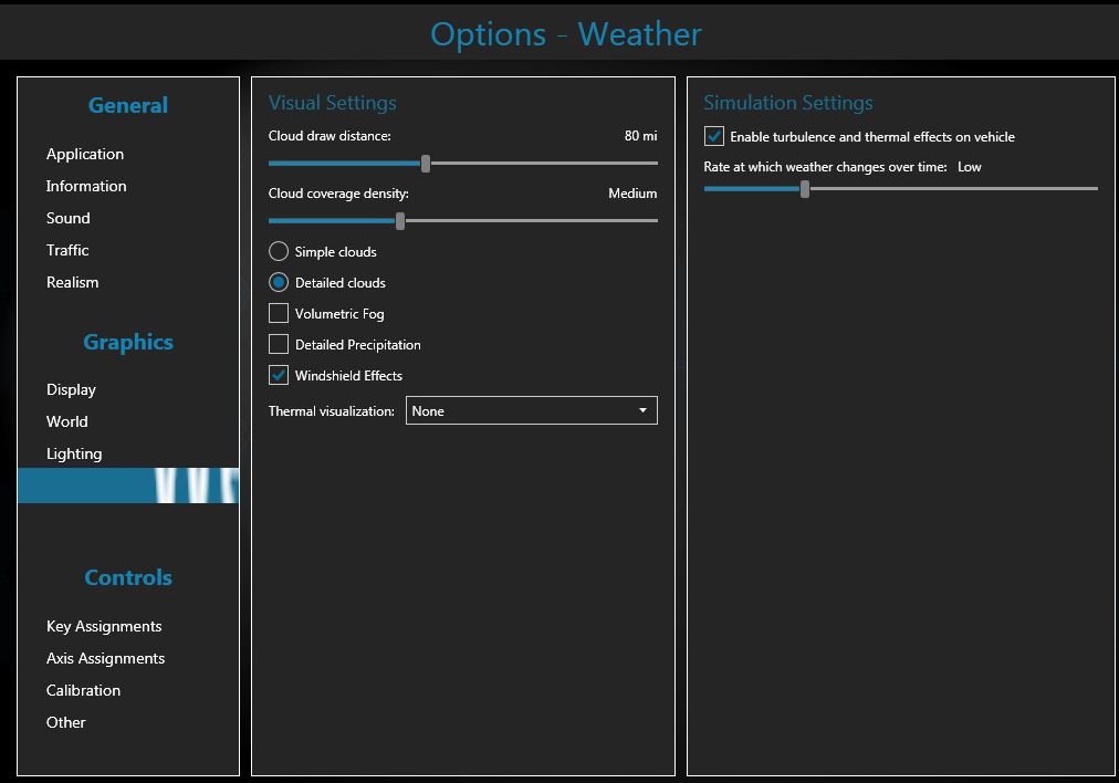

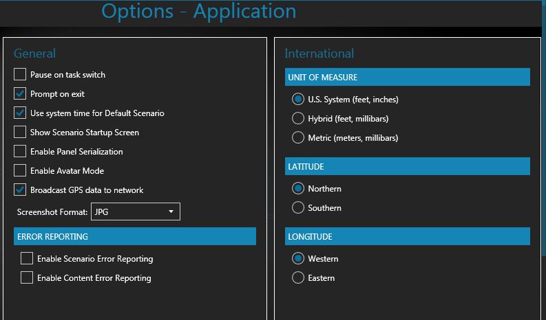

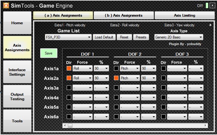

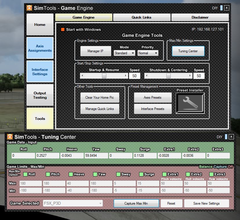

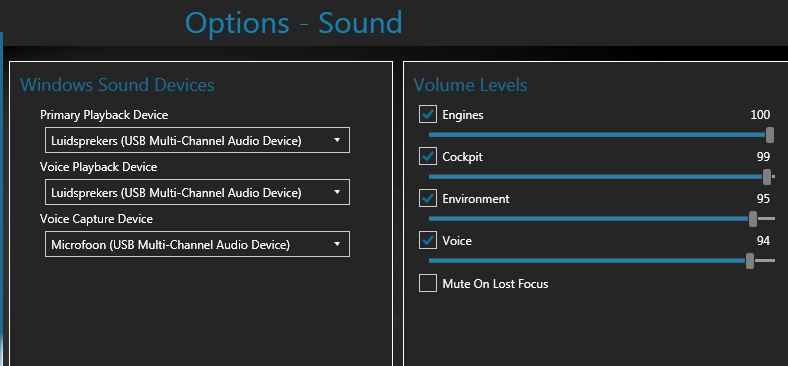

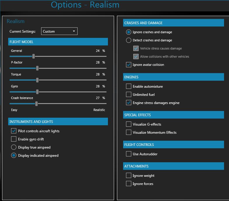

    Can you please post pictures of all of your settings, including the Tuning Center while P3D is running.
    You may find @Archie's P3D profile tips helpful: https://www.xsimulator.net/community/faq/prepar3d-guide-to-realistic-motion-settings.144/
  11. Nico Weesjes
    Nico Weesjes Finally my 2DOV DIY Motion working.
    Jun 7, 2020
    11Coins
    +8 / 0 / -0
    Thank you for your fast response,
    Is this what you want to see?
    thanks
    [GRAPHICS]

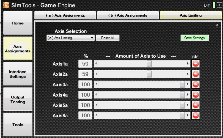

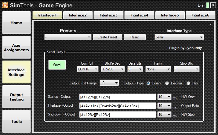

    No @Nico Weesjes, I mean pictures of all of your SimTools settings, including the Tuning Center while P3D is running
  13. Nico Weesjes
    Jun 7, 2020
    11Coins
    +8 / 0 / -0
    Thanks for your quick response, sorry for the misunderstanding!
    Are the accompanying images sufficient?
    Thank you very much for your support.
    Nico Weesjes
    22,210
    154,723Coins
    +11,213 / 57 / -2
    OK, a couple of things, SMC3 needs to be fully sorted and working as expected before messing with SimTools, and by the looks of the green feedback line SMC3 settings likely needs some refinement.
    When it comes to SimTools why are you using so much Axis Limiting, is there a potential hardware damage related reason? If not then leave it at 100% as that will be greatly limiting the range of the hardware movement.
    Grab a copy of the SimTools manual and keep it handy for reference: https://www.xsimulator.net/community/faq/rtfm-start-with-the-official-simtools-documentation.117/
    Once SMC3 is fully sorted see these tips for refining a motion profile: https://www.xsimulator.net/community/faq/steps-to-create-a-motion-profile.228/
    For flight profiles you are correct in using large Axis Assignments, as other than for harsh aerobatics or a crash it is unlikely you will use the full allocation for all axis at the same time.
    With the Tuning Center the larger the value the slower and smoother the response, over a greater range, and the smaller the value the sharper the response nut over a smaller range.
