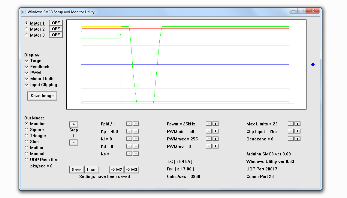

    Under Window SMC3 Ultility set up, it's communicating with Adruino. When I move the POT, the green line go up and down... but no motor output (no voltage).

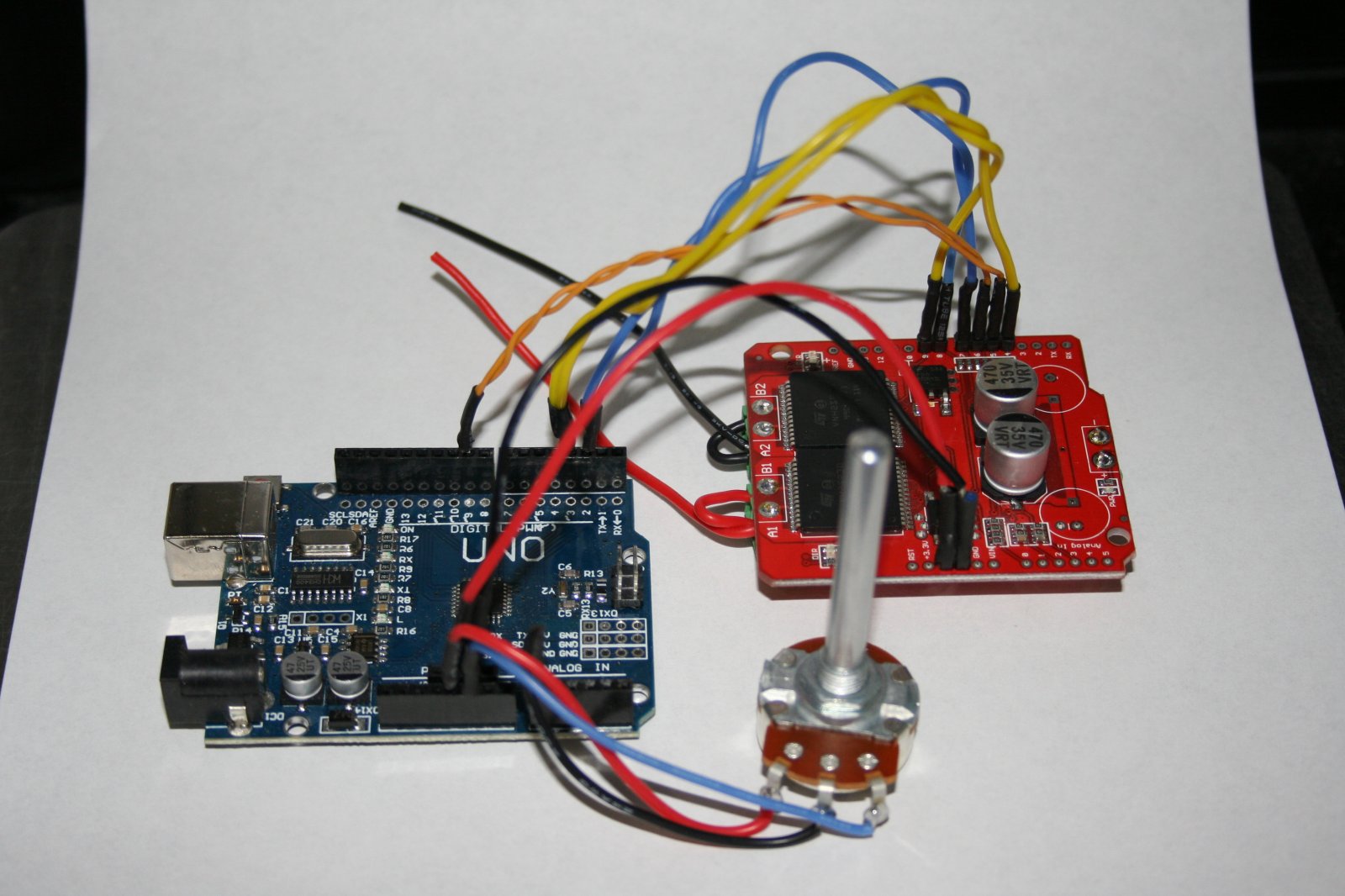

    I wired this correctly right?
    Ardruino 9 to Moto 5,6
    Adruino 3 to Moto 4,9
    Adruino 2 to Moto 7,8
    Moto: A1 with B1 and A2 with B2
    A0 to center pin of POT, left outter to ground, right outter pin to 5V.
    When I power everything on, when I turn the pot by hand I can see the green signal changing. Attached image

    put the pot at the middle position IE for 180 deg pot at 90 deg and then open smc3utls and see if motors are off (top left corner). if it says off click on it to turn it on. your motors are off
    wiring seems to be good. could be some faulty MM too if all are configed properly first

    Ok got it... it seem I didn't realized it's in testing mode... therefor turning the pot too much causing it to shut off.

    it looks like #2 is the runner (signal) but you can take some measurements with a multimeter if you have one to be sure

    Sigh... this is frustrating... Window SMC3 would connect to Ardruino just fine... then if I disconnect it and reconnect then nothing... 50/50 chance... not sure why....

    So I got it working on my office PC... then now I am switching it to the gaming PC to do some testing... I install Arduino Driver and Software and Ardruino seem to be working fine... I can loaded the code and verified it. Show comp port 23 is being used.
    But same old problem again, can't seem to get Window SMC3 to detect Ardruino... At first it will still showing Com 23 on the right corner, but it doesn't work... but after switching around USB port, it now keep saying Com 7.... even though I think my adruino is plug in to Com 23.
    Any idea what I have to do? I am pretty sure the USB cable is fine and there's connect between Adruino and my pc... because I can load the firmware no problem... What else am I missing? The Window SMC3 Ultility doesn't seem to have any configuration need to be done?
  20. RufusDufus
    RufusDufus Well-Known Member
    Jul 21, 2013
    681
    Adelaide Australia
    16,493Coins
    +1,016 / 10 / -1
    You need to make sure the comm port is configured correctly in SMC3Utils.ini file
    Also SMC3Utils will not work at the same time as simtools.
    Can you post a screenshot of when it is not working.
