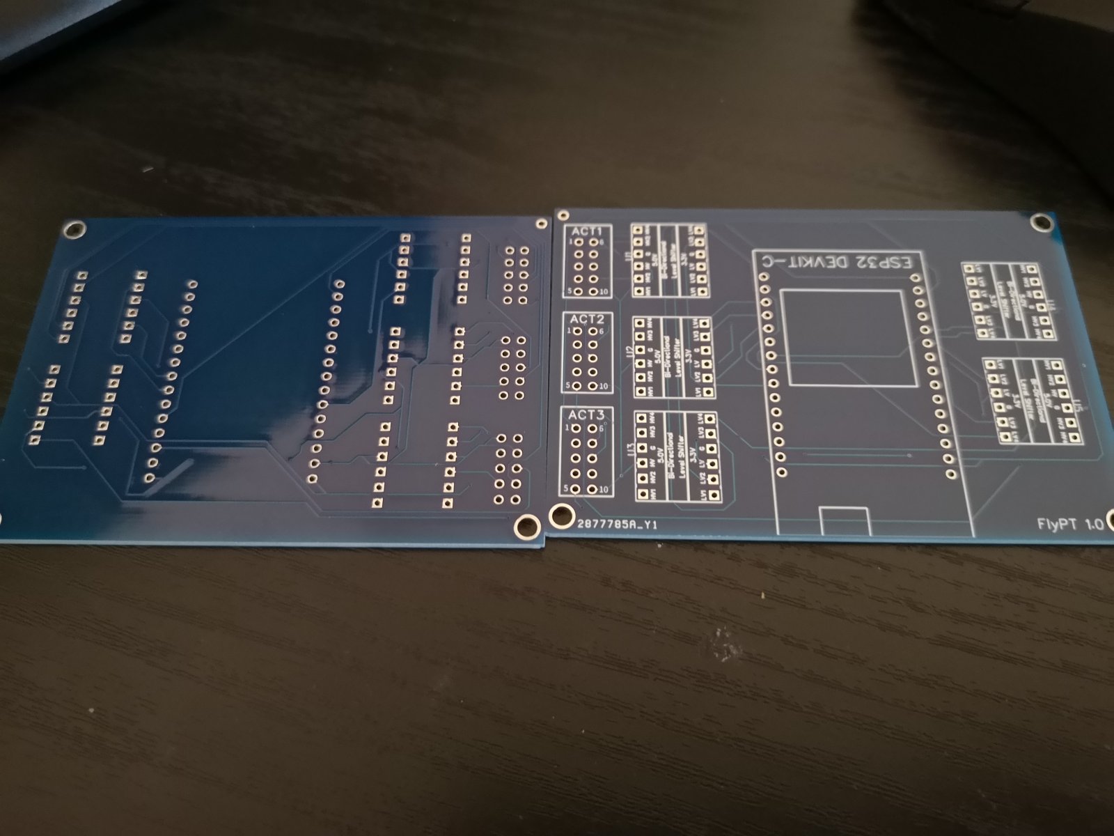

    The board is at least working for one actuator.. The connectors for actuator 2 and 3 are still untested

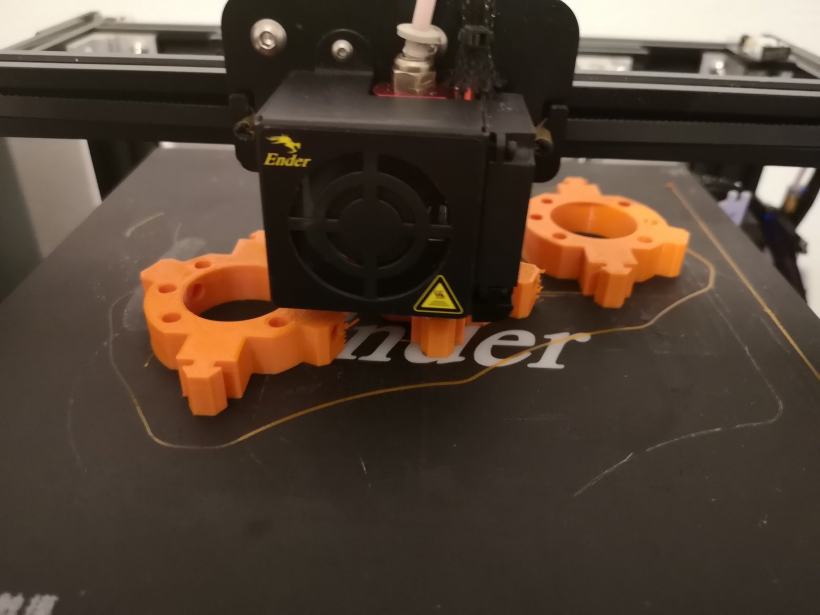

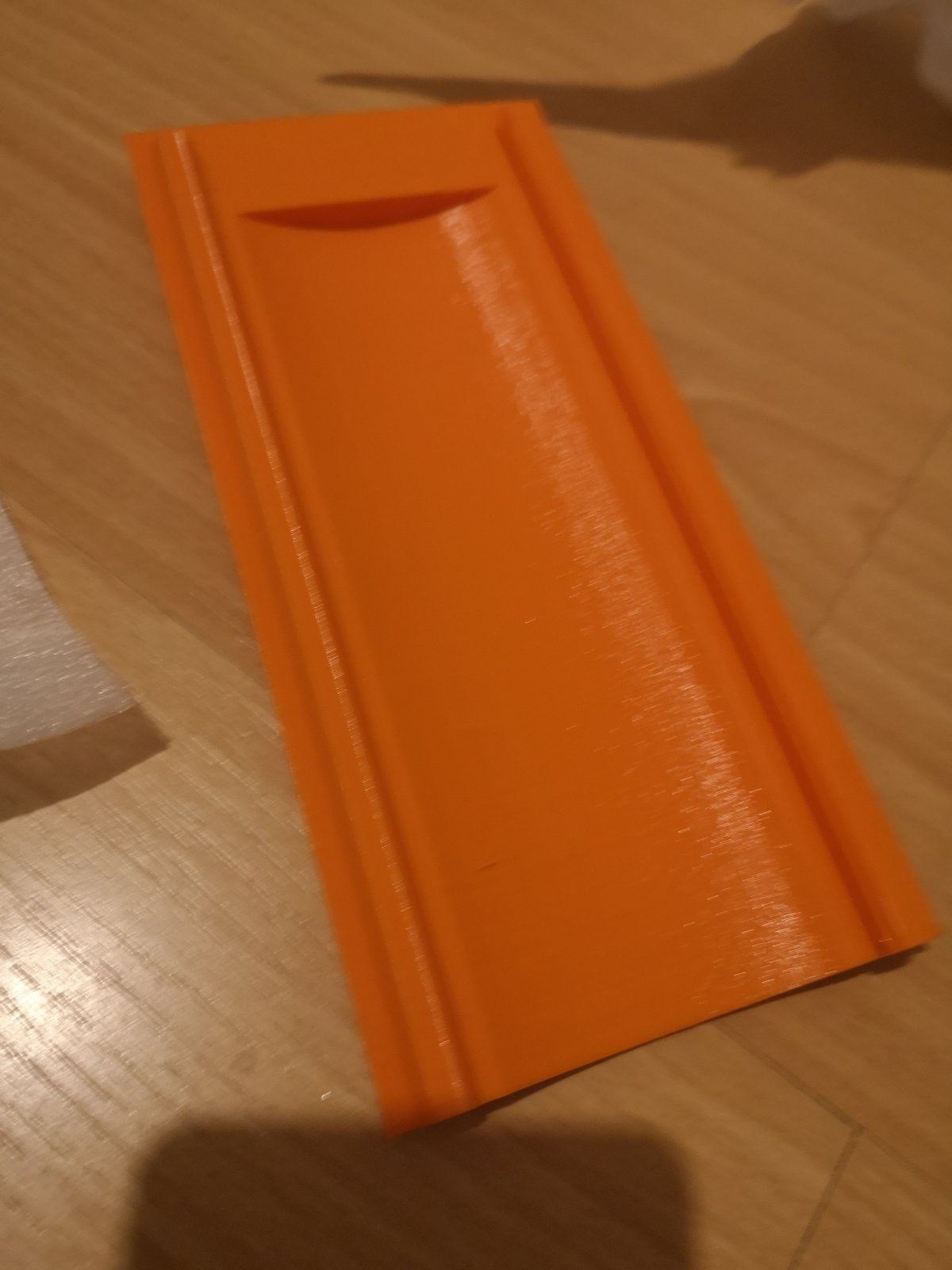

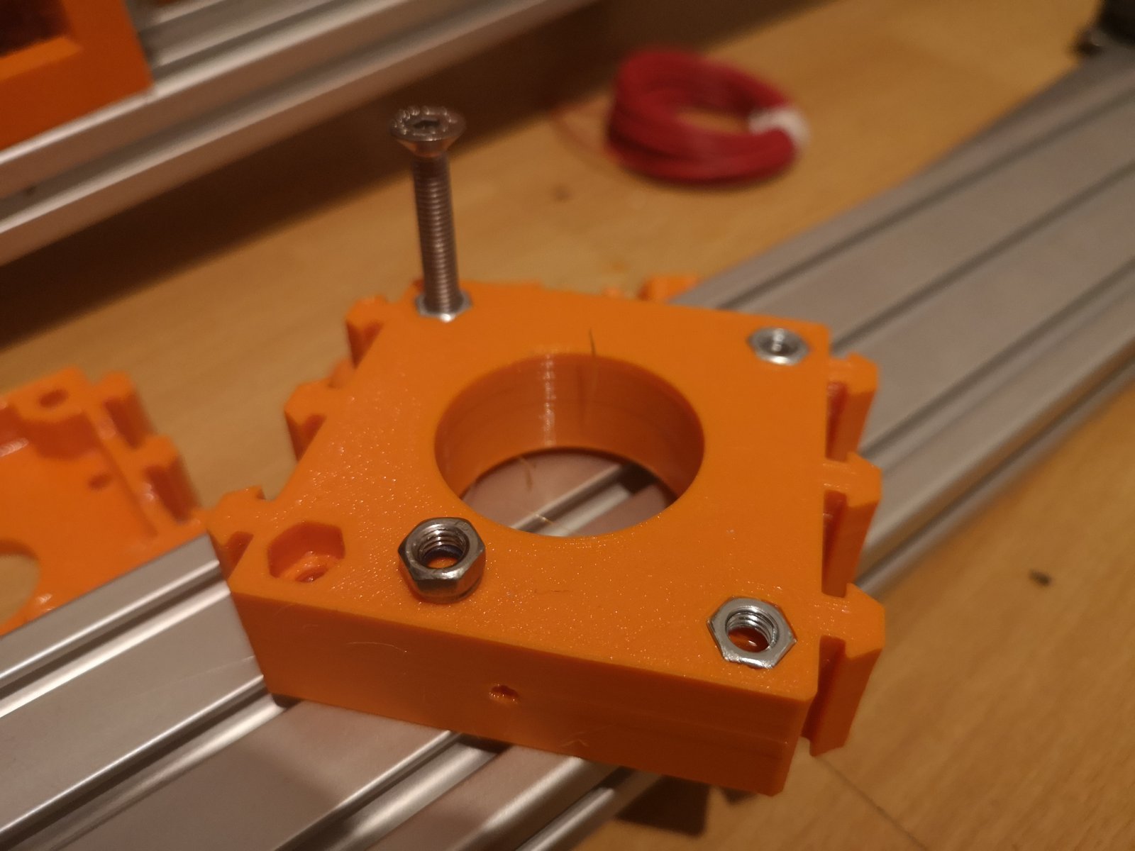

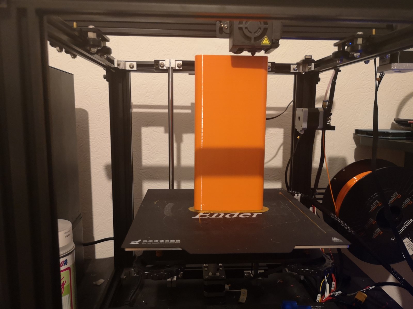

    The printer is pumping out parts
    Some of them are modified

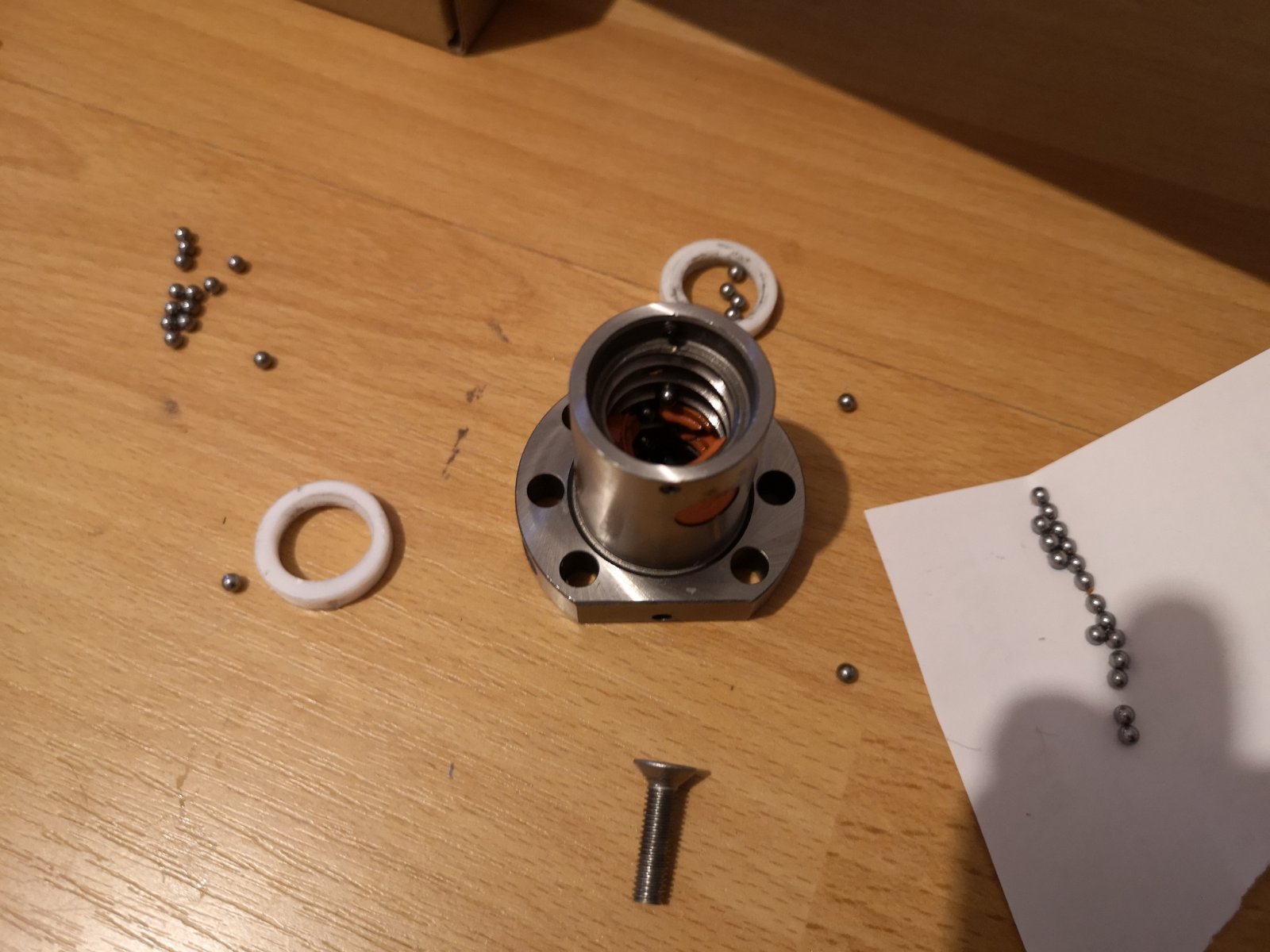

    A ballscrew already shot out the actuator
    But it is getting somewhere
    More coming soon...

    The board is from jlcpcb. They also have an online editor and because it was my first ordner, actually the first time ever creating a pcb, I did pay around 2€ for 5 PCBs including shipping. The shipping took almost 3 weeks. But worth the wait. Quality seems fine.

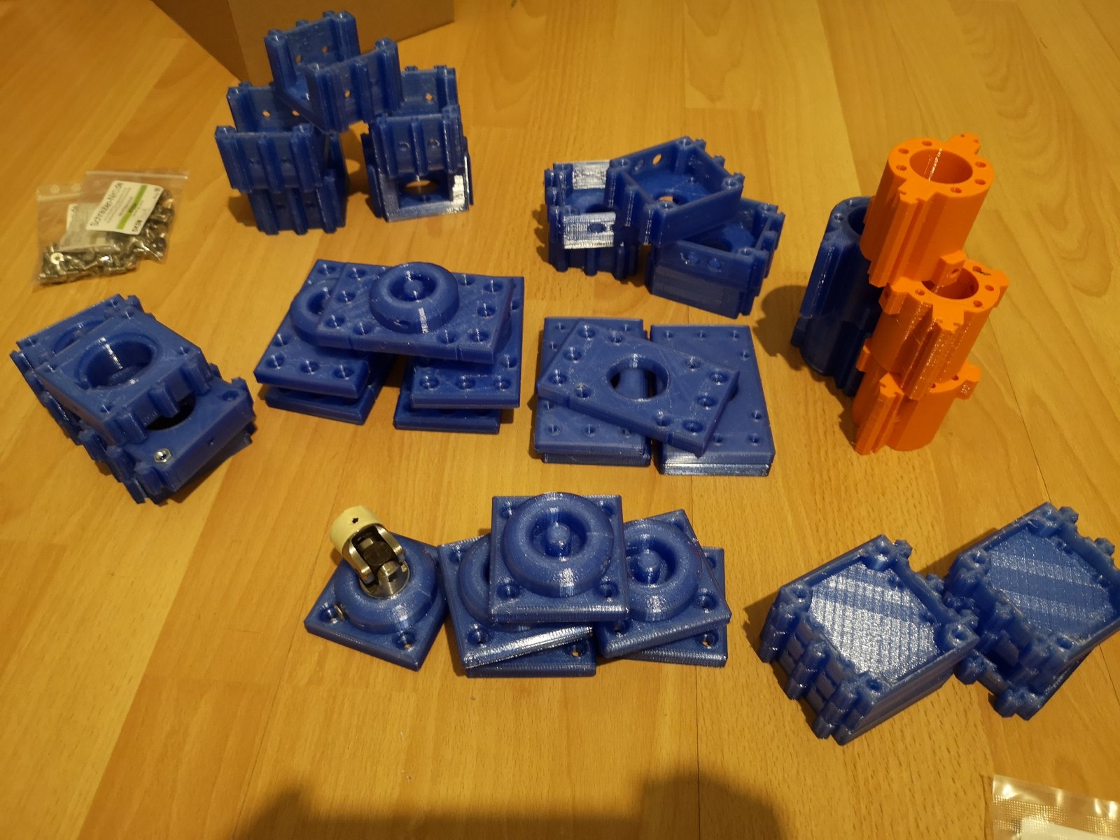

    Parts for the electronics are all there... Let's see if all the metal parts for the actuators arrive before the weekend.

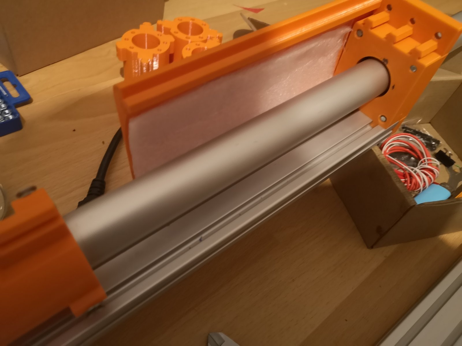

    Hows the project progressing? Looking forward to seeing the first FlyPT clone simulator. I'm working on a very similar one just with enclosed actuators to try and deaden the ballscrew noise a bit.

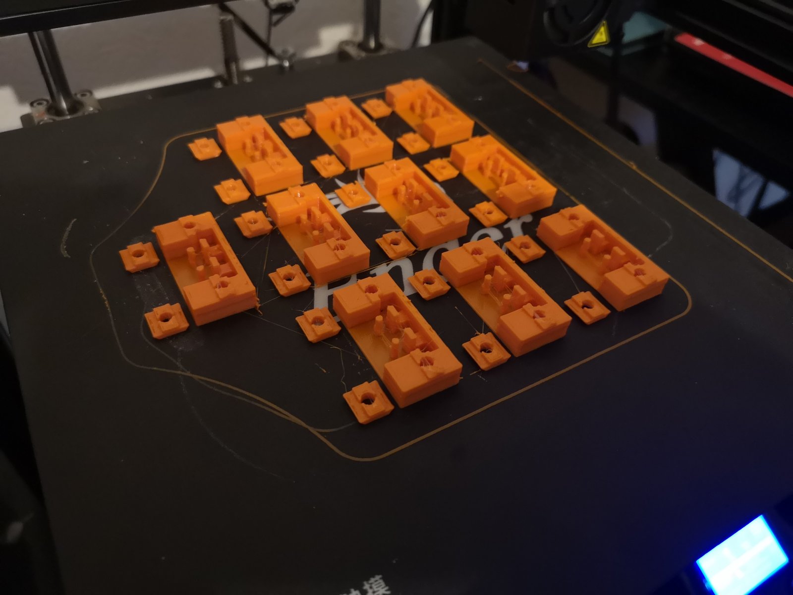

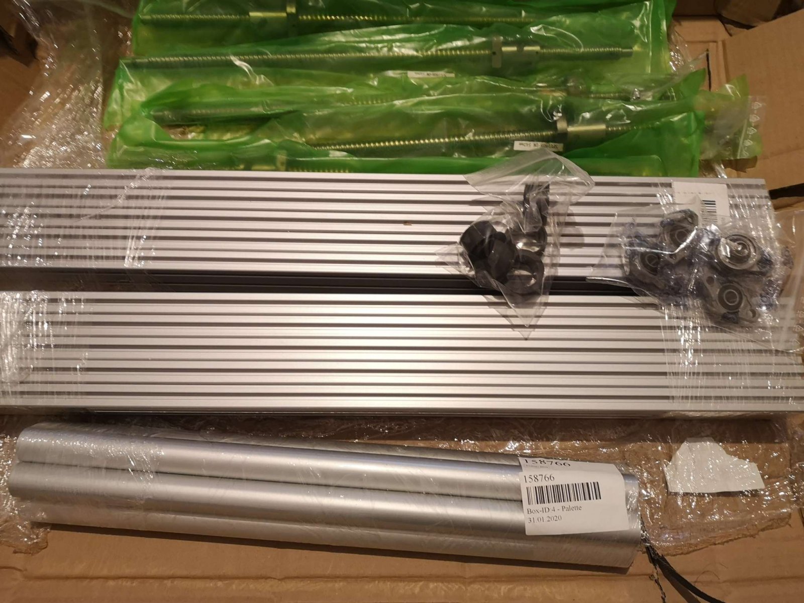

    Im still waiting for a bunch of parts... Including the last few ballscrews :(
    I think it takes about 60 more hours of printing to get the last parts done.
    I am also playing around with some enclosures to get the noise down.

    A little bit over 3 kg filament and days of print time and all the parts are finally done. I'm amazed how good Amazon basics petg filament is as I printed all the parts without any failed prints. I maybe reprint the orange parts in blue if it's going to bother me. The ballscrews and missing parts are finally in my region and should be delivered tomorrow. :)

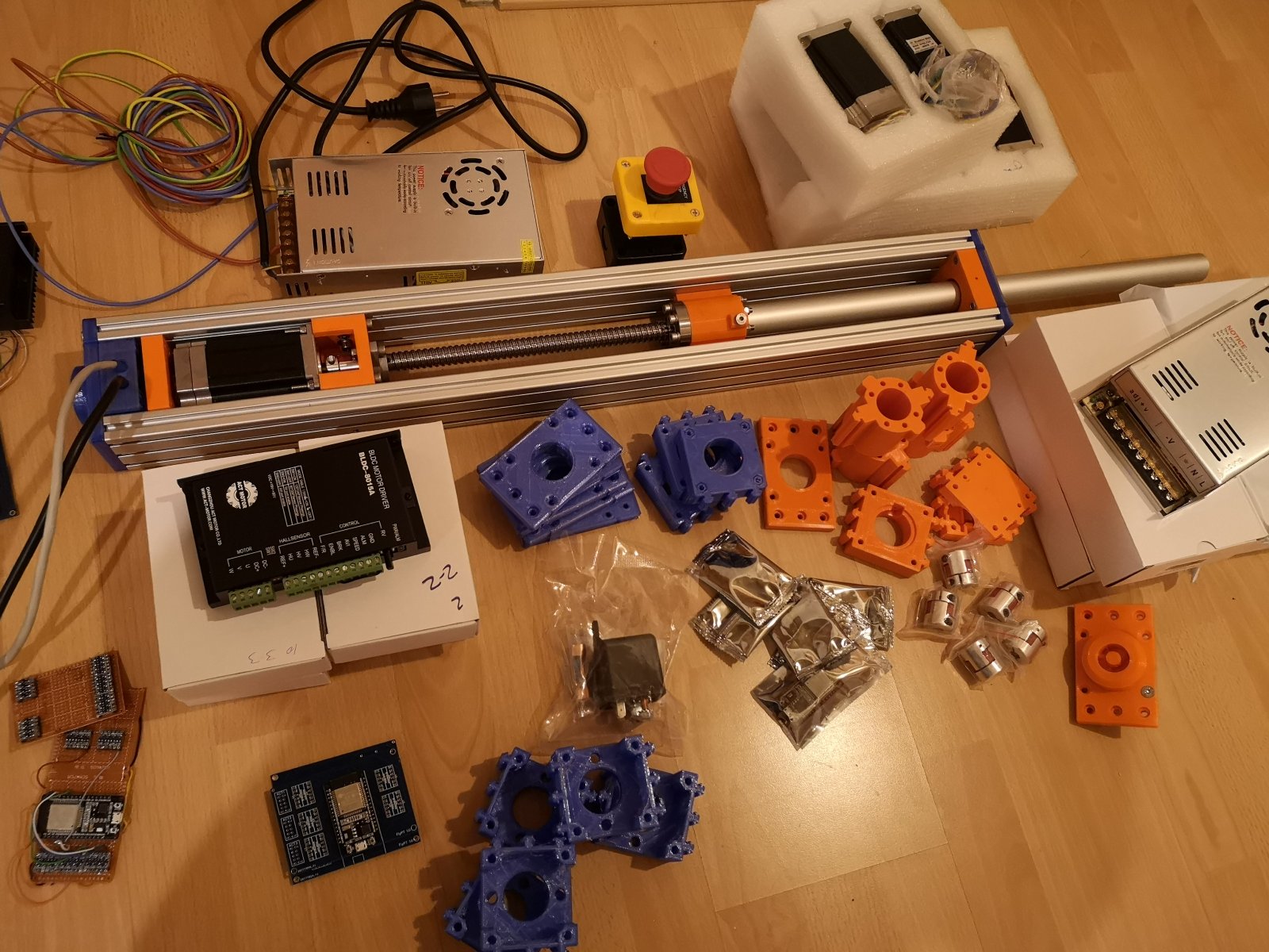

    I know what i am going to do this weekend :)
