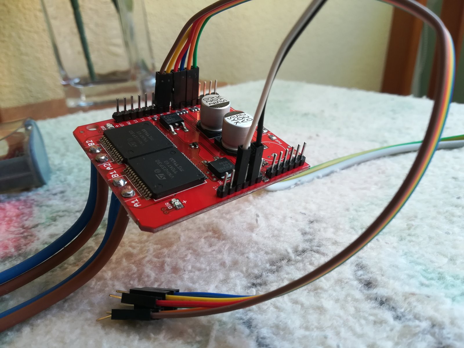

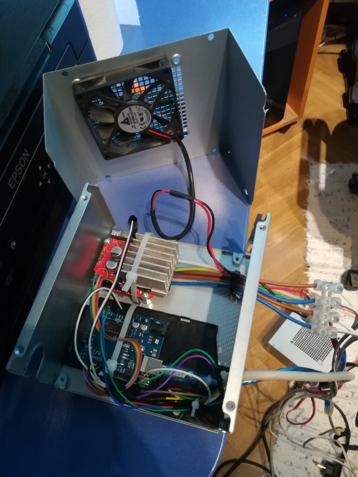

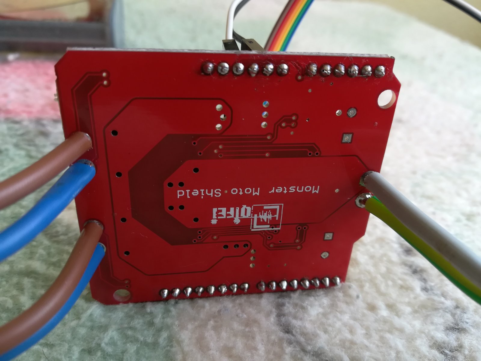

    A sample of the finish of the Arduino circuit

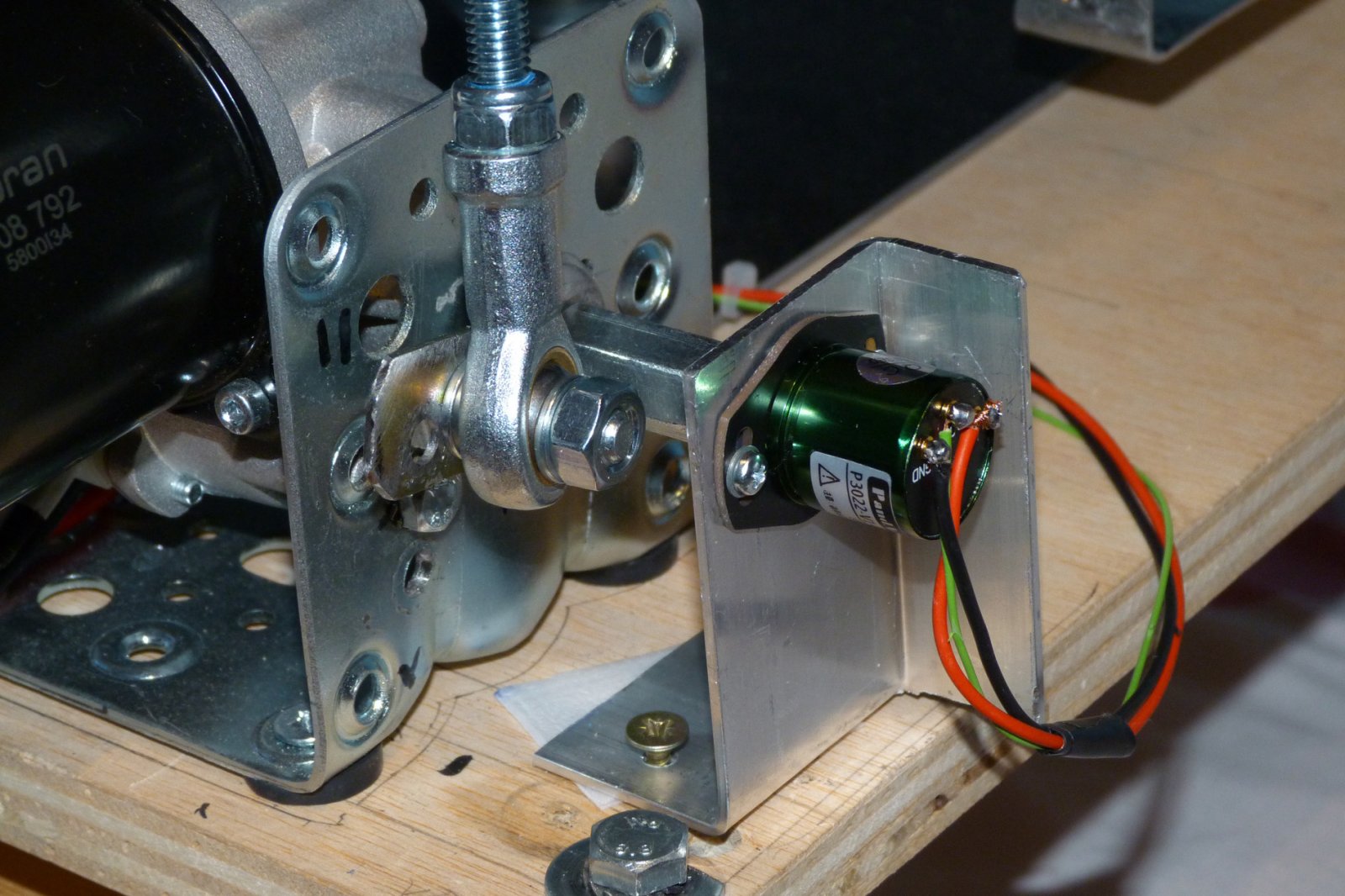

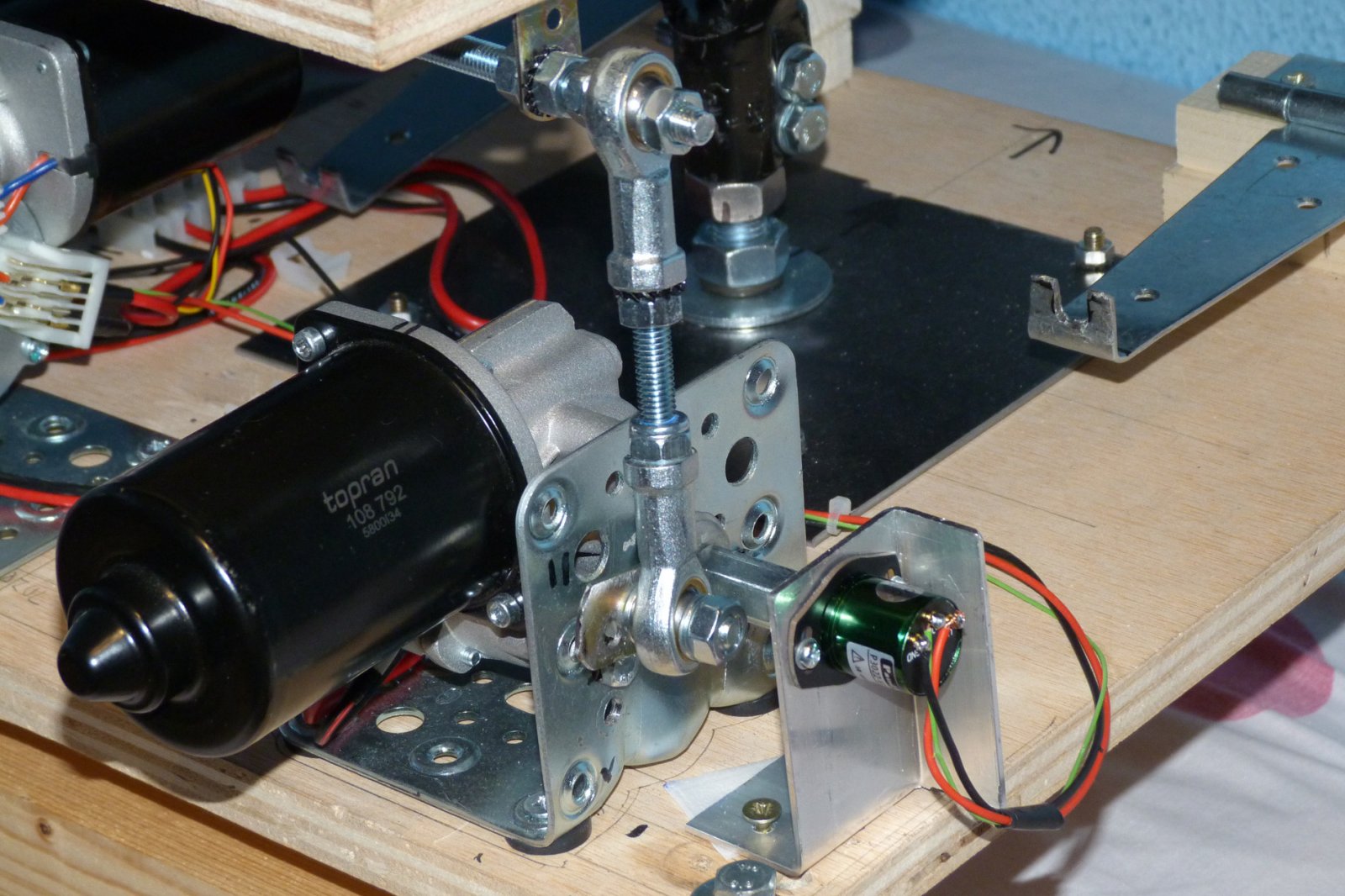

    Basically the system consists of two wiper motors, a very robust cardan shaft, linear plastic potentiometers and quite rudimentary levers.

    In this other image you can see how the potentiometers engage the motor shaft in a simple and practical way

    My first serious problem was the short length of the motor shaft that I had to solve by gluing two washers to the lever and also deforming it so that it did not collide with the screws of the motor support

    I had to reinforce the anchors of the system due to its extreme weakness, duplicating supports and joint joints to give it some flexibility.
    Also I have installed some movable supports to rest the mechanical system when I do not use it.

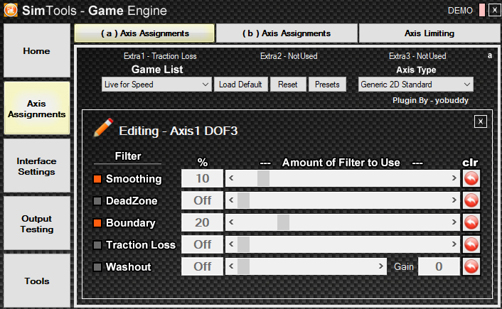

    You may have noticed that the movements are very short at the moment, because I am starting to adjust the sensations that it transmits to the seat.
    This is the configuration of the 4 axis roll, pitch, surge and sawy
    Roll and appears I have them set to 20% smoothness

    The explanation of this 20% smoothness is for two reasons, set to 0%, the movements are extremely abrupt and the consumption of the motors shoots up logarithmically.

  17. noorbeast
    20,555
    145,148Coins
    +10,780 / 52 / -2
    Best to use something like an old car universal joint and mount it as close to the seat base as possible: https://www.xsimulator.net/community/faq/universal-joint-placement.108/
    The motor mounts, levers, rods and brackets are subject to high loads in our rigs and must be very rigid. I use 6mm thick plate for my levers and angle iron for motor mounts.
    Use heim or tie rod ends to connect rods to the levers and top brackets, with spacers if needed: https://www.xsimulator.net/community/faq/heim-rose-joint-conical-spacers.72/
    The simplest way to make a rod is to use the correct size threaded rod that will screw into your tie rods or heim joints, then sleeve over the top of it with 50mm square or round tubing, with large washers and lock nuts either end. That will prevent the threaded rod from flexing under load. Personally I used solid aluminum rod and tapped it either end for my rods and also a cross brace rod between the top of each gearbox, to make them really rigid. I use flexible couplings and aluminum brackets to mount and connect my pots to the gearboxes:

    As you can see, the solution is the most widespread and reliable both in the union of the levers and in the control of the motors with the new sensors hall free of rotation and 360 degrees

    the simulator with these improvements already works better, but I am finding a problem with the control of the motors
    These make an "eletric noise" in each movement, it is a noise like a squeak, as if the electric currents that pass through the brushes were not in consonance or something similar.
