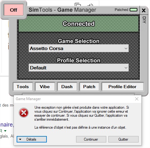

    When I press the ON button I have an error and gamemanager quit
    22,202
    154,675Coins
    +11,209 / 57 / -2
    What error message does it give when it quits?

    I have this message that on some plug-ins

    No one to this problem?

    Did you find a solution to this error?
    I get the same error after disabling ASUS service (which resolved the NOT CONNECTED for me).

    With the simtools vrsion 2.1 it works
