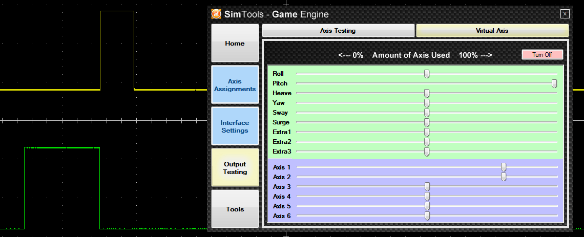

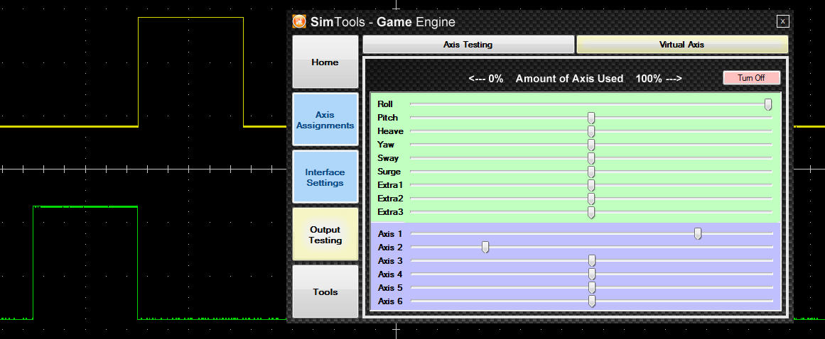

    Another interesting 2 pictures...
    As you see above, virtual axis window shows coherent axis displacement for roll and pitch, however Arduino output is contrary (PWM 1 and 2 on osciloscope).

    Gday @Pedro Silva ,

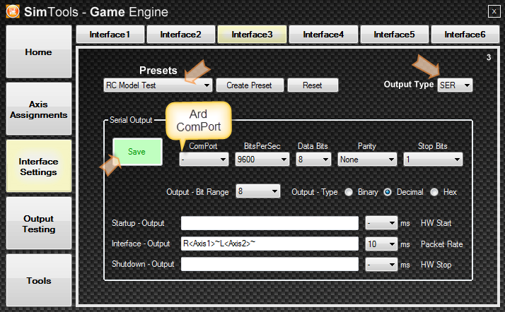

    Ok to explain a little about servos and Ardunio , They use a mapping of 0-179 , which is the min and max of the servo's movement.
    In the code provided I had one servo inverted on test model as in one lays on left side and other lays on right side.
    Hence the two different scalings 0,179 and 179,0
    I prefer to do scaling and inversion with in the code as this makes looking at simtools and using simtools alot easier.
    So if both servos are laying in the same plan then you can change the scaling to be equal both set at 0,179 or the other.
    Plus Axis settings need to have an inverted selected to one side of Roll or Roll will act like pitch.
    Ok with axis settings dont use more than 100% big error here made mainly by Ard Sim users.

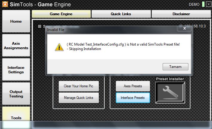

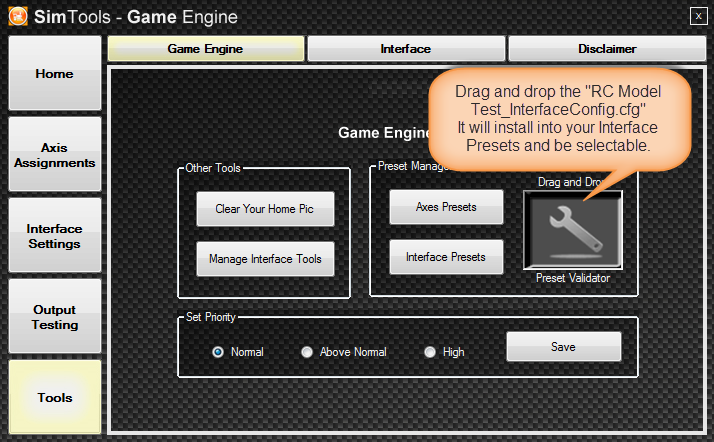

    Hi ( https://www.xsimulator.net/community/marketplace/rc-model-code-for-arduino-uno-2dof-expandable.89/ ) I downloaded RCModel.zip. and RCModelSimToolsMode.ino installed my arduino. i did not install the RC Model Test_InterfaceConfig.cfg to Game Engine - Tools - Preset Validator.
    Where did i go wrong?
