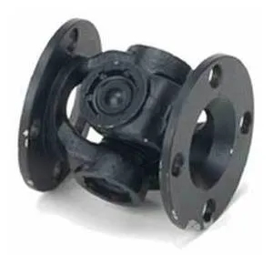

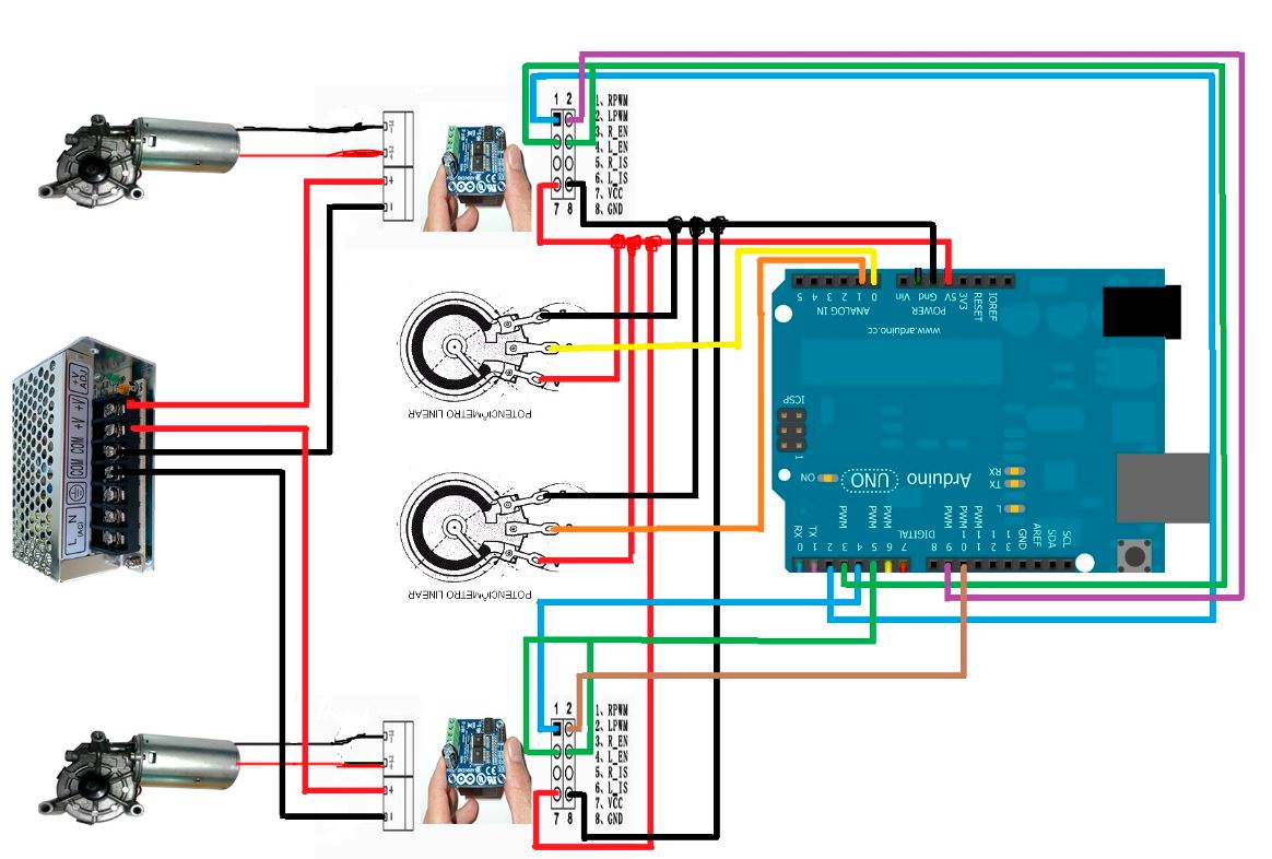

    HERE THE LIST OF PARTS I USED IN THE PROJECT:

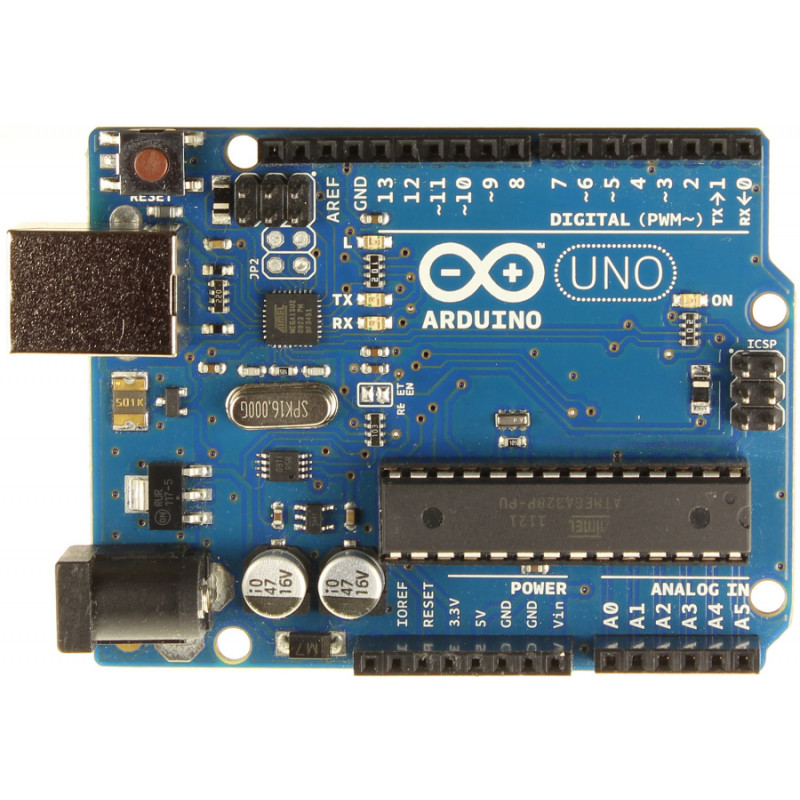

    1- Arduino uno

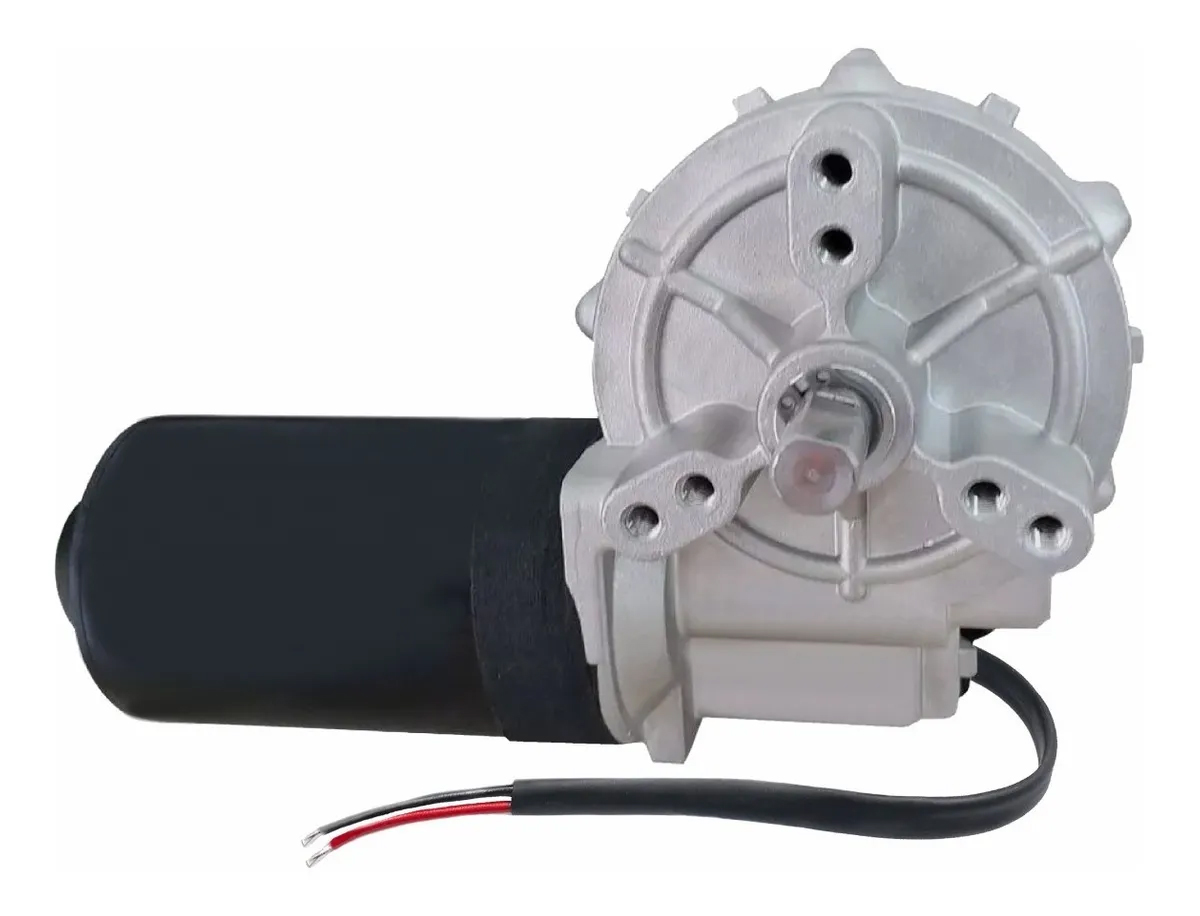

    2-Reducer Motor 12v Dc 30 Rpm High Torque 50 Nm Continuous Current Gearmotor 12v 30rpm

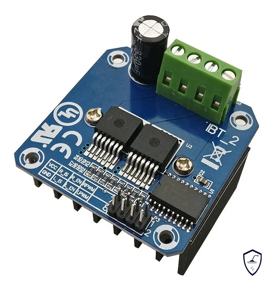

    3- H Bridge Driver Module - Bts7960 43a - Ibt_2

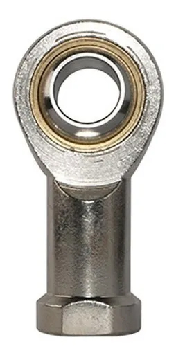

    4- 04 Labeling Tip For Pneumatic Cylinder Thread M10x1,25
    5- Universal Bus Junction M210 Tirante Cambio Mb Mercedes Benz

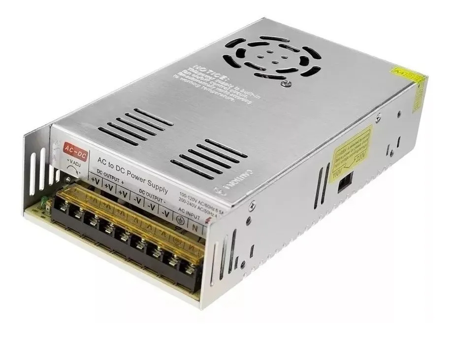

    6-Power Supply 50a 12v 600w
    Software:
    - SMC3Utils v1.01 (The SMC3 is a controller written for the Arduino UNO R3 for up to 3 motors)
    - Smc.ino (Programming for Arduino to control the rotation, in degrees, maximum and minimum of the motors)
    - Arduíno Uno R3 (Executes the programming)
    - SimTools_v2.4 (Generic Motion Simulator software capable of controlling various hardware interfaces, such as Arduino, SimAxe, JRK, SCN5 actuators)
    https://www.xsimulator.net/simtools-motion-simulator-software/
    - Program for 2DOF Arduino + Bridge H Motomonster
    https://www.xsimulator.net/communit...-and-2-pins-direction-hbridge-motomonster.67/
    - Live For Speed (Sim Tools already installed)
    https://www.h2oms.com/p/downloads.html

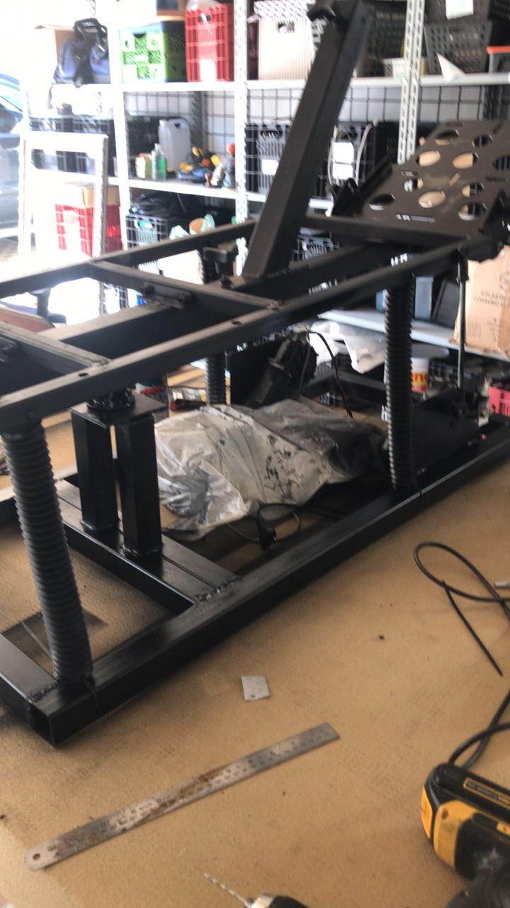

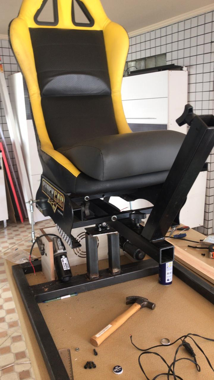

    IN MY FIRST ATTEMPT I PLACED THE ENGINES IN THE BACK, I DIDN'T HAVE SUCCESS, THE ENGINES DIDN'T HOLD
    I PASSED THE ENGINES TO THE FRONT, SUCCESS! WORKED PERFECTLY
    PROJECT COMPLETED AND WORKING, I PURCHASED SIMTOOLS 2.4 AND THE PREMIUM LICENSE PACKAGE TO DOWNLOAD THE PLUGIN, SO I AM WAITING FOR ADMIN TO RELEASE MY ACCOUNT
    TO ACCESS PLUG-IN
