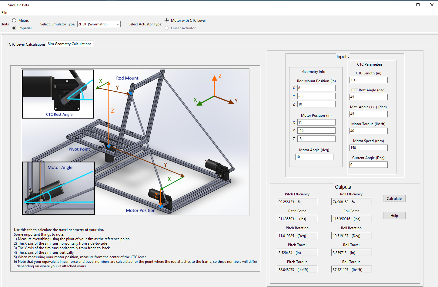

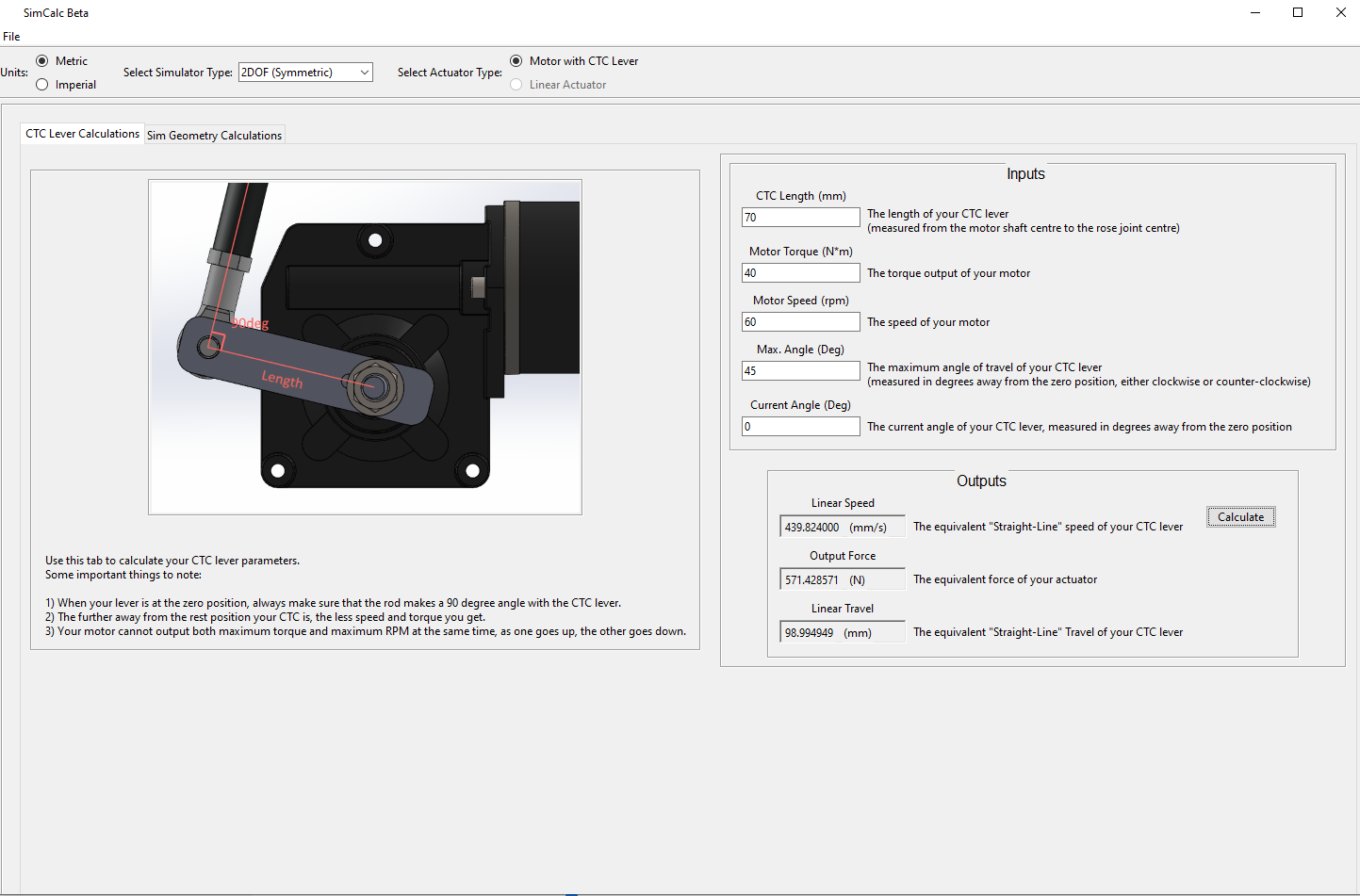

    i just receive alibaba motor {300w 12v 40n.m 50:1} ...but its can push me up , when its try to push the powersupply be so low , you think if i change it its will be good ? or the motor is bad?
    this is my simcalc
    22,185
    154,750Coins
    +11,196 / 57 / -2
    What is the geometry of your rig and approximate mass fully loaded?
    The CTC should be OK for designs with plenty of inherent leverage, like shoulder and foot mounts, but is likely too large for a compact rig with high mass load.
    Our rigs do generate significant power spikes in fast reversals, hence personally I run one modified 600w server PSU per motor, though led PSUs are another cheap option.

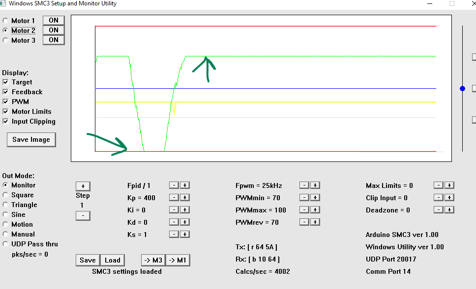

    my potentiometer green line in smc3 when i turn it left and right its go to last line down but when go up its just go to above middle? what's wrong?
    Note: i tried another potentiometer and reupload smc3.ino and try another vesrion of smc3 but nothing worked for me
    22,185
    154,750Coins
    +11,196 / 57 / -2
    The green line should be centered at rest, it looks like your pot is out of alignment and needs to be loosened, rotated to center, then re-tighten.

    its centered, i tried with new potentiometer and its same , i think its a problme with arduino code

    You also have not set the Max and Clip values.

    its not affected, all the problme my potentiometer not going all up but its go all down

    i tried it, i have new issue the green line direct go down and not move ever , i get new pot and new arduino and it was the same problme i delete smc3 and reinstall it but nothing helped!

    A lot of members use SMC3, so the likelihood is you have a problem with your setup, hardware or both.
    But you will need to supply far more information for members to be able to make suggestions, including posting pictures of all current settings and I would suggest a video of the step by step configuration of SMC3.

    Much appreciate. Can you also please detail what hardware is being used and what related Mode, 1 or 2, you are using.
  20. absyfadhel1
    absyfadhel1 Active Member
    Oct 19, 2017
    347
    bahrain
    556Coins
    +37 / 0 / -0
    its mode2..arduino and IBT 2, and its both new and the pot also new i just upload the smc3 code and entered the smc3 utility and when i enter the green line goes and dont move again and moving pot not affected ,i changed wires and i tryied with diffrent pc but it was same problme
