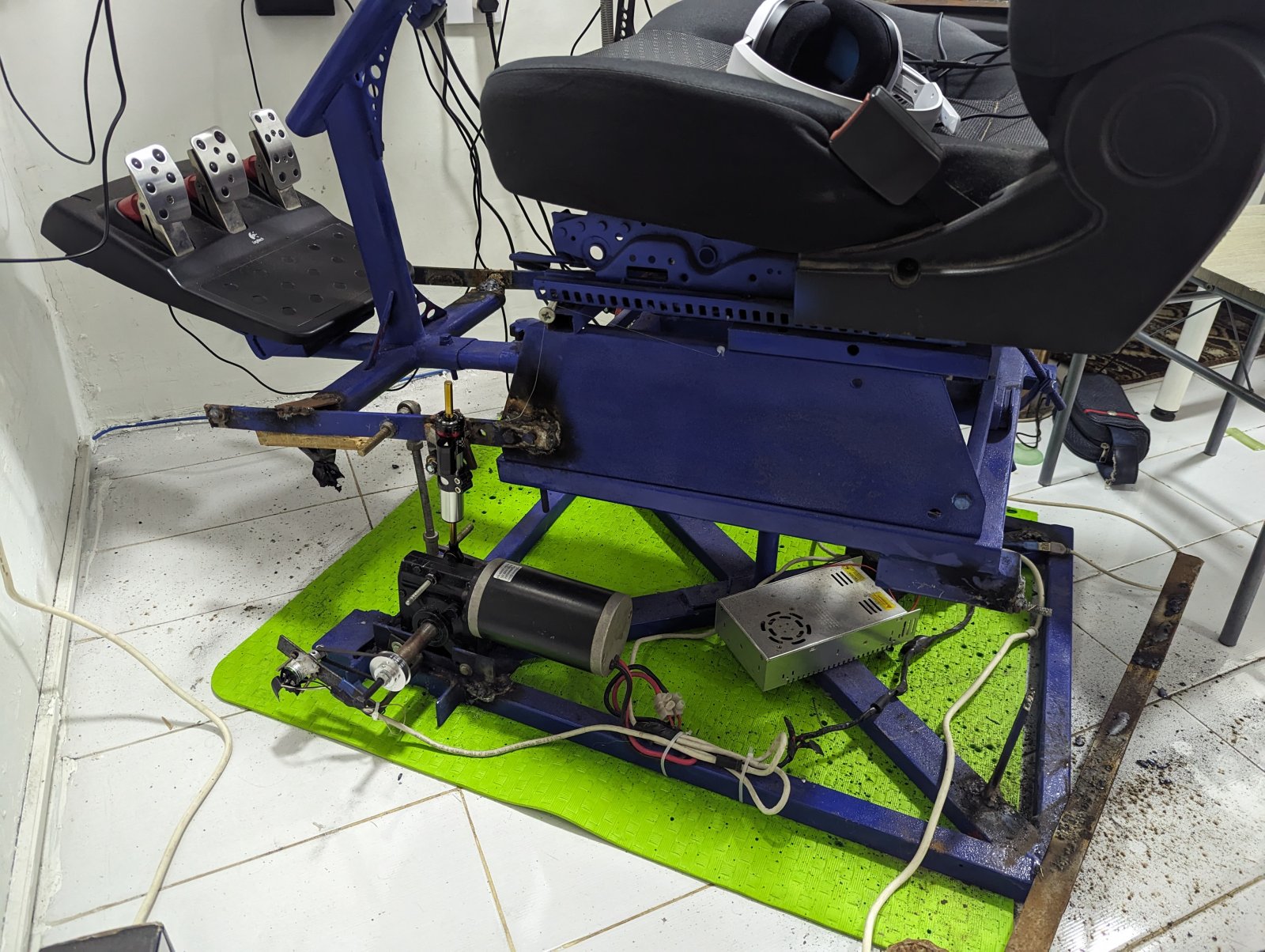

    Hello guys, i got problem that one motor moving up and down (tracking) more accurate than other one, when i tried to fix the issue i add more ki (smc3) for the motor that moving less its tracking perfectly but i got too much backlash, too much shaking, i change rod angle but i couldn't fix it, so what i'm thinking on is to purchase the dampers as suggested by *DofReality*, so i know its make the movement less but it can reduce the backlash ,
    so my idea is to increase the Kp and the PWmin while using the dampers so i can get perfect motion with less backlash.
    So is my idea make sence or should i do somthing els?
    I use
    (2dof front motor, 100A drive controller, 300w motors 12v.)
    I cant use back motor with shoulder mont long rods because of my small room.
    Looking forward for any suggestion and if anyone use dampers and can help me with my idea , appreciate it

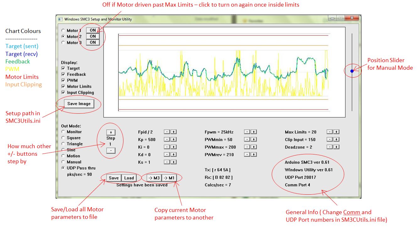

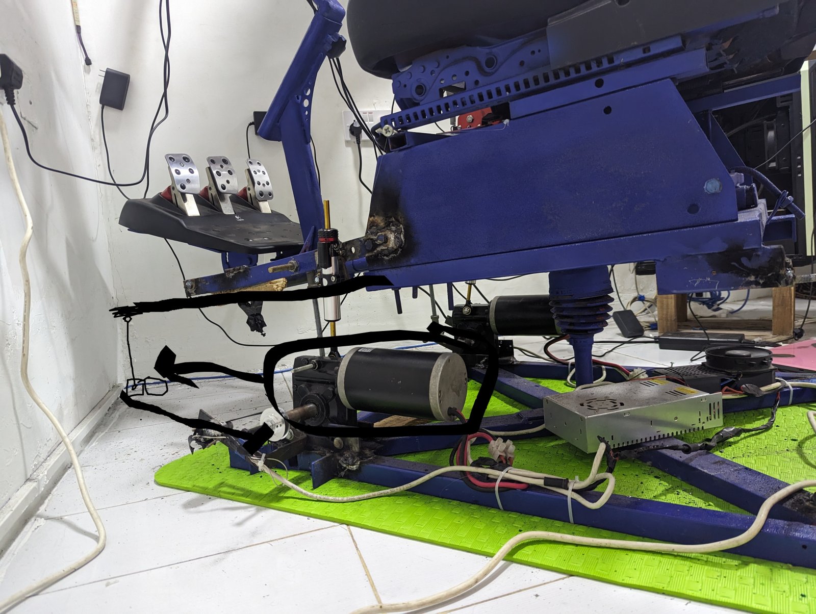

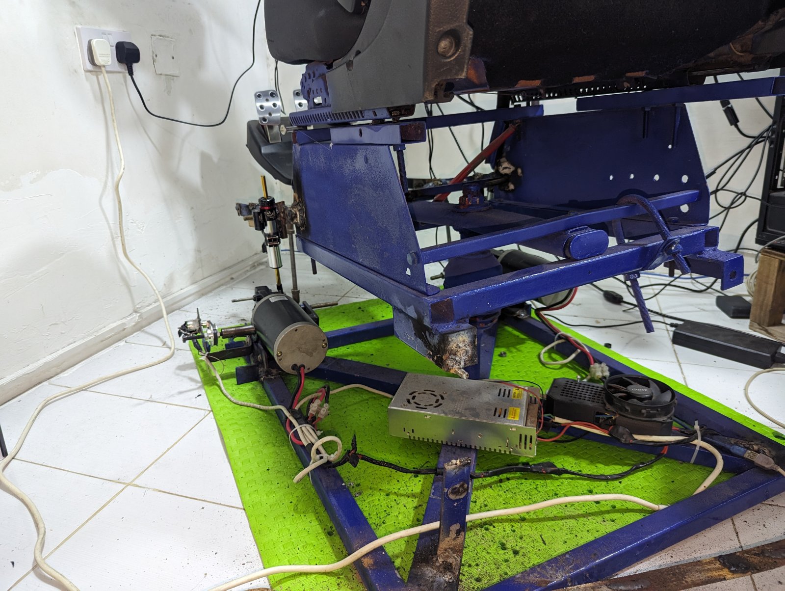

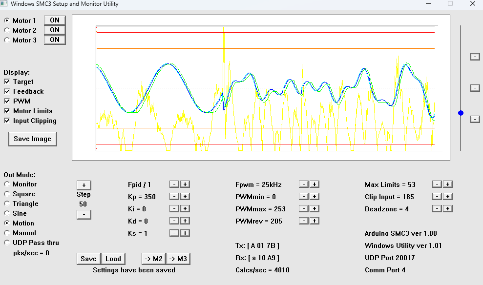

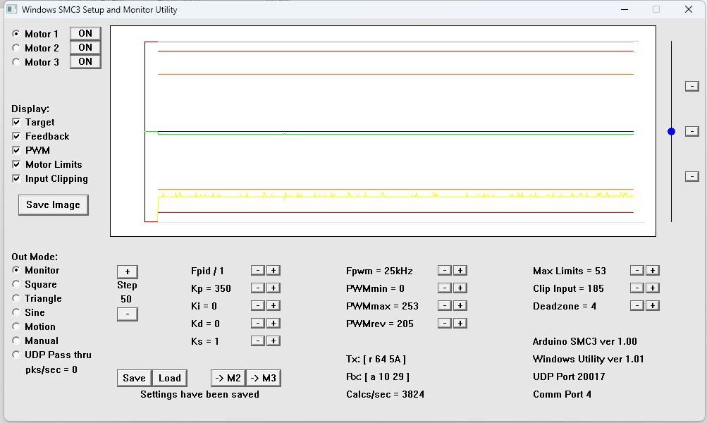

    @noorbeast i got an idea from this tip from you, do you think if i weld long square pipe to under the pedals and attach the rods and motors there will move the seat strong and faster with lower smc3 setting? , because now i'm using these setting and i cant get the green line near the blue until i increase the power and make the seat more jerky
    see the green line here and this is how it look wile moving
    its loosing big amount of movement in game like shifting offroad line,
    so my idea is to weld like this from under seat to below the pedals and attach the motor there so i can reduce weight in m0tor as i thought from the your quote
    to this
    21,740
    152,213Coins
    +11,065 / 56 / -2
    The new foot mount motor placement will increase the inherent design leverage, which will in turn lowers the lose on the motors.

    so it can help me achive my goal?, make the green line react more accurate to the blue line?.

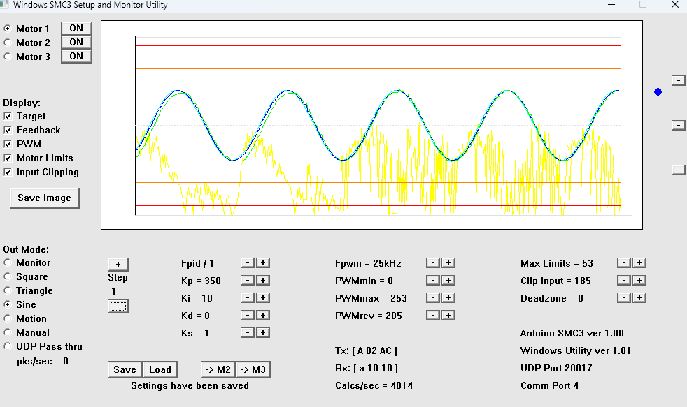

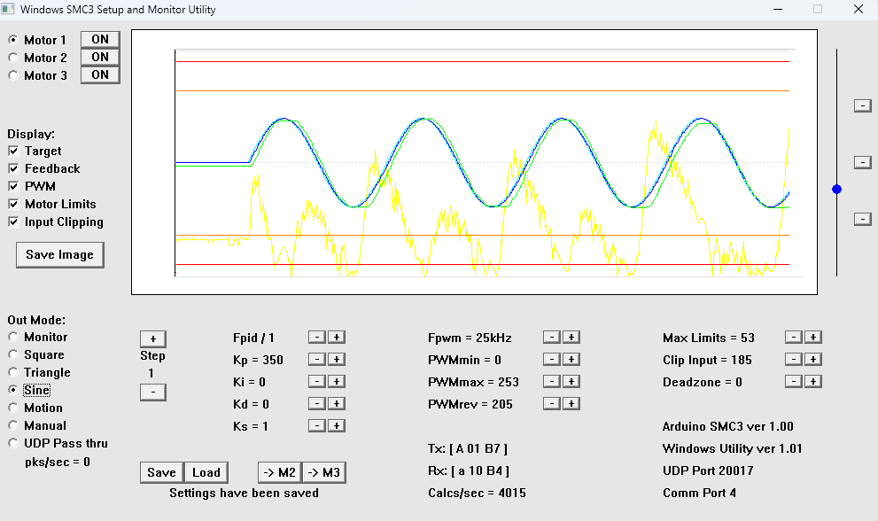

    Can you please try setting Steps to 1, Dead Zone to zero and then post a picture of the Sine runing in Out Mode.
  11. absyfadhel1
    absyfadhel1 Active Member
    Oct 19, 2017
    346
    bahrain
    550Coins
    +37 / 0 / -0
    ok when i go back home i will do, i will set deadzone to 0 but i dont understand what you mean by set steps to 1? can you expline it please, thanks for your time and help

  14. absyfadhel1
    Oct 19, 2017
    346
    bahrain
    550Coins
    +37 / 0 / -0
    here is it
  15. noorbeast
    21,740
    152,213Coins
    +11,065 / 56 / -2

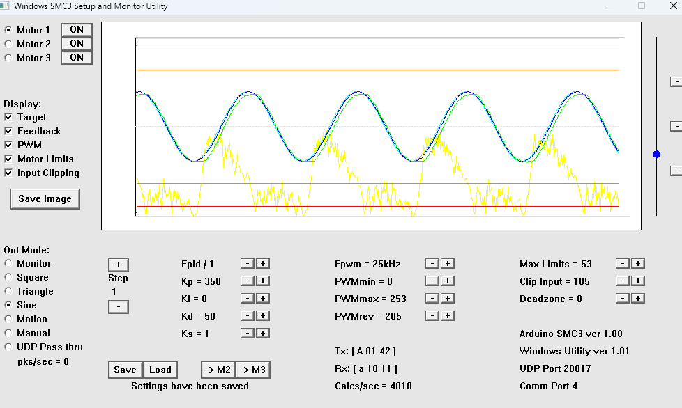

    Try adding a little Kd and see if that tightens the Sine tracking.
  16. absyfadhel1
    Oct 19, 2017
    346
    bahrain
    550Coins
    +37 / 0 / -0
    Screenshot 2023-11-05 175819.png this with kd
    Screenshot 2023-11-05 175851.png this with ki but too much jerky

  20. absyfadhel1
    Oct 19, 2017
    346
    bahrain
    550Coins
    +37 / 0 / -0
    Hi, can anyone please suggest where to change the motor position?, i want to change motor place because i couldnt achive good movment in smc3 , its hard to move slowly because of backlash, if i increase damper streanth backlash almost gone but movment to green line its bad.
    i think the motor place and the shaft in middle is too close to each other so i think i need to move it far enough to get easy move.
