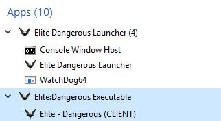

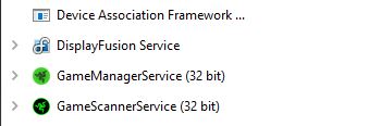

    I have read the Simtools documentation and noticed that in the game manager under the "Profile Editor" tab it shows the Process Name as EliteDangerous64. I am running ED Via Steam and when I run the game I do not have a process called EliteDangerous64 running. I have included a screenshot of the Apps section of the Task Manager and a shot of the Background Process section sorted alphabetically. Is this the source of my problem and if so is there a way to change the process name so it points at the right one. I have downloaded and installed the most recent plugin from the site and I am still not getting any motion.

    You need to place the pointers xml into the simtools plugin directory. Instructions are on the ED plugin page.
    Dont worry about what processes are running as the correct process is running that is why gamemanager/engine are turning blue.
