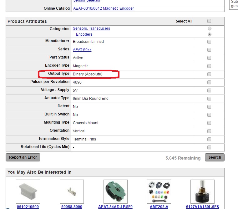

    No I'm sorry the output type is Binary and we need Analog for Arduino .
    BTW ... the Hall pot are perfect :thumbs and @paulg100 problem was in that all the grounds of all circuits [computer/ digital/ analog sensors / analog VFD outputs ] are all connected together on Thanos board " Internal Darlington Transistors leakage " as he said ... that is something you should consider when designing as I used an opto-coupler with a separate ground for the VFDs side ;) ...

    oh ok thanks for the reply. I was planning on using hall effects before reading about his pot problems. By the way i saw your sim just a minute ago, and that is nice. I like your frame tubing and actuators!

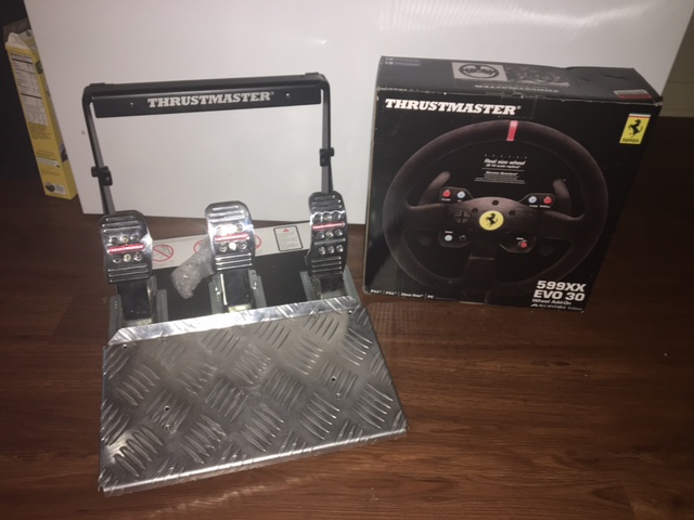

    I'm torn actually. I want the OSW but that is money that could go toward motors or something. I'm leaning toward the t300 just as a cheap fix until i get the rig built. We'll see how work goes over the next month.
    I'm planning on buying @speedy octo-coupler card which is based on the arduino uno. I was hoping the VFDs would overcome any 8 bit limitation, and should ask speedy about it.
    Edit: hmm a Thrustmaster TS-PC might be a good compromise between t300 and OSW:
