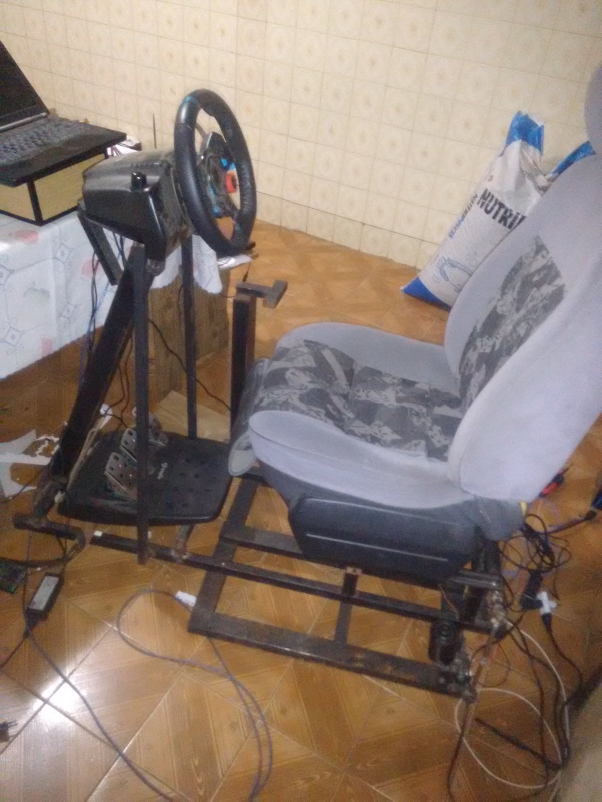

  6. guguraul
    guguraul New Member
    May 1, 2018
    Brasil
    180Coins
    Hi guys, here is my poor project 2dof with wipe motor 12v, it Works well with Life For Speed on Pc, but I want to use It PS4 and project cars. How can I get the plugin? Is there any link to download It?
    Olá pessoal aqui está meu prietop pobre 2dof com motores de limpador 12v, funcionando bem com Life For Speed no Pc, mas eu quero usar no PS4 e project cars, onde consigo o pligip? Algum site para baixar?

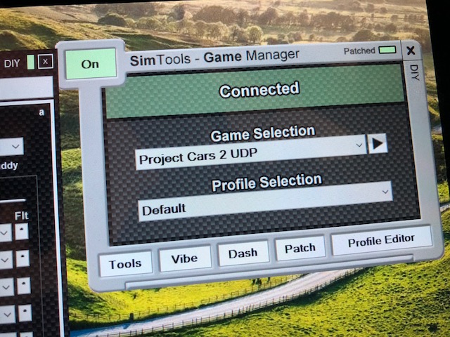

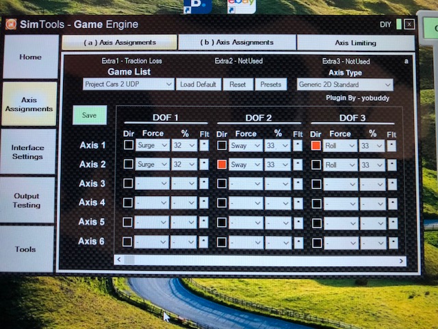

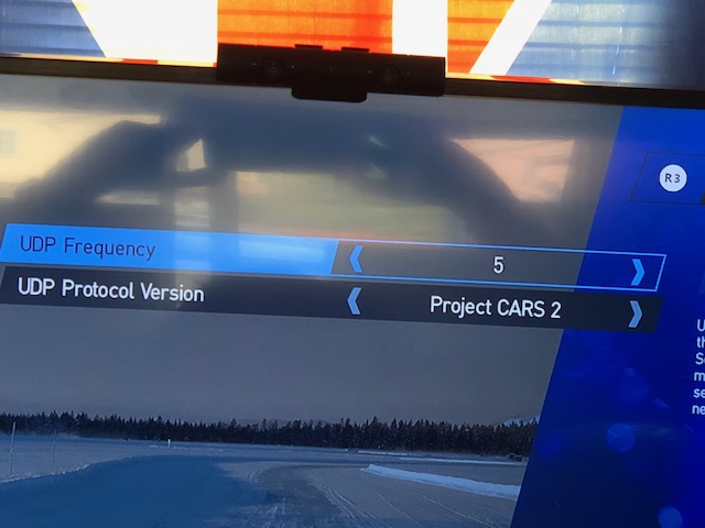

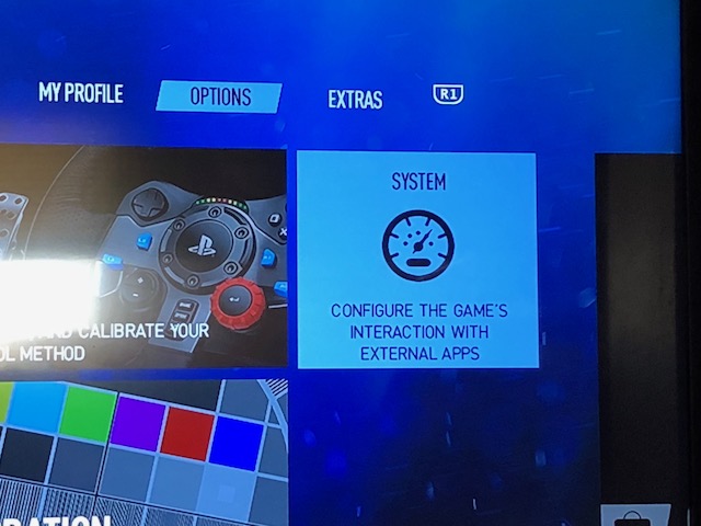

    Hello Santanadany,
    I'm in difficulty because I don't success to connect by UDP the PS4 with the PC to game with Projectcars 2.
    I downloaded the plugin for UDP, the Game manager game running but the sliders don't move.
    I connected the PS4 to PC by Ethernet cable and then the PC to Arduino by USB.
    I don't success to open the UDP port n°3478 - 3479 of my PS4.
    May you help me?
    Francesco

  15. vthinsel
    vthinsel Well-Known Member
    Feb 20, 2015
    439
    FRANCE
    6,026Coins
    +568 / 2 / -0
    Arduino, 4DOF
    IP address and netmask must be configured carefully on PC and PS4 if not using DHCP. PC and PS4 must be on the same IP network (same subnet mask, same gateway), otherwise you can be sure that the broadcasted UDP packets will be dropped. First step would be to use an ethernet cable between the PC and PS4, by eventually giving coherent static address and making sure the PC can ping the PS4. The simtools should work (do not forget to press the play/triangle in gamemanager too ;) )
