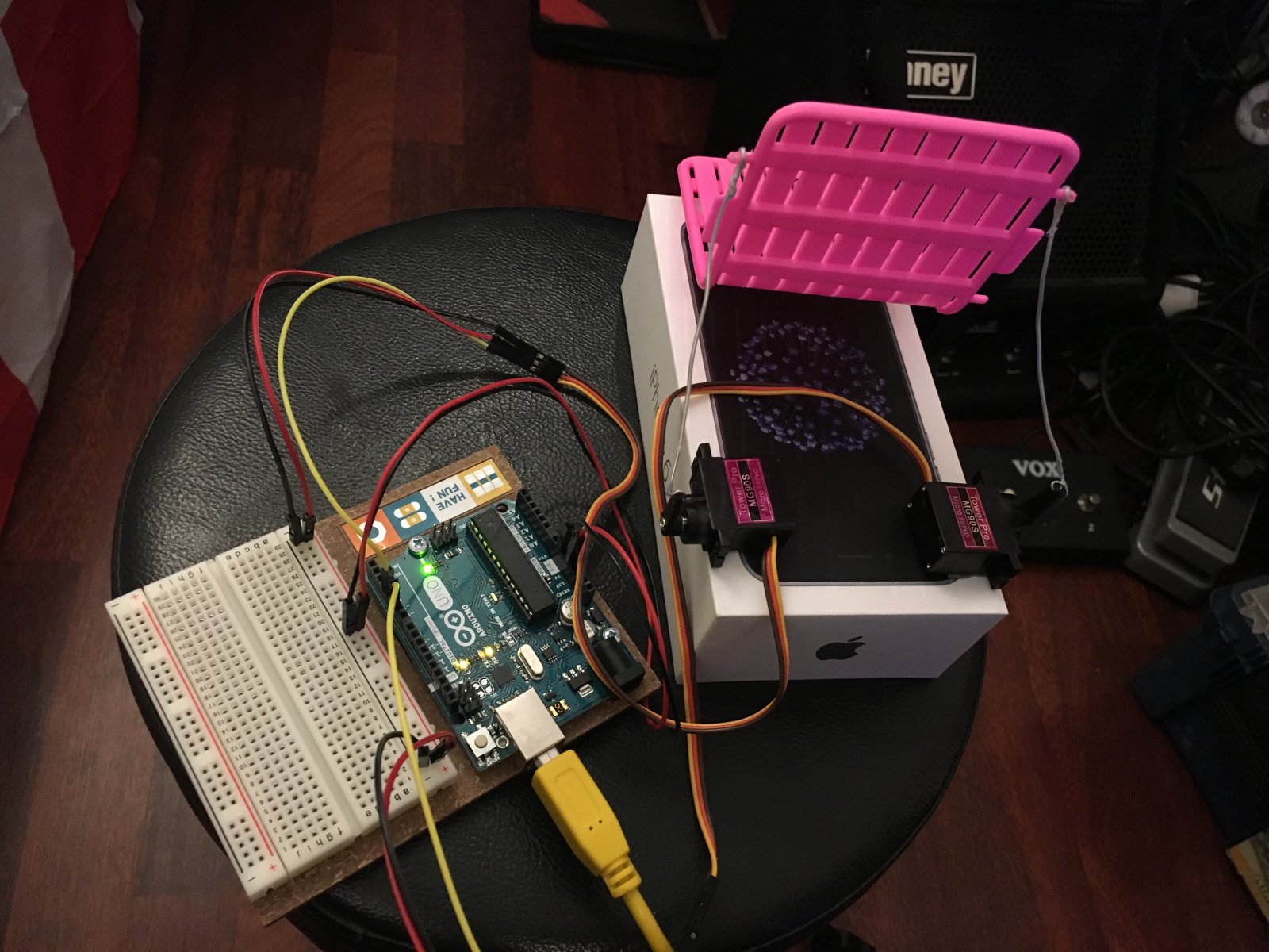

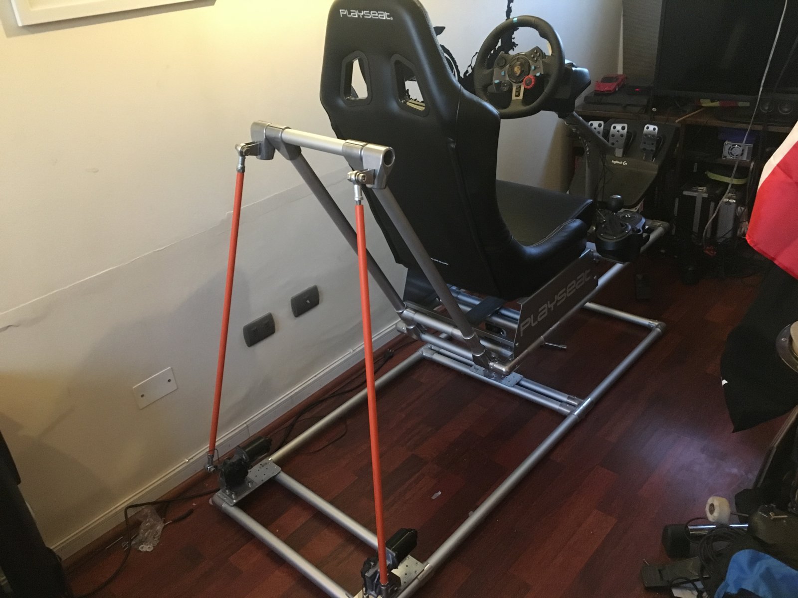

    I will start to show my progress here
    I think my starting point was the most complex, to achieve communication from the Playstation 4 to the PC => Simtools => Arduino. => to the chair of the barbie (donated by my daughter, she was the one who has recorded the video). and Work very well !!
    https://photos.app.goo.gl/B48NodK7hVfrqKyG2

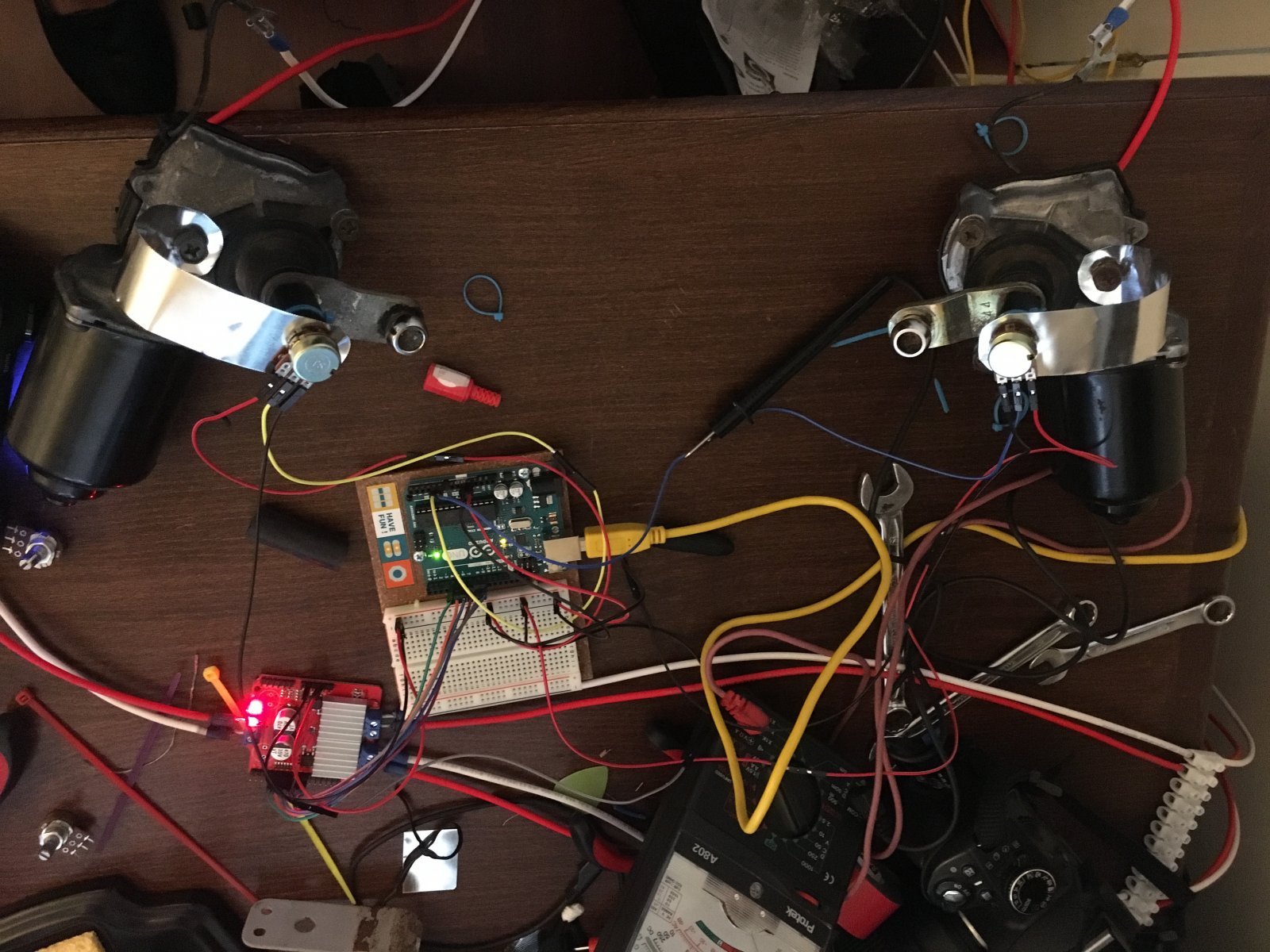

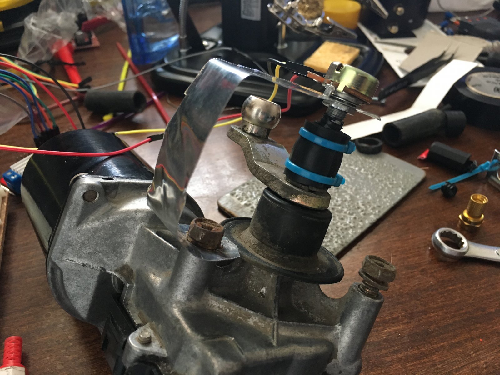

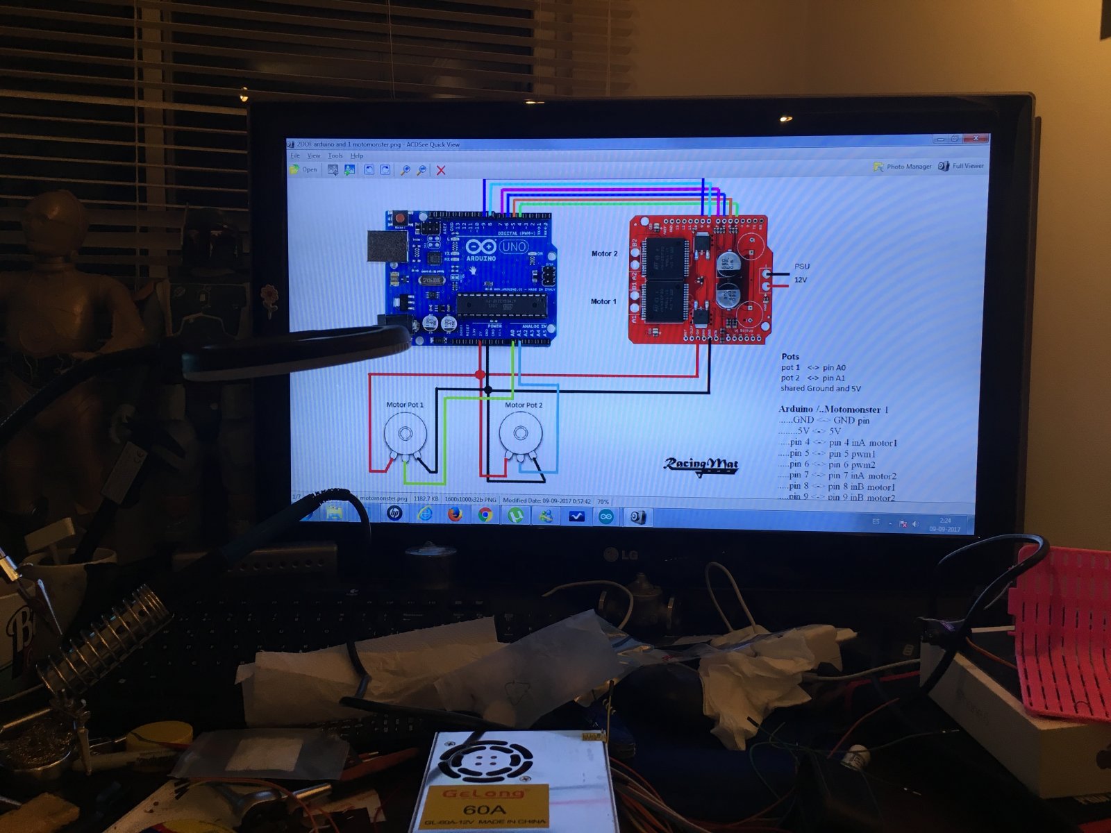

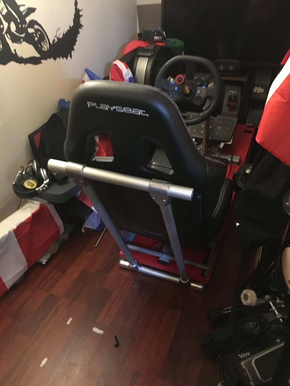

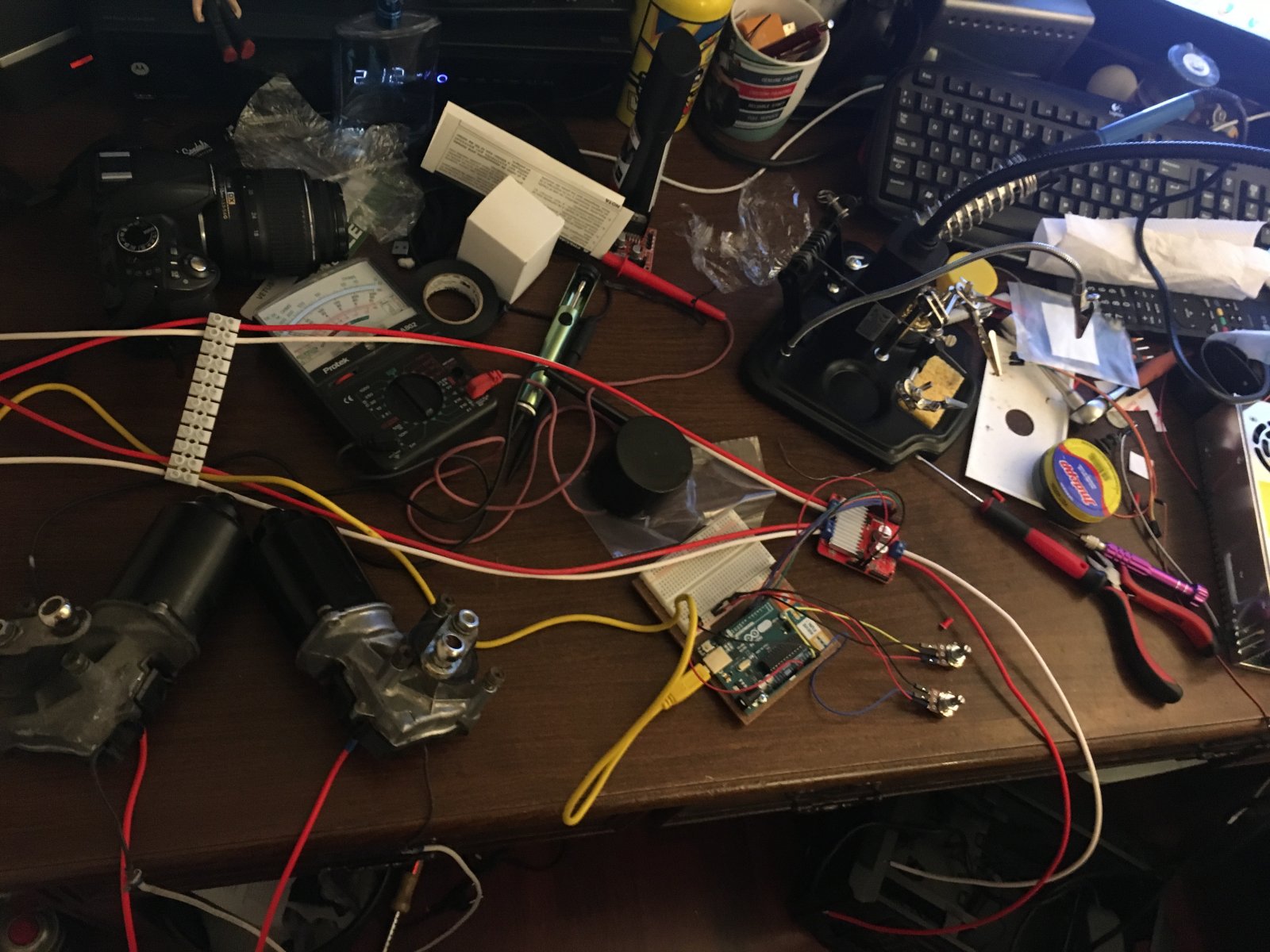

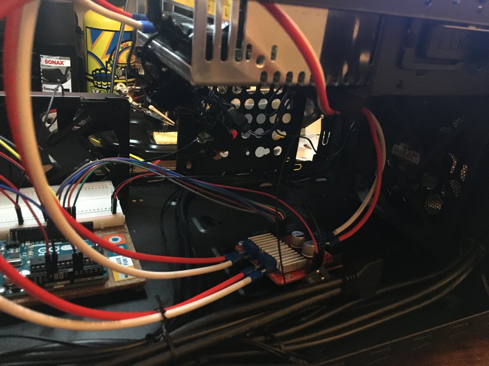

    After a very profitable weekend, (it has been raining in Santiago de Chile, so I have had time to move forward); I commented that I have now tested the configuration of @RacingMat , https://www.xsimulator.net/community/threads/from-atoz-2dof-arduino-wiper-playseat.4616/
    Sending serial signals from the arduino and everything work 100%, I can only say that this great! https://www.xsimulator.net/community/members/racingmat.8138/
    thank you racingmat, very complete
    So far it has worked very well I tested the game in the ps4 Project Cars, using UDP telemetry, sending to the PC, and this to the arduino I have done some accelerations and brakes and everything looks great

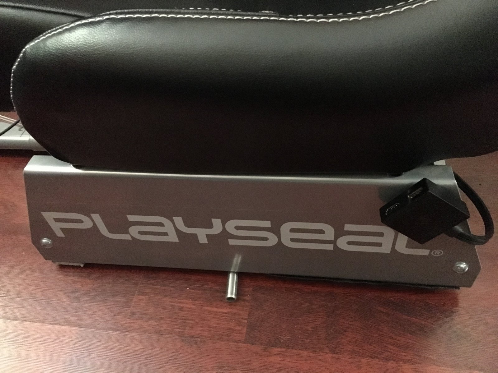

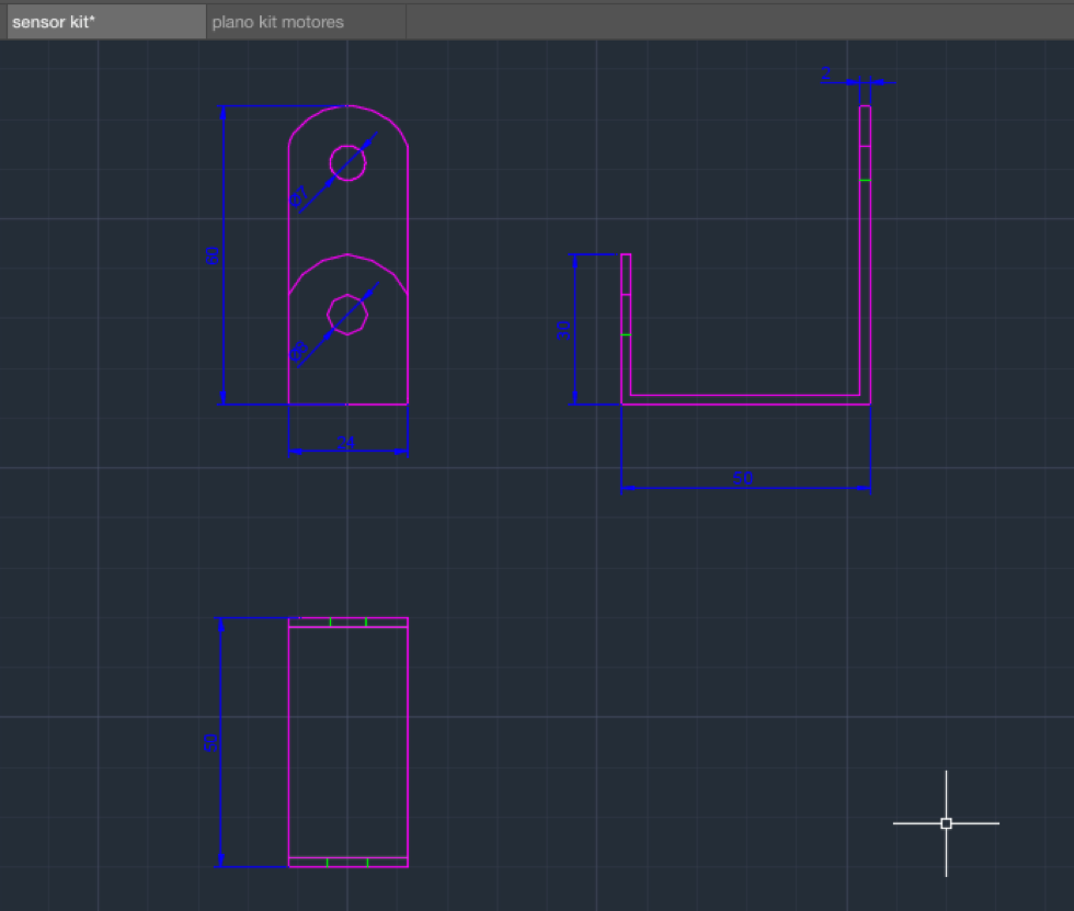

    In addition I already bought everything, (Change the Cardan), I have drawn the pieces that tomorrow enter the production
    I hope this weekend to build the structure, today I have also measured the balance of the play seat
    I leave some photos.
    regards!

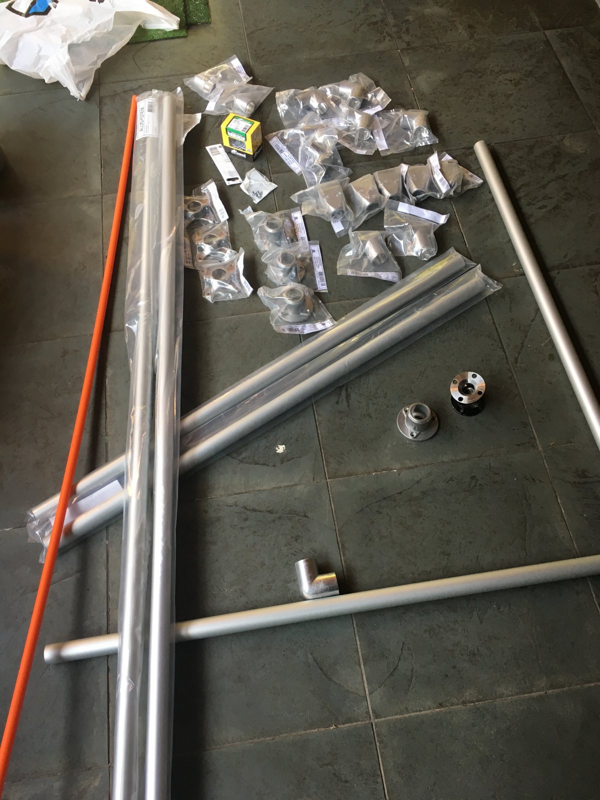

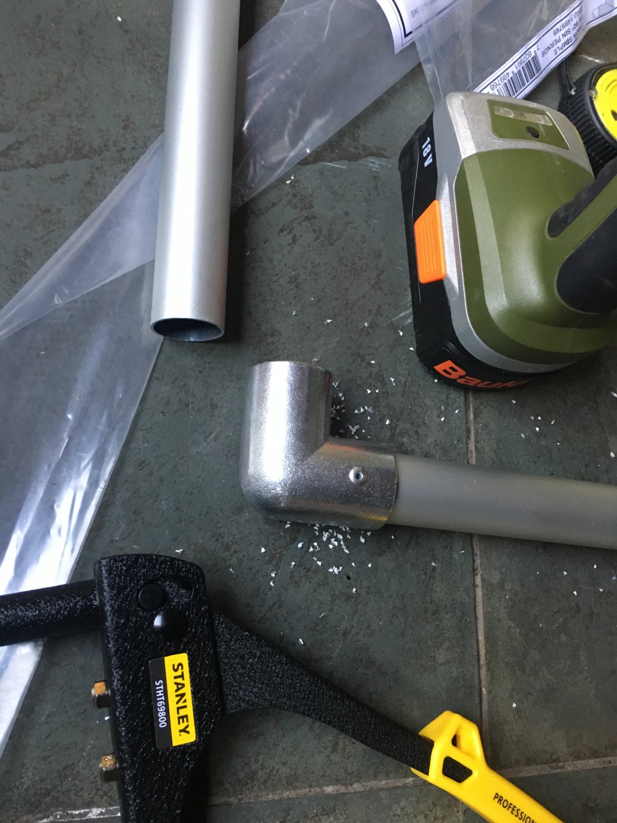

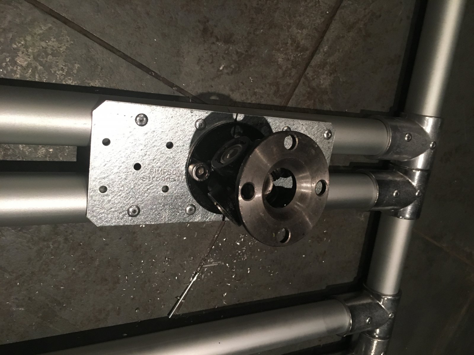

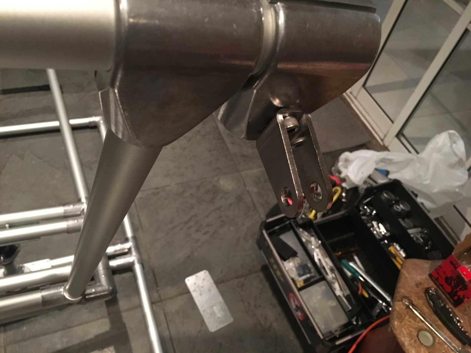

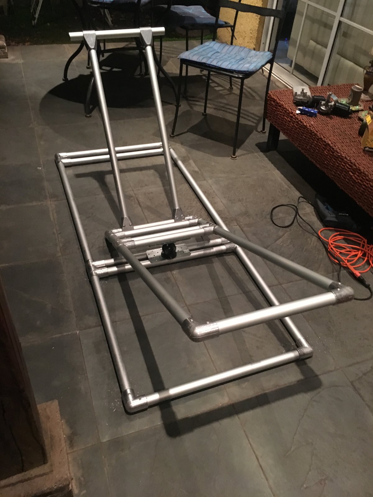

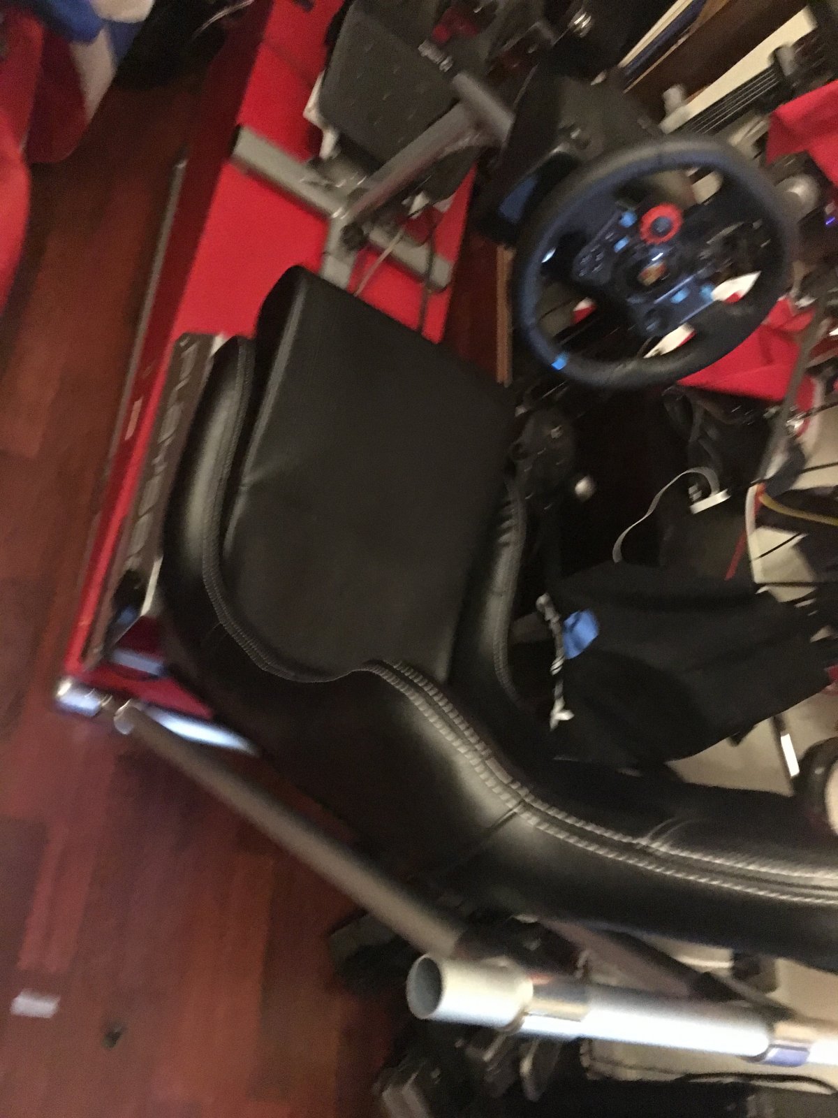

    Hello everyone, my project continues to progress, sorry for not responding before but @noorbeast has done very well (Thanks @noorbeast) ,PS4 => UDP by wifi => PC => Simtools =>Arduino => playseat...is the solution, there are also the UDP plugins for F1 2016 and F1 2017, but I will start with Project Cars.

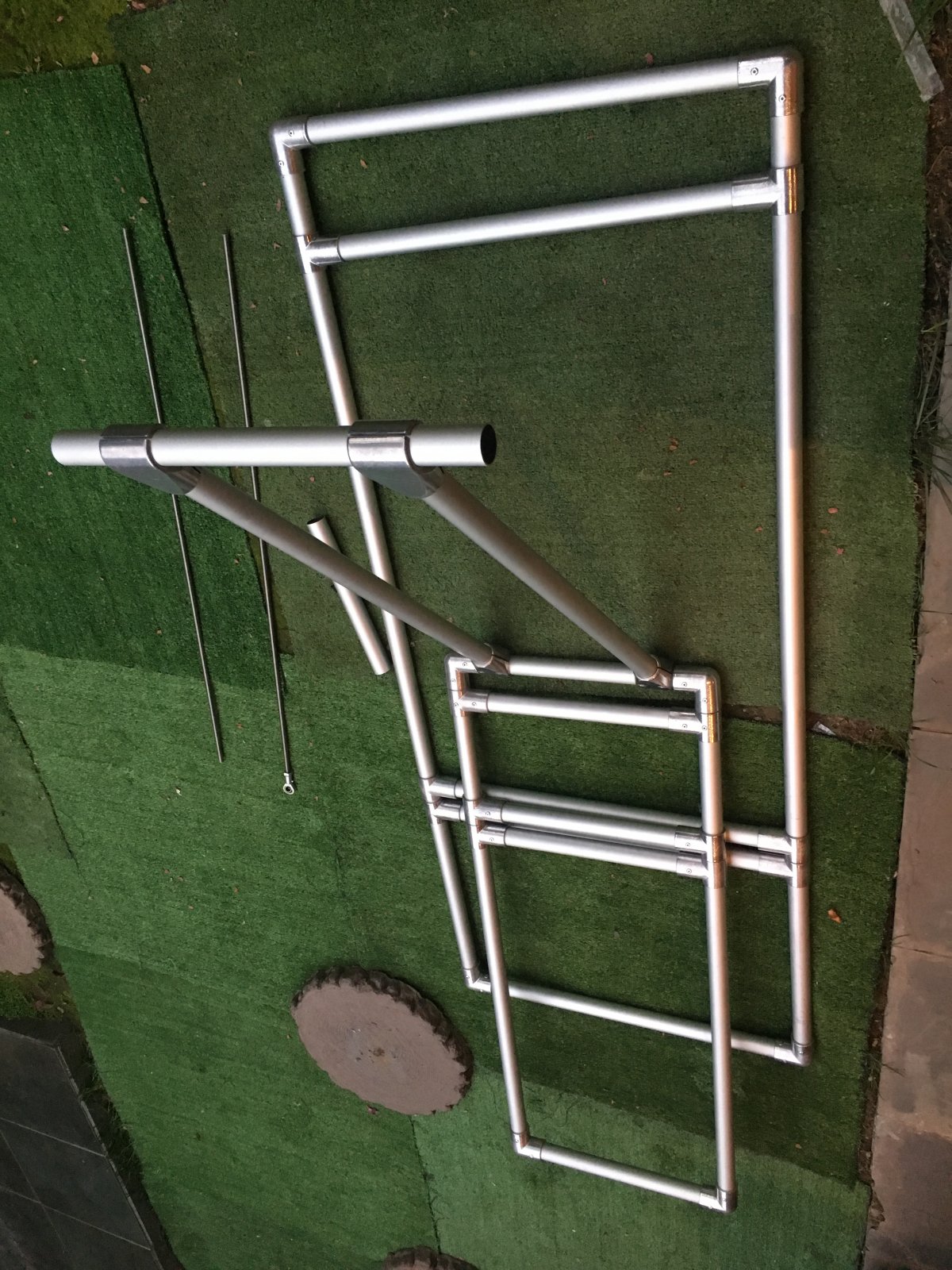

    I was cutting aluminum for my structure, I'm playing very fine with the resistance, but betting on a better termination, lighter and easy of Assemble (use rivets! Similar as in airplanes!) but, Allen bolts on the Cardan, and reinforcement plates at the critical points.
    I am attaching some photos, I will be out of the country for a week, so I think in two weeks I will finish everything !!
    best regards!

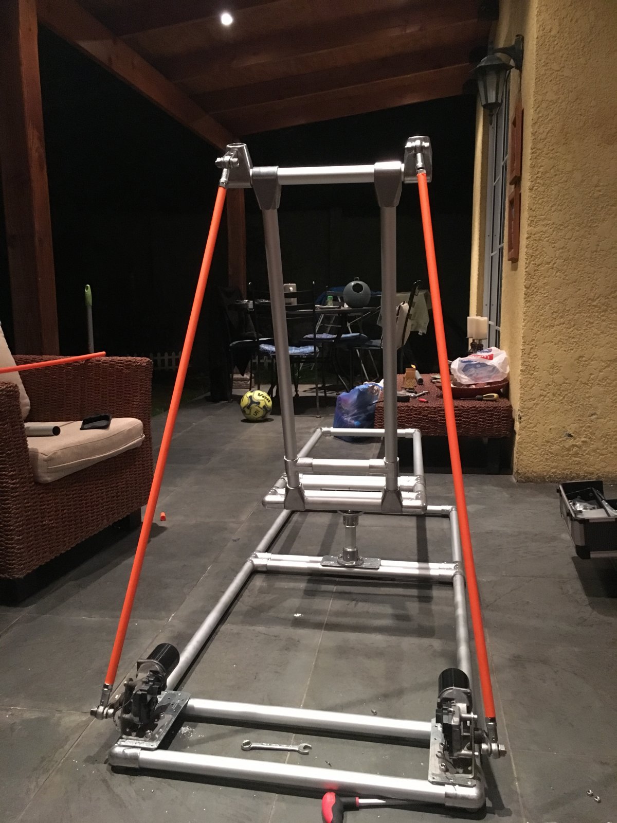

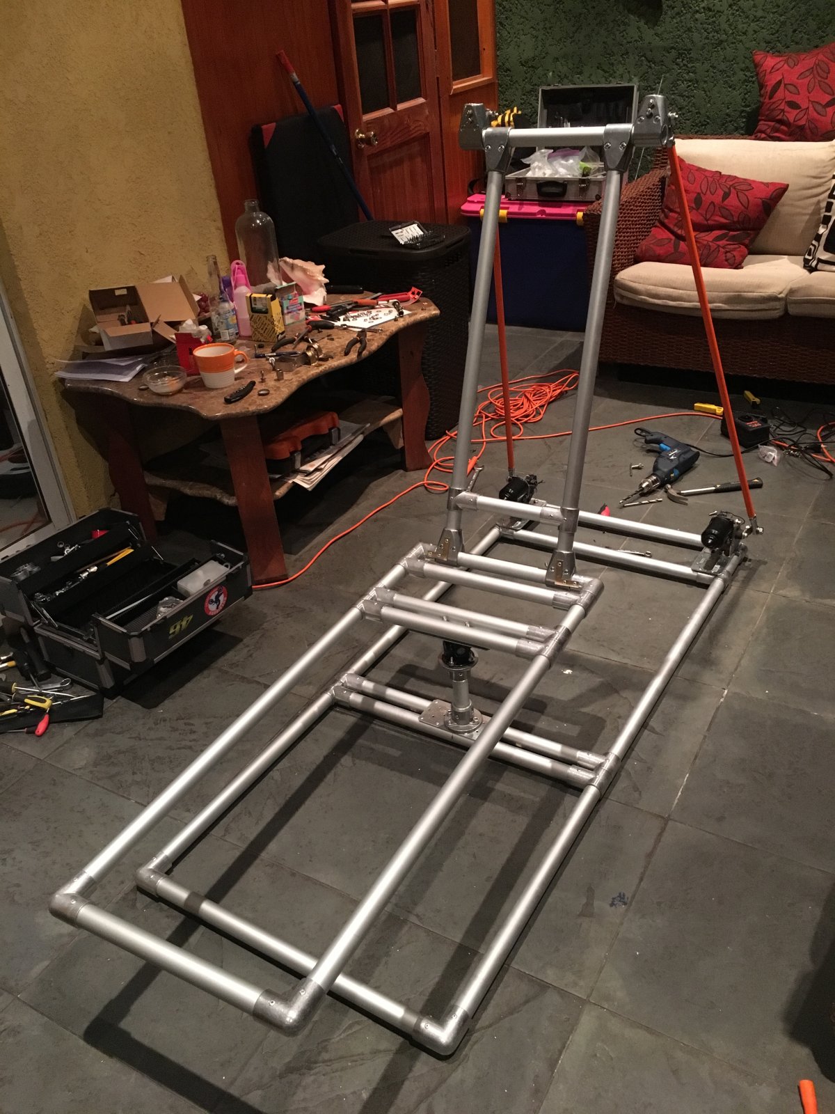

    Current Stage...

    great work especially for the 46 sticker :thumbs
    a thing i noticed is when you turn on a right corners the chair should move to the left and opposite for left corners ( sway)

    Dr. Rossi! the biggest (it's my toolbox)
    Yes, the Sway works correctly, but it was already 2 AM I need to regulate the height of the arms of the wiper, today I will film one with more detail of the movements, after correcting.
    the feeling with the playstation VR+ 2 dof + Body Shaker, is really very good, I will connect a fan to feel the wind ... !!

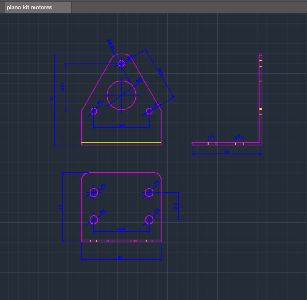

    Hello @creazyrider , only the structure must weigh as 15 kilos +/ - and 250 rivets!, works very well, just need to reinforce the most critical parts with metal clamps.
    I have all Drawings in CAD, if you want them, give me your e-mail and I will send them to you; I wanted to use square aluminium profile , but in Chile the importer only have the profiles square and not the unions ..
    Yesterday, I have finished adjusting the arms of the wiper, y @insanegr , he was right, I had to invert the motor cables, now the sway is correct.
    Project car works 100%, but I tested the F1 2016 and , F1 2017, and the movement of sway and surge, is very soft (in the axis testing simtools move very little) , only increases I get out of the track, try to increase the% in the AXIS assignments but I can not increase the movement. :( , I need help.
    best regards.
