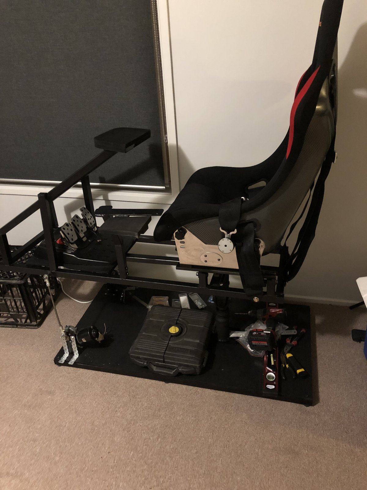

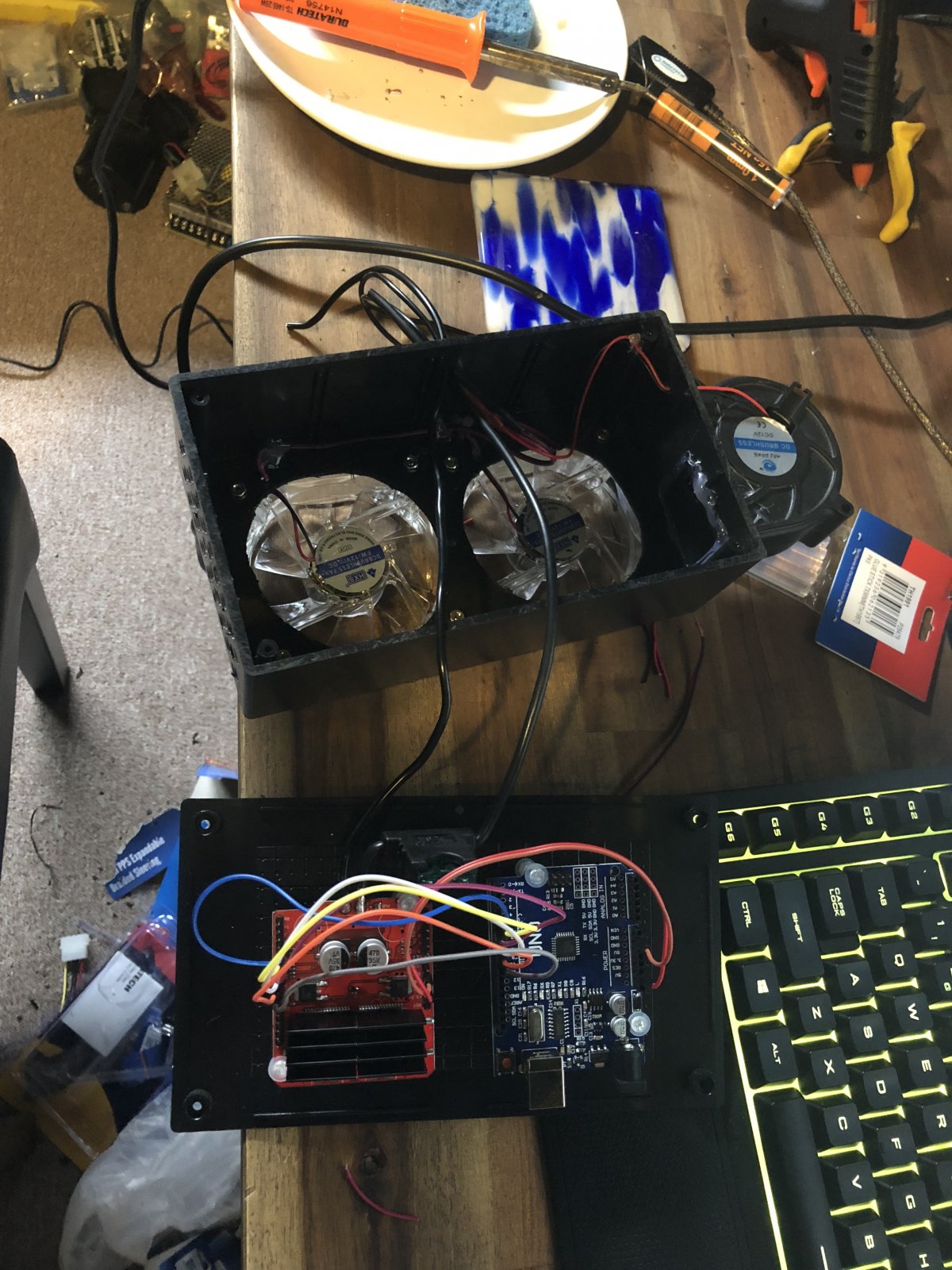

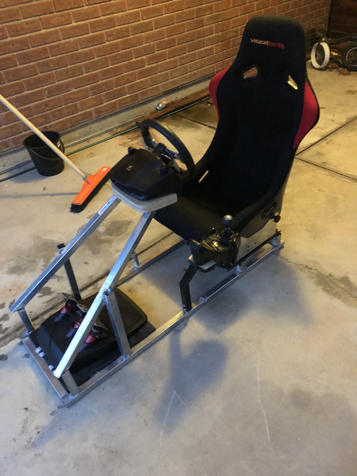

    Hi everyone names Dion
    Started building my first racing sim a few weeks ago Almost finished.
    Fingers crossed I’ll finish it tonight after work.
    Running a uno r3
    Moto monster
    150watt 12v power supply
    2x 80mm pc fans
    2x vp/vn commodore wiper motors
    G27 wheel/pedals/gears
    Custome hand brake
    21,592
    151,215Coins

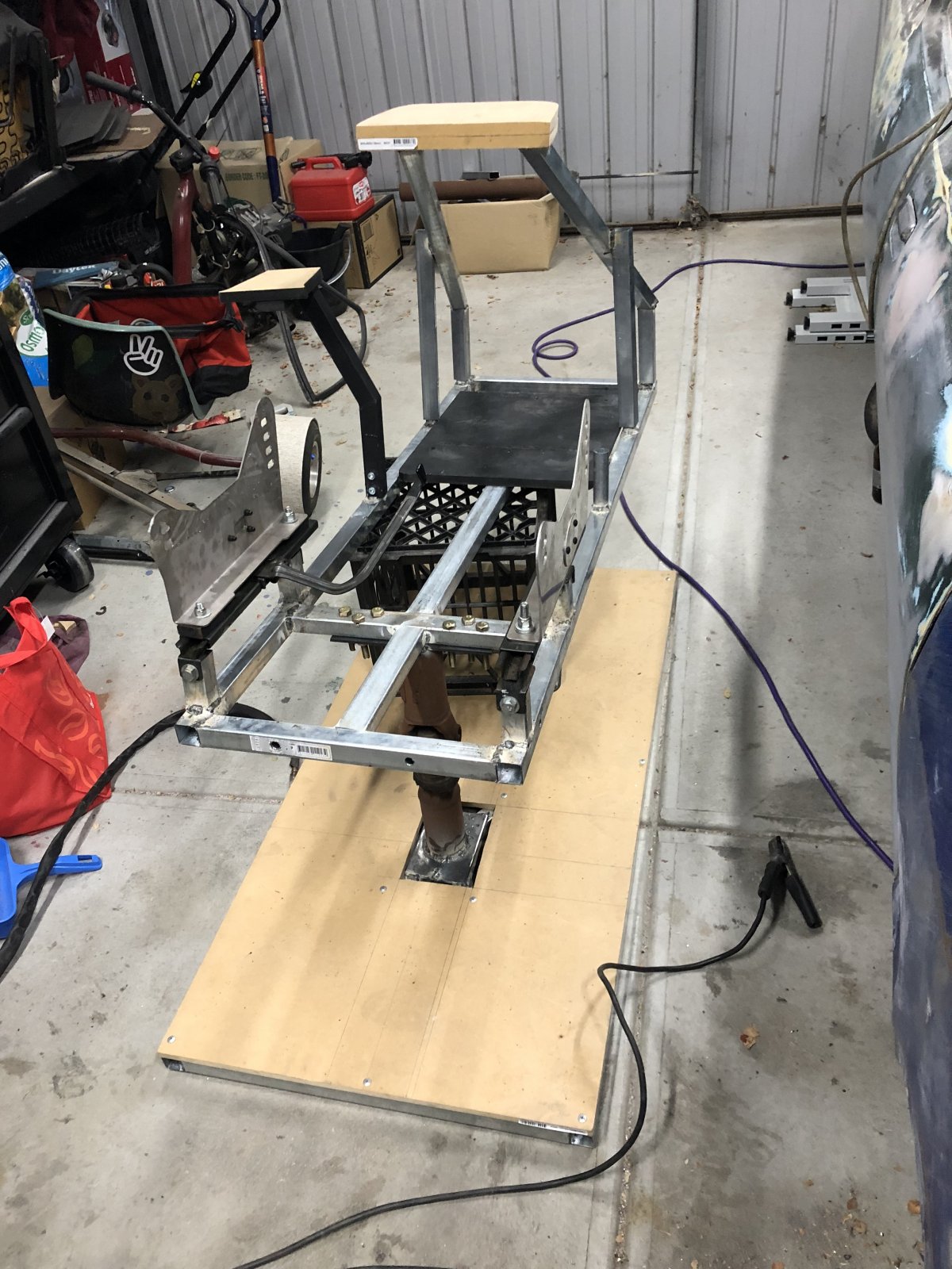

    Welcome @dion, thanks for sharing your rig.
    A couple of comments for you to consider.
    Be aware that you usually need to ground isolate wiper motors: https://www.xsimulator.net/community/faq/wiper-motor-mandatory-ground-isolation.25/
    I suspect your placement of the uni joint at the mid point of the upright is likely to result in some odd geometry as the rig moves and will increase the load on the motors, normally the uni joint is placed as close to the seat as possible: https://www.xsimulator.net/community/faq/universal-joint-placement.108/
    The motor mounts may also be a little flimsy.
  3. dion
    dion New Member
    Jan 8, 2018
    8
    Adelaide, Australia
    134Coins
    +8 / 0 / -0
    2DOF, 3DOF, DC motor, Arduino
    thanks for the suggestions
    i have grounded them in 2 points
    as for the uni joint, ill have to deal with it an see how i go hahaha dont really want to cut it up
    motor mounts were flimsy but i have now beefed them up so all good there now

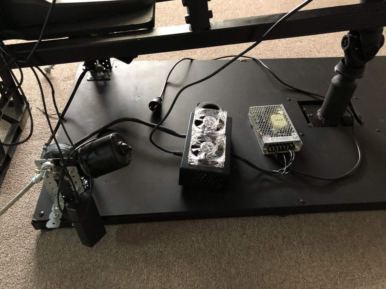

    Update from Friday to now
    Installed scm3 code to my Arduino, wired it all up and gave it a test but no luck
    Lots of hours but it seem to be getting worse
    Ordering new moto monsters tomorrow as I Believe that’s where the issue is

    Hey dion, as noorbeast already mentioned, the uni joint would be much better located closer to the bottom of the seat. I know changing things like that is a bit of a job but it would be very much worth it.
    All the best with your project!

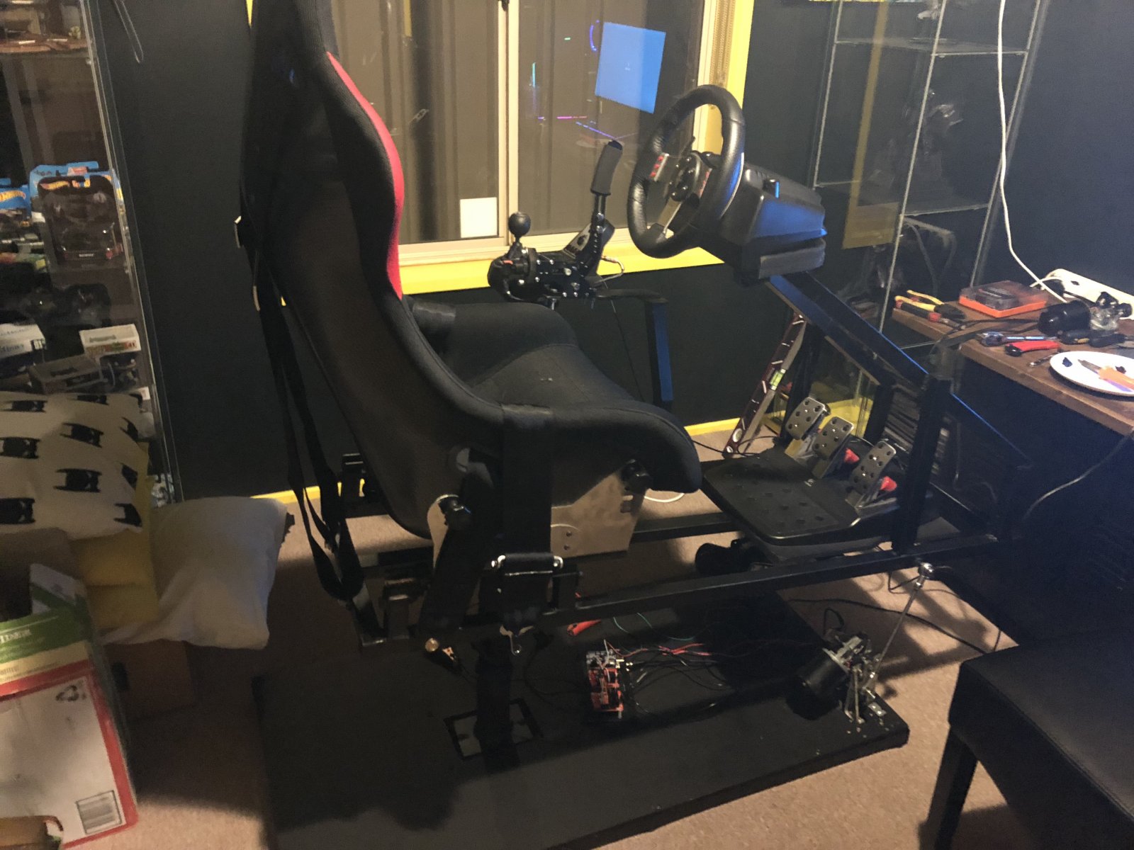

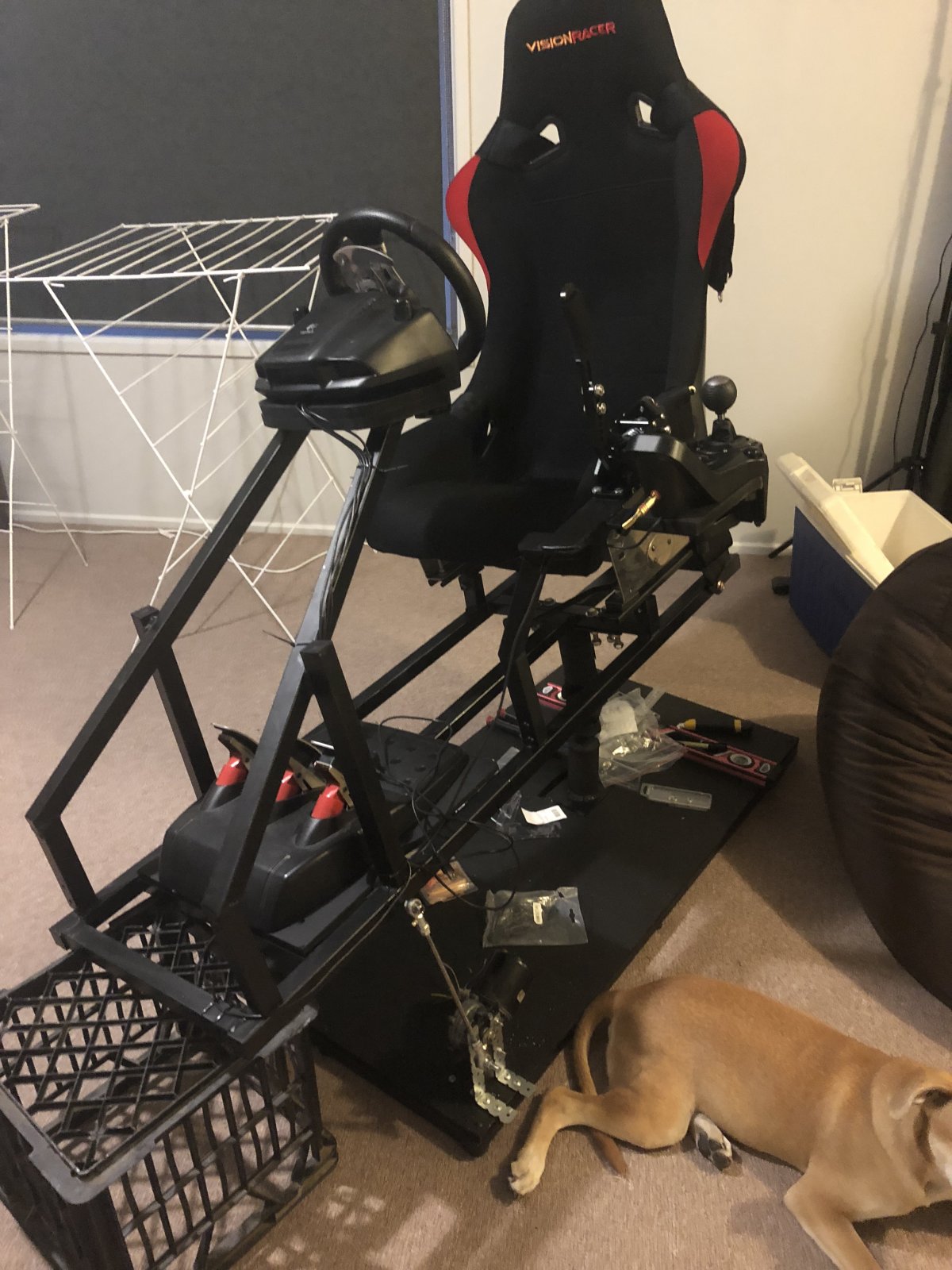

    so another update finally got my sim up and running and i think for my first try it is awesome!!!!
    few issues with faulty pots and 2 faulty moto monsters.
    now getting into the fine tuning and making adjustable arms for the motors to see if i can get some bigger angles
    ill try post a vid soon

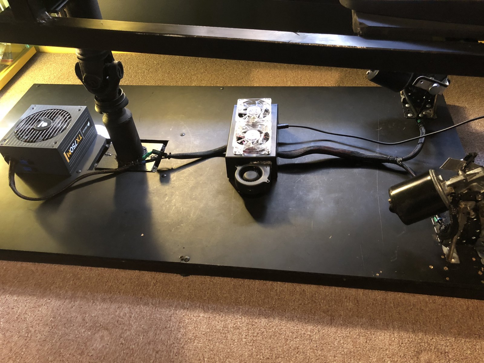

    So had it running but my power supply just wasn’t enough so I have upgraded to a 750watt pc psu 79A max
    Also 1 motor must have been on its way out and just had no power. Luckily I got 4 of the same motors together swaped it out and all good.
    And Covered up all the wiring up nicely
    That’s a bit of an update.
    Can’t seem to upload a video. Will try again when I’m on my computer.
    Next longer arms for the motors (some time this week)
