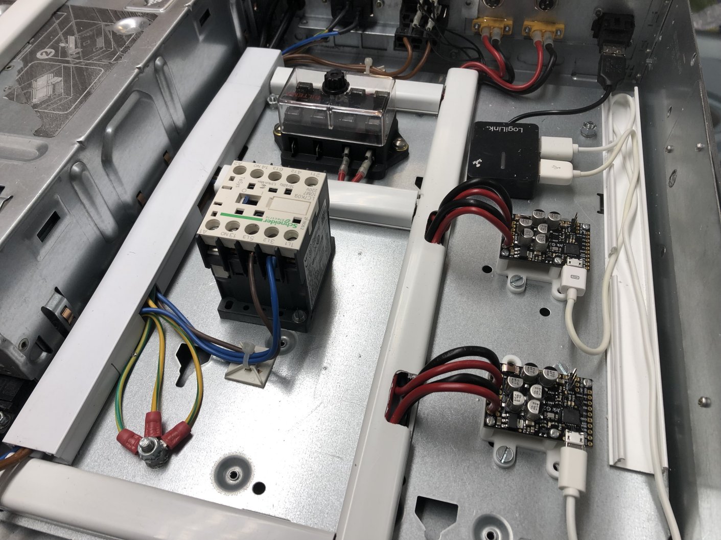

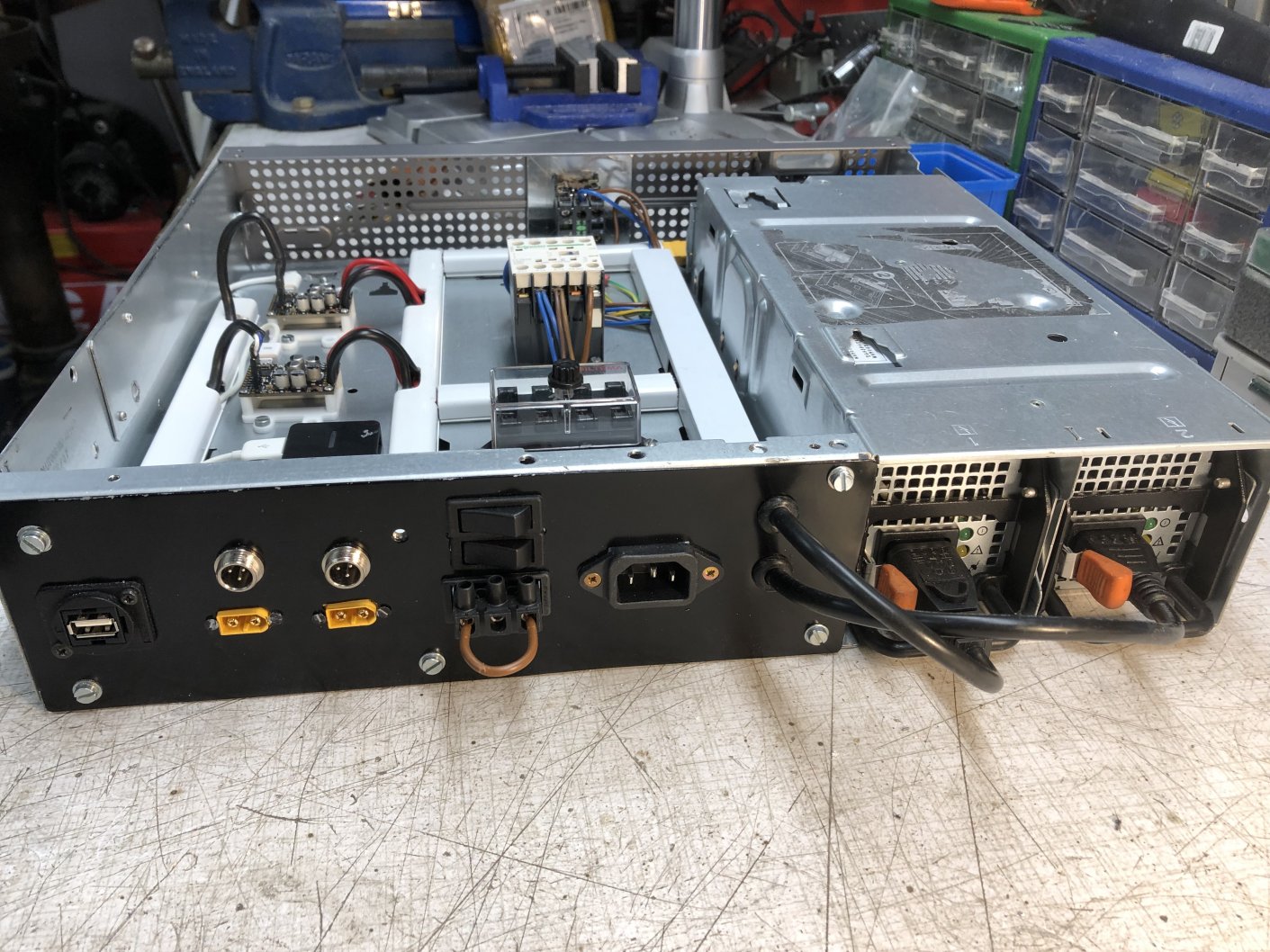

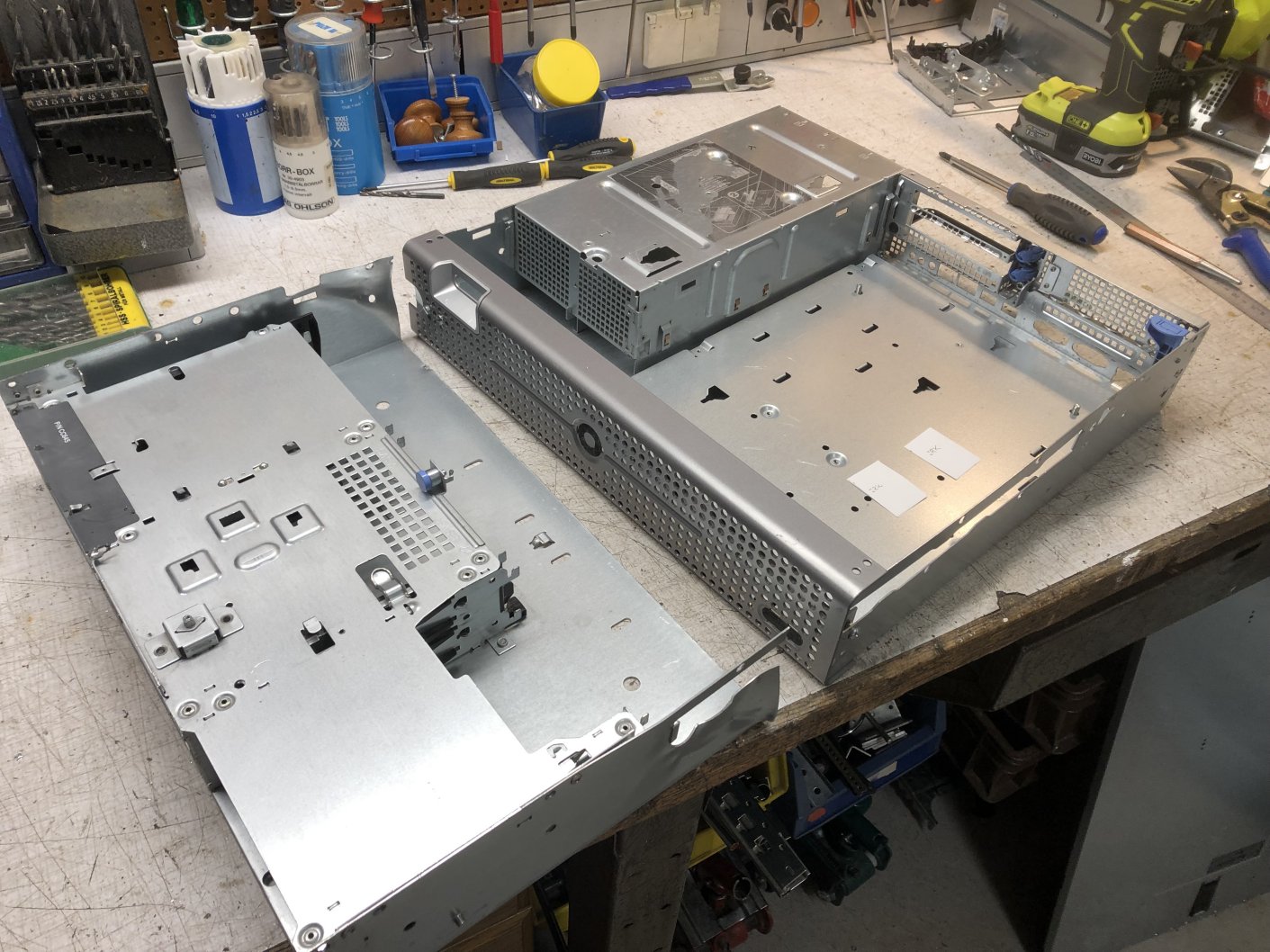

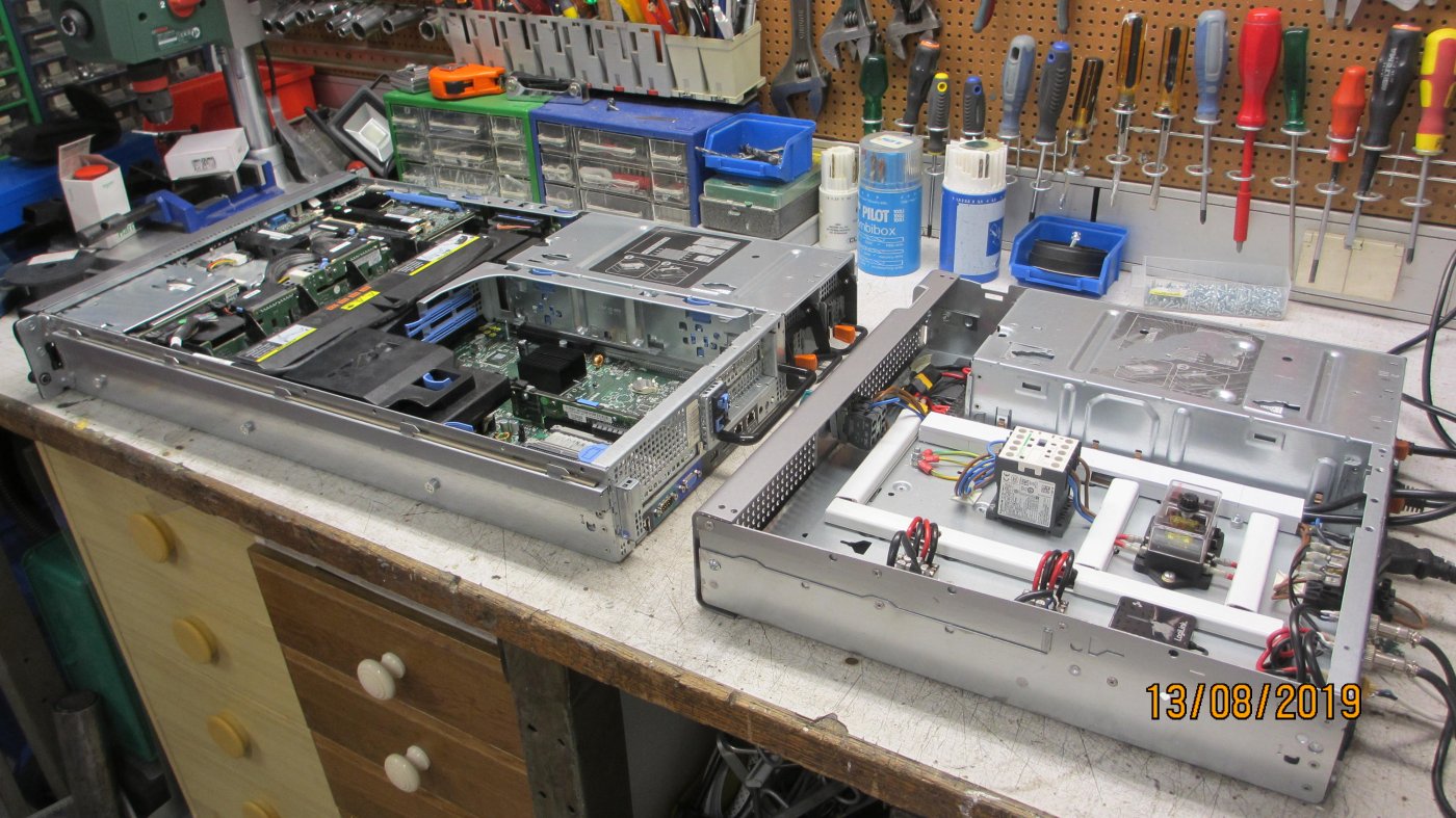

    Step 1 – Cabinet with all electric and electronic stuff.

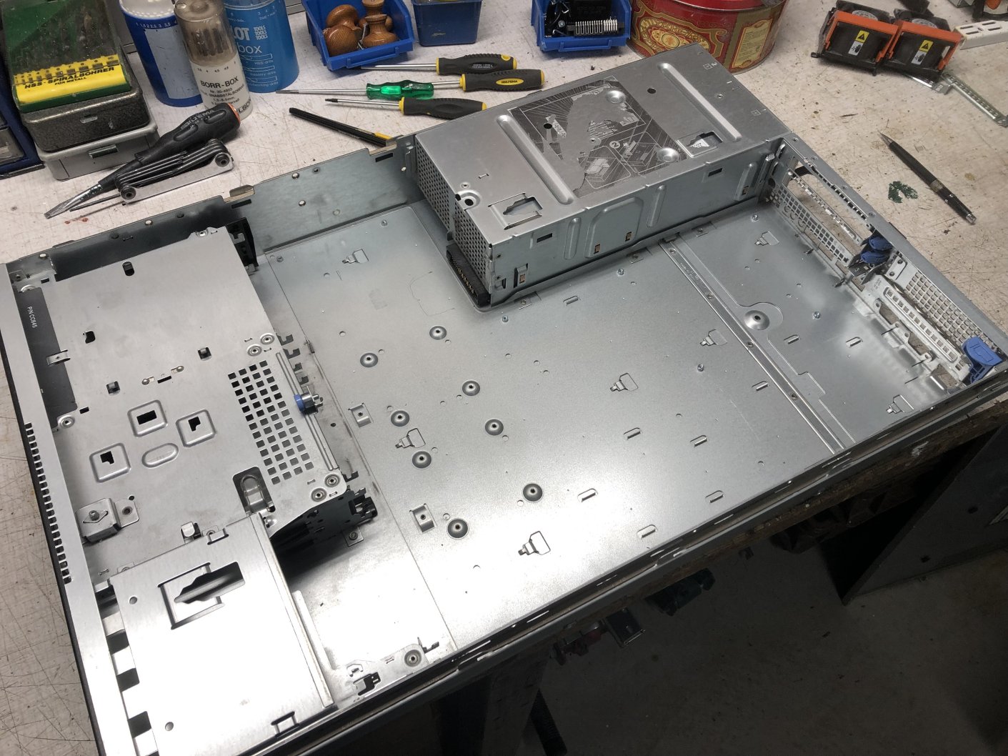

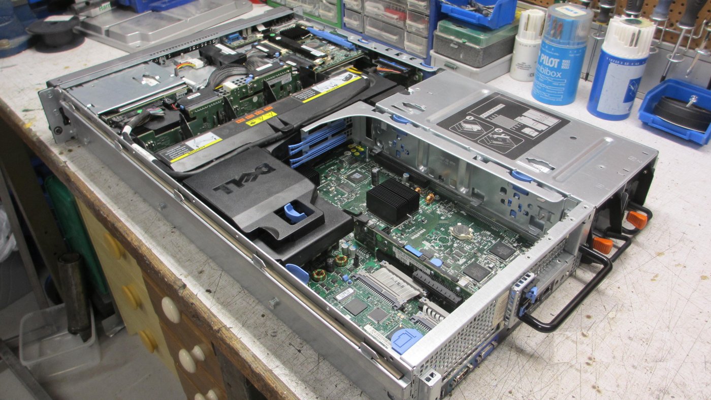

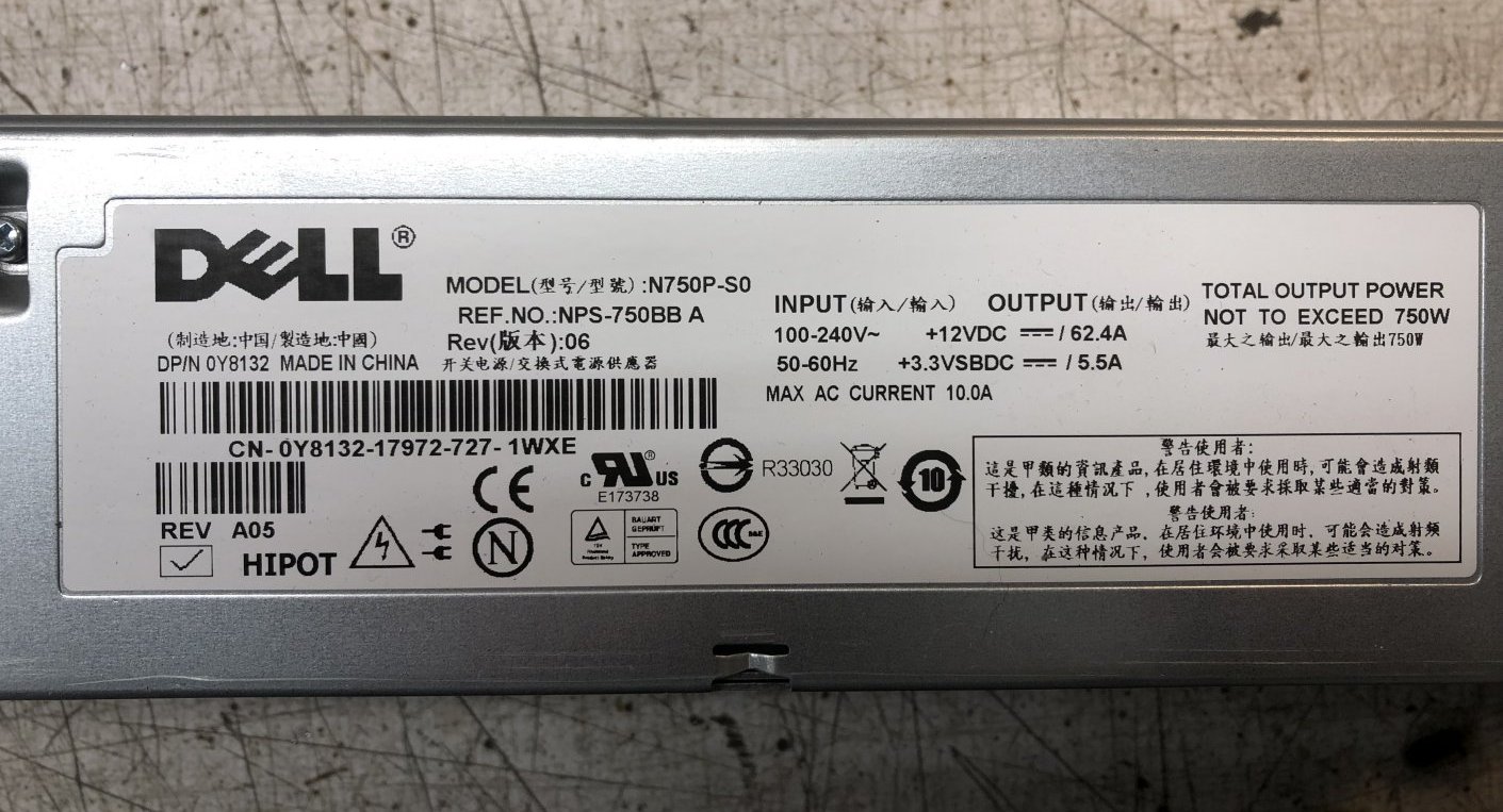

    1. Starting point, an old Dell server with two 12VDC, 64Amp, Power Supplies. A perfect chassis to start from.
    2. Label on the power supply.

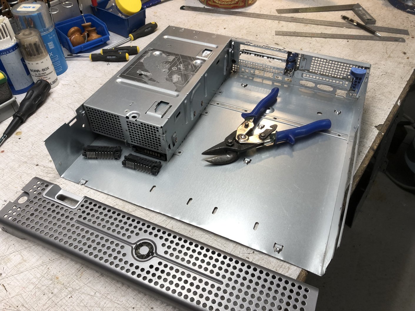

    3. The old server chassis was too big and needed to be resized and rebuilt after the old electronics was removed.
    4. I reused the front panel from the old server and kept the two slots for the power supplies. The front panel will get the main power switch.
    5. Some unused metal for recycling…

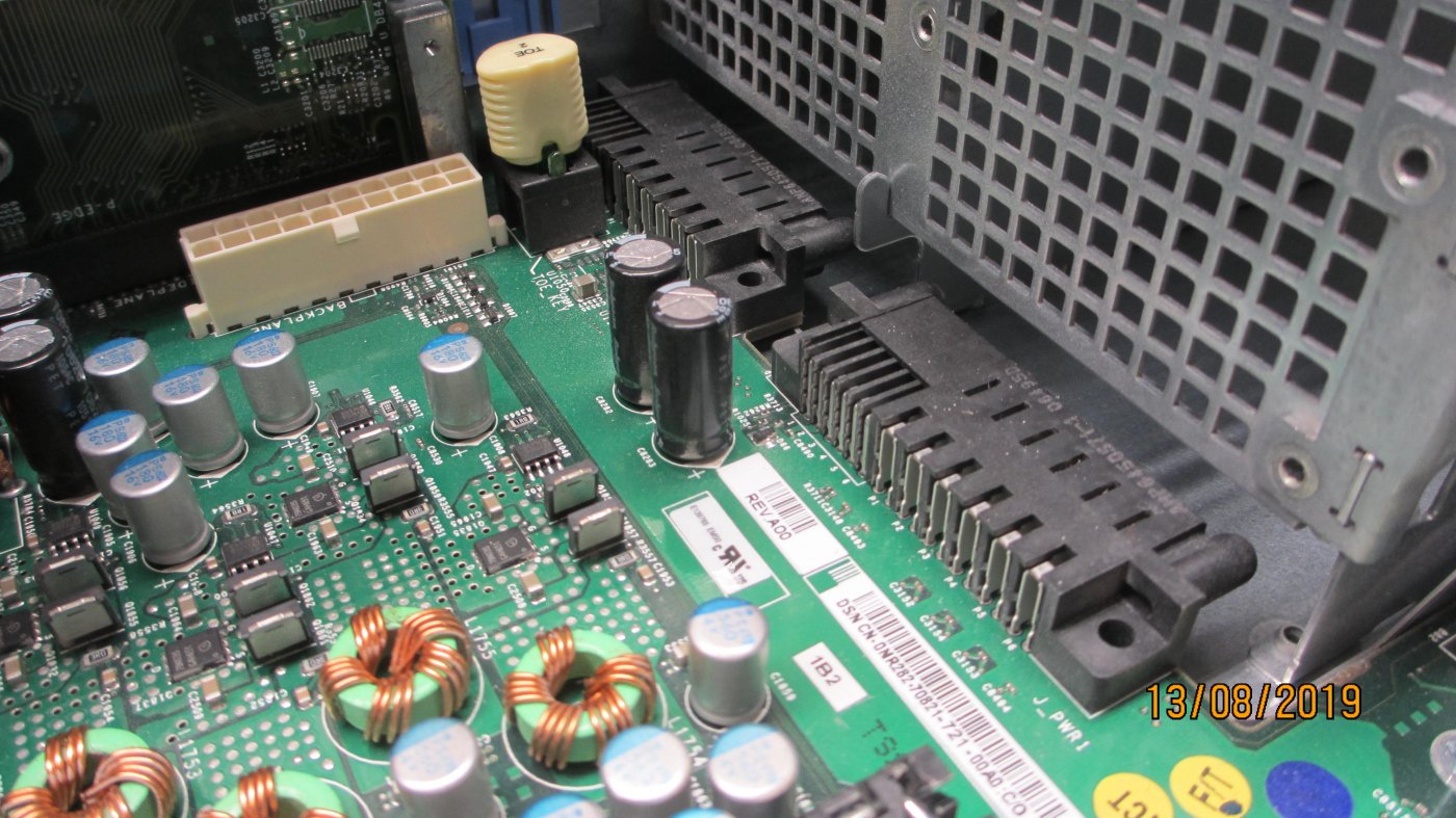

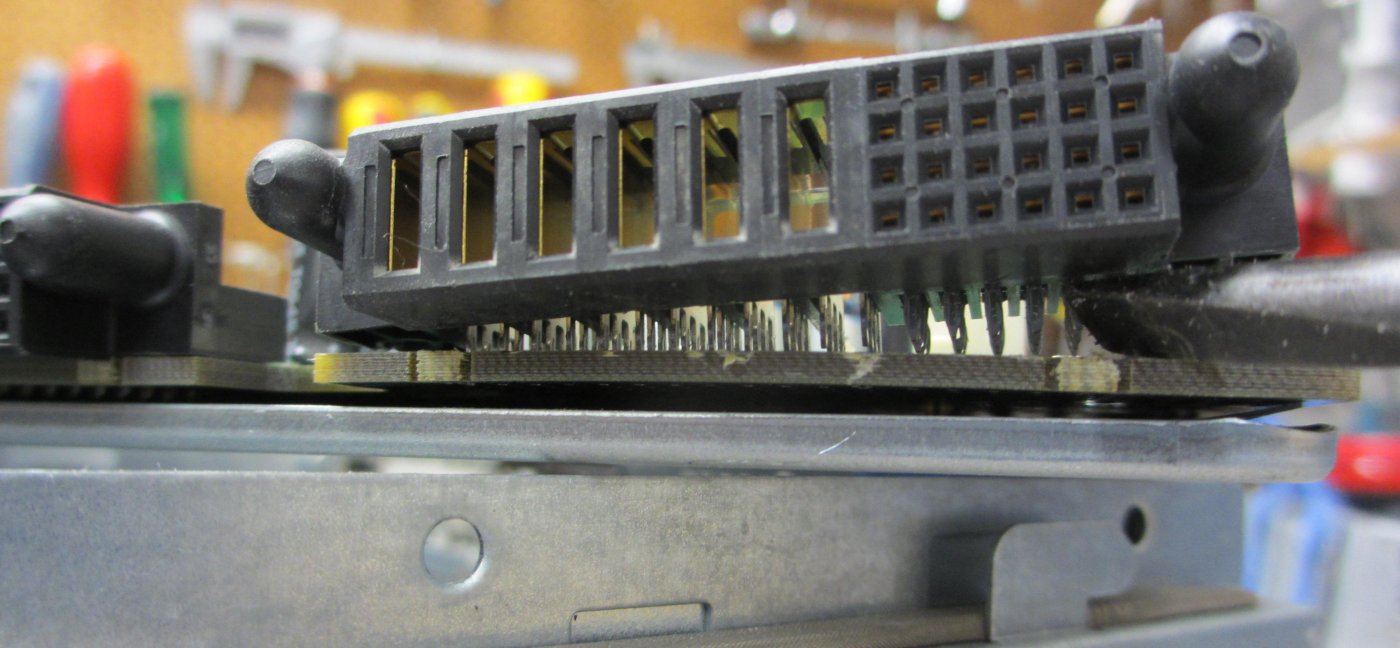

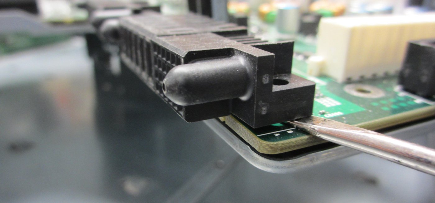

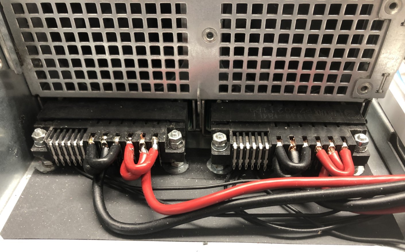

    6. The power supply contacts will be reused and be put back in the chassis when the circuit board is removed to be able to ”plug-and-play” the power supplies without soldering or mechanical work.
    7. The contacts are not soldered and can be removed carfully from the circuit board by a screw driver. Start with a small one to open a gap and then use a bigger one to ease the contact from the circuit board.

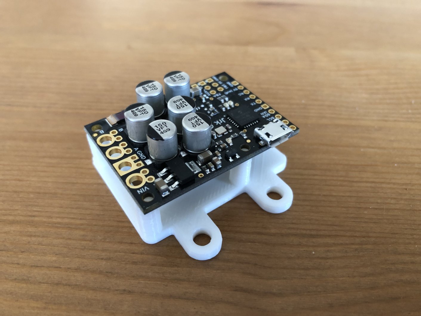

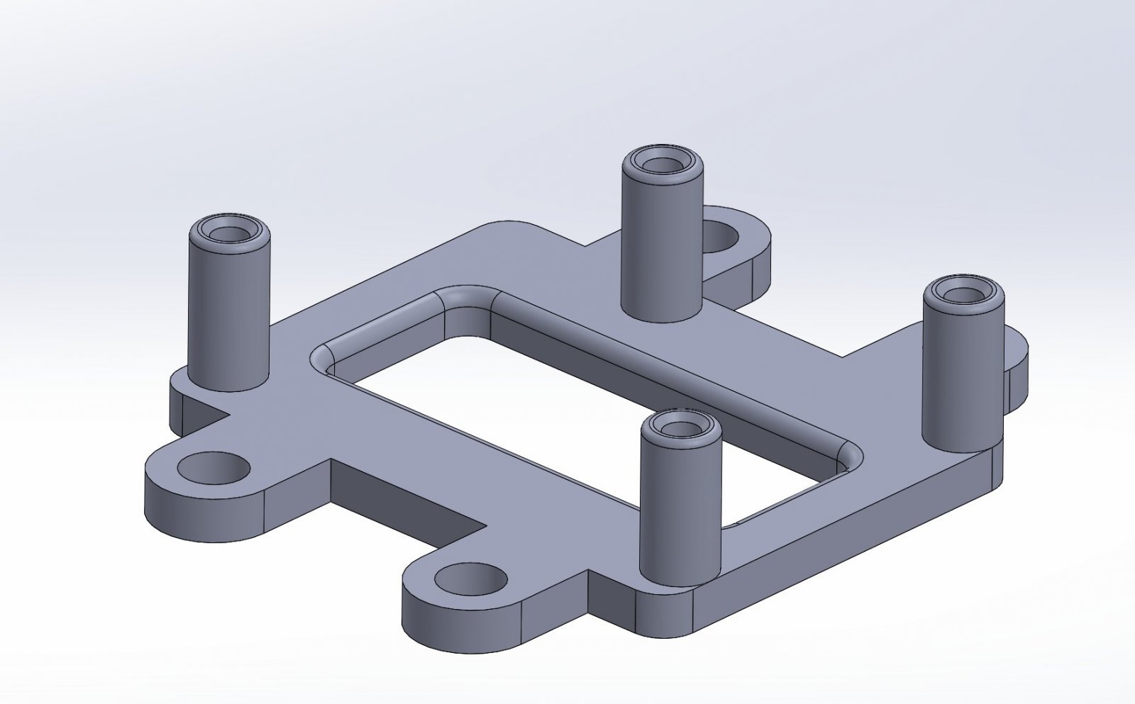

    8. A buddy made brackets in his 3D printer for the Pololu JRK G2 12V27
    Download the STL file from ... https://www.thingiverse.com/thing:3837389
    (too large to be uploaded here)
    [​IMG][​IMG]

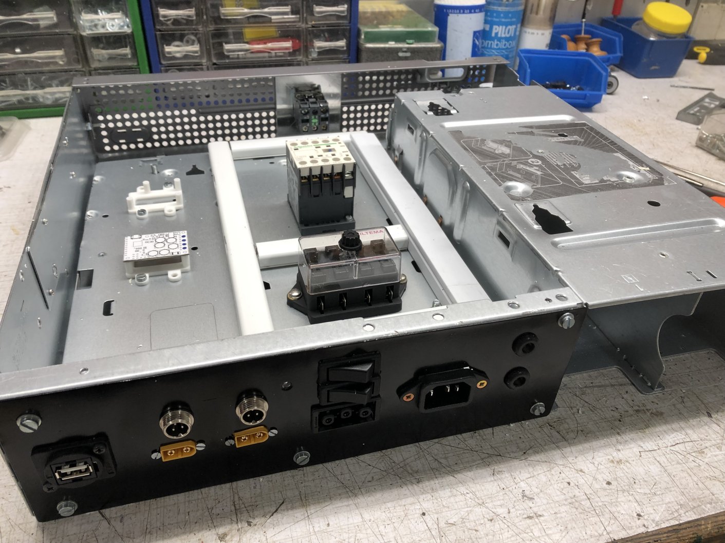

    9. The rear side of the cabinet got connections for the USB connection, motor power outlets, potentiometers, switches for PSU fan speed, emergency stop circuit and main power input. And the front panel got a main power switch witch control the mini contactor (in the middle of the chassis).
    10. The contacts for the power supply in place and connected.
    11. View of the componets. Note that no heat sink is needed on the JRK G2’s.
    [​IMG][​IMG]
    12. View from the back of the cabinet with all components in place and ready for test.
    13. Ready! Before and after…
    Today status: All components has been tested and works as expected and it’s ready to be used, first for the mini test rig and then the full rig :)

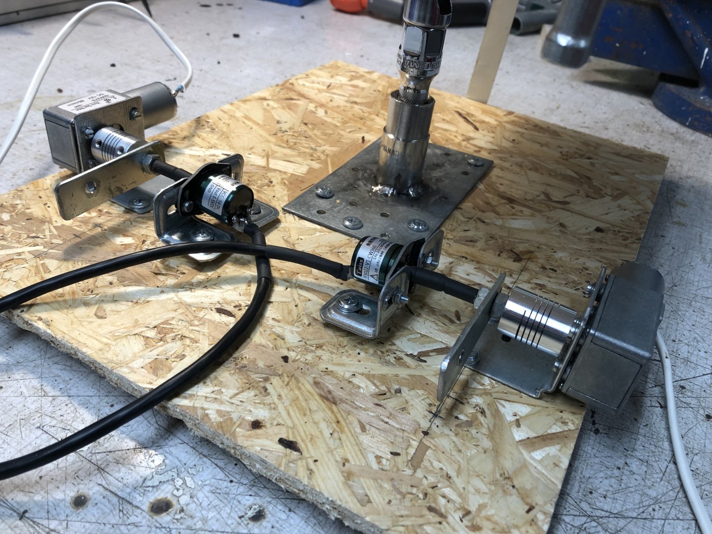

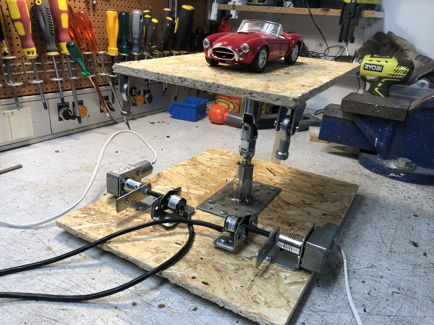

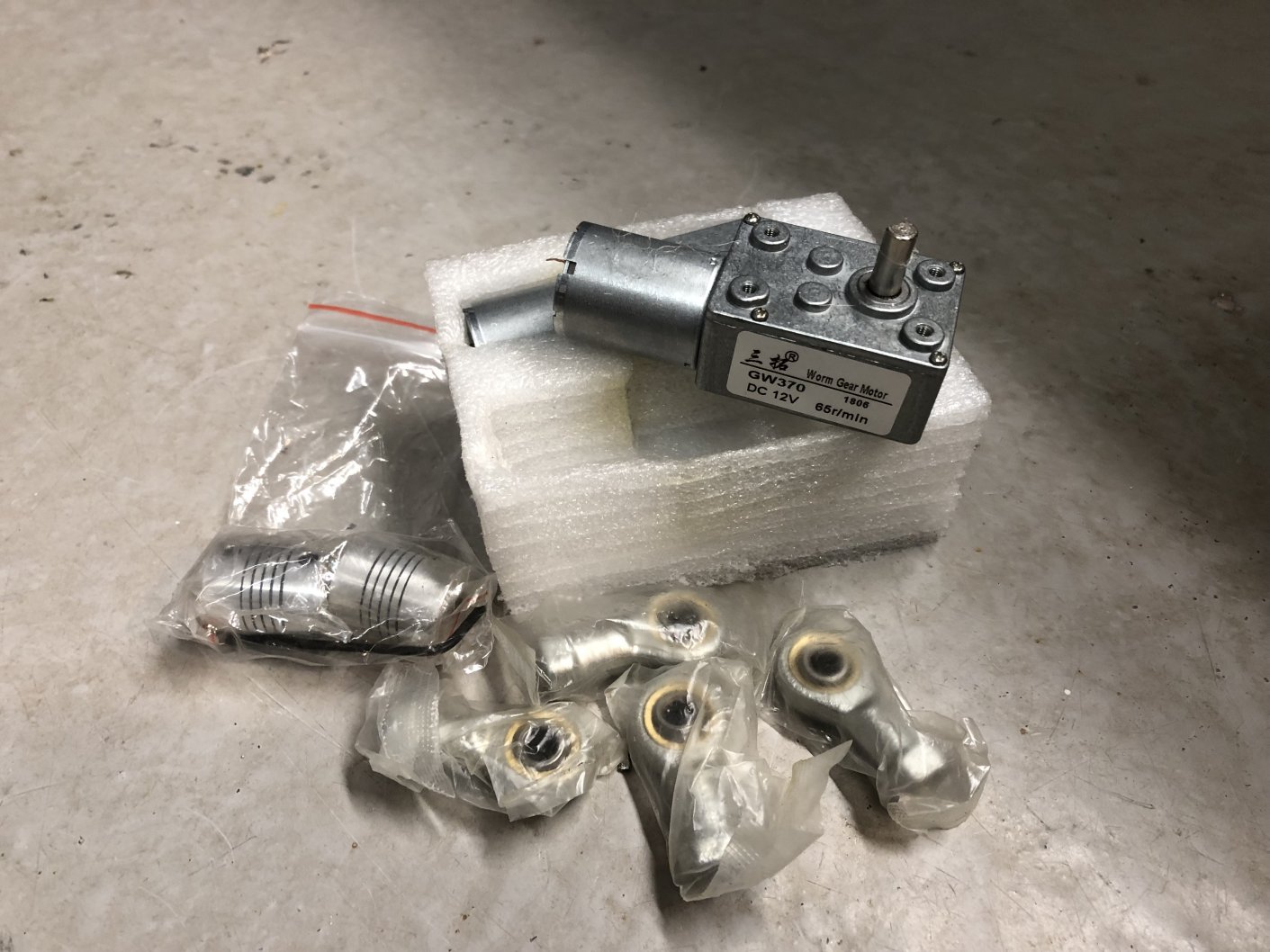

    Step 2 – Mini test rig
    The small test rig use 12V/2W worm gear motors and will help me to test that everything works as expected and to play with the settings to learn the basics before I start the setup of the full size rig.
    So far it has not been tested, focus now is to make the full size rig because I have limited time to spend on the project in the coming months.

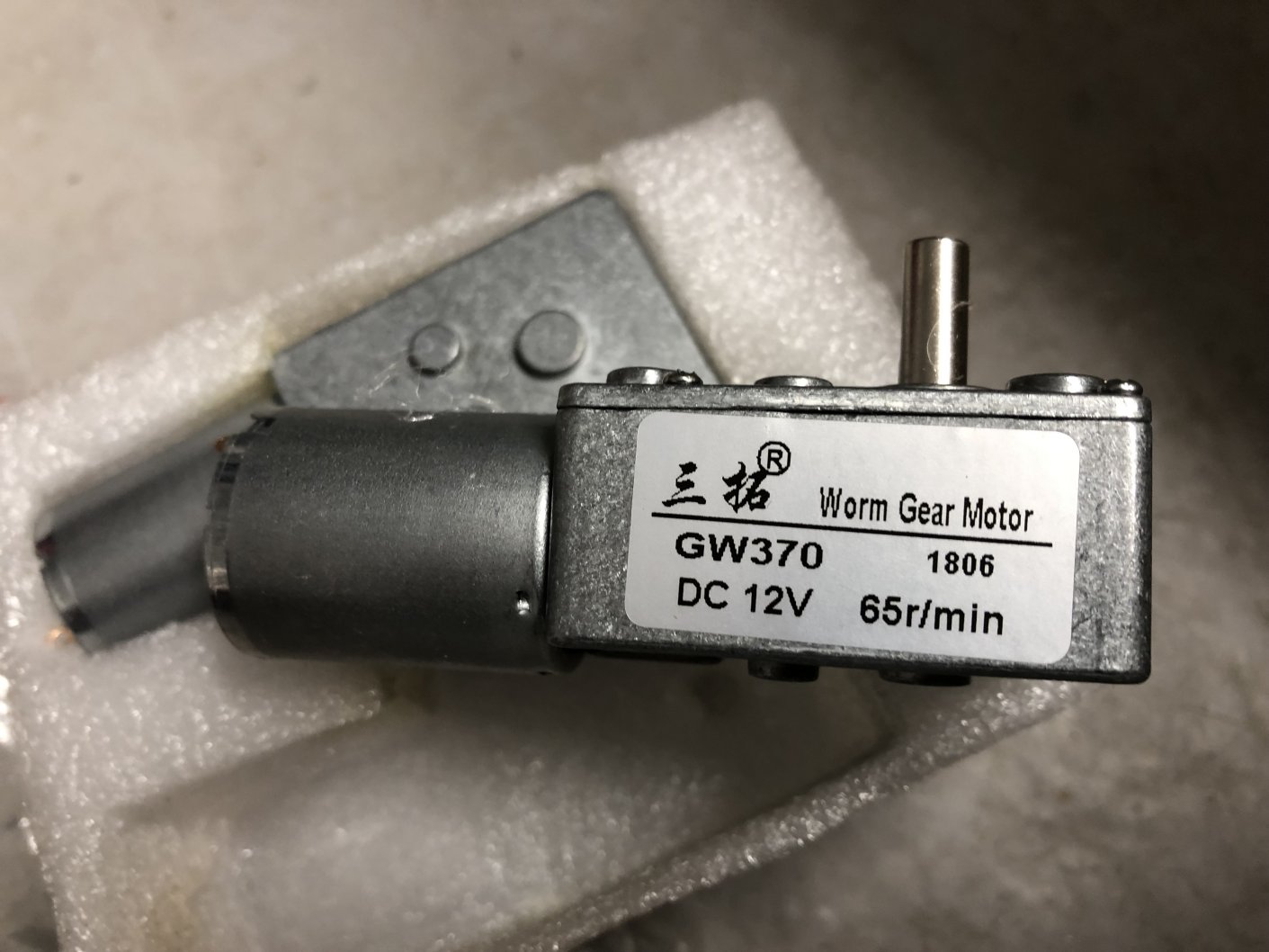

    1. The small worm gear motors, flexible couplers for the potentiometers and M6 rod ends arrived.
    2. 12VDC, 65rpm, worm gear motor

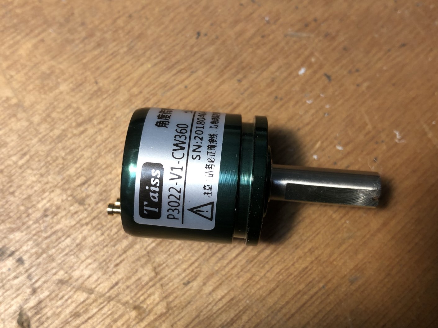

    3. One of the two hall potentiometers.
    4. The test rig, and of course an AC Cobra model on top if it :)
    Almost complete except two rod ends and rods.
    5. A closer look. The u-joint is from a ½” tool set.
    Main components used…
    2 x Worm gear motors 12VDC 65rpm
    4 x M6 Rod ends
    2 x Hall potentiometers
    2 x Flexible couplers (between motor and potentiometer, 6mm inner diameter)

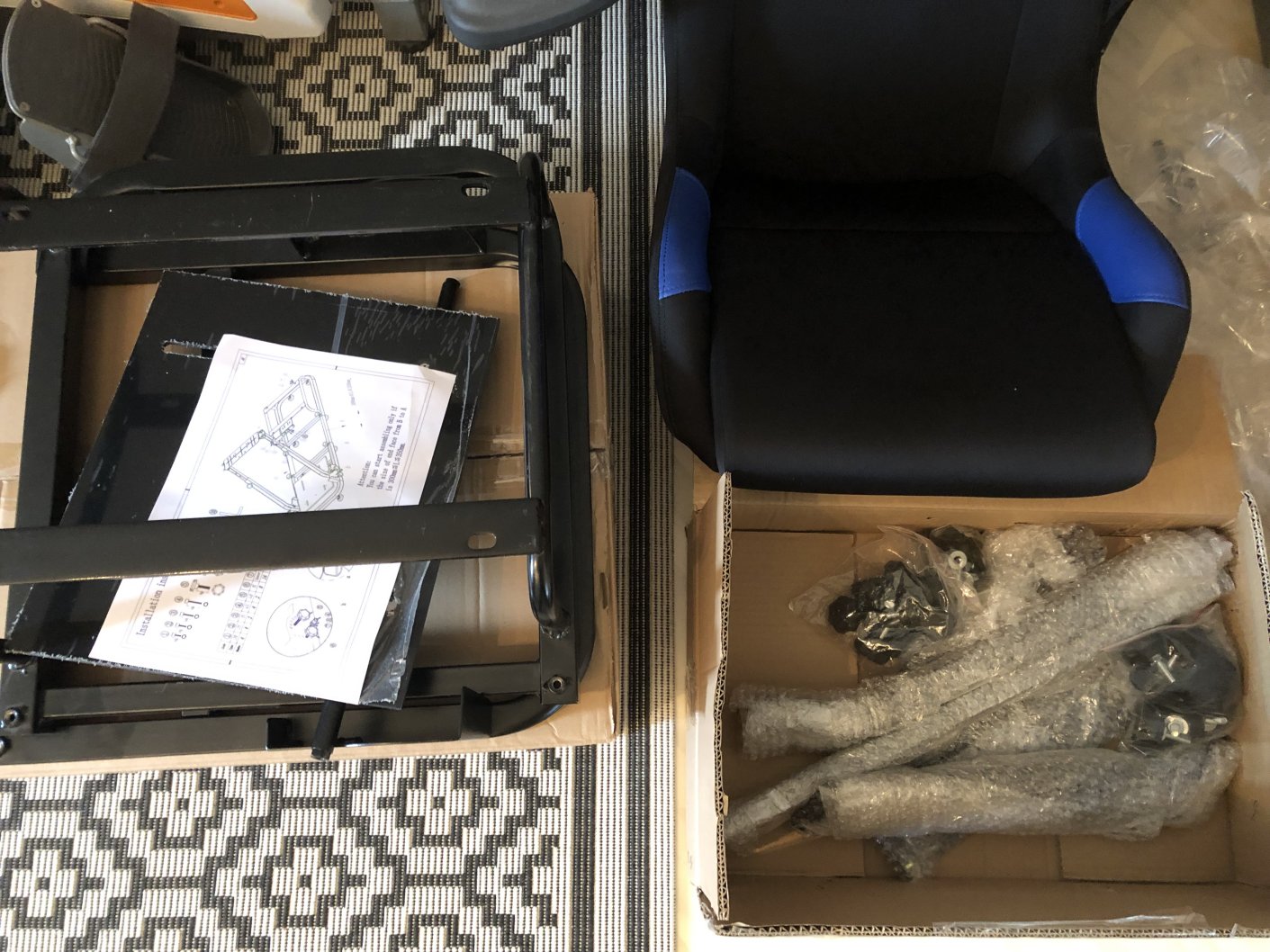

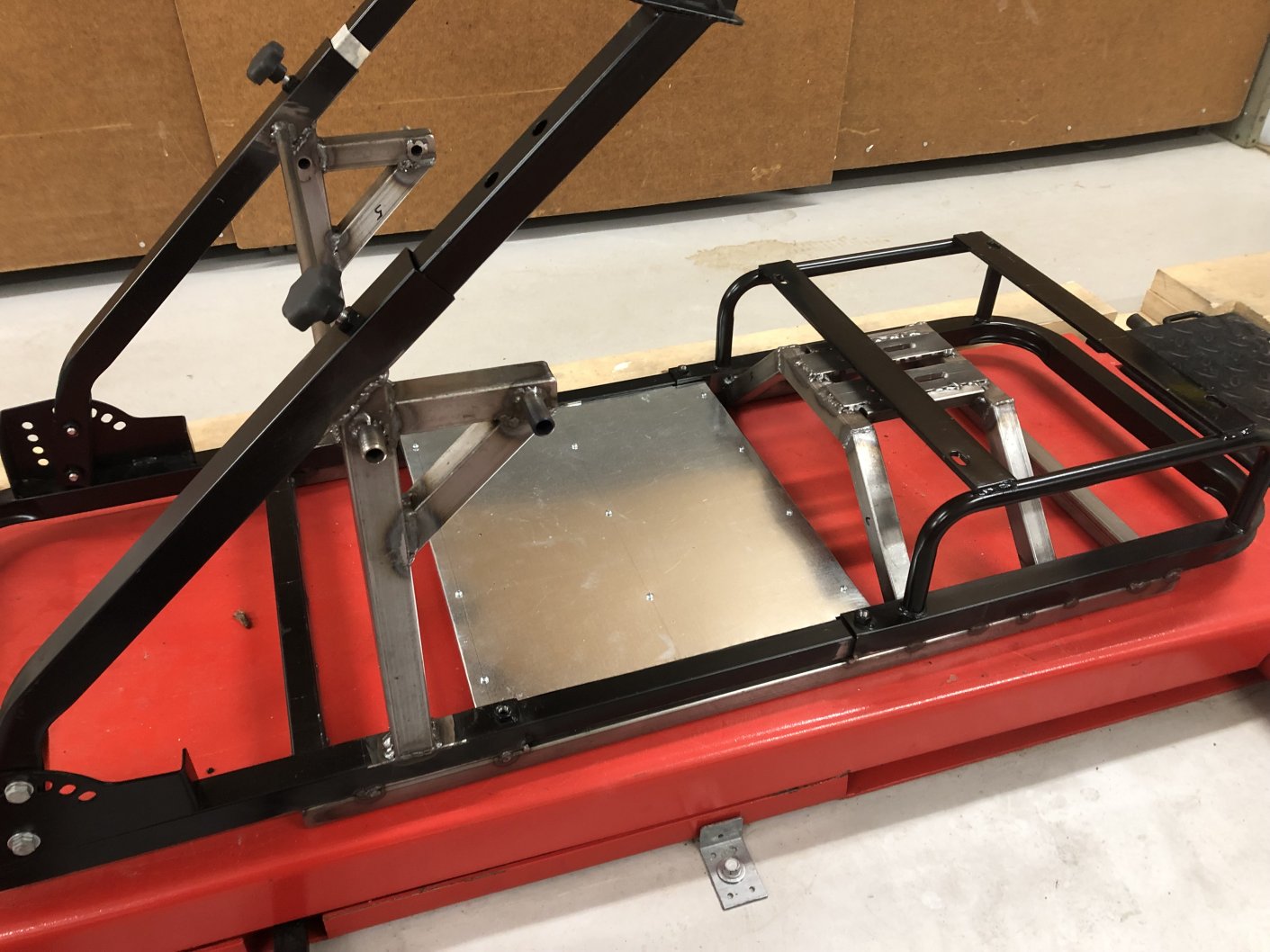

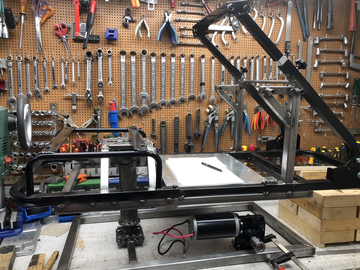

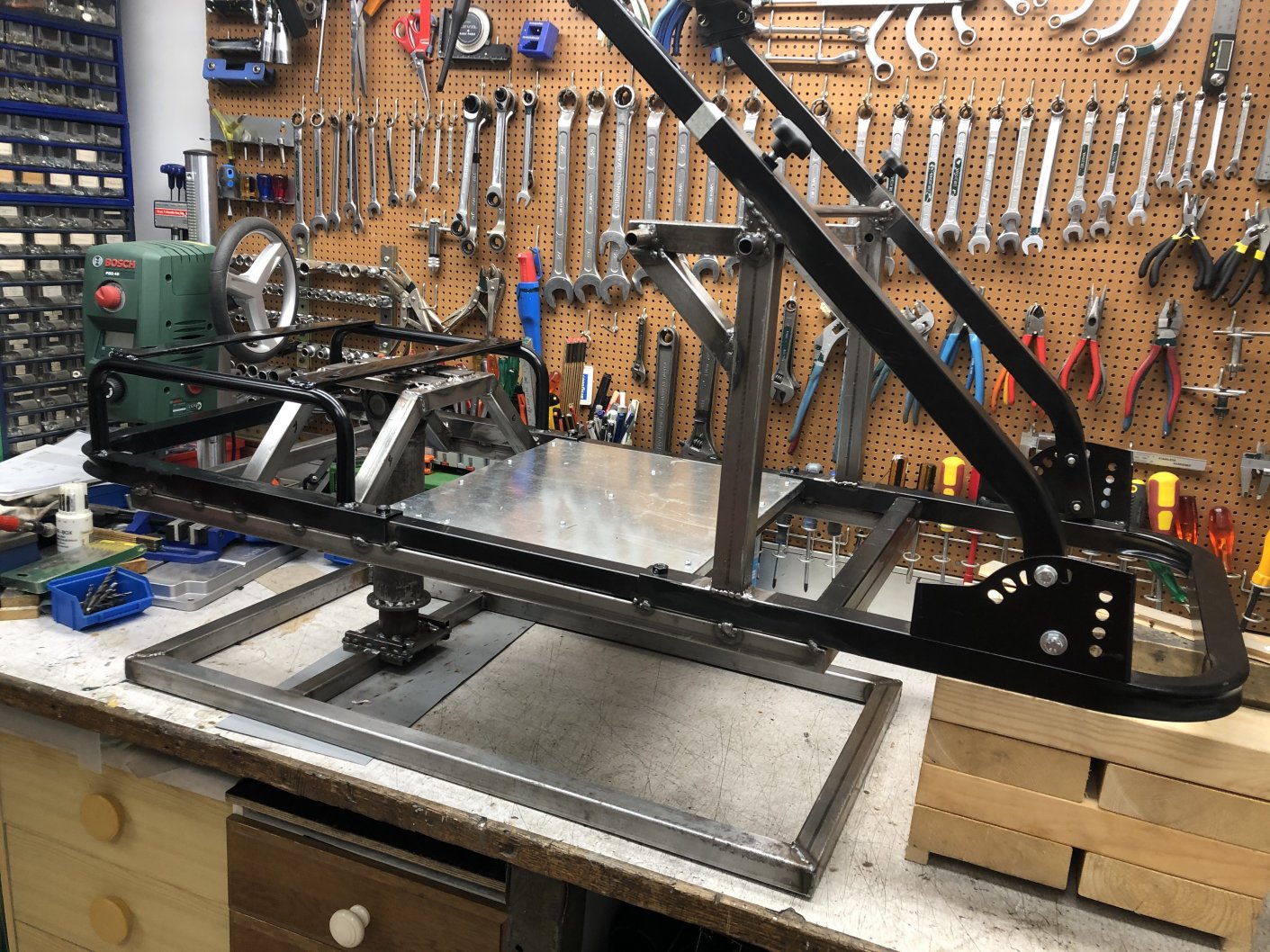

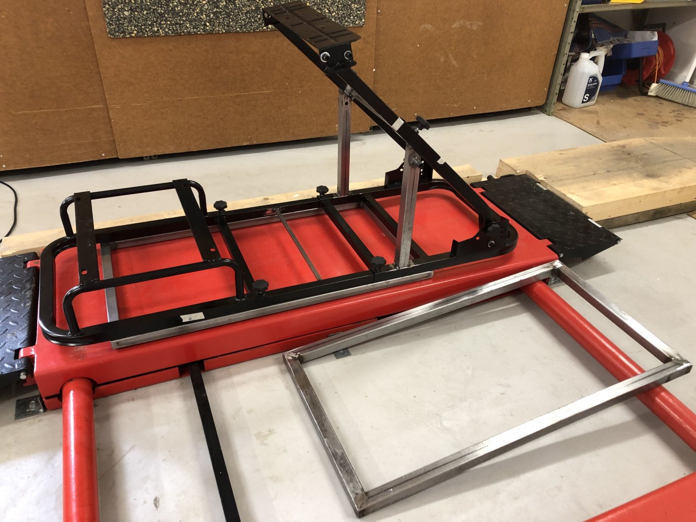

    Step3: Full size rig
    The full size rig is based on a modified fixed FK Automotive sim racing seat plus welded frames and 200W, 12VDC, 50:1 worm gear motors. The reason why I modify a fixed rig like this one is to save time on the construction and to get a flexible starting point to test wheel and pedal possitions etc. before the welding and final measures are fixed.

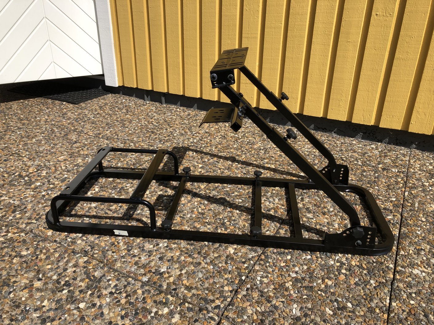

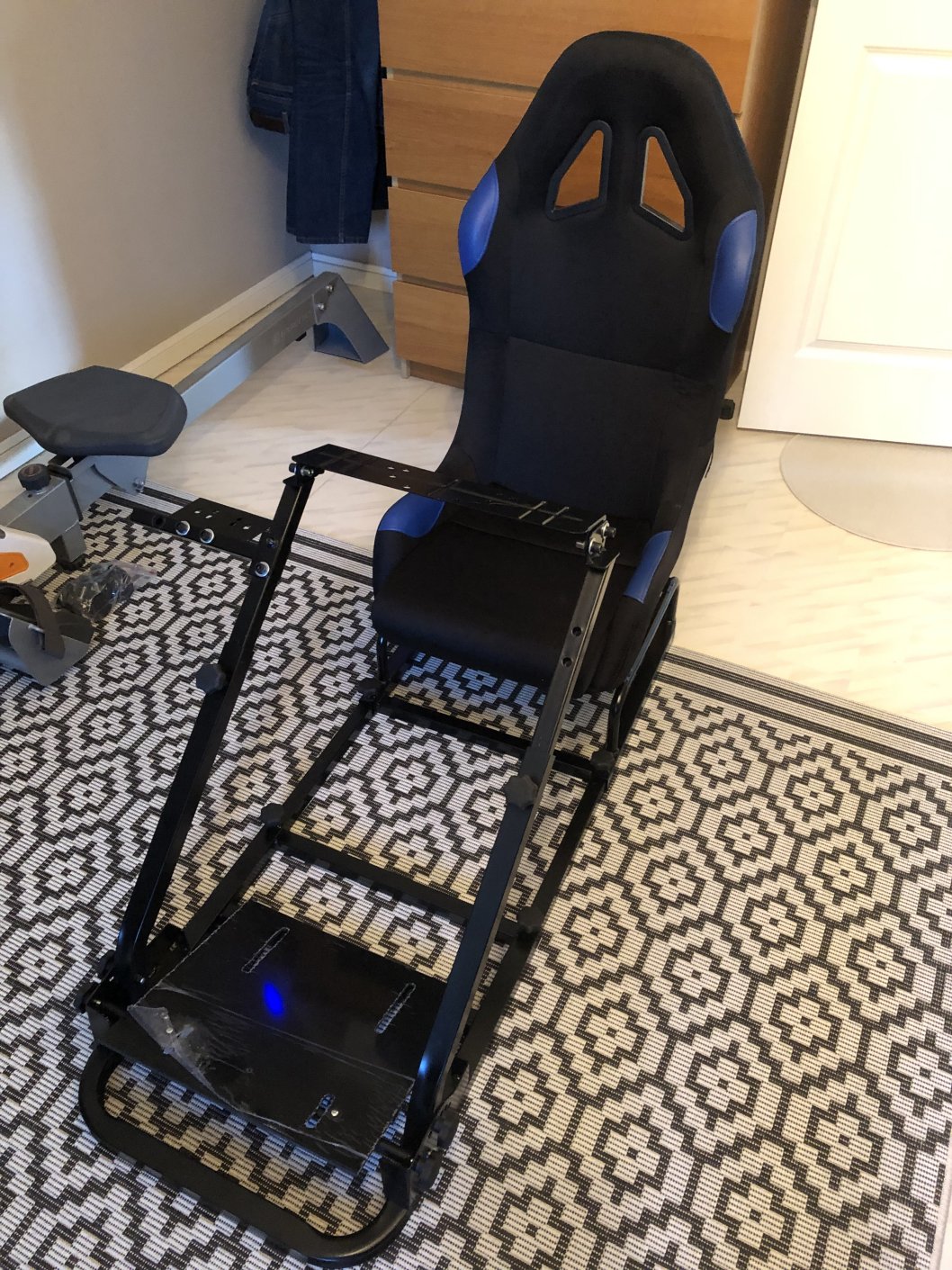

    1. The FK Racing seat and fixed rig arrived
    2. Unboxing
    3. This is how it looked like before the modification started

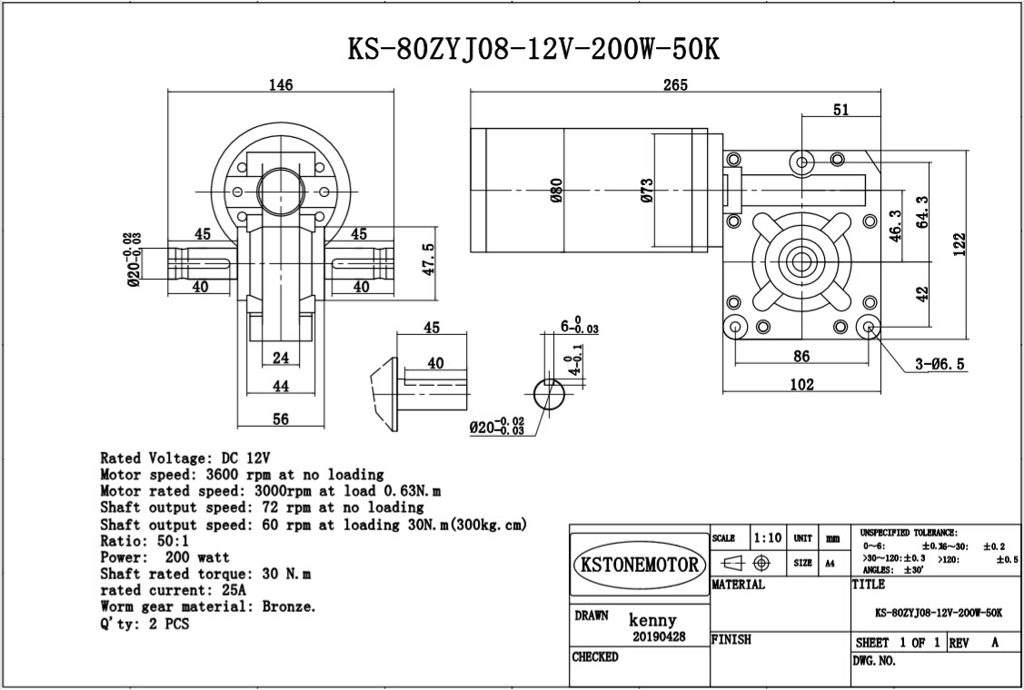

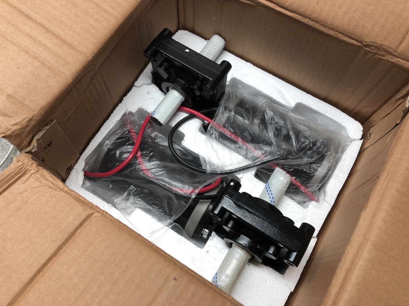

    4. Worm gear motors (200W, 12VDC, 50:1) and couplers arrived from China.
    5. Motor specification and dimensions. Motor type KS-80ZYJ08-12V-200W-50K

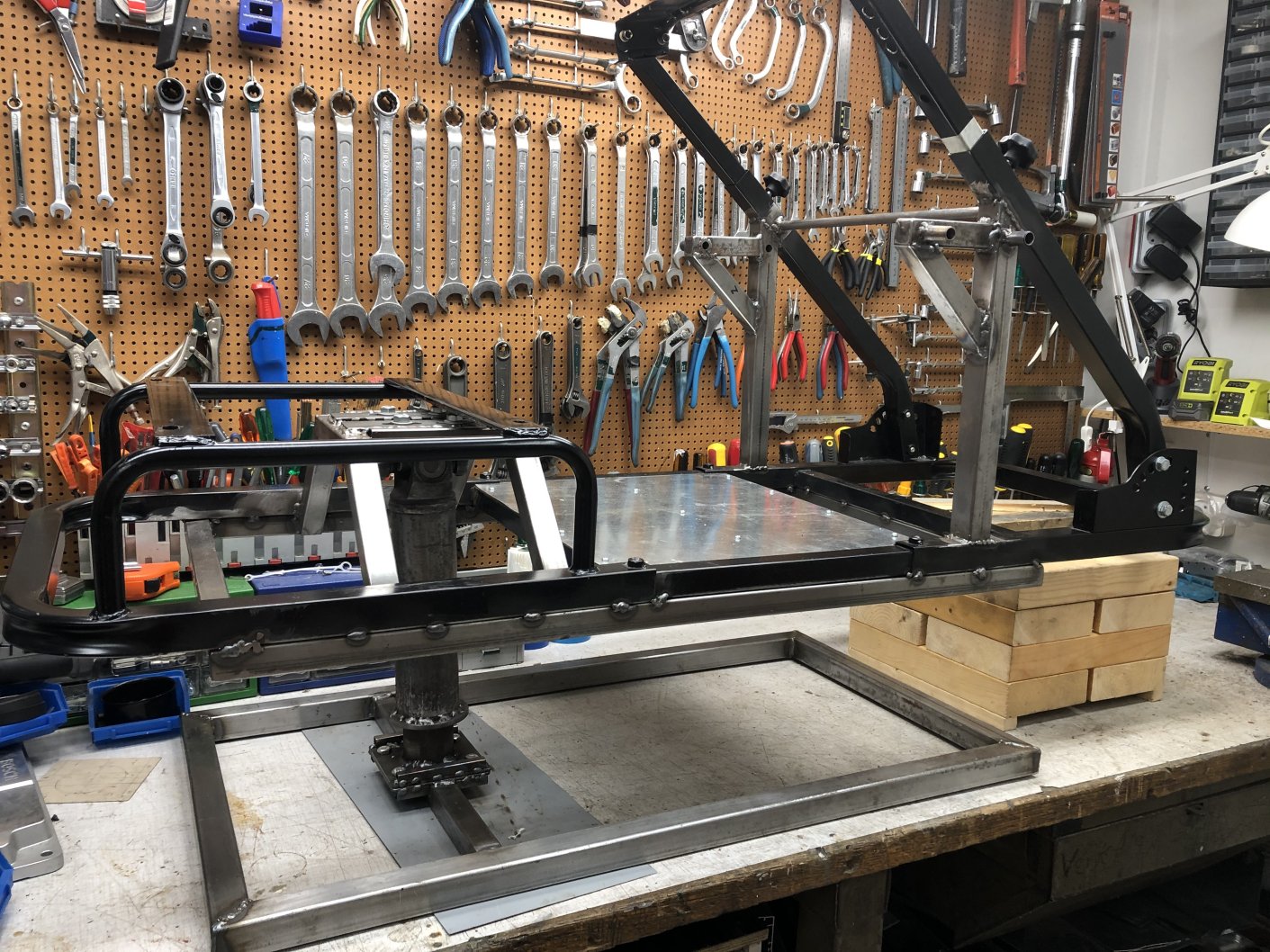

    6. Before modification. The frame is a very good starting point and will save me a lot of work :)

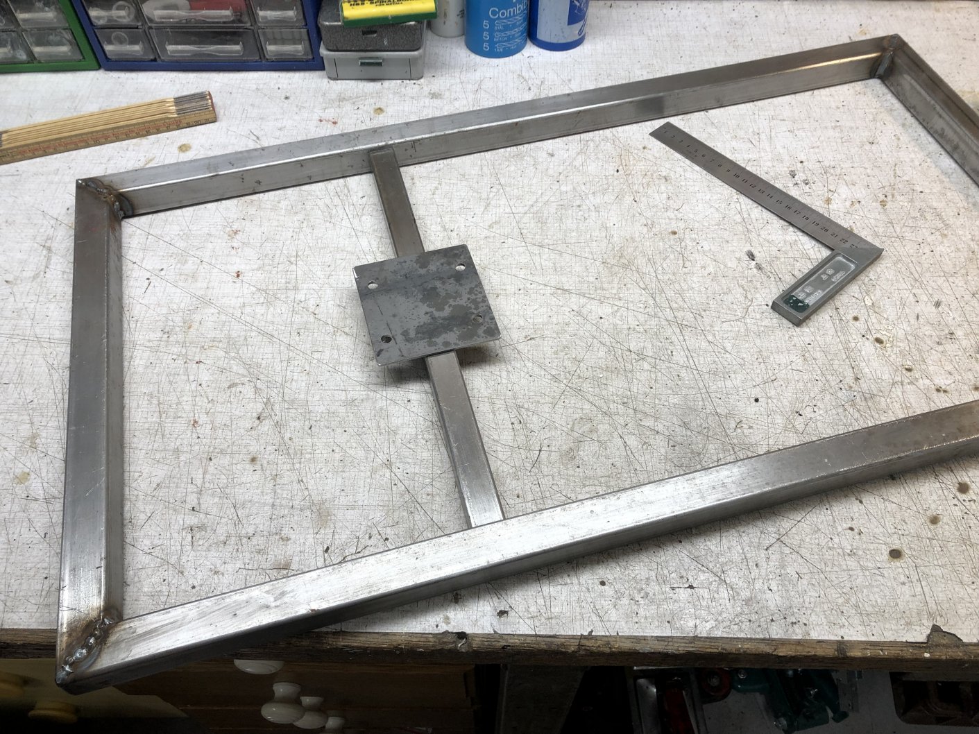

    7. The original frame is not stable enough and needed some reinforcements, both for it’s stability and to get mounting points for the rods. An additional frame under the moving part of the rig is made of 25x25x2mm, and the frame in front on the picture is the one to be on the floor, made of 30x30x2mm tubes.
    Reinforcements and fixing points for the rods are also made in 30x30x2mm.
    8. The frame for the u-joint is made of 25x25x2 mm but is not welded in the correct place yet because the balance point is not measured (only placed there for the picture). Note the possibility to fine tune balance point and possition of the u-joint if needed after the rig is finalized.

    1. Motors KS-80ZYJ08-12V-200W-50K. 12V, 200W, 3000rpm (no load speed 3600rpm), 50:1 gear

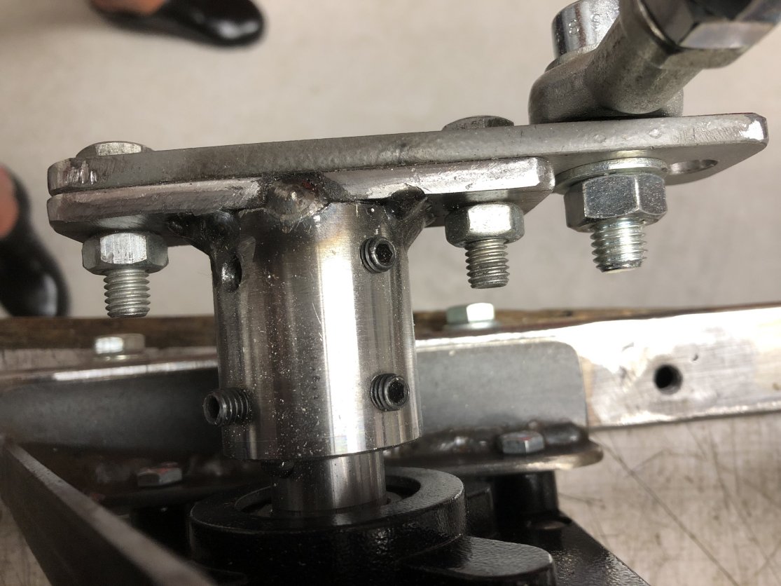

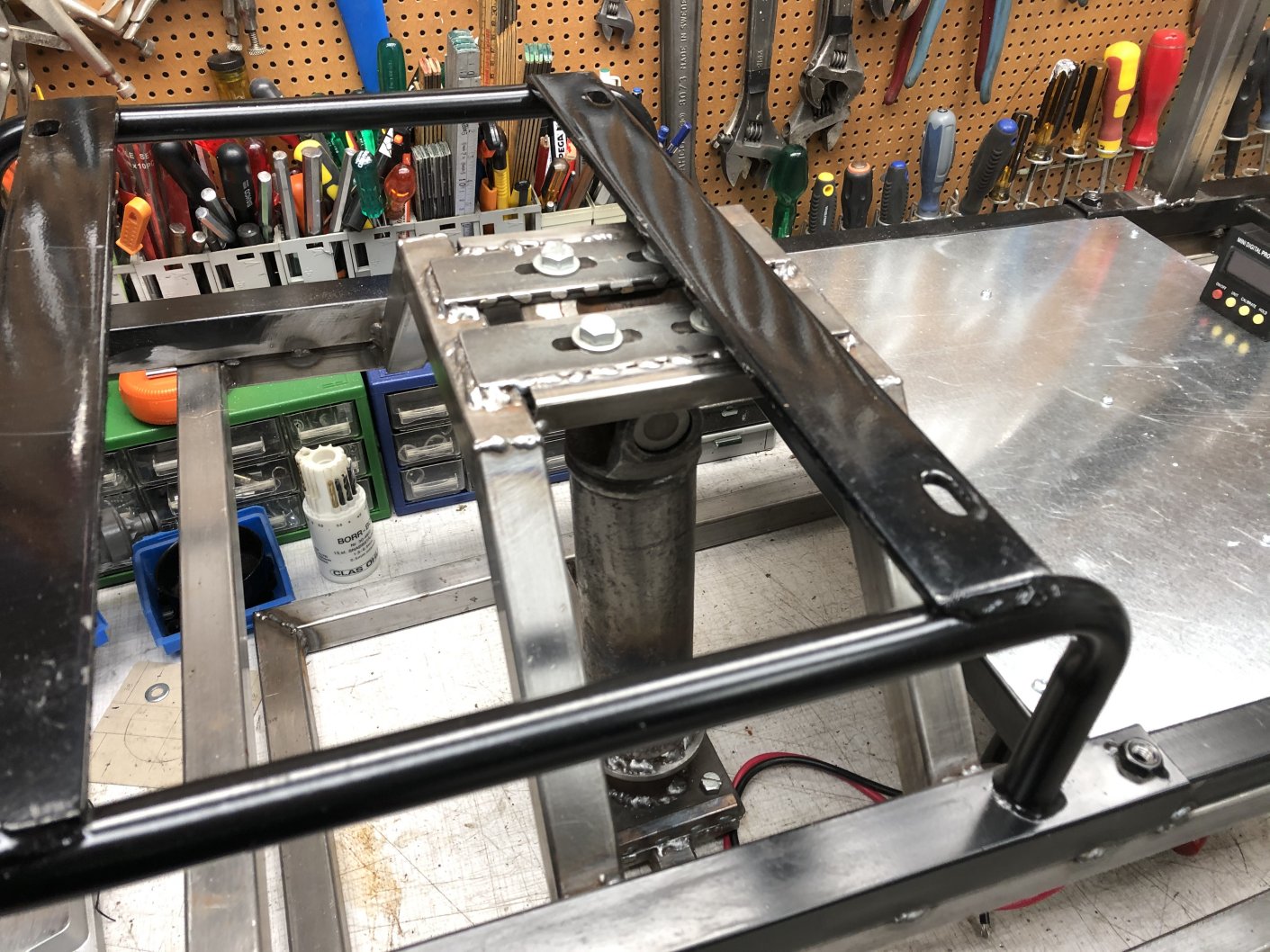

    My project is slowly moving forward and it’s time to add some updates on what I have done since last time I updated this thread.
    9. The moving part of the rig is ready. Made two front brakets to be able to change the distance between the brakets and balance point.
    10. Construction of the lower fixing point for the u-joint on the frame.
    11. The u-joint and column in place.
    12. The upper u-joint fixing point is adjustable to fine tune the balance point if needed.
    13. Approx location of the motor with enough space between motor and frame for the movement. The motor mounts will get two possitions to be aligned with the two upper brackets for the push rods.
    The construction is still ongoing ... adjustable motor mounts and push rods are next to be done.…more info and pictures to come later…

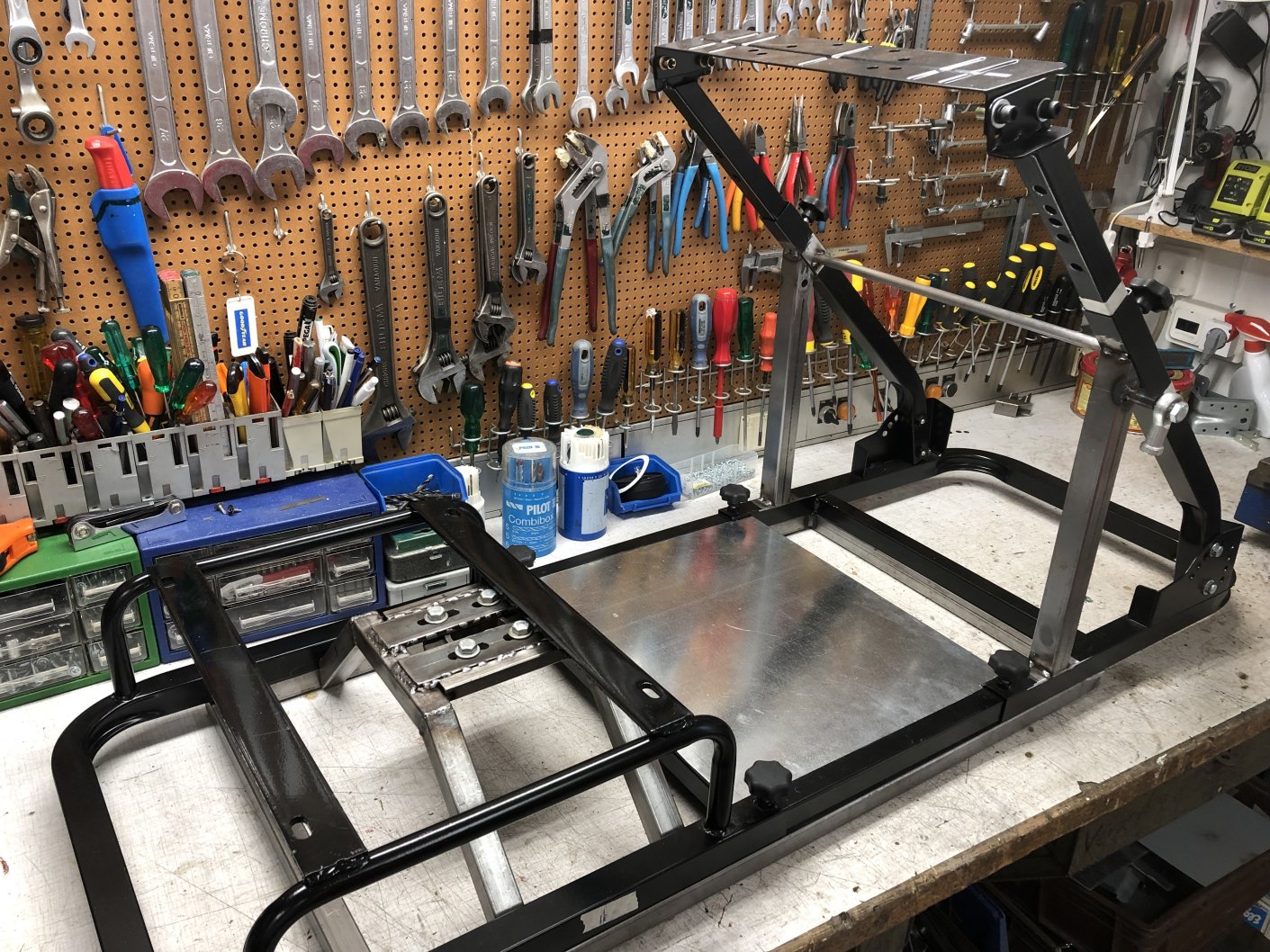

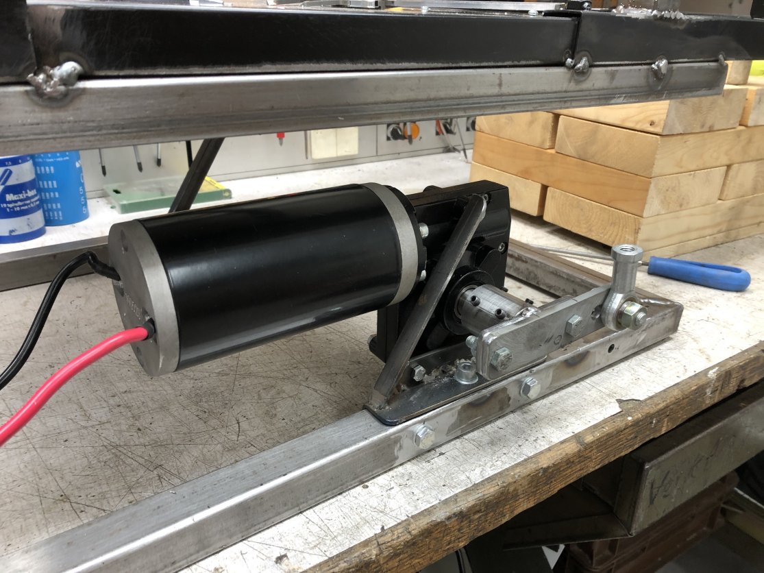

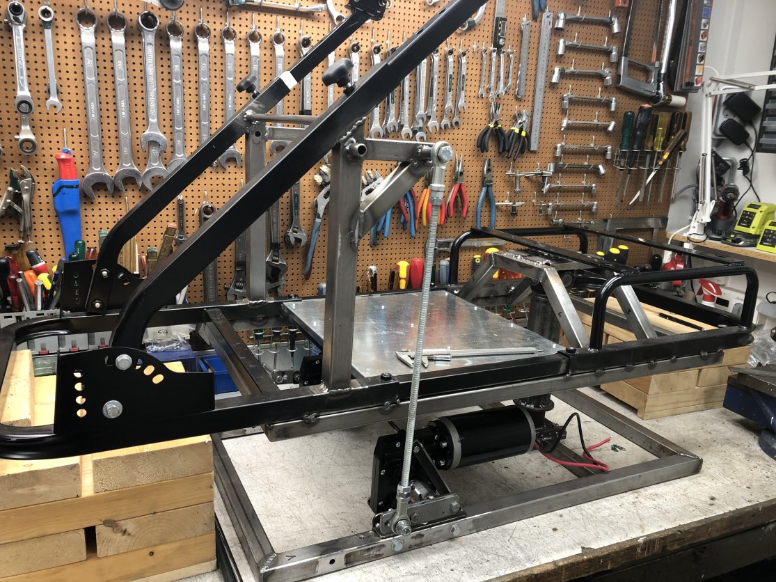

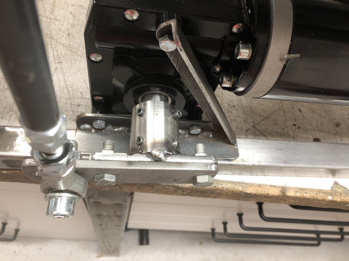

    It's time to make an update of the progress of my project.

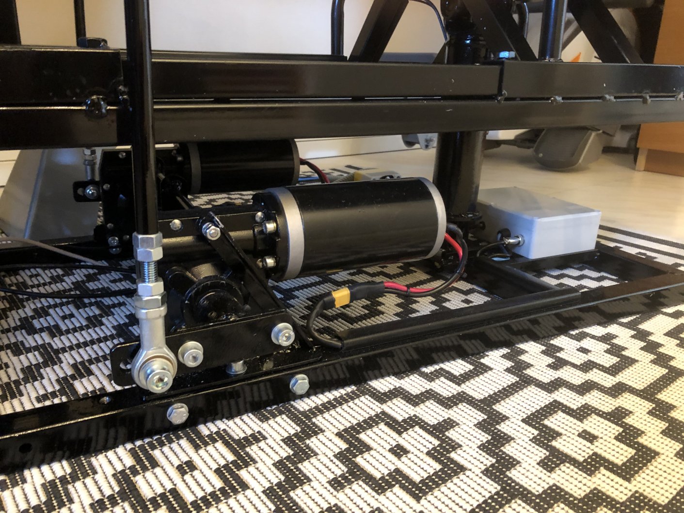

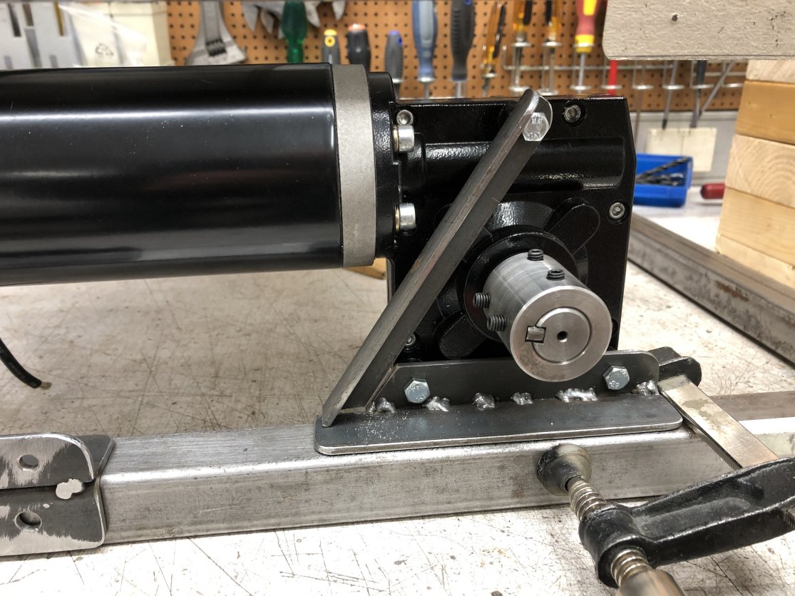

    14. Construction of motor brackets. Used 15x15x3mm and 30x30x3mm to get it stable.
    15. A 30x5mm is welded to the motor shaft couple on which the motor lever is bolted for easy exchange to a lever with different CTC distance if needed.
    [​IMG] [​IMG]
    16. The motor has two fixed locations for the bracket on the frame and can be moved to change the pitch movement if needed.
    17. Left side is done. Note the two fixing points for the motor bracket and the rod to be able to change the pitch movement. Hope the possibility to change the pitch and CTC on the motor lever will make it flexible enough to fine tune the movement.
    18. The mechanical construction is now almost done :)
    Final step is to add fixings for the Hall potentiometers, a stabilization bar between the motors, cable ducts and the box for the electrical connections before disassembly and painting

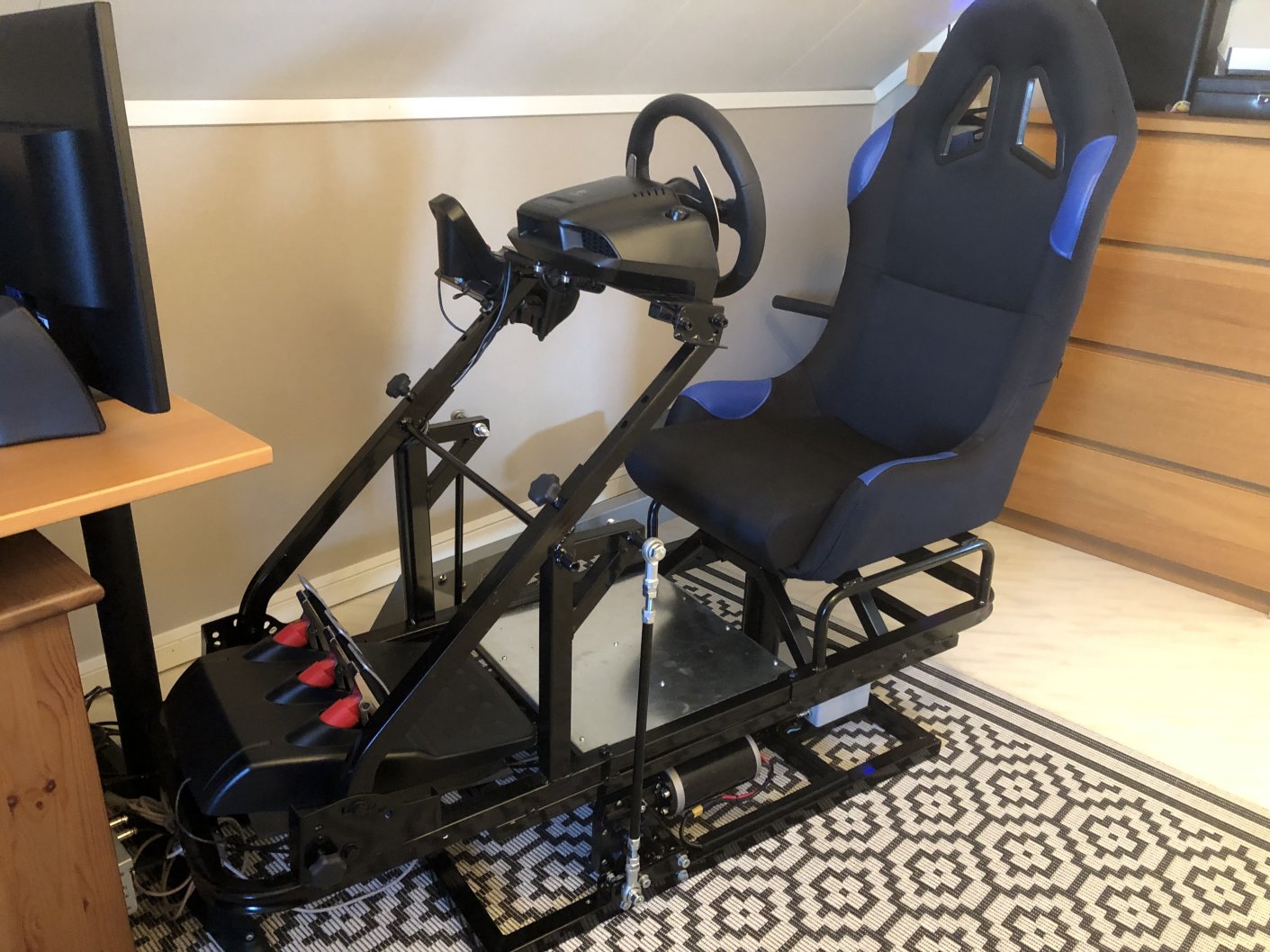

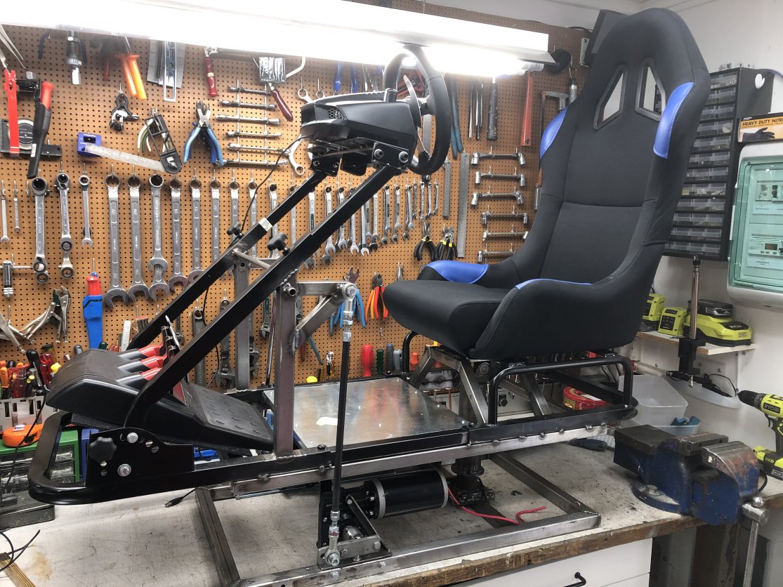

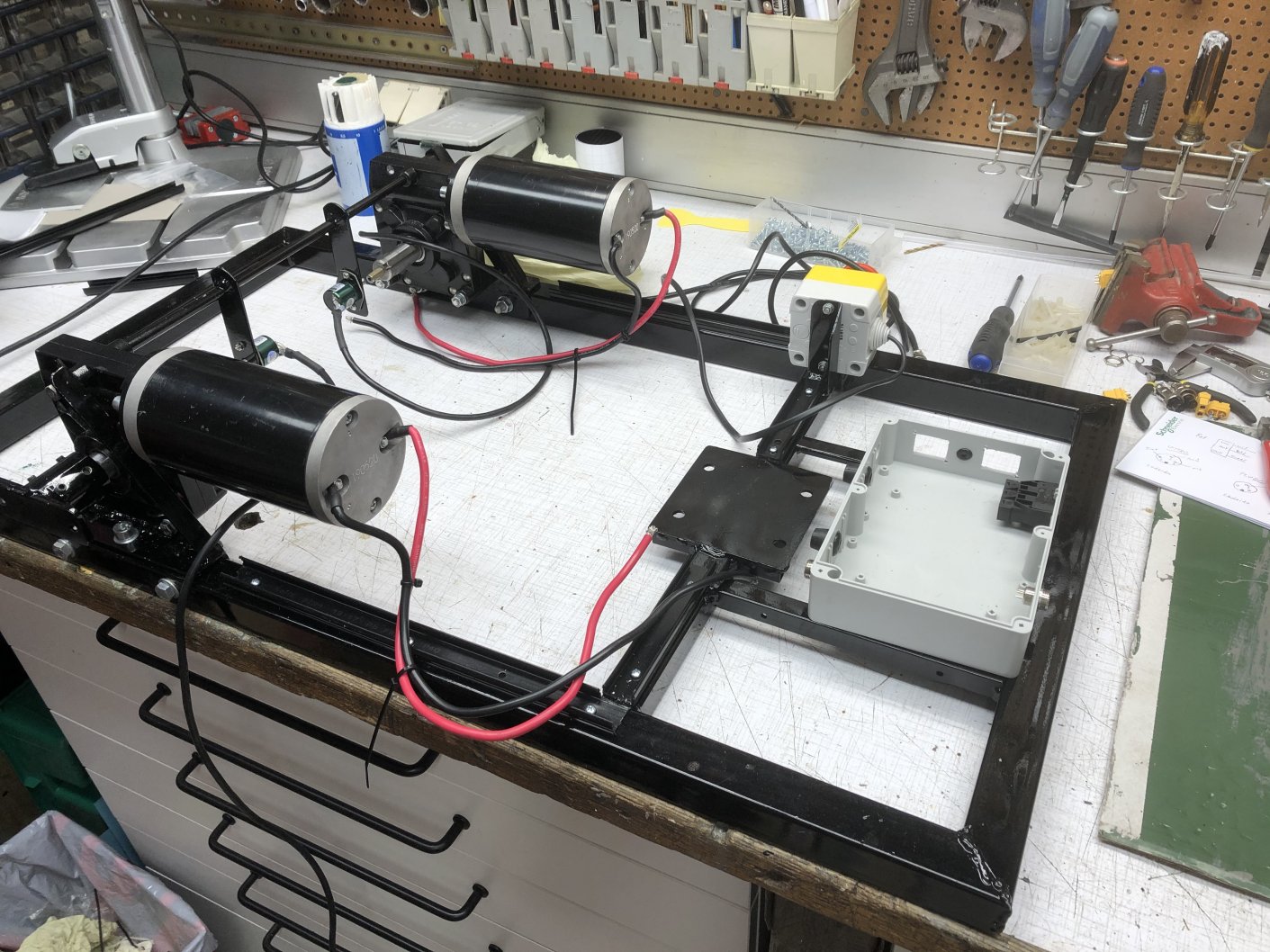

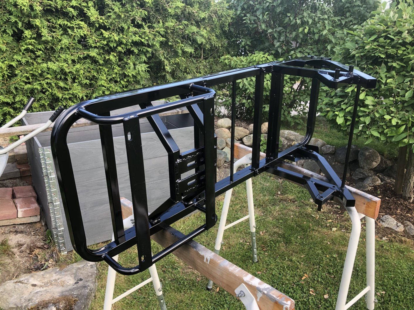

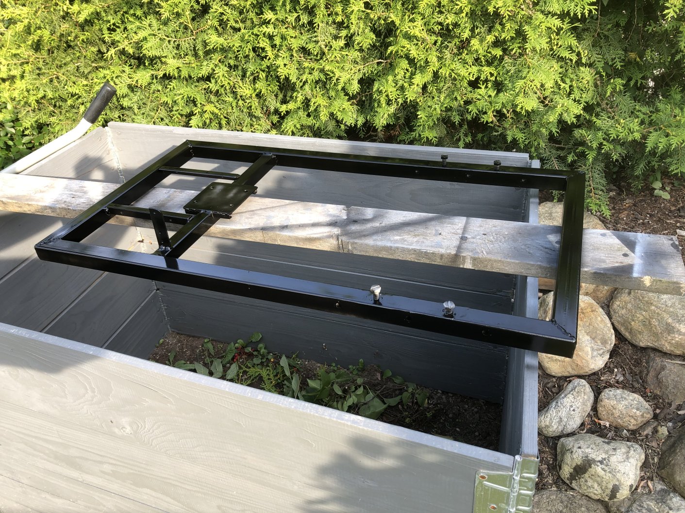

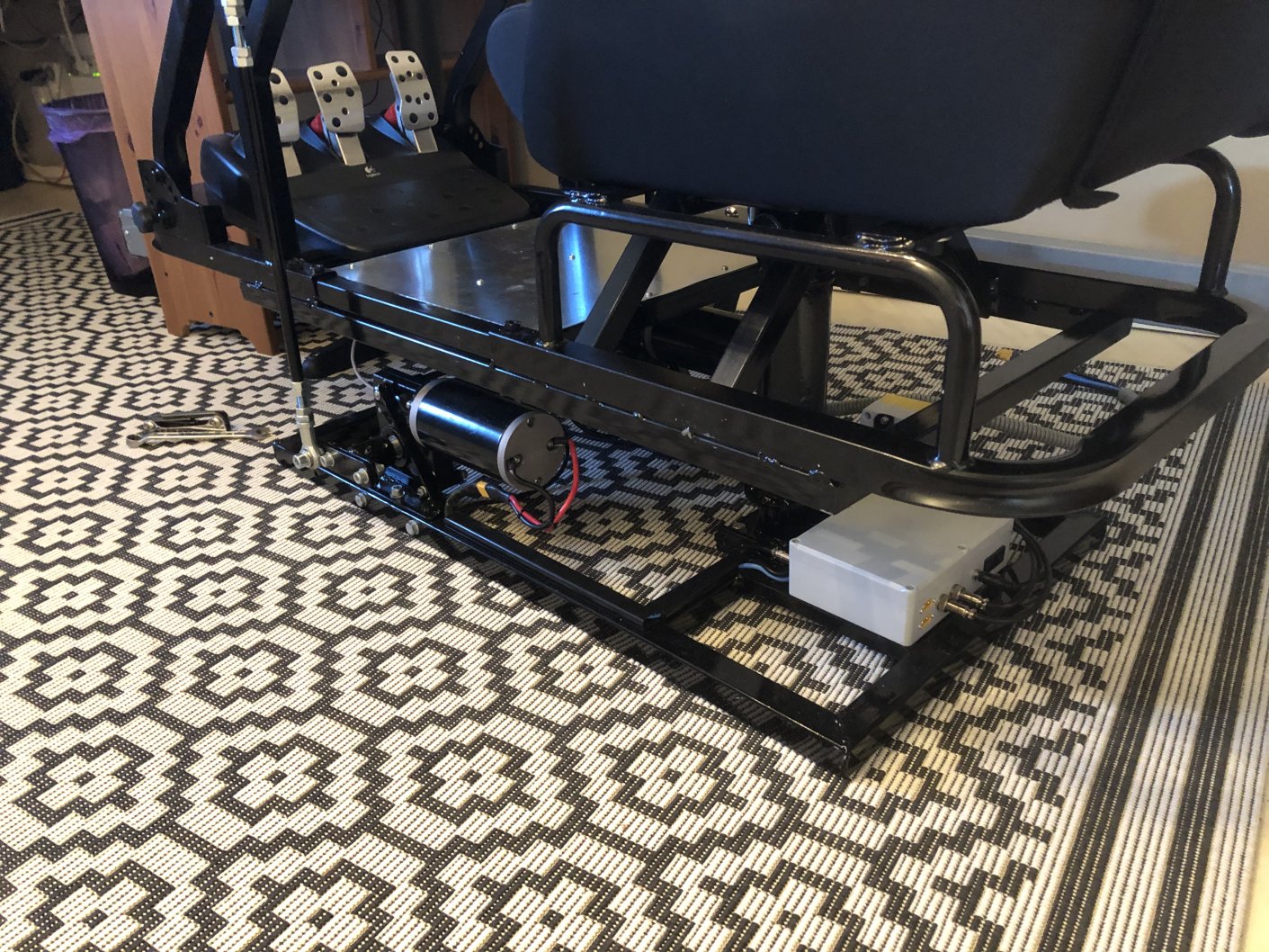

    My project is moving forward, the rig is now disassembled and painted. Just started the final assembling by adding an electrical connection box to be able to disconnect and remove components easily without soldering of cables.
    19. Painting done.
    [​IMG] [​IMG]

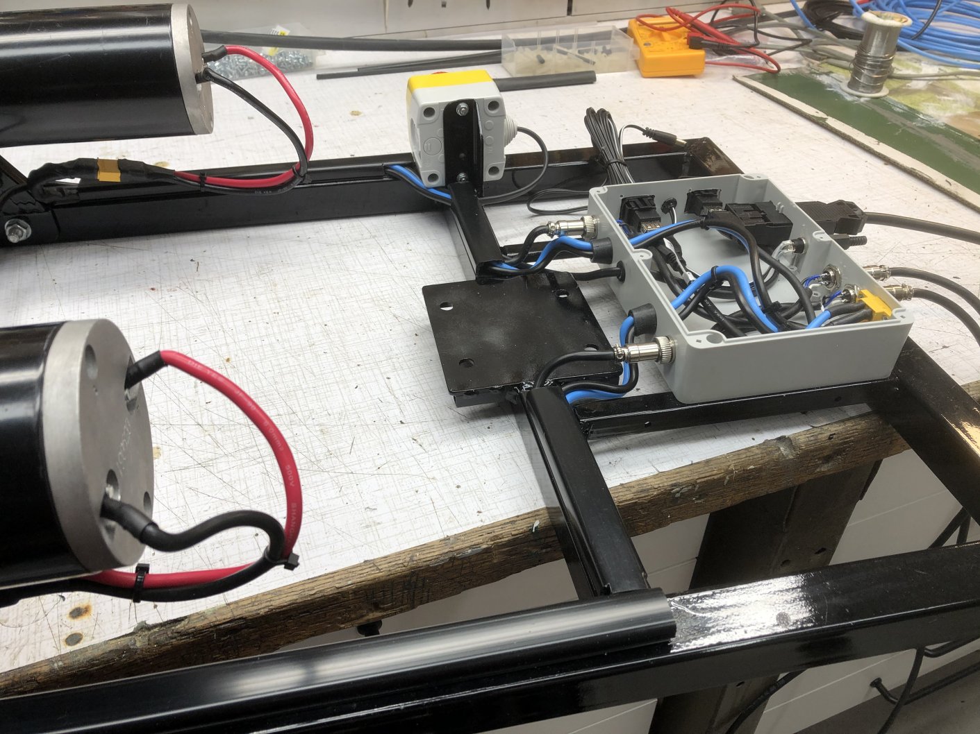

    20. The motors and the new electrical connection box are in place.
    [​IMG] [​IMG]
    [​IMG] [​IMG]
    Next is to mount the moving parts of the rig and the Logitech racing wheel. Then the fun, but probably time consuming, part will start to learn how to set up the software and to get it work :)

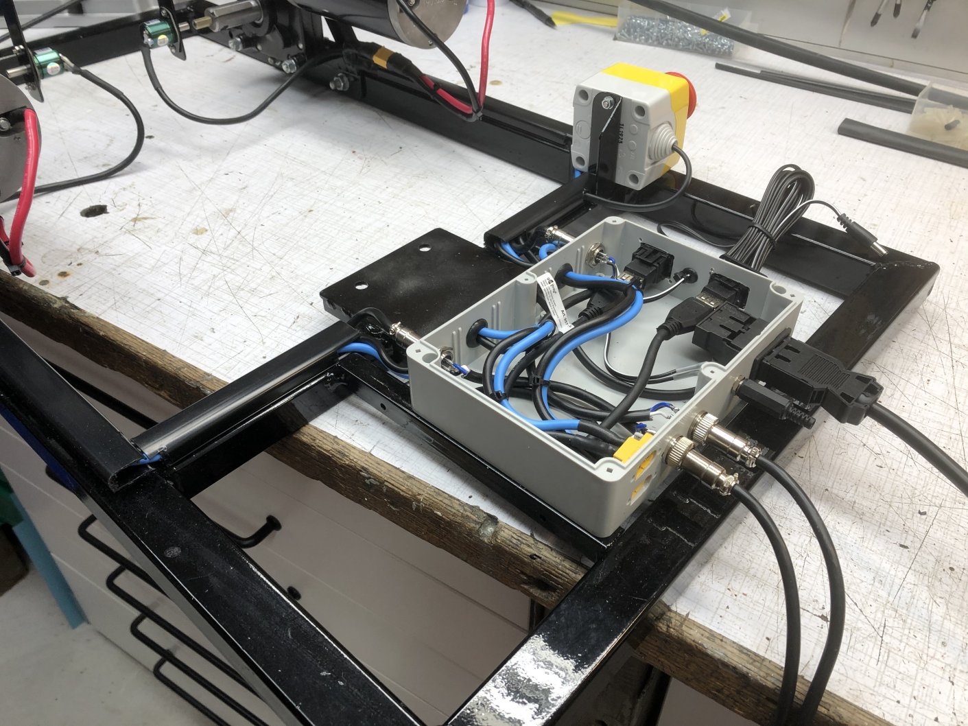

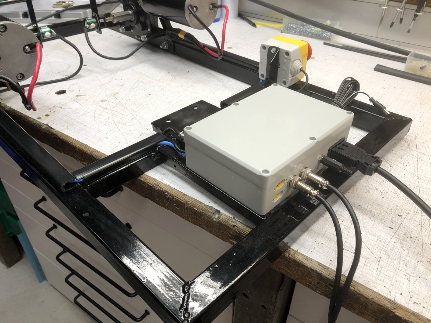

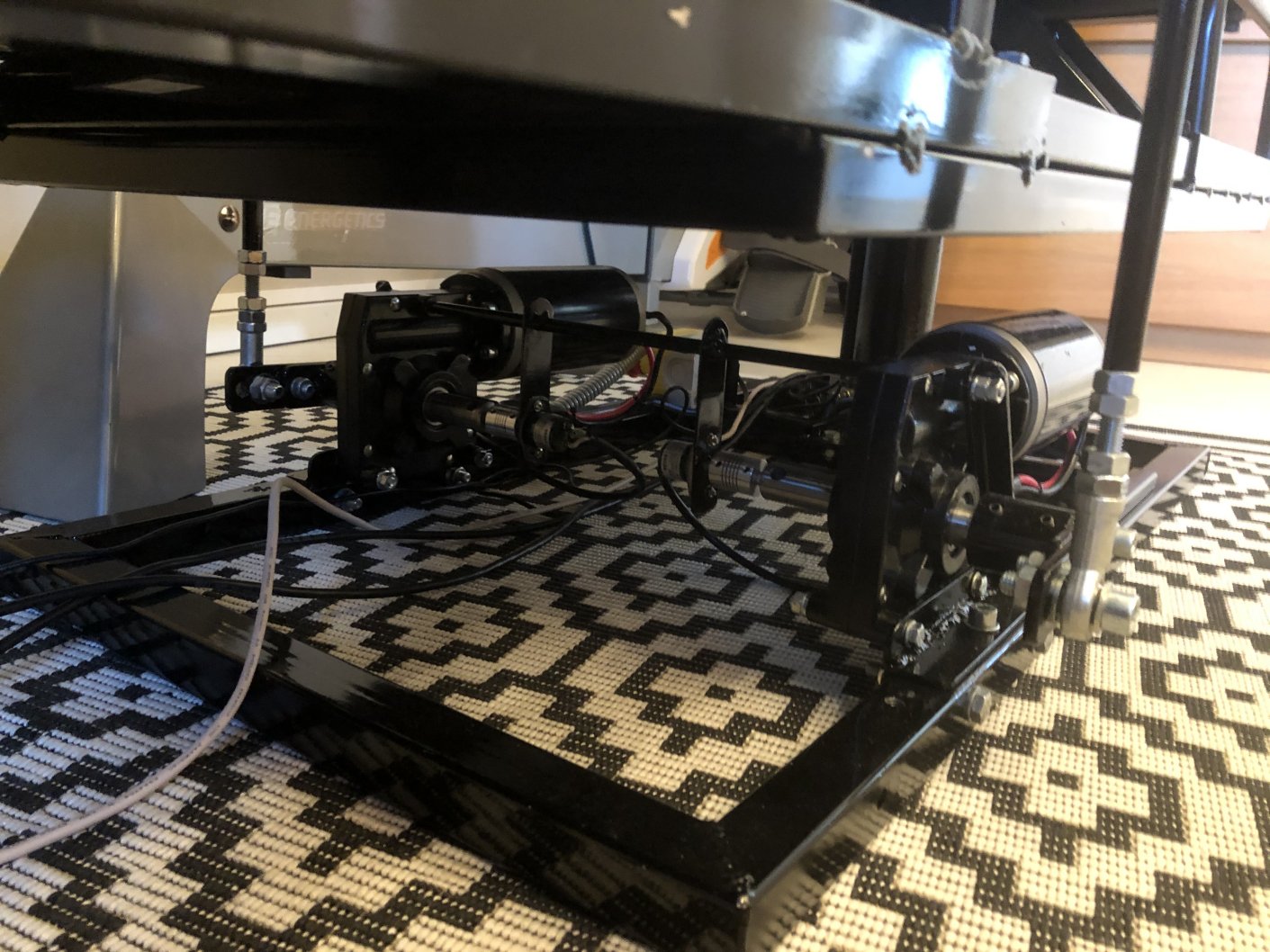

    My project is slowly moving forwared and the rig is now ready for configuration by the JRK Configuration tool and SimTools.

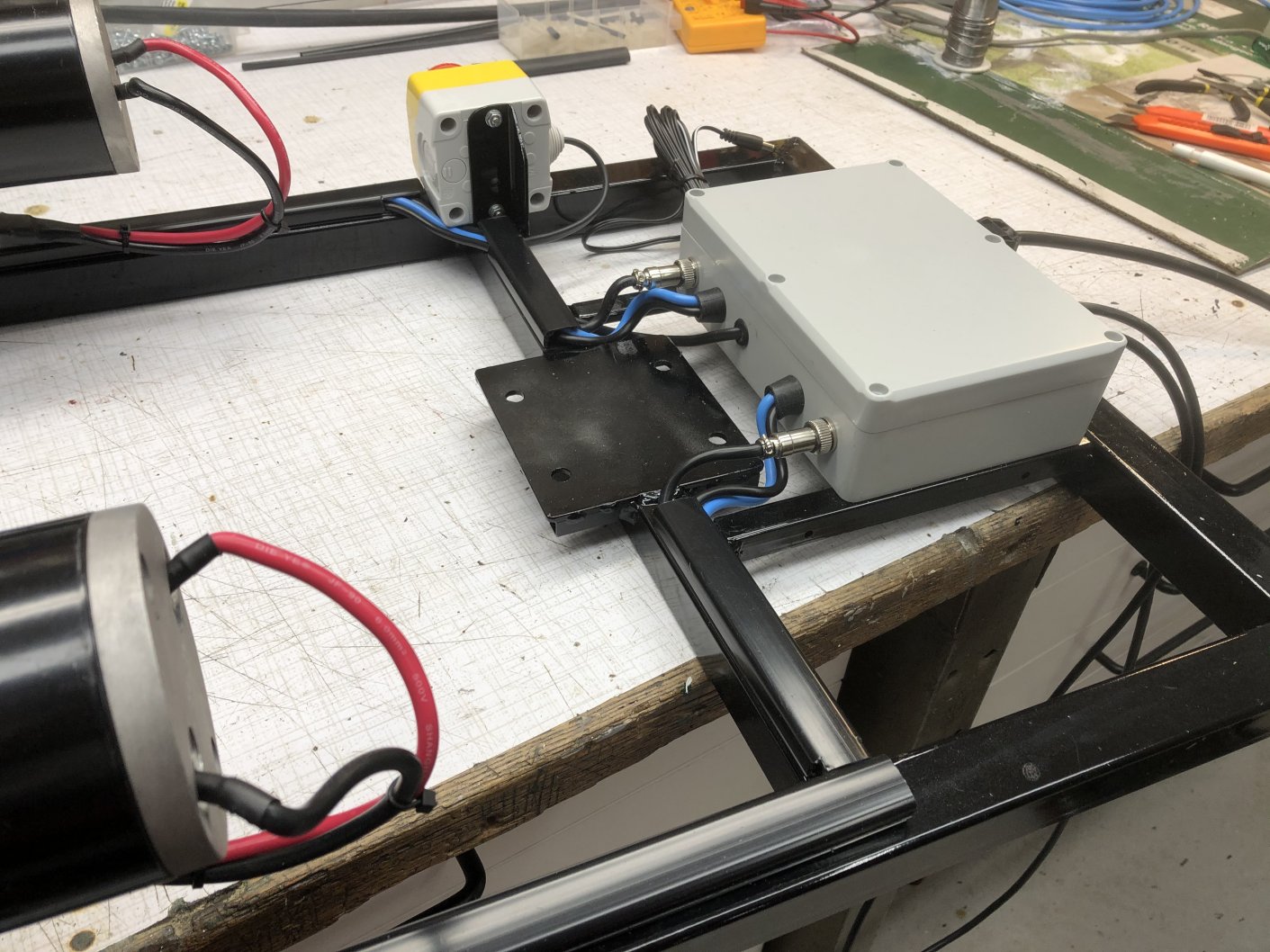

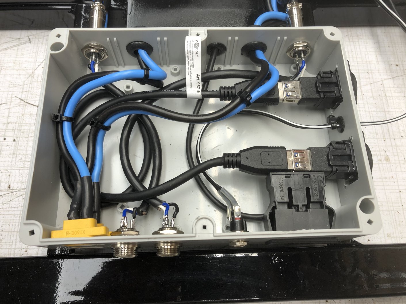

    21. The electrical box on the rig is done.
    [​IMG] [​IMG]
    22. The rig is now finally assembled and ready for setup of the JRK’s and SimTools.
    [​IMG] [​IMG]
    [​IMG] [​IMG]
    Started to run the JRK Configuration tool to set basic motor parameters and feedback from the Hall potentiometers. Setup of the first JRK/motor combination went fine but I got serious trouble on the second JRK/motor and got ”Motor driver error” after 15 minutes of tests without load. :-( Same error if I have the motor connected or not. Looks to be a bad JRK board and Pololu is looking at the issue right now.
    (URL to my thread about the broken board https://www.xsimulator.net/community/threads/jrk-g2-motor-driver-error.15510 )
    Hope to get it solved quickly so I’m able to finalize the setup and do my first race on the rig.
