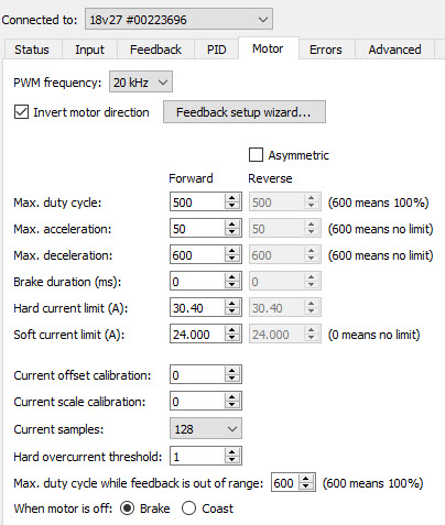

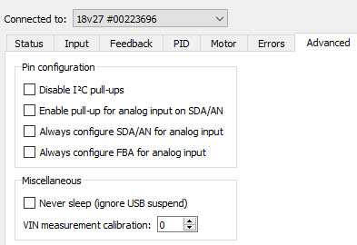

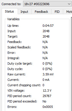

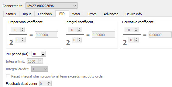

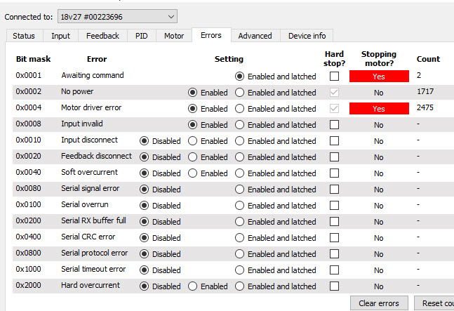

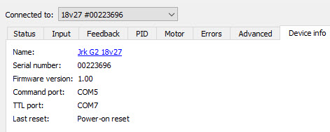

    Attached pictures are the settings I used when the JRK stopped working, except the ”Status” tab which shows the values today when I took the pictures. Feedback was not activated.
    Have been in contact with Brandon at Pololu but haven’t got any explanation how to move forward to check if the card is broken or if the error can be reset, but he told me the JRK G2 18V27 is to small and can’t be used by my 12V 200W motor. ☹
    I’m surprised because the JRK series is used by several rigs in the forum.
    My main concern is if the motor is to big for the JRK, in that case I need to find another solution to move forward, and as I wrote in my first post, I have no experience about Ardunio and programming. If the motor size is OK, I just need to buy a new JRK but I will not take the risk to burn a second JRK.

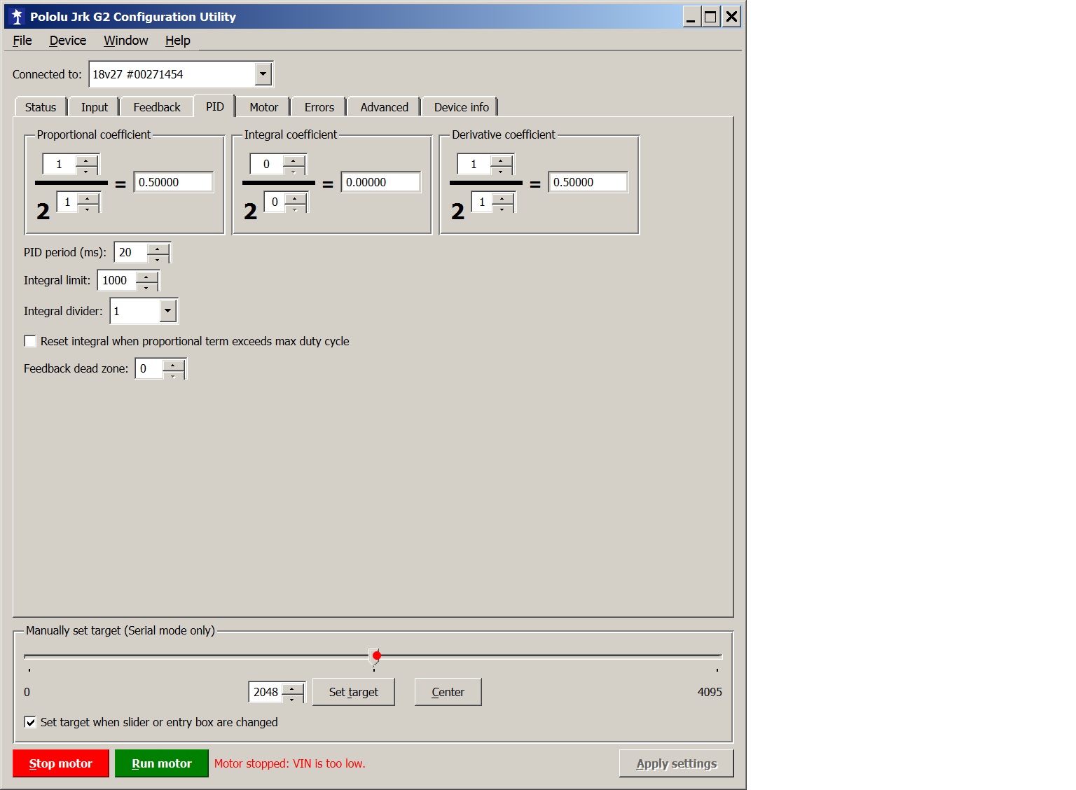

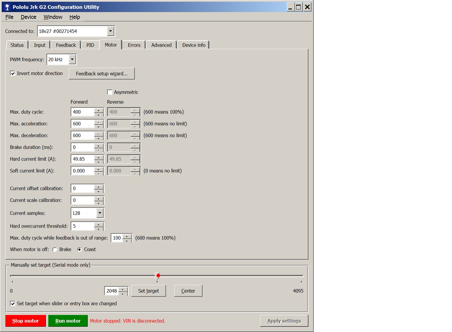

    It is a long time since I setup my JRK G2
    But from memory I also had this error,
    Looking at PID.jpg it appears to be wrong...
    I suggest changing PID as attached.
    These where initial values for me, which I tuned / increased slightly later.

    I also attach my motor settings used initially to get it to work.
    I used Corsair power supply, because if the motor drew too much current, the PSU will off.
    Mian to Corsair PSU can be reset and you can test again.
    This way I was able to test, gradually increasing max duty cycle and max acceleration to the values here.

    Unfortunately still the same "motor driver error" when using your settings. The error text is flashing when I try to run the motor from the Configuration tool, with or without the motor connected (or with a small 1W motor). And if I change "When motor is off" setting from "Coast" to "Break" the error text is constant.
    The second JRK/motor combination in the rig works fine and without any problem so far so it looks like a broken JRK card for this JRK/motor combination. :-(
