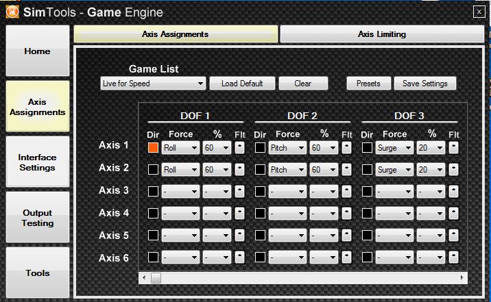

    Now that you have your own thread you can add questions to it as they arise, like this one that you had earlier about Axis Assignments: https://www.xsimulator.net/communit...ator-with-rear-wipers.4897/page-3#post-111046
    Creating a good motion profile takes time, but is worth the effort. Here are the steps: https://www.xsimulator.net/community/faq/steps-to-create-a-motion-profile.228/
    Leave roll and pitch to last and try and keep the to Axis Assignement total to 100%, or just a little over: https://www.xsimulator.net/community/faq/axis-assignment-percentage-totals.120/

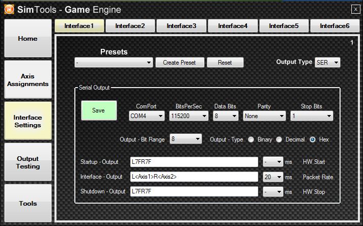

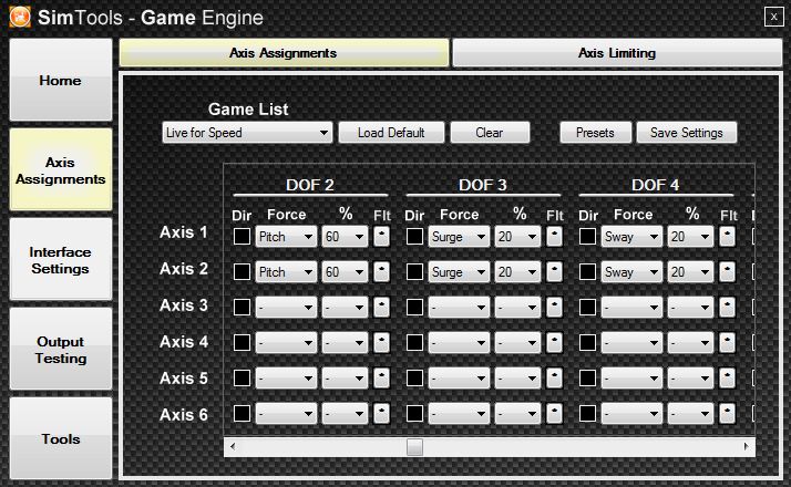

    i having issue with motion when i try to test manual motion when press dof output on platform roll but no motion with slide button same issue with game when i start game platform roll one side and no motion plz help me ASAP
    21,909
    153,065Coins
    +11,117 / 56 / -2
    For SimTools 2 your Interface Settings should be like this: L<Axis1a>R<Axis2a>

    thanks @noorbeast bro now i have issue with live for speed game no motion with this game any solution
