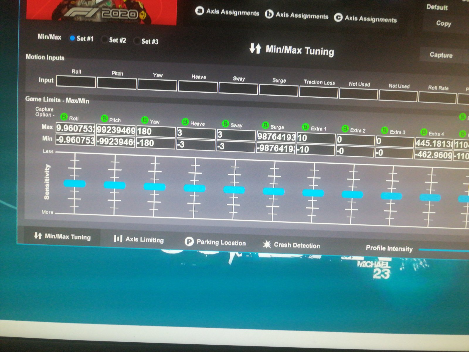

    22,225
    154,819Coins
    +11,226 / 57 / -2
    This is the Tuning Center, temporarily set all Max/Min vales to 50 and let us know if the shaking stops:
  7. FLORIN ROMANIA
    FLORIN ROMANIA Member
    Dec 30, 2022
    150
    România
    822Coins
    +13 / 0 / -0
  8. FLORIN ROMANIA
    Dec 30, 2022
    150
    România
    822Coins
    +13 / 0 / -0
  9. FLORIN ROMANIA
    Dec 30, 2022
    150
    România
    822Coins
    +13 / 0 / -0
    No change, do the same

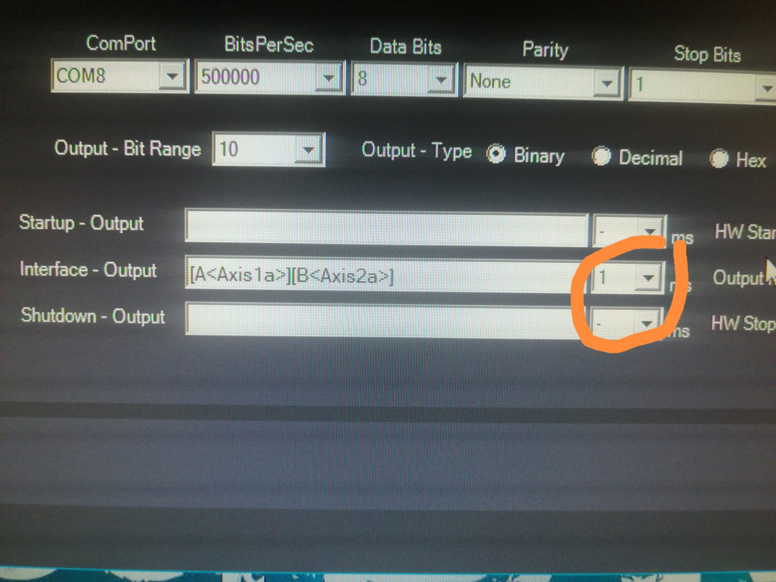

  10. FLORIN ROMANIA
    Dec 30, 2022
    150
    România
    822Coins
    +13 / 0 / -0
    When I change this value, nothing is changed IMG_20230318_142431_edit_12411065129355.jpg

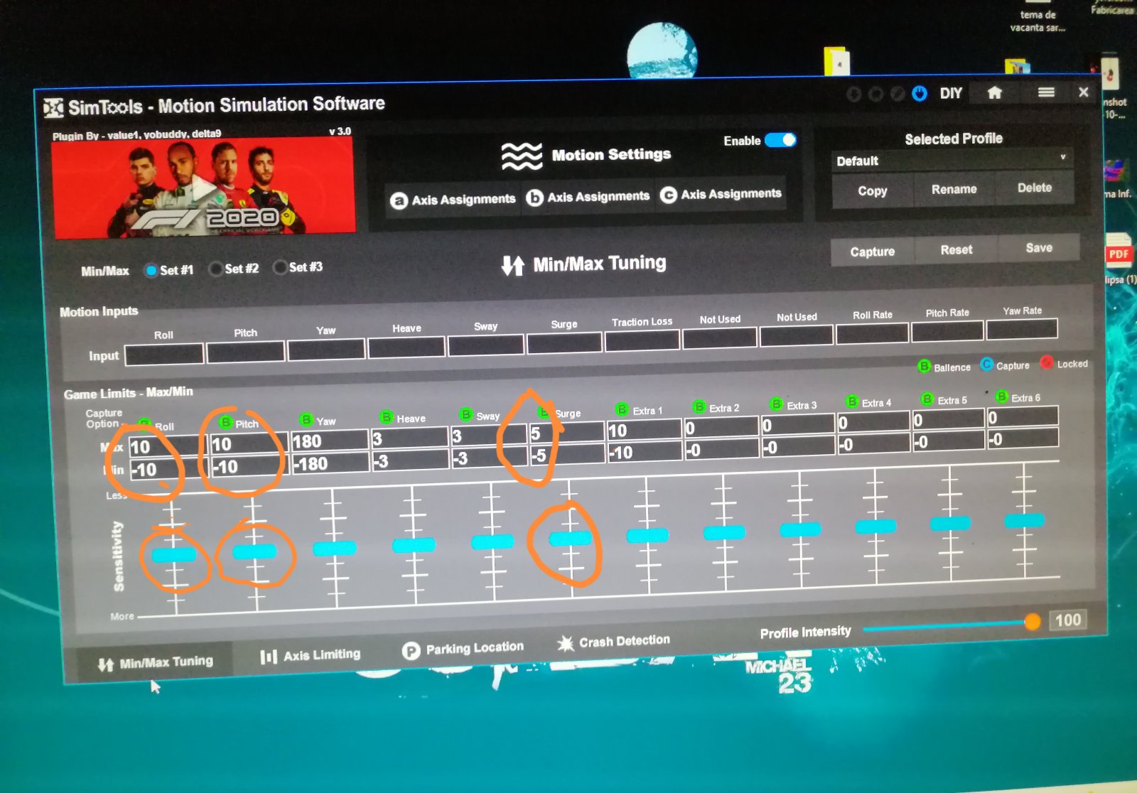

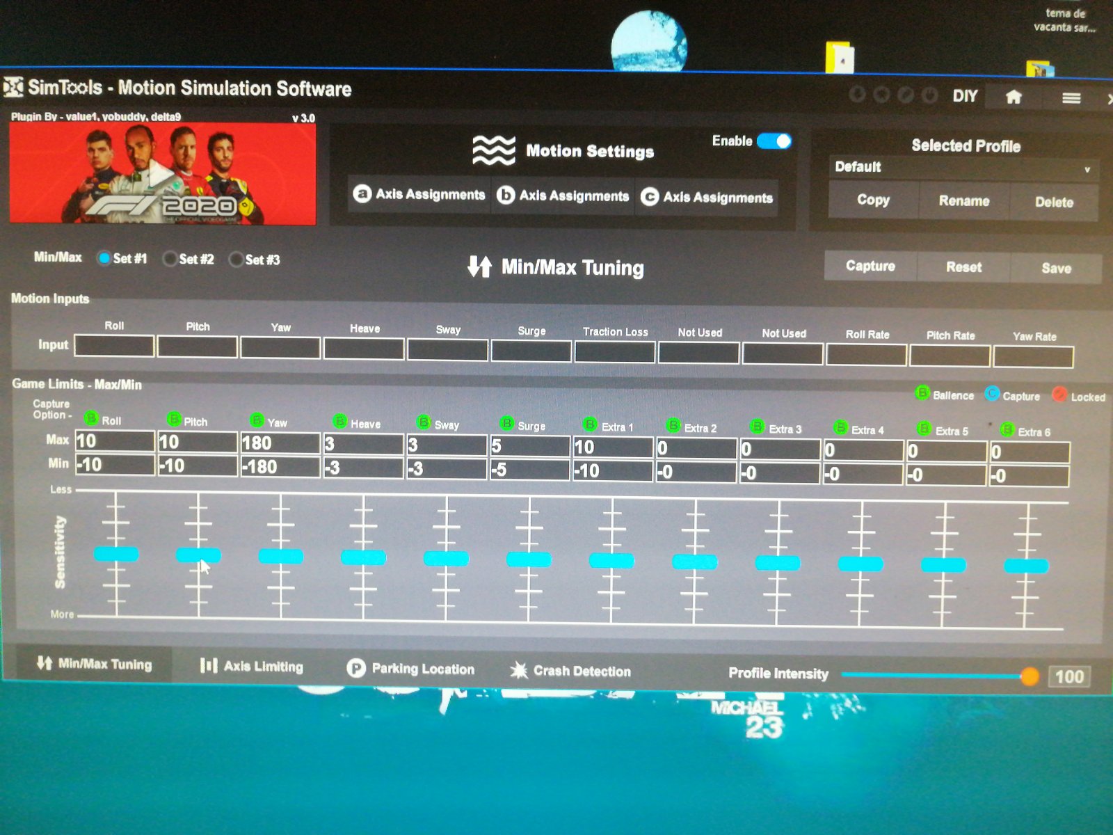

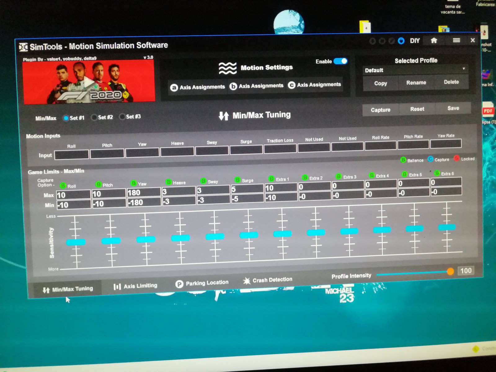

  13. noorbeast
    22,225
    154,819Coins
    +11,226 / 57 / -2
    You should not mess with the Interface settings, they are fine.
    It is unlikely to be the PC, if it runs games it will easily run SimTools.
    I suspect your issue is interference, but my previous questions are intended to rule out other possibilities.
    So, if you manually set all Tuning Center values to 50 does the shaking stop?
  14. FLORIN ROMANIA
    Dec 30, 2022
    150
    România
    822Coins
    +13 / 0 / -0
    If you mean roll, pitch, surge sensitivity, I tried to adjust it to 50, but no change, (in the picture it is not the change) IMG_20230318_120636_edit_13947119052558.jpg
  15. noorbeast
    22,225
    154,819Coins
    +11,226 / 57 / -2
    In that case I suspect it is not a settings issue, but some sort of interference, though from what I have no idea.
