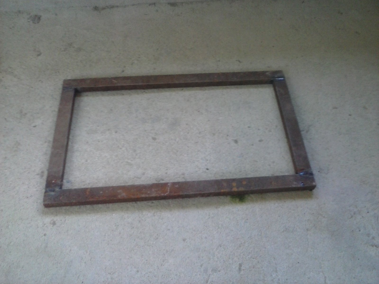

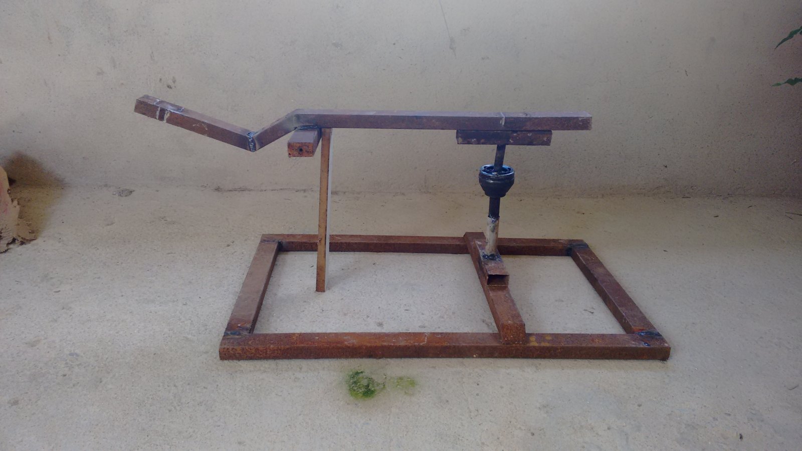

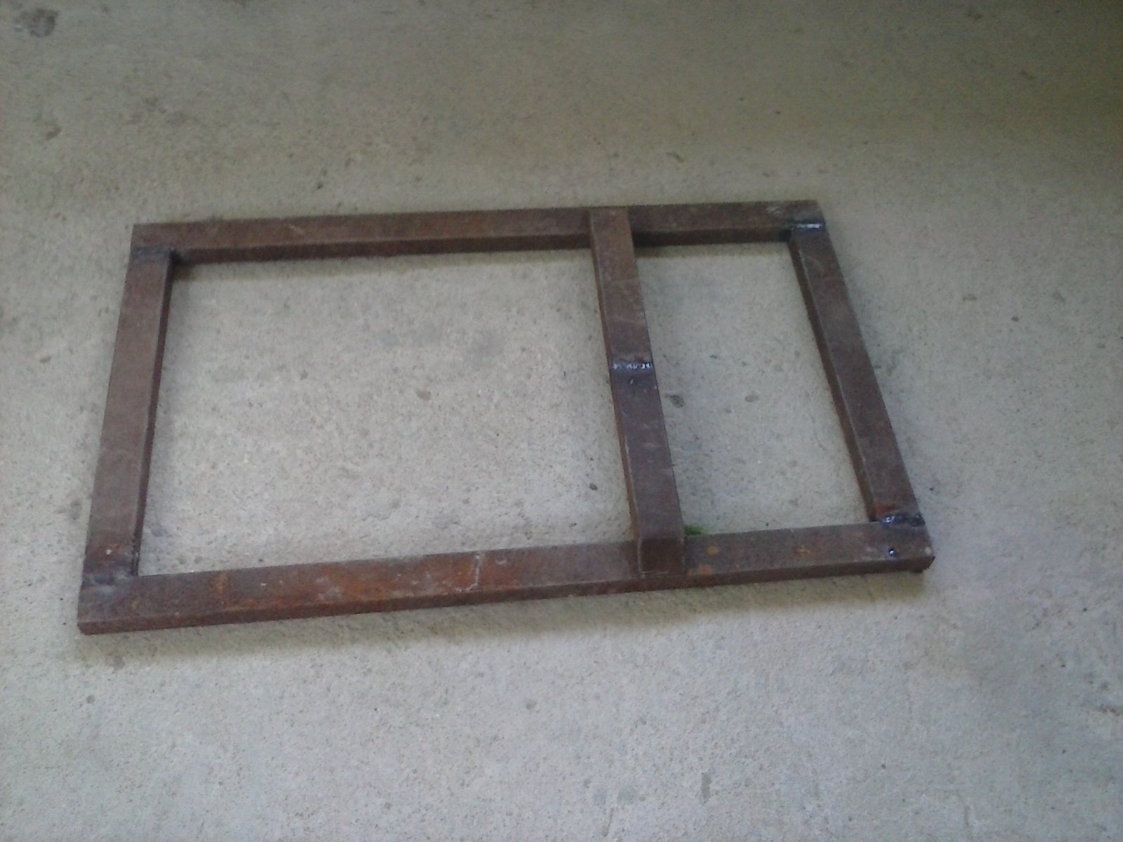

    Hello I'm starting the welding I found some good irons that I had in the garage. is just the beginning of the cockpit, I will also make an iron bench with leather trim, aviation style CAM00205-1.jpg CAM00206.jpg CAM00207.jpg CAM00208.jpg CAM00209.jpg

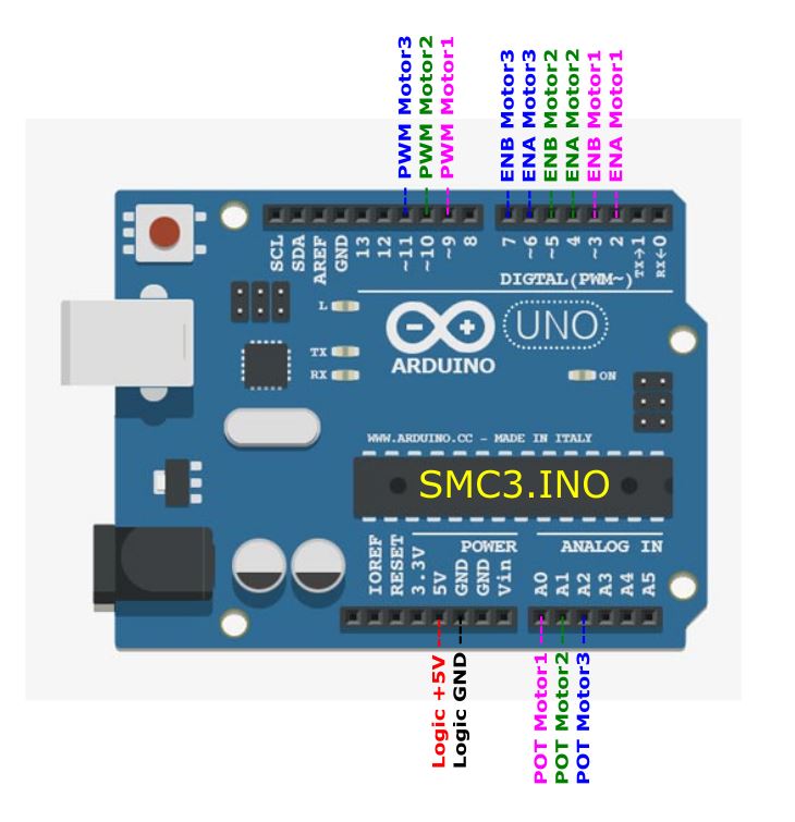

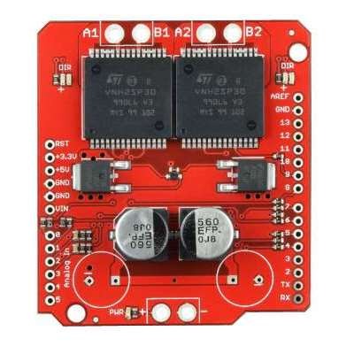

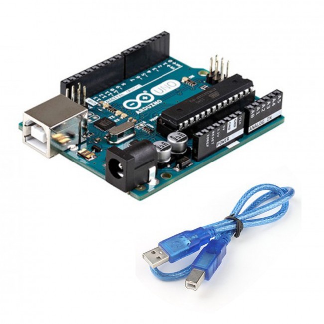

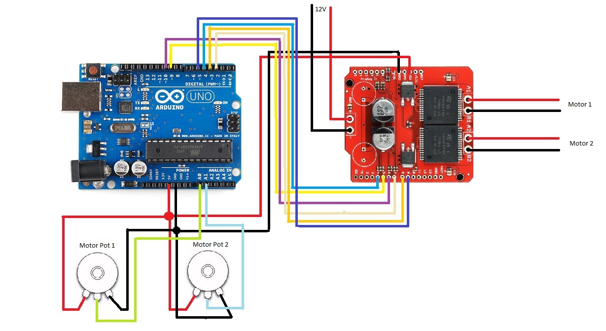

    The arduino code I am using is SMC3 I took from the community forum X SIMULATOR

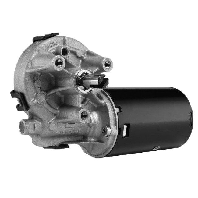

    I'm using
    Aduino Uno R3
    Monster Motor Shield for Arduino VNH2SP30
    2 motors car windshield wiper 12v

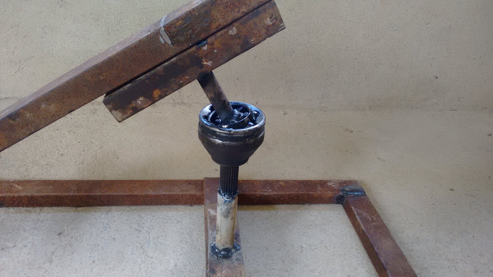

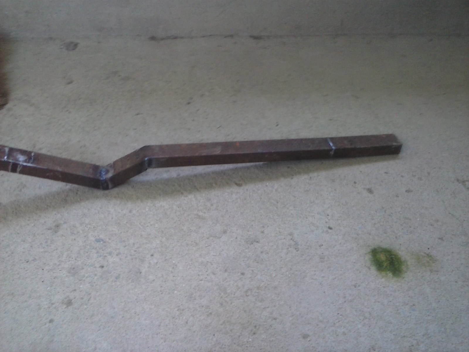

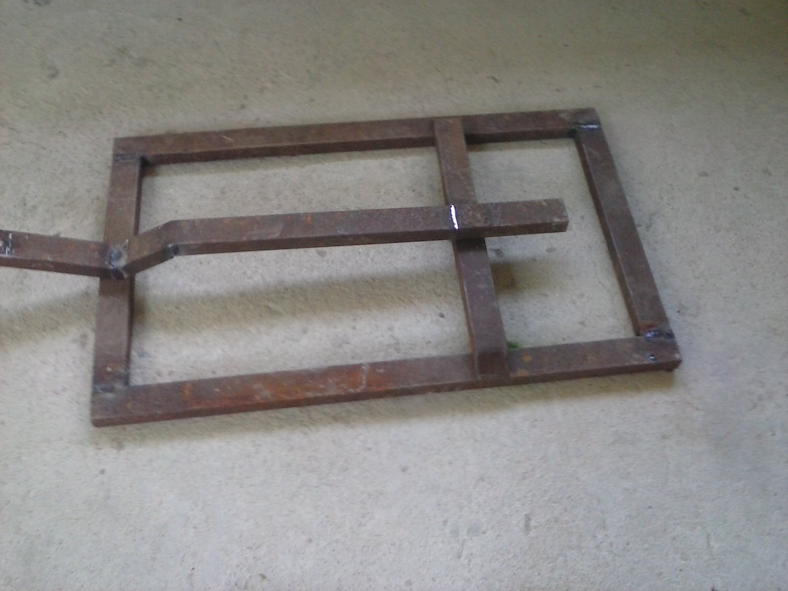

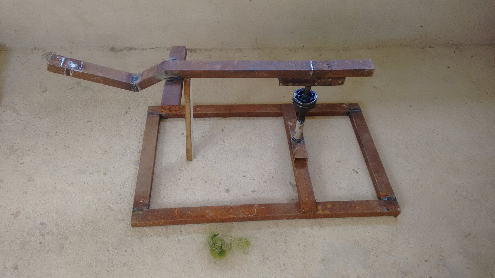

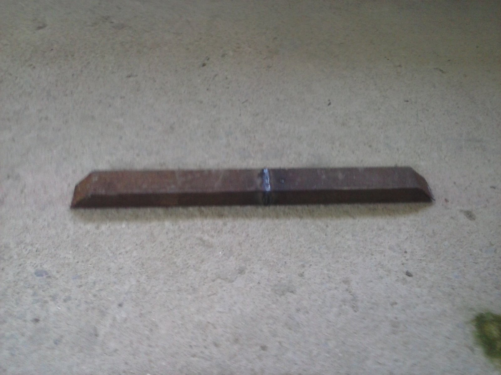

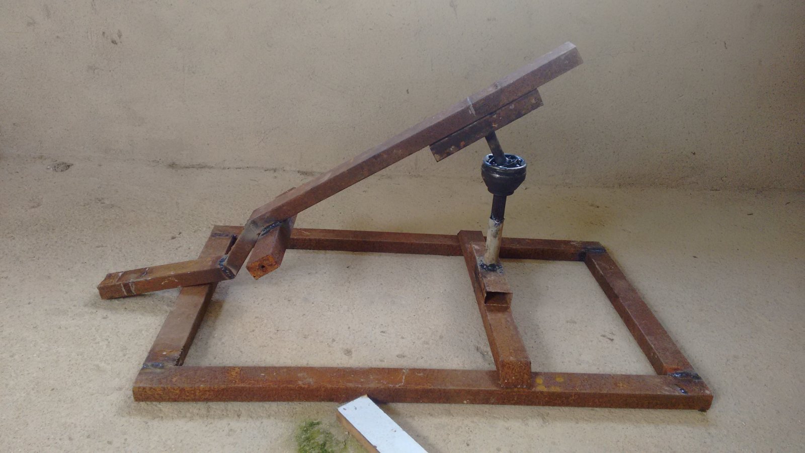

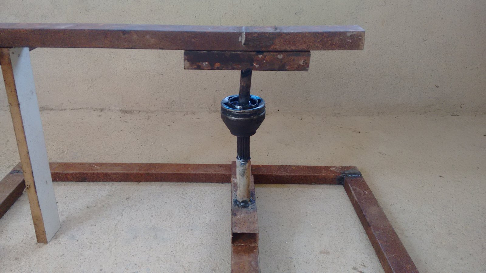

    the welding work continues I found a shaft of cardan
  7. Fernando Godinho
    Fernando Godinho Member
    Feb 23, 2019
    35
    Entusiasta de simulação
    Brasil - São Paulo - Guarulhos
    70Coins
    2DOF, 3DOF, Arduino, Motion platform
    IMG_20190316_132147637.jpg IMG_20190316_132139869.jpg IMG_20190316_132156028.jpg IMG_20190316_132220393.jpg IMG_20190316_132230714.jpg

  9. Dschadu
    Dschadu Active Member
    Jan 2, 2017
    109
    1,938Coins
    +146 / 1 / -0
    A short tip: you need to clean the metal before you weld! It's not a good practice to weld with all that rust. Your welds may not be strong enough to withstand the forces in your simulator
  10. Fernando Godinho
    Feb 23, 2019
    35
    70Coins
    thanks for the tip Dschadu
    it was just to know the diameter and size of the project
    I'll make a new one with a bigger size
