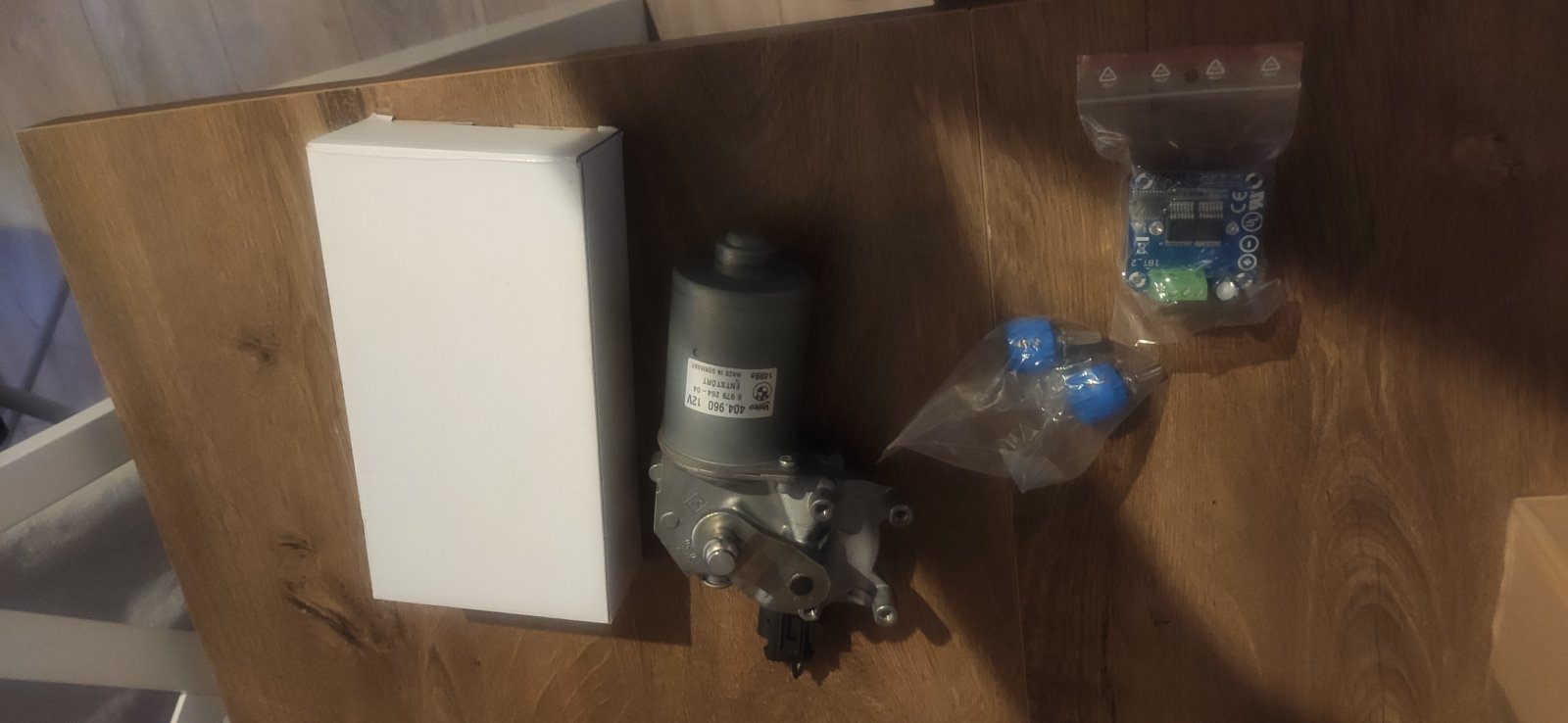

    Ok my shop list:
    - Power supply HP ATSN-7000956-Y000 700W 411077-001 412211-001 do
    - some used wiper motors (i don't know if all available are compatible)
    - two BTS7960-Modules
    - Arduino uno
    - two pots
    I will try complete my parts and do something like this :https://www.xsimulator.net/community/threads/diy-2dof-simulator.4793/
    Or this : https://www.xsimulator.net/community/threads/my-2dof-motion-add-on-for-playseat-evolution.13918/
    So wish me luck :)

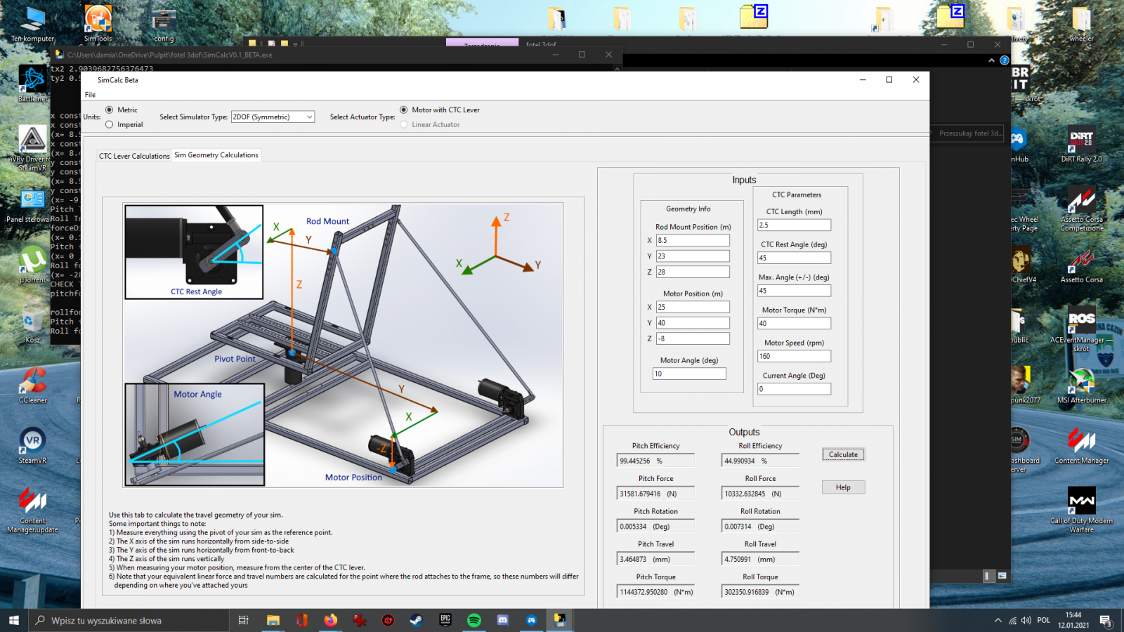

    Ok I'm waiting for my stuff to come and wondering where to place wiper motors on front or in the back. I thing in front i can make my 2dof seat less wight. Am I right?
    Does the feeling and immersion r the same?
    21,891
    152,977Coins
    +11,116 / 56 / -2
    Wiper motors are not particularly powerful, so you want to have plenty of inherent design leverage, so a shoulder of foot mount would be best. Wiper motors are not really suited to a compact design, as that requires lots of torque.
    Have a play with SimCal, that will give you some idea as to the tradeoff between design and physics: https://www.xsimulator.net/communit...e-linear-speed-and-forces-of-your-design.270/

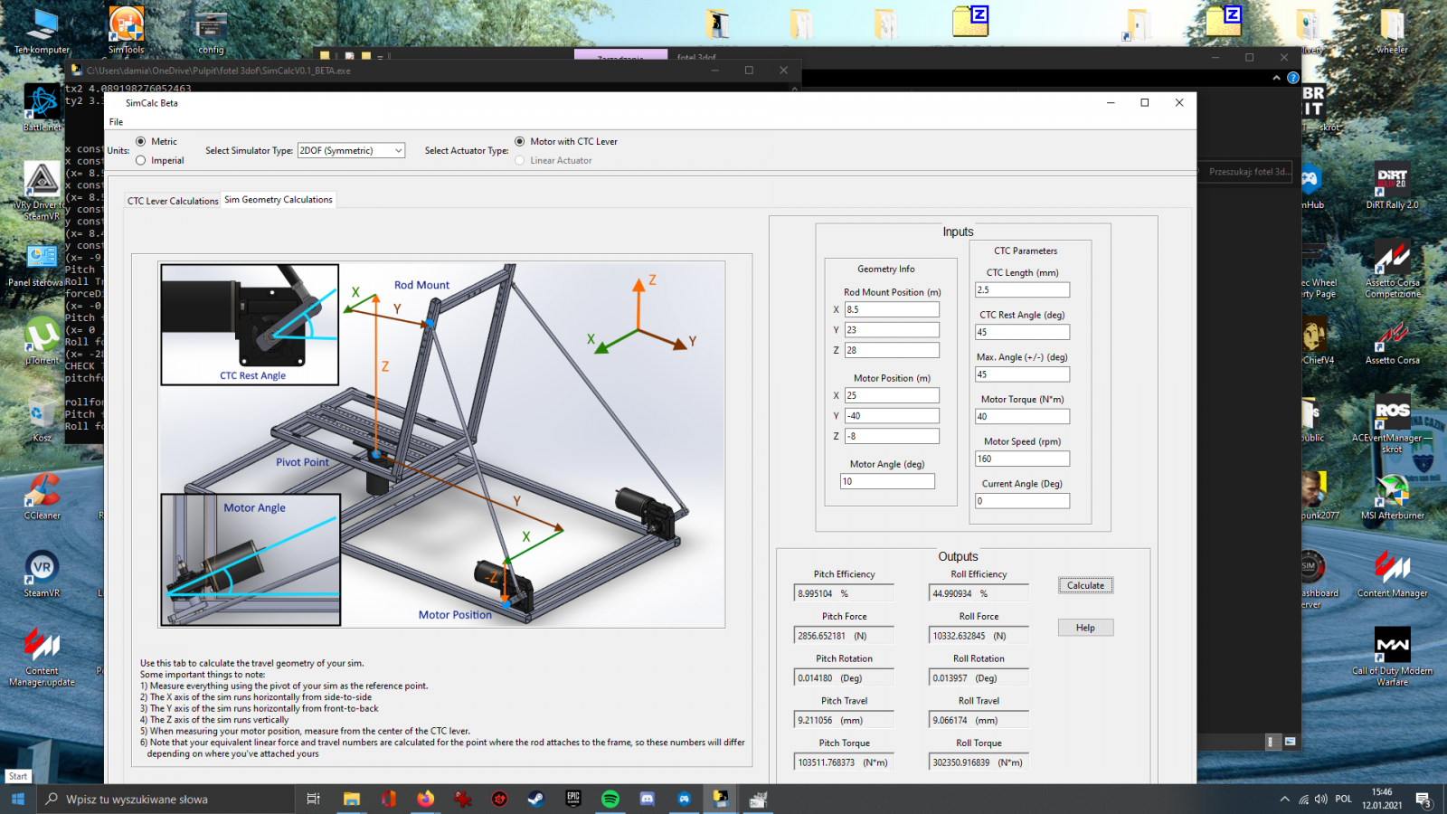

    ok i done some calc and i see whenn i put motors to the front my Pitch efficiency fall to the 9%. i dont want to have big forces but this looks like i must change my idea and put motors to the back

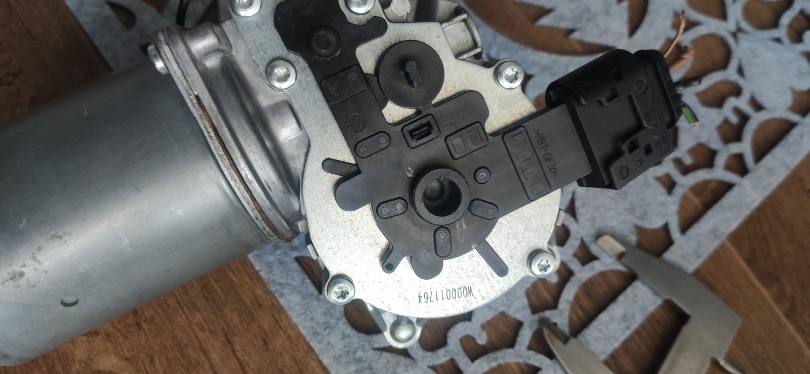

    Ok little break but covid times and snow falling and school break making me doing something else. Now I have my parts and tomarrow I will try make my wiper be ground isolated. Keep finger cross beacuse i will not step this out :)
  7. Krzysztof Dej
    Krzysztof Dej Active Member
    Jun 3, 2020
    315
    Poland
    1,100Coins
    +74 / 0 / -0

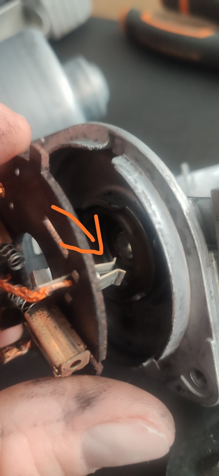

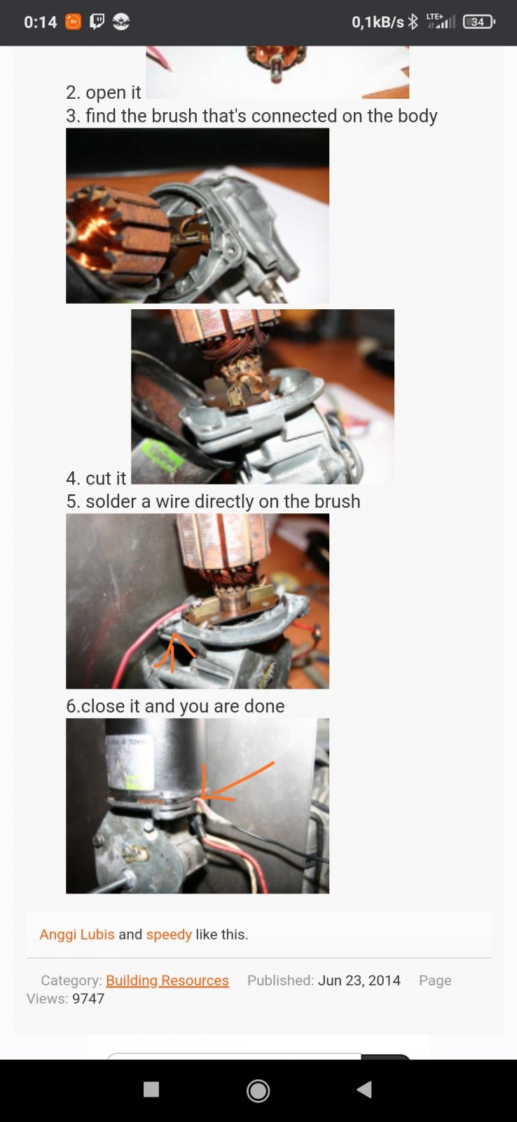

    So @noorbeast what execly i must do with this wiper? I have 2 parts : motor and gear shaft.
    Motor cover is isolated with gearshift by bolt washer but I saw i must take cover and ground some parts to the cover. Can u help me with some links?

    I am guessing your wiper motors may have a number of wires for high and low speed, is that correct?
    If so high speed is what you are interested in.

    OK how I check this which I high speed :)?
  12. noorbeast
    21,891
    152,977Coins
    +11,116 / 56 / -2
    Connect the motor up to a battery, it should be pretty obvious which is high and low speed via its RPM.

    I found a wiper motor grounding tutorial on youtobe. Is any good?
  14. Krzysztof Dej
    Jun 3, 2020
    315
    Poland
    1,100Coins
    +74 / 0 / -0

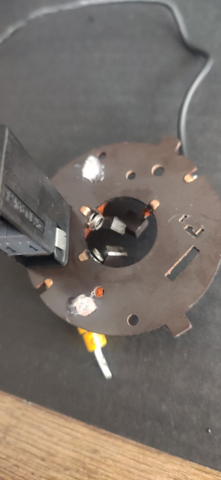

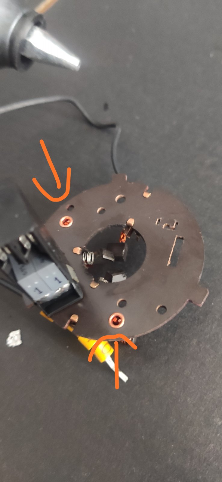

    Wiper motor grounding complete

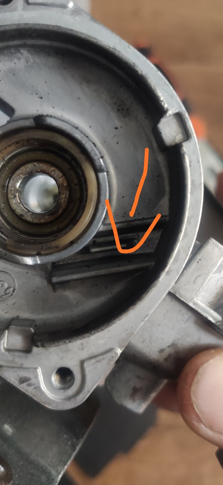

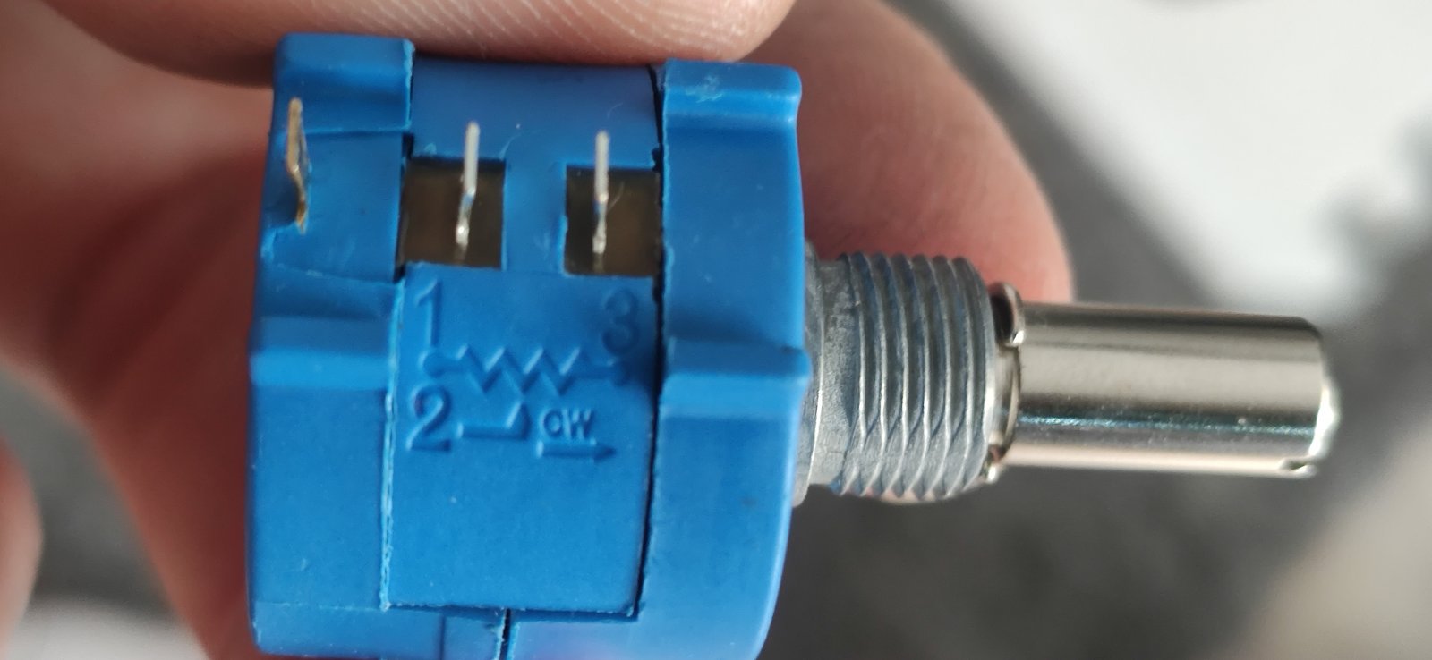

    Now I will try to make pot connection the motor but on the other side. I must make hole like m6 maybe and pin to connect with pot.
    I wonder if anyone make it like me. Maybe someone make pot holder do wiper motor on 3d printer?

    The grounding cable put outside and isolate from the rest or connect somehow?
    Can U help me with the pots how connect them?
  17. absyfadhel1
    absyfadhel1 Active Member
    Oct 19, 2017
    346
    bahrain
    550Coins
    +37 / 0 / -0
    "MAYBE"..the middle one must be the control one and left is gnd and right the 5v.....
  18. noorbeast
    21,891
    152,977Coins
    +11,116 / 56 / -2
    I am not sure I understand what you mean, could you please explain a bit more.
    If the wiper motor is ground isolated the case is not live when in operation, which you can check with a test light.
    If you mean the ground wire for the pot then that goes to the Arduino, if that is what you are using. In which case it would be helpful to know what motor driver you are going to use, so we can advise on the correct wiring.

    I find brush connected to the body cut it and solded to the brush as tutorial says but this cable connected to the brush is outside the body and where it goes?

    I will use Hbridge BTS7960B 43A
